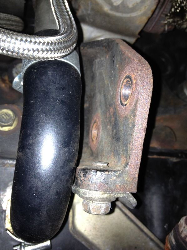

A L 3 X Posted August 18, 2012 Posted August 18, 2012 Bit concerned about this bracket touching my oil return rubber pipe given how tempremental they are, what do people suggest or would one of deans silicone pipes be able to withstand this better:cheers Quote

A L 3 X Posted August 18, 2012 Author Posted August 18, 2012 That's how it's always been as far as I'm aware? Standard bracket?Yeah I'll get one of them hoses but is that deffo the right one? Quote
akyakapotter Posted August 18, 2012 Posted August 18, 2012 Shouldn't be like that mate should be a gap between it Quote

james@cjperformance Posted August 18, 2012 Posted August 18, 2012 Im guessing you have an aftermarket mani that movea the position of the standard turbo? Thatl be your problem Quote
A L 3 X Posted August 18, 2012 Author Posted August 18, 2012 Why not lol obviously the oil return can't move and connect and I doubt the bracket can?N nope, standard mani just race tech oil feed? Quote

A L 3 X Posted August 18, 2012 Author Posted August 18, 2012 I'm gonna see if I can move the bracket tomorrow but I don't understand why its touching in the first place :/Gonna order a return pipe off dean as soon as he replys Quote

jezza Posted August 18, 2012 Posted August 18, 2012 There's only one way the bracket bolts to the block. Moving the bracket might upset the exhaust position. If it's only the oil feed that is not OE then I would start my search there. Perhaps the oil return pipe is sitting at an angle?You could use some spiral wrap as a means of protection until you find a better fix. Quote

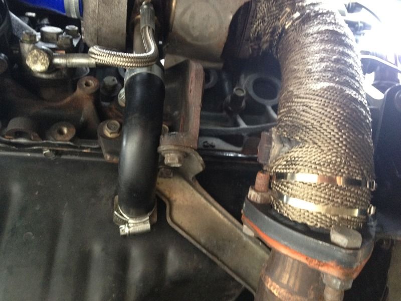

james@cjperformance Posted August 19, 2012 Posted August 19, 2012 Coild you take a wider angle pic at all? Something is not right there which is causing it to touch Quote

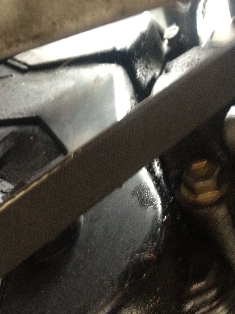

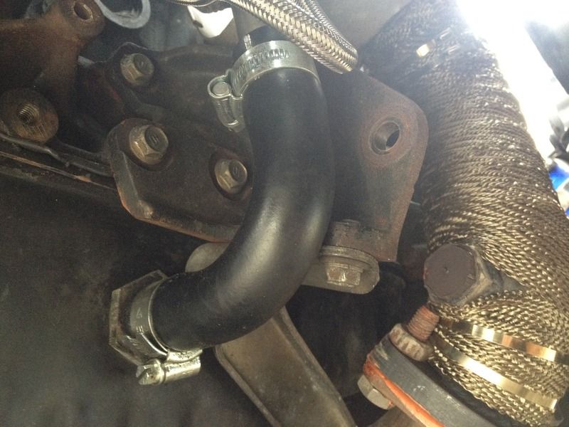

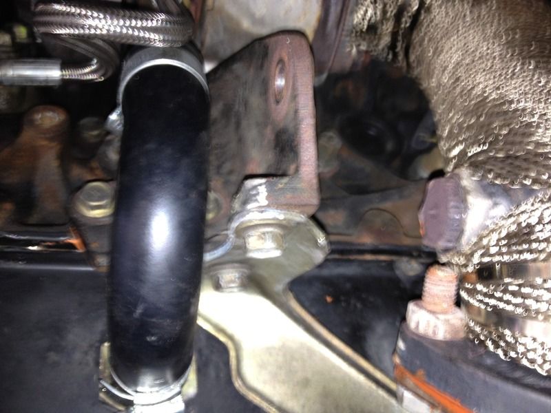

A L 3 X Posted August 19, 2012 Author Posted August 19, 2012 Heres a few pics of how it was form different angles:So, out came the Dremel:Before realising that the bolt holes allow some room for adjustment with the bracket, which gave me this:Is that as much room as standard or should there still be more? It was the movement of the bracket which has given the most space as I only took a couple of mm off the brasckets to stop it touching for now.I am however wondering if I should remove the brsacket all together as having the exhaust clamped to a brace is causing this, is this gonna cause early failure of the exhaust or is it ok?Finally, whils under there I noticed this light oil misting, it seems to be coming from above the oil filter and the rocker gover gasket was recently changed, so unless its from before or its after me spilling during oil changes, any ideas? Quote
