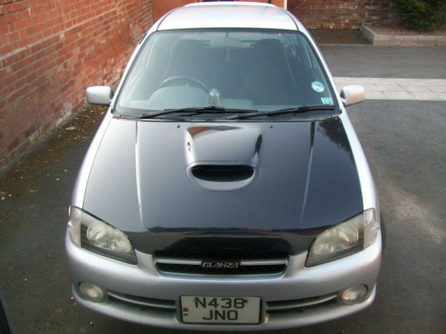

So I've finaly got myself a glanza after years of wanting one.
I found it on ebay and put a bid in and got it at a steal (£1001)
there no rot anywhere and seems to be in faily good nick, given the price.
There are bits that need sorting like-
Wheel bearing passanger side.
Turbo timer seems to do what it likes and idles quite rough.
Oil spray that keeps apearing on the rocker sprayed towards the bulkhead, think its out the breather.
The wiring is A MESS! as in sub kit wiring and some shit siren thing that makes horse and cow noices lol
water in boot wheel well.
Rip a ghey HID kit out as they have seen better days and hardly work..
Need a new boost gauge as it reads 1.1 bar and im sure its not lol
Oil leak around the PAS pump area :s
so heres the pics from the advert as i havent had chance to take any myself yet.

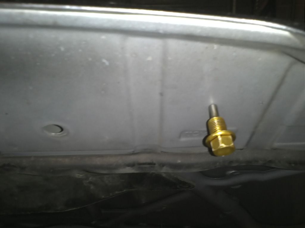

so had a poke around to discover what i thought was part of the block was the oil filter! It was that cackd up and old it blended right in. so i brushed it off with my hand and it turned. It was less than finger tight. OIL LEAK SOLVED! yay.
also in the process found out i had a magnetic sump plug :)

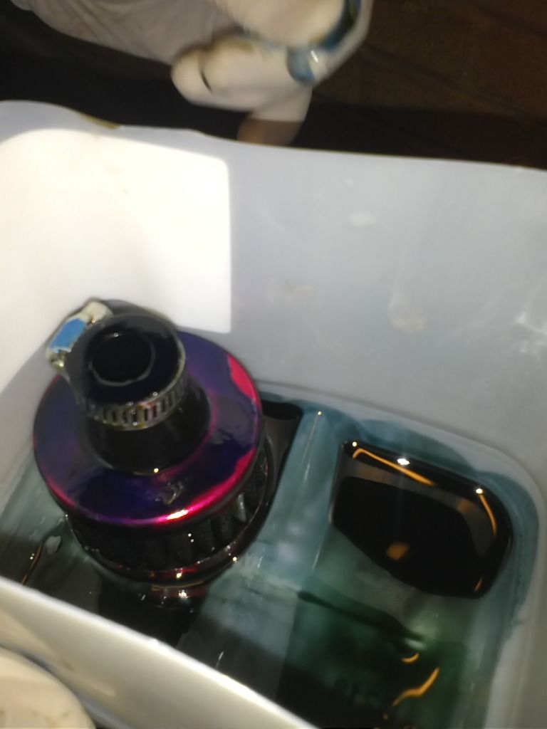

so after that thoughtid clean the breather filter as it was clogged with oil. then DAN TO THE RESCUE lol hehad some filter cleaner he uses on his motorX bike and it worked a treat on my breather
this stuff is bright blue and turned black as soon as we poured it in. Great stuff.

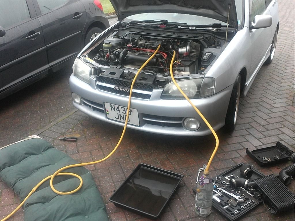

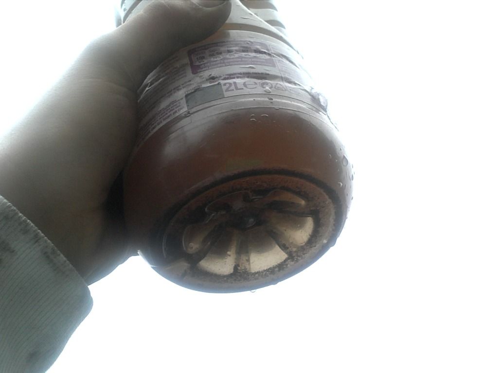

First i was getting abit tired of not having heaters so i decided i should flush the system (again) and matrix
should have taken more pics of the sludge that came out lol
heres the only one I've got which isnt very impressive
the heaters still arnt great but enough to de mist the screen so its an improvement.

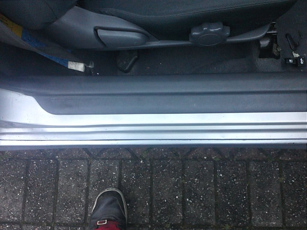

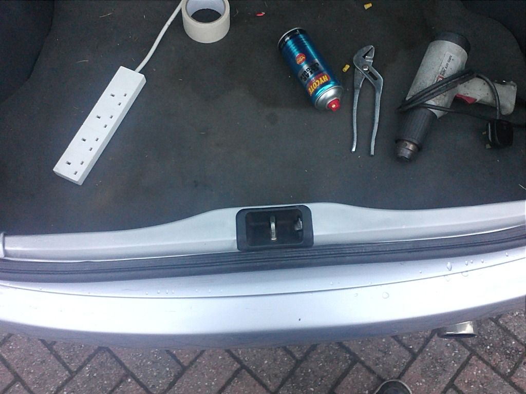

then sprayed the sills and boot as they where scrachd and didnt look the best.
To this :)

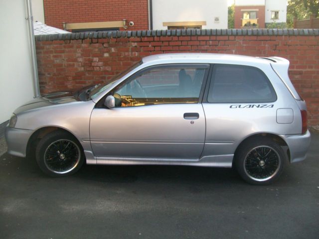

I've swaped my wheels aswell from the horrible wolfrace buckled mess. havent got any proper pics yet though bar the pic below.

Looks like a clean Glanza, was wondering where did you tape and mask up the sills? because I need to do my NA sills at some point and don't wanna make a mess!
