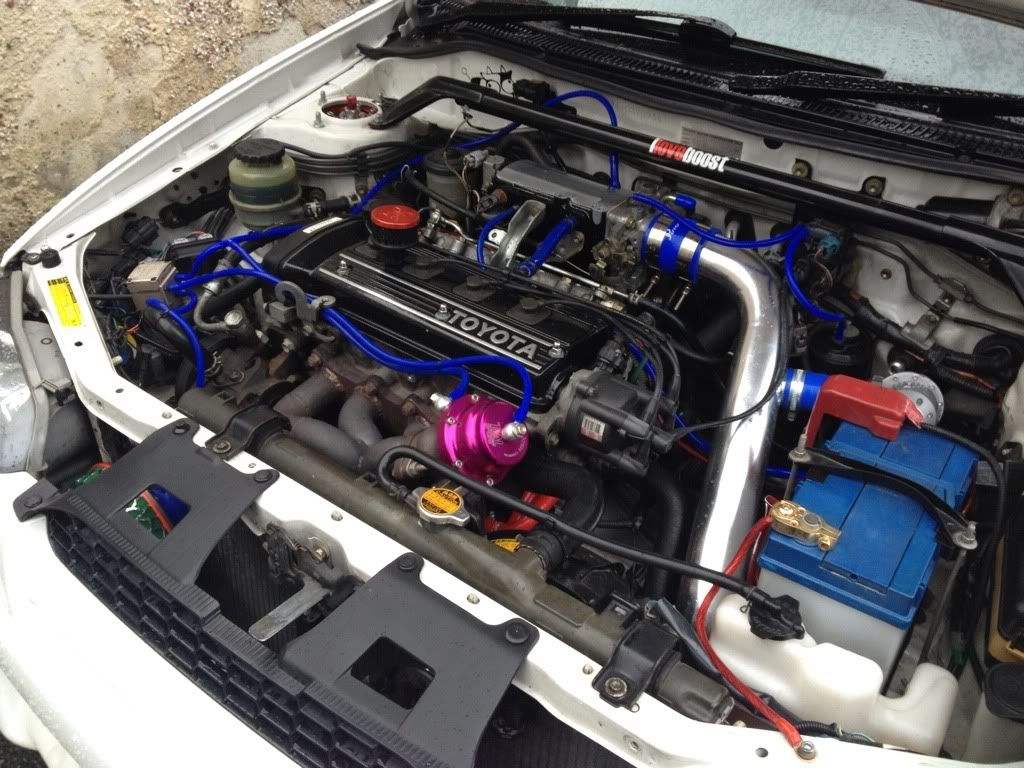

A L 3 X Posted November 5, 2012 Posted November 5, 2012 (edited) Currently I have a 0.6 bar spring in my wastegate; although when running spring pressure it seems to peak at 0.4) but I'm currently using a manual boost tee to run bar and I notice my screamer starts to come in earlier than 1 bar, yet when using my Ebc the screamer opens at almost peak boost and sounds better, but I'm not using the Ebc as it won't learn properly.My question is if I run a 1 bar spring will this open the wastegate at near enough a bar or will it still come in at lower boost?Cheers Edited November 10, 2012 by A L 3 X Quote

A L 3 X Posted November 6, 2012 Author Posted November 6, 2012 (edited) Ill get a picture next timeI'mN not 100% mate but Im sure i Installed it all correctly? Edited November 6, 2012 by A L 3 X Quote
Broony Posted November 9, 2012 Posted November 9, 2012 Better pics please:) from what I can see you have a lot of t's that could be giving you a poor vaccum Quote
A L 3 X Posted November 9, 2012 Author Posted November 9, 2012 I'm not running that setup anymore mate so that's the only pic I got :/Only the one tee from the intake mani to the Ebc solenoid and bottom port of wg Quote

steve-gers Posted November 10, 2012 Posted November 10, 2012 Mine goes from 'com' port on solenoid to top port on wastegate then from 'nc' port on solenoid to a t-piece which splits to the bottom port of the wastegate and the turbo (could also tee to inlet mani). 'no' port must be left open to atmosphere as a vent, this is with a profec b spec 2 other controllers may have different port names. Quote
A L 3 X Posted November 10, 2012 Author Posted November 10, 2012 Well from that picture above^^ you have it plumbed in wrong according to this: http://www.fd3s.net/profec_install.htmlOnly 2 out of the 3 ports on the solenoid should be usedlike this: http://i825.photobucket.com/albums/zz177/conceptuatuning/Gizzmo%20Stuffs/Gizzmoexternalwastegatesetup.jpgMine goes from 'com' port on solenoid to top port on wastegate then from 'nc' port on solenoid to a t-piece which splits to the bottom port of the wastegate and the turbo (could also tee to inlet mani). 'no' port must be left open to atmosphere as a vent, this is with a profec b spec 2 other controllers may have different port names.Oh? I'm confused now? Could someone maybe tell me from them instructions which port goes where as I'm confusedThere's a port on the back for bleeding off I've left open, but other 3 were connected Quote
Broony Posted November 10, 2012 Posted November 10, 2012 Ahh yours is a profec A sorry. ^^ That does look right Quote
A L 3 X Posted November 11, 2012 Author Posted November 11, 2012 hmm, not sure why it wouldnt work then, do i need the bottom port teed off the intake mani? or cant u leave that open Quote
Broony Posted November 11, 2012 Posted November 11, 2012 bottom port goes to tubby, right port goes to bottom of wastegate with a vaccum T (vaccum that see's boost and vaccum) and left goes to top of wastegate<<<< how you have it looks right just not sure where your vaccum goes as its hard to seeHave you sewt the click switches on the back according to your setup? they are in the link i posted Quote
