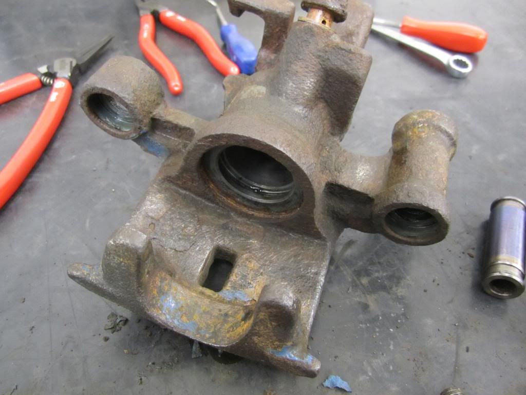

WallaceGlanza Posted February 26, 2013 Posted February 26, 2013 (edited) The main problem I found is just the rust on the actual pad carrier. When they rust, overtime, the build up will compress the little metal slider clips which the pads sit in, when that happens the pad won't slide back. I took a dremel to mine and removed the rust, greased them up and that should stop them seizing. A proper rebuild of the actual caliper is the next step, as above if the seals for the sliders have torn they may be seized too, a clean with some scotchbrite and then a grease up (grease is supplied with the toyota rebuild kits by the way) and they should be all good. You can see one of the sliders in the right of this photoae; The fact it has turned purple shows its seen some heat! Edited February 26, 2013 by WallaceGlanza Quote

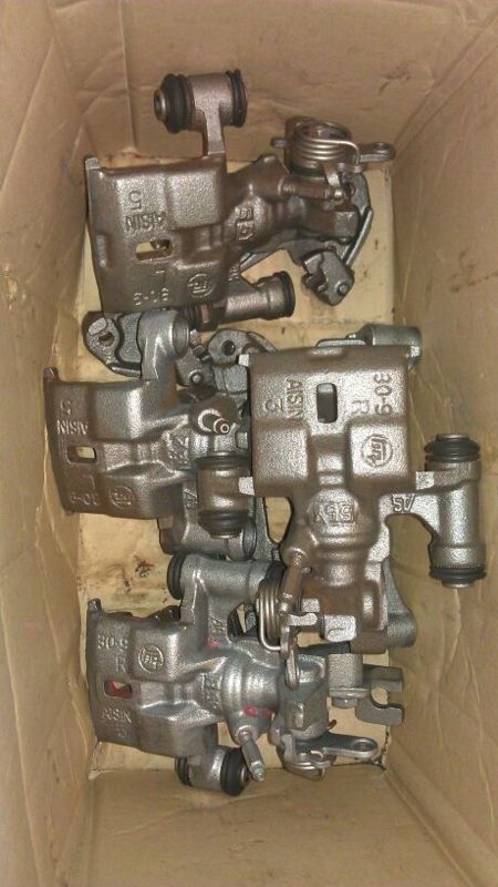

morgey Posted February 27, 2013 Posted February 27, 2013 (edited) My mate got around to shot blasting all my spare calipers today so now have all of these to make an good set from! Edited February 27, 2013 by morgey Quote
morgey Posted February 27, 2013 Posted February 27, 2013 I've got a rebuilt kit with these, so im going to make a good pair first, then with the ones on my car and the left overs from these ill try make another good set! ;) Quote
