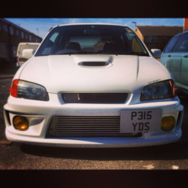

mowgli123 Posted April 30, 2013 Posted April 30, 2013 As the title says..I got an evo intercooler and it's massive!!!!!!!Will it run alright with it on? Quote
Matt1878 Posted April 30, 2013 Posted April 30, 2013 May lag a little more but I'm sure evi coolers have been ran before.. Quote
TurboTobz Posted April 30, 2013 Posted April 30, 2013 They have been run before some people even run bigger Quote
mowgli123 Posted April 30, 2013 Author Posted April 30, 2013 Really not sure if i should install it..My current one is a little rectangle. Looks shit lol. Nott sure Quote
TurboTobz Posted May 1, 2013 Posted May 1, 2013 Try it if you already brought it. Theres some one on here running one on his glanza. If you no likey remove it! Quote
wickedep Posted May 1, 2013 Posted May 1, 2013 yeah should be alright...a little on the large side..but its perfect for even when you upgrade turbos..very good cooling. Quote
AdamB Posted May 1, 2013 Posted May 1, 2013 They are good coolers, upto about 400bhp. Although I think a little too big than it really needs to be. Quote
funny onion Posted May 1, 2013 Posted May 1, 2013 I've got an Evo 8 front mount on mine. It's td04 now but I ran it for a while on the ct9 and it was mint. Didn't notice any more lag to an arc top mount tbh Quote
Matt1878 Posted May 1, 2013 Posted May 1, 2013 At matt - yeah that oneThis is a HDI Intercooler, the best for a starlet IMO, other than custom... Quote
AdamB Posted May 1, 2013 Posted May 1, 2013 You should count the amount of fins per inch of core, this is a good indication of how good the cooler is at dissipating heat.The Greddy cores are most likely the best as they have about 9 fpi, the less there is the greater the gap between the fins, allowing greater cooling capacity. Quote
Liam_D Posted May 1, 2013 Posted May 1, 2013 No different to the generic starlet front mounts...This, I'm pretty sure most FMIC kits are as big as a standard Evo one. Quote
mowgli123 Posted May 1, 2013 Author Posted May 1, 2013 My fmic is about the same size as a custard cream Quote
