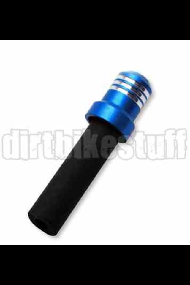

Lew91 Posted May 26, 2013 Posted May 26, 2013 I've taken out any thing and everything to do with the ACAlso removed the fuel filter and replaced it with an inline one. Charcoal canister can go but remember to put a valve on it. I'm removing ABS and PAS as well. Battery can go in the boot if needs be. Think there's a few other bits but can't think of any more off the top of my head. Quote

garrygt Posted May 26, 2013 Author Posted May 26, 2013 Ahright ok, dont have abs and i dont want to take my pas out as parking would be a nightmare. Was goin to take the charcoal canister off but how do you mean a valve? Cheers for the help Quote
