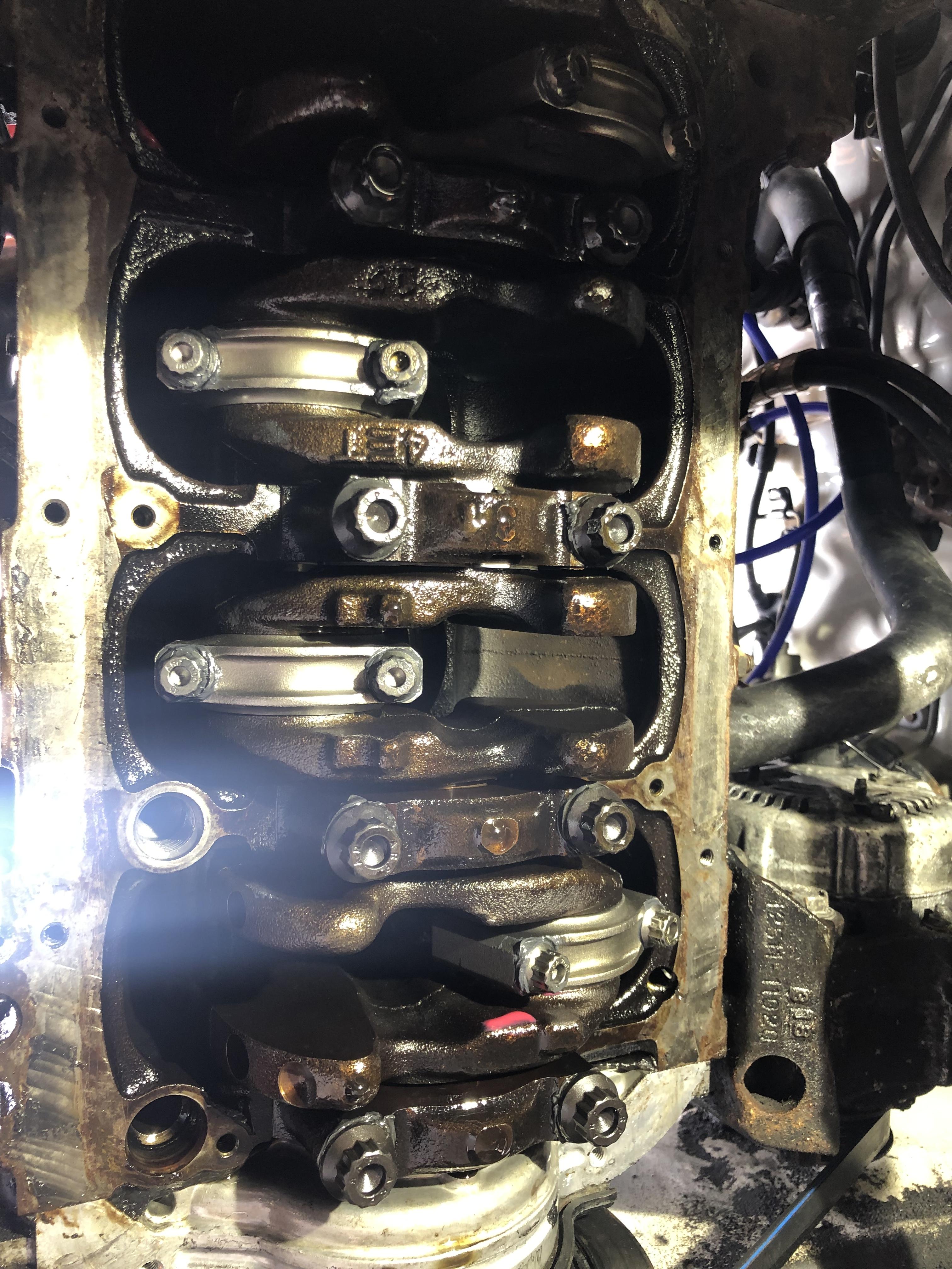

So after a long battle, I have finally got the car to a point where it can be started and flushed out, I’ll be using a cheap alternative oil for flushing then switching to Fuchs 5-40 fully with a fresh filter.
So just to go over what’s been done:
New ACL Big end shells
New ARP Big end bolts
New ARP Main cap bolts
Cleaned out oil strainer
Stripped and cleaned oil pressure relief valve

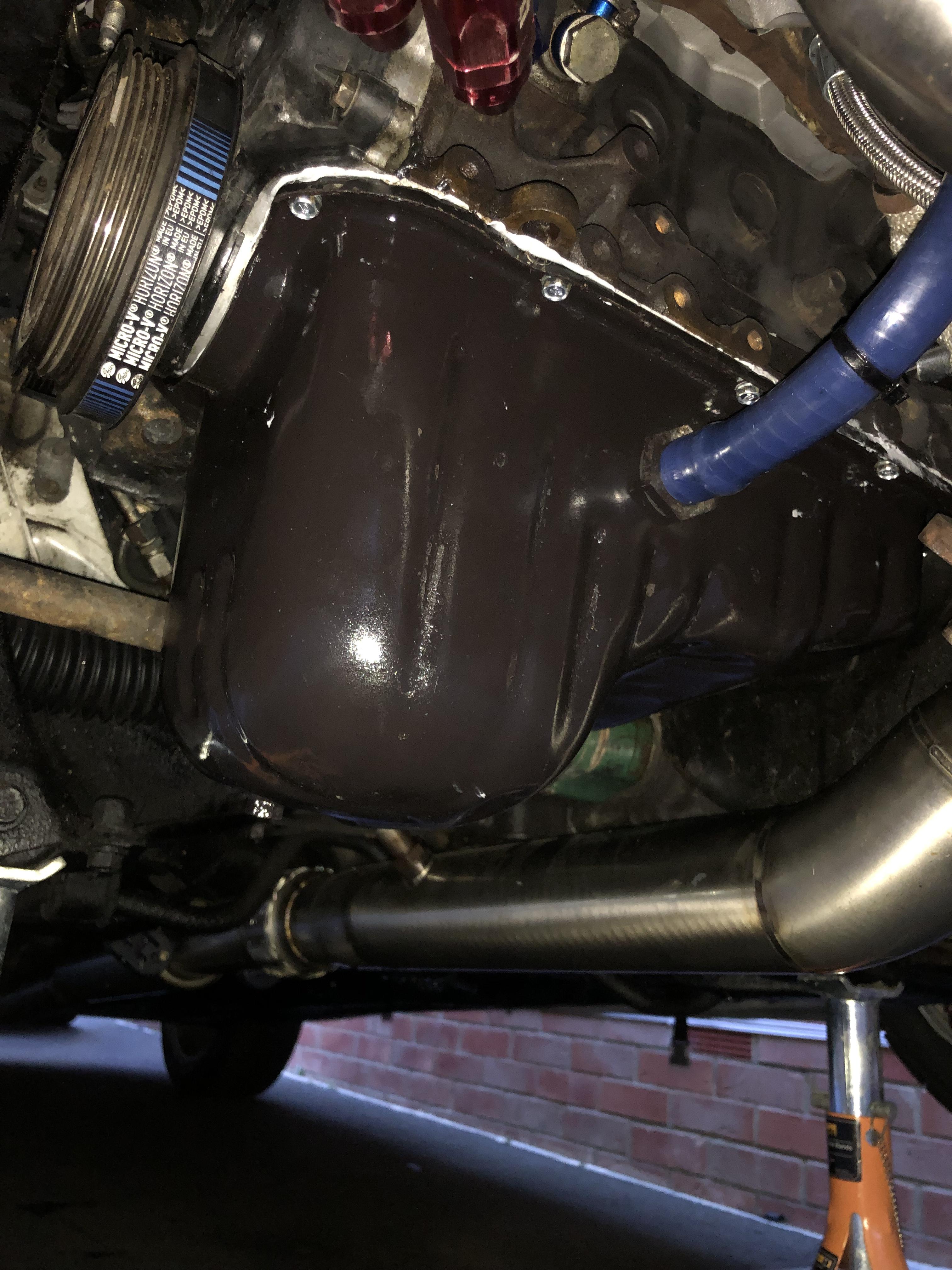

Cleaned and painted sump
New genuine sump bolts
Heat wrapped down pipe
Fitted new Racing lines remote oil line
Fitted new Heatshield Products heat proof sleeve to oil line
Couple of photos.
