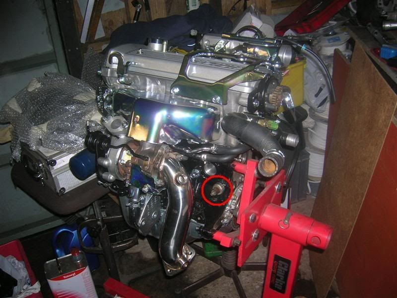

akyakapotter Posted July 1, 2013 Posted July 1, 2013 I'm going to use this when I get round to hooking my gauge up This is where the stock sensor is circled in red hope this helps Quote
Chops Posted July 1, 2013 Author Posted July 1, 2013 I'm going to use this when I get round to hooking my gauge upThis is where the stock sensor is circled in red hope this helpsFantastic mate, that's cleared this mess right up for me cheers! Thanks to you both! Quote
