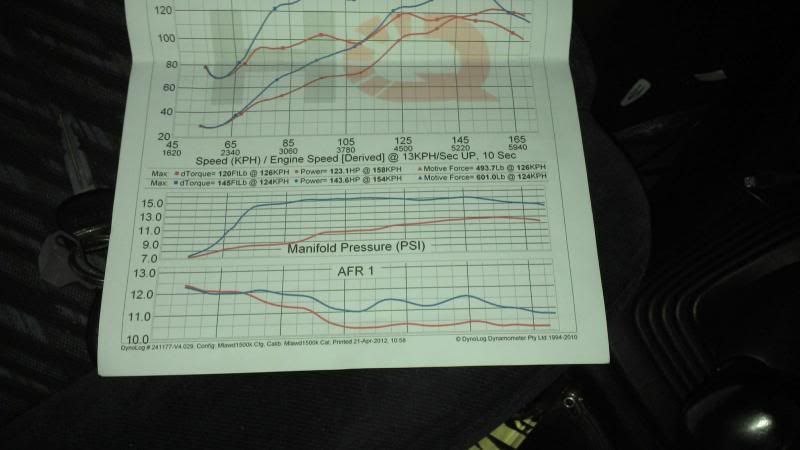

white-gt Posted July 30, 2013 Author Posted July 30, 2013 (edited) this was on a standard ct9. the red graph was using the actuator alone, and then blue was with the mbc. Edited July 30, 2013 by white-gt Quote
