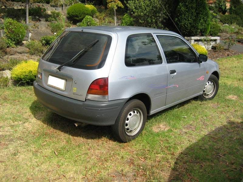

This all started in February this year when my AE86 sporting a 4A-GZE decided to catch a cold and miss and splutter constantly, not being able to chase down the problem, and with my spare car on loan to my girlfriend (she's got a EP82 GT, engine was dead at the time) I bought a EP91 to run around in.
A boring Australian spec Starlet, no power anything, unpainted bumpers, not even hubcaps.
Looked like this, yes the stickers came with it.

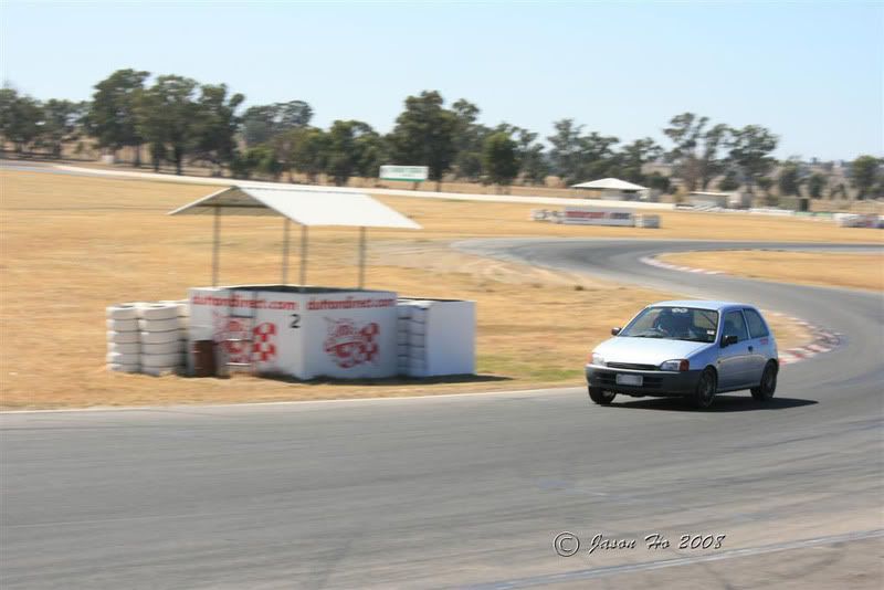

I find out my mates are going to the track, so it's off to yahoo auctions to bag some coilovers for track day, also got some 17s and new tyres as the 13 inch steelies weren't going to cut it. A quick strip of the rear half shed a few kilos, add a monster recaro knockoff seat with headbangers, and we are ready to go racing!
2 minutes flat around Winton. The slowest car down the straight, but I didn't do the slowest lap ;)

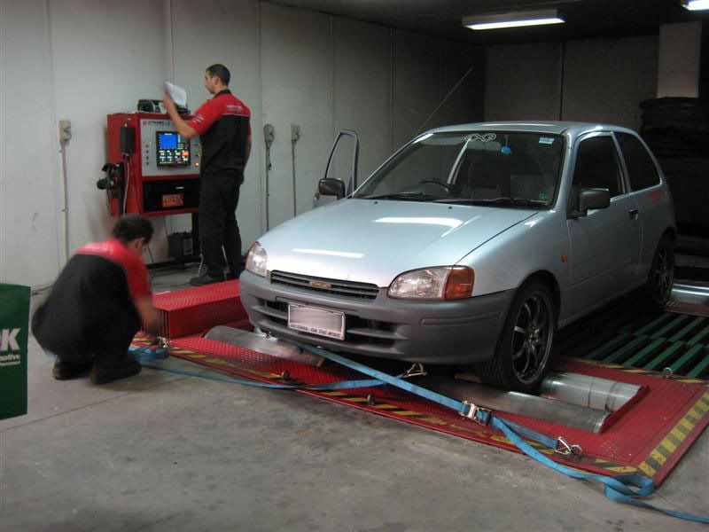

We have a dyno day, 43.4 kw at the wheels.

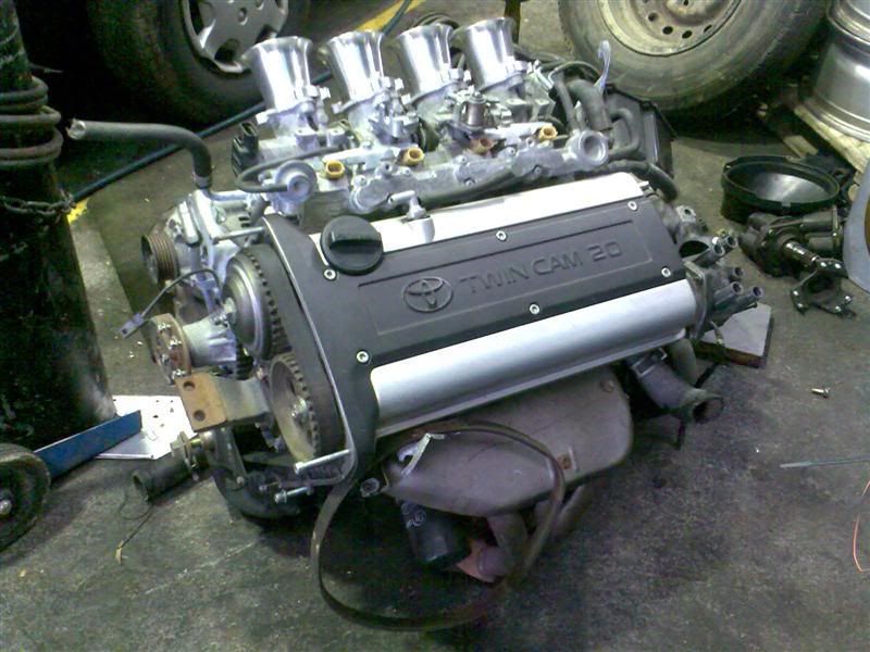

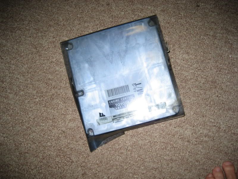

It certainly is a silvertop engine, going by the year markings it's a late 93 with the updated intake manifold. I got a blacktop computer from yahoo, this allows me to run MAP rather than the AFM, good move for sound and space. I got the trumpets off yahoo too, really nice CNC machined things they are, were 22000 yen if i remember correctly.

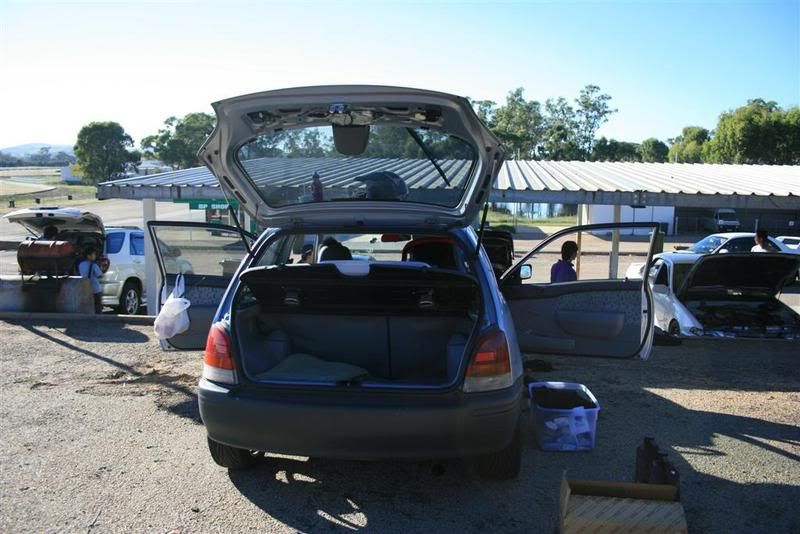

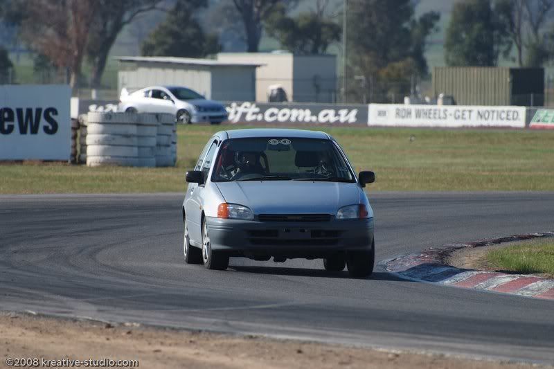

Pics from last track day
Me
Ying my girlfriend in her GT, we converted it to manual after the last motor died from old age. All your basic mods, intake, exhaust, FC cooler.
Thanks to Jase our camera man on the day for taking sooo many pics

We had a dyno day (rolling road??) and my 20v just pipped the girlfriends Starlet GT, mine 82.9fwkw, hers got 81.2. Her car makes more torque all the way through, in a drag race I reckon she'd win.

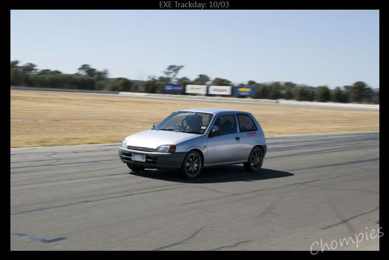

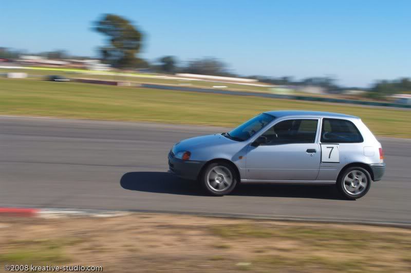

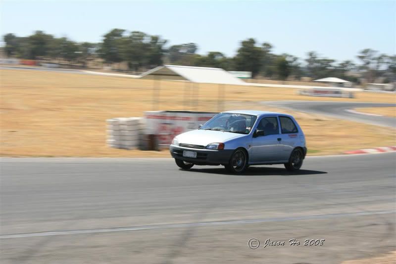

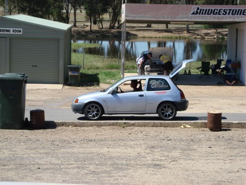

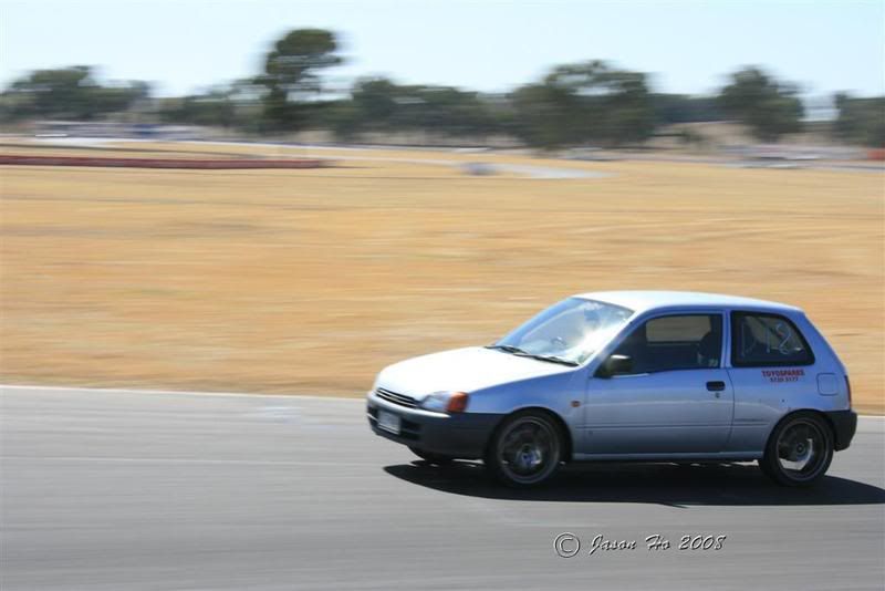

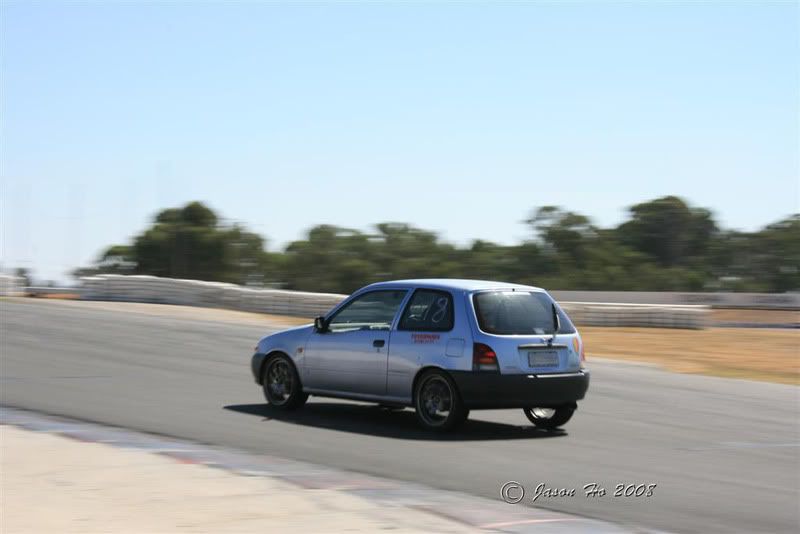

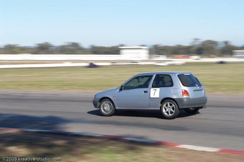

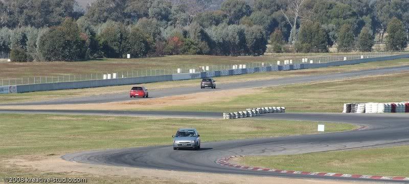

Pics of me at the track, not really in any order except the last few
GT belongs to Ying, my girlfriend, she's currently only 2 secs slower than me around the track, but she runs semislicks (cheater)
The pics with the HUGE wheels are around the end of summer, air temps were around the 36c degree mark, I had the track to myself after everyone packed up because of the heat. GO 4AGE!

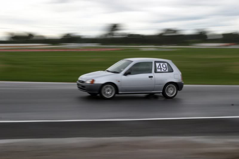

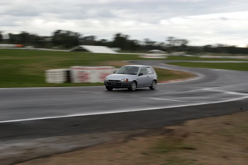

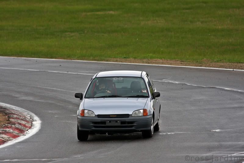

The latest track day it rained, check out the tyre flex on the damp circuit!

Forgot to put a engine bay shot in, plus some bonus ones of a Melbourne Starlet meet. Less than 20 GTs in Melbourne, and that green Glanza replica got written off a while back :)
