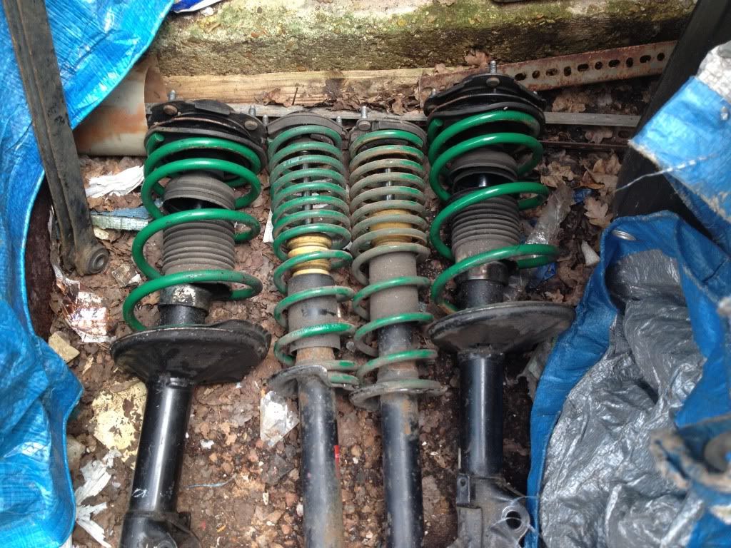

akyakapotter Posted October 8, 2014 Posted October 8, 2014 (edited) You got the springs on the right way up? They go a certain way the compressed end goes at the top like the picture bellow of my old ones Edited October 8, 2014 by akyakapotter Quote
mikey4410 Posted October 8, 2014 Posted October 8, 2014 I dont think a spring up a certain way will make any difference.check if the damping action is there still mate.rock the corner of the car on the corner u suspect a dud damper,if it stops rocking immediately then its fine,if it keeps going its buggered.I have silly hard springs on my car and mines not bouncy at all. Quote
maddox710 Posted October 8, 2014 Posted October 8, 2014 Likey mikey said, sounds like a bad shock absorber. Check to see if it's damp round the shock Quote
