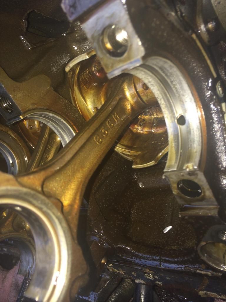

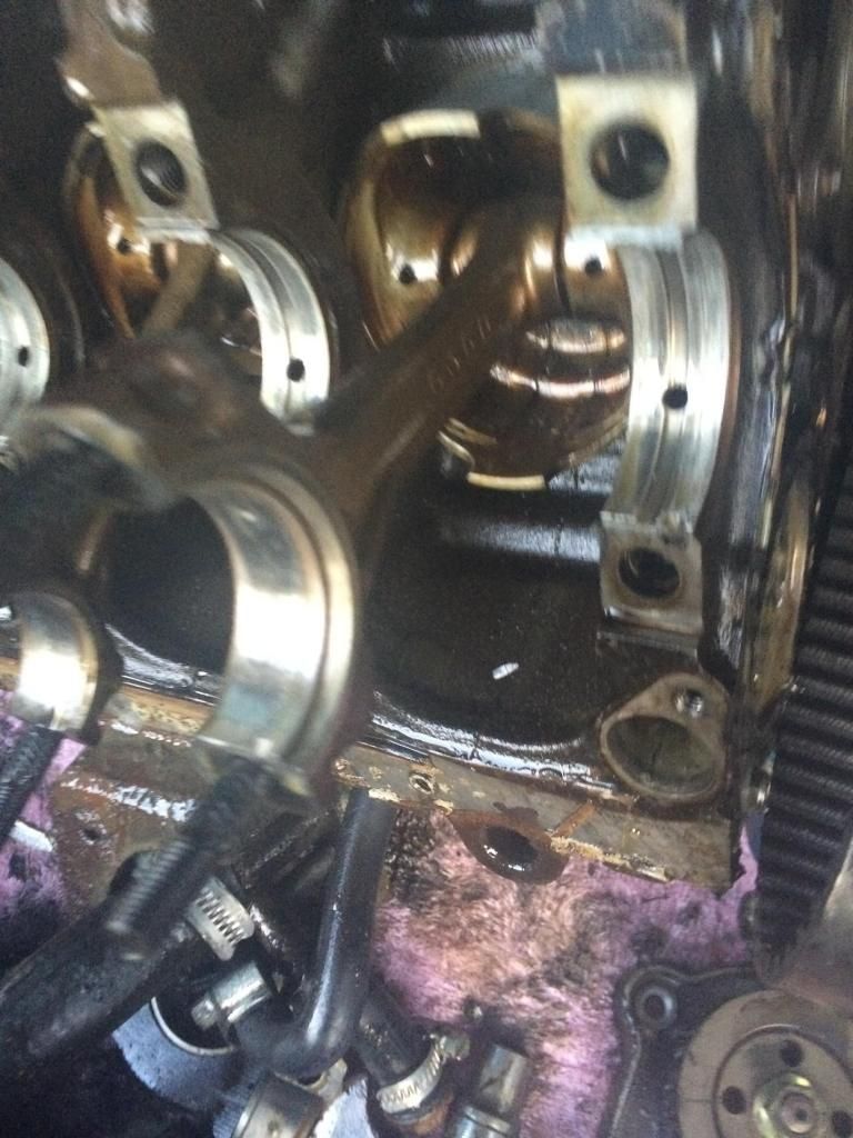

dangeestarlet Posted November 7, 2014 Posted November 7, 2014 Here some pics are they forged or not ? Quote
Socks Posted November 7, 2014 Posted November 7, 2014 Looks stock to me.. Forged rods usually flat sided or come OUT not inward... Quote
Charlie28 Posted November 7, 2014 Posted November 7, 2014 I'd say that's stock pistons and rods mate. Here's a pic of my forged internals Quote
Ollieh17 Posted November 7, 2014 Posted November 7, 2014 could be 5efe or gen1 rods, hard to tell from pics but they look thicker than glanza rods Quote
Phil Posted November 7, 2014 Posted November 7, 2014 I'd say that's stock pistons and rods mate.Here's a pic of my forged internals nice pistons. Phil Quote
_shaun_ Posted November 7, 2014 Posted November 7, 2014 Looks stock can see the casting marks on the rods. If there not arp rod bolts good sign aswell. Quote
