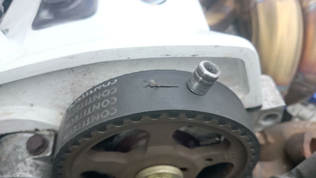

akyakapotter Posted March 22, 2015 Author Posted March 22, 2015 Found the cause one of the dowls must have been lodged in the head for the top cam belt cover it worked loose and must have fallen down into the belt found that lodged between the belt and the cover it's ruined a brand new belt bastard thing. Quote

patman Posted March 22, 2015 Posted March 22, 2015 Found the cause one of the dowls must have been lodged in the head for the top cam belt cover it worked loose and must have fallen down into the belt found that lodged between the belt and the cover it's ruined a brand new belt bastard thing. Yeah I agree mate chin up you found the problem fast I know it's a new belt as you say but that would of been the least of your worries mate if that belt had snapped and you know it aswell thank god you found the issue quick Quote
