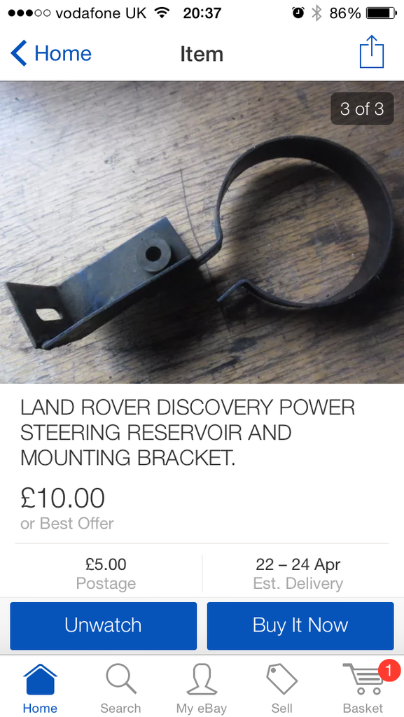

Ollieh17 Posted April 15, 2015 Posted April 15, 2015 Im looking for something like this toMount a 106 power steering pump on the chassis leg. Looked for ubolts but non seem to go big enough. Something like below would be perfect Quote

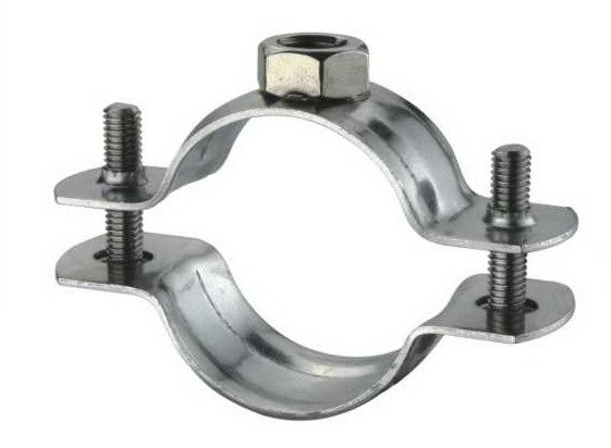

WallaceGlanza Posted April 15, 2015 Posted April 15, 2015 A split pipe clamp would surely work?... Quote
