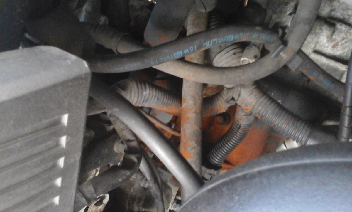

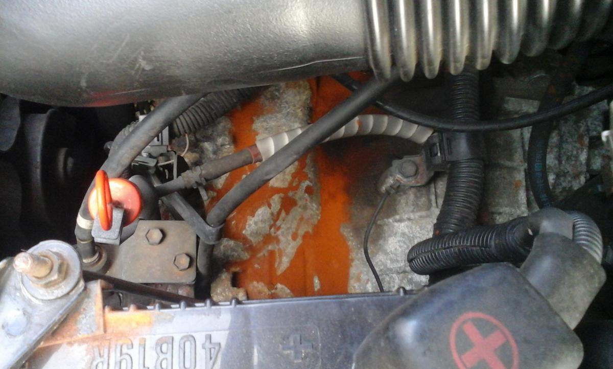

Dale SR Posted June 23, 2015 Posted June 23, 2015 (edited) On Sunday evening just as I pulled into my garage in my GT I noticed my car temperature was getting very high and when I got out the car I could see a little bit of steam/smoke coming out the nearside of the bonnet. I turned her off but left the fan on. Once she cooled down I just shut her off.On inspection under the bonnet I noticed my engine fluid had little to none left. What was left was a really dark brown rusty fluid. Which has also spewed over part of the engine on the right hand side I have took a couple of pictures to try and show where it's spilled over. So I topped up the coolent.The following day I started her up. She seemed to be ticking over as normal. She warmed up half way on the temperature gauge (quicker than normal) I drove her a hundred yards and the temperature started rising quickly. So I turned her off and left the fans on to cool her down.I'm not that clued up on fixing cars so I have her booked in with the garage I use. I was just wanting a little advice as to what the problem could be. Thanks Dale Edited June 23, 2015 by Dale SR Quote
enots Posted June 23, 2015 Posted June 23, 2015 (edited) Thats some rusty water!!could just need a good flush mate worth changing thermostat too make sure you flush the matrix too and get some decent coolant in there once the system is flushed fully.best to start with the cheaper things lol Edited June 23, 2015 by enots Quote
Duduglanza Posted June 24, 2015 Posted June 24, 2015 Use toyota coolant .. the best. Check the thermostat by dipping it in water and a temp.. at 82°c it will start to open.. if nothing happens cjange thermostat Quote
Dale SR Posted June 24, 2015 Author Posted June 24, 2015 Thanks for the comments guys. I will be sure to get the system drained. I couldn't believe the state of the coolent/rusty water!. A few people now have suggested the thermostat hopefully that's it and it's an easy fix Quote
George_EP82 Posted June 29, 2015 Posted June 29, 2015 A thermostat won't cause it to over heat in anyway, that will prevent the engine from warming up. Are there any noticeable leaks from the pipes or the rad? As said before, drain the system and flush it well. Once topped up again, turn on the car with the rad cap off and put the heaters on full blast. Whilst it's on give the hoses a squeeze to release any trapped air in the system, you'll see the coolant in the rad start to bubble, just keep it going for 15/30 mins and take it out for a spin to see how she holds up Quote
Duduglanza Posted June 30, 2015 Posted June 30, 2015 Yes if the thermostat is stuck closed.. it will overheat... Quote
Dale SR Posted July 16, 2015 Author Posted July 16, 2015 My GT is all sorted now it was a burst pipe. I did no damage when she was overheating thank god!! I also got a new thermostat fitted.Thanks for all your comments lads Quote
