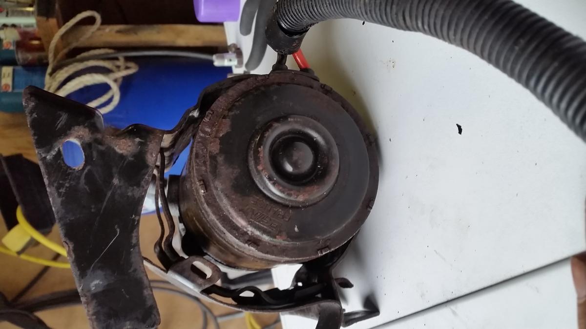

fordie_glanzaV Posted July 12, 2015 Posted July 12, 2015 Hi, correct me if I've posted in wrong sectionGot myself a saxo pas pump..It came with a mounting bracket which doesnt seem to fitAs u can see from the pictures the bracket seems far to big for the pump..Any suggestions?Also if anyone has got any picures of how they have mounted the pump and ran the lines to the pump will be much appriciatedCheers lewis Quote

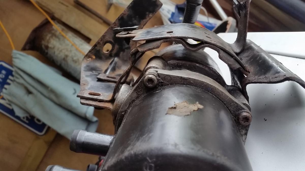

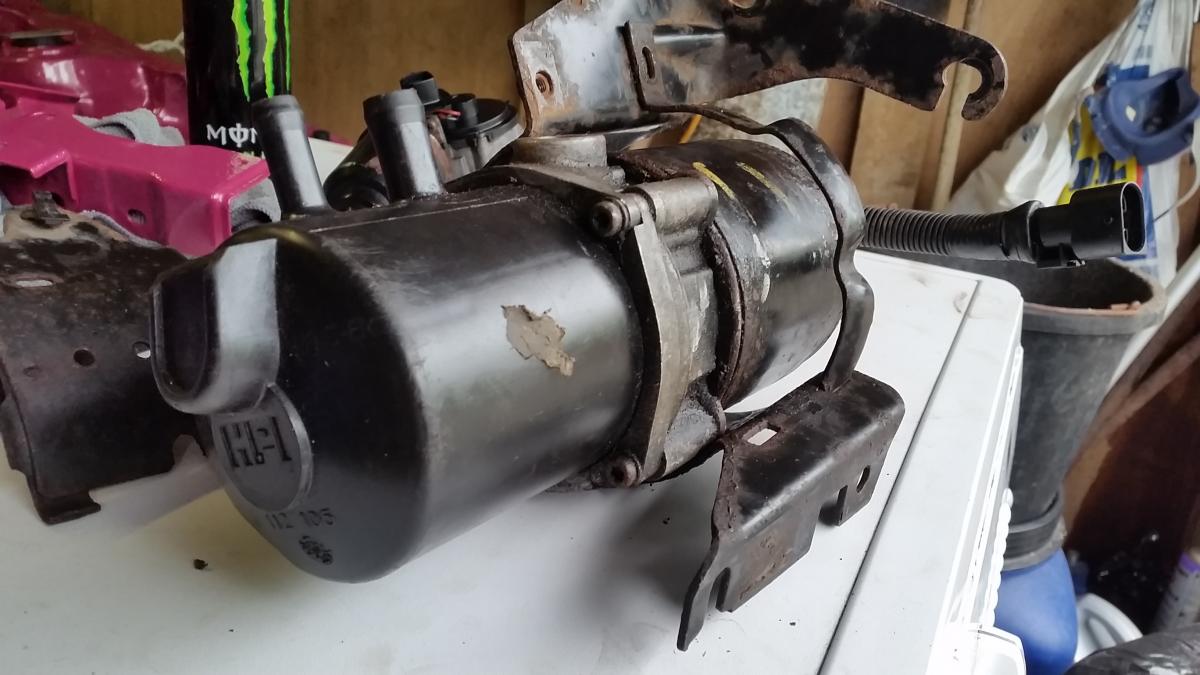

fordie_glanzaV Posted July 12, 2015 Author Posted July 12, 2015 (edited) Also 2 more pics Edited July 12, 2015 by fordie_glanzaV Quote
maddox710 Posted July 12, 2015 Posted July 12, 2015 I used long piece of threaded bar and wrapped it round the pump then drilled holes above fir the bar to go through but honestly if you have you alignment bag on you won't need it. It just makes the steering dangerously light Quote
fordie_glanzaV Posted July 12, 2015 Author Posted July 12, 2015 Im gunna have to make a bracket up at this rate. As the 1 that came with it is miles to big?What u class as the alignment bag mate? Quote

Mad Mike EP82 Posted July 12, 2015 Posted July 12, 2015 (edited) Your bracket is missing rubber inserts that's why it doesn't fit. Edited July 12, 2015 by Mad Mike EP82 Quote
fordie_glanzaV Posted July 12, 2015 Author Posted July 12, 2015 Oh that would explain alot.. Think im gunna have to try make something up... Quote
fordie_glanzaV Posted July 12, 2015 Author Posted July 12, 2015 Ahh i see. Ill see how i get onCheers for your help. Quote
Ollieh17 Posted July 12, 2015 Posted July 12, 2015 Were the rubber brackets not with it mate? I might have them somewhere Quote
fordie_glanzaV Posted July 12, 2015 Author Posted July 12, 2015 No mate no rubber brackets Went about fitting it today but couldnt work out the bracket. Lol Quote
