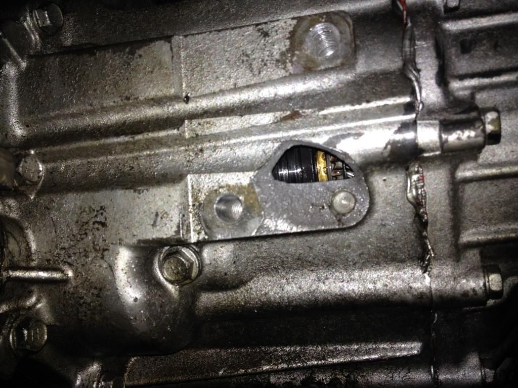

Ep82gi Posted July 16, 2015 Posted July 16, 2015 So I was out for a nice drive the other day nothing to crazy just me the car and some Suffolk back roads i was having a brilliant time out and about and then 3rd gear started to become a little bit hard to engage. Luckily I wasn't to far from home only about 10 minuets so a babied the car back home avoiding any harsh or unneeded gear changes everything was going fine until I approached a very sharpe corner that forced me to drop in to second. Then BANG I had no drive and no clutch pedal. The pedal would move an inch then go rock hard. Something wasn't right. Lucky I was a matter of 200 yards from my house so I pushed the car back and left it on my drive. Yesterday I found some free time to drop the box off and have a look at what's going on. And this is what I found Now the clutch isn't a problem it's what it's don't to my gear box that's got to me. Having no car sucks when I'm trying to look for a new job but on the upper hand I have 3spare 4efte gear boxes (non of which work) but could I make one out of what I have? If anyone has done this before I.e changed the bell housing. Please could you let me know what I need to do or direct me to a how to somewhere please so I could have a crack at it. ThanksLiam Quote
aleximport25 Posted July 16, 2015 Posted July 16, 2015 yeah buddy the housing is fairly simple to replace, if you follow this guide http://www.ukstarletowners.com/topic/59358-a-guide-to-fit-an-aftermarket-quaife-lsd/obviously some parts can be ignored but this should help a lot, it helped me to replace the centre section of my gearbox :-)by the way you've done a cracking job haha Quote
Ep82gi Posted July 16, 2015 Author Posted July 16, 2015 yeah buddy the housing is fairly simple to replace, if you follow this guide http://www.ukstarletowners.com/topic/59358-a-guide-to-fit-an-aftermarket-quaife-lsd/obviously some parts can be ignored but this should help a lot, it helped me to replace the centre section of my gearbox :-)by the way you've done a cracking job haha Thank you so much I'll get cracking with it Saturday morning Oh Indeed I wish I could say it's because of my crazy power....................................... But I can't Quote
aleximport25 Posted July 16, 2015 Posted July 16, 2015 no problem buddy, i thought it would be a right task, but its not as bad as you expect ;-)haahaa mine broke under braking so dont wurrie about it ;-Pwhile the box is in bits id check the breaings and synchros where possible Quote
Ep82gi Posted July 16, 2015 Author Posted July 16, 2015 no problem buddy, i thought it would be a right task, but its not as bad as you expect ;-)haahaa mine broke under braking so dont wurrie about it ;-Pwhile the box is in bits id check the breaings and synchros where possible Really?? did it do as much damage? Yeah that's a good shout buddy thanks for that I've always had a dog of a second gear but only down shifting never going up. Strange????¿thats a good efford for sure :) Ahaa thanks dude. Either of you have a rough idea of the gear ratio difference between the n/a and turbo boxes? I'm feeling combining some gearing here to suit the na set up better. Quote
aleximport25 Posted July 16, 2015 Posted July 16, 2015 This is the damage .....Sound like a worn synchro to me buddy best bet would be to check the condition when it's in bits As for different gears im unsure Colin is more of a guru than me but I know the fte gears are nearly twice as thick as fe gears Quote
Ep82gi Posted July 16, 2015 Author Posted July 16, 2015 This is the damage .....Sound like a worn synchro to me buddy best bet would be to check the condition when it's in bits As for different gears im unsure Colin is more of a guru than me but I know the fte gears are nearly twice as thick as fe gearsOh sshhhhhhhhhhhhheeeelllllssss that's not good. Ahh okay so that's the strength in the fte box then. Only trouble is I can't remember for the life of my why each box is there. Oh and on the inside of my pressure plate it had a 2E stamp. And the clutch measured at 190mm for the friction plate. I'm presuming that's correct for a 4efe and not some gadget bolting a 2e clutch n flywheel on there? ThanksLiam Quote

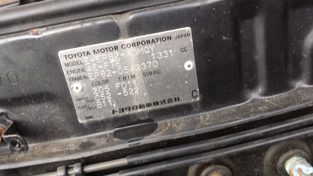

daniel_g Posted July 16, 2015 Posted July 16, 2015 there is no way you could tel the diference al na boxes look the same and toyota didnt nr them so its a geas which c1## nr they haveI know, its a shame Toyota never stamped the boxes, its a pain in the hole.Sweet hopefully I can get back to murdering some fiesta pritty soon then. :-) Haha if I could afford it I would hence the need to build one box out of spares :'(Chances are its the original box in your Gi.What does the engine bay plate say the box code is? Bet its different to a normal N/a. Quote
Ep82gi Posted July 16, 2015 Author Posted July 16, 2015 Chances are its the original box in your Gi.What does the engine bay plate say the box code is? Bet its different to a normal N/a.We're will I find it buddy and I'll let you know haha Quote
daniel_g Posted July 16, 2015 Posted July 16, 2015 We're will I find it buddy and I'll let you know hahaDirectly in the middle of the bulkhead in the engine bay, just once you fine out what code it is (assuming its the original box) then you can look around the internet and find out what ratios you have. It might just be the same as a UK N/a but you never know.This is the plate youre looking for. Quote
Ep82gi Posted July 17, 2015 Author Posted July 17, 2015 Directly in the middle of the bulkhead in the engine bay, just once you fine out what code it is (assuming its the original box) then you can look around the internet and find out what ratios you have. It might just be the same as a UK N/a but you never know.This is the plate youre looking for.Right so here's my plate dude. Trans/axel is c150-542 Witch is different to yours so is that the same as all n/a 4e's ThanksLiam Quote
Ep82gi Posted July 17, 2015 Author Posted July 17, 2015 Just took this from a toyota gearbox wiki page. ===C150=== A 5-Speed Manual Transmission for FWD cars. Gear ratios for this transmission. {| class="wikitable" |- ! 1st ! 2nd ! 3rd ! 4th ! 5th ! Reverse ! Final ! Final Echo ! Final Paseo ! Final Starlet & Tercel |- | 3.545 | 1.904 | 1.310 | 0.969 | 0.815 | 3.250 | 4.058 | 3.526 | 3.941 | 3.722 |} Applications: * [[Toyota Starlet#80 Series|Toyota Starlet]] (All EP82 except turbo and 4WD) * [[Toyota Echo]] 2000-2005 * Toyota Corolla [[Toyota Corolla (E80)|E80]] and [[Toyota Corolla (E90)|E90]] 1985–1992 with [[Toyota E engine#2E|2E]] engine * Toyota Corolla [[Toyota Corolla (E110)|E110]] with 4E-FE engine * [[Toyota Paseo]] 1991–1999 * [[Toyota Tercel]] 1991–1994 Looks like I have the normal n/a box? When I split it if I take some pictures of the in sides could any one tell me if there is much difference between mine and the stand n/a box as the wiki pages gives them two different codes. One for the sr and one for the gi Regards Liam Quote
