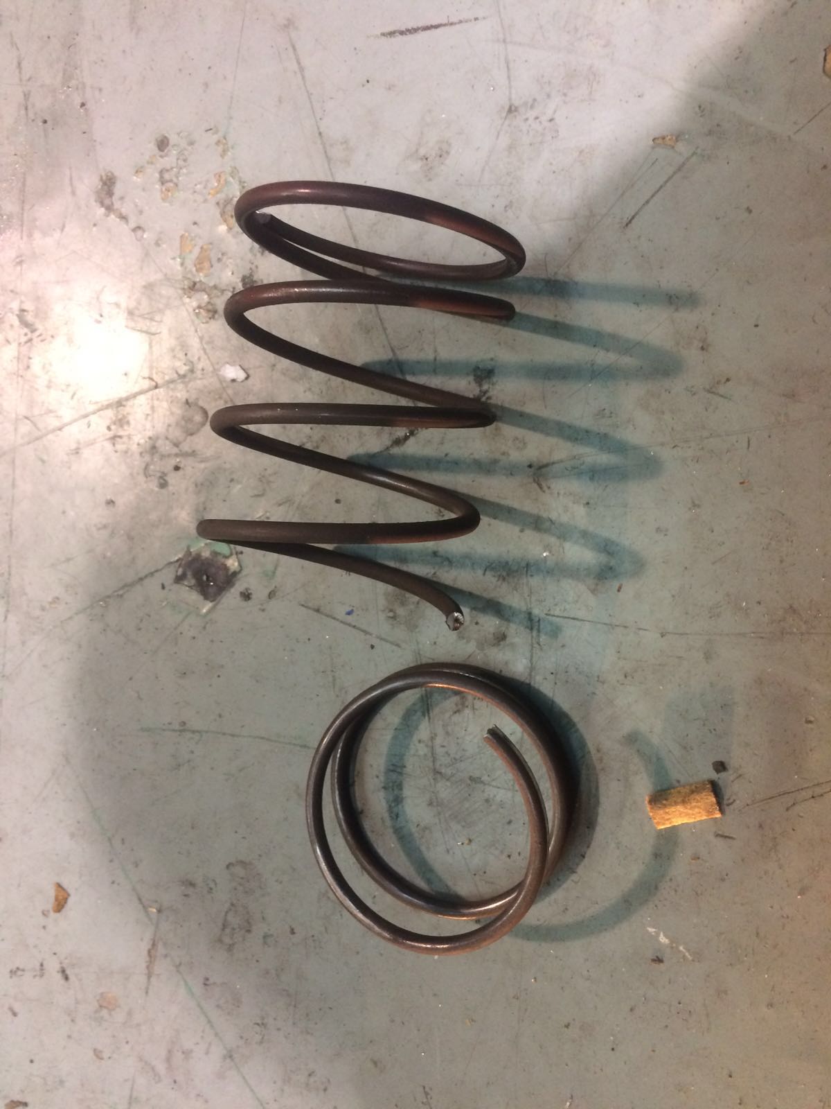

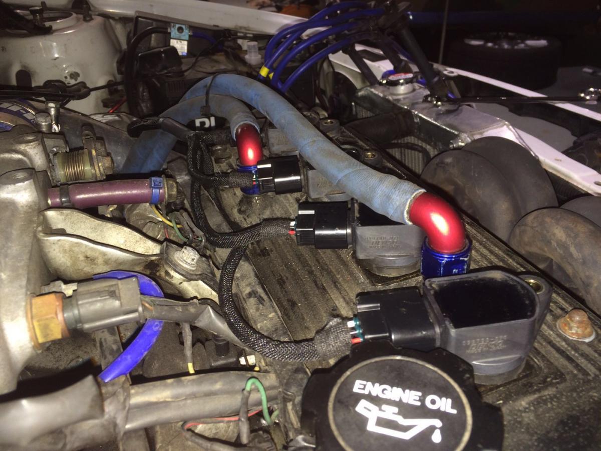

turbo-fever Posted May 29, 2016 Author Posted May 29, 2016 (edited) Finally picked the car up today have had some issues though. Firstly the rad I had bought off ebay from someone who said worked fine didn't fit and leaked when we did get it to fit was not impressed so had to use old one. Then we thought I needed a stiffer spring to get more boost turns out the spring had snapped as you can see lol. So the good news after fitting my billet td05 16g i had an EMUMASTER standalone ecu fitted with k20 coil plug conversion and nissan gtr throttle position senso. Using standard cam sensor. Managed to find another spring so could get it mapped to 1 bar making 248 at the wheels but when I get stiffer spring in few weeks going back up for more tweeks and 1.6 bar. Plus had rolling anti lag fitted which does help being td05 even though I get a full boost by 4300rpm which is quite good considering before the billet i didn't get full boost till 5000rpm. Launch control fitted aswell. Will upload some more pictures soon car needs a wash first. Got to recommend rrr engineering near peterborough cracking ECU much better alternative to the greddy emu and dastek Edited May 29, 2016 by turbo-fever Quote
