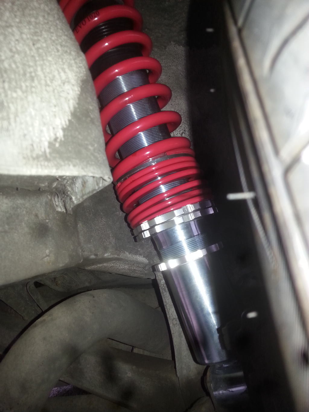

jamesh Posted August 1, 2015 Posted August 1, 2015 Just fited rear mk2 coilovers after following a post about them. The issue im having is they are to bouncy and i cant figure out how to change that. I have adjusted the springs and the bottom part but im still bouncing. Quote

5e colin Posted August 1, 2015 Posted August 1, 2015 shows a pic how there set polo is same weigh on the axel so thats not the isseu replied to your pm by the way Quote
5e colin Posted August 1, 2015 Posted August 1, 2015 ok i seen your pick your coils are wound aal the way down cant go any further and she is lying dead on the bumpstops ( had the same problem when i first did mine ) you need to cut the bumpstops down 1/2 to 3/4 Quote
5e colin Posted August 1, 2015 Posted August 1, 2015 (edited) your pic for ref, Edited August 1, 2015 by 5e colin Quote
jamesh Posted August 1, 2015 Author Posted August 1, 2015 So shall i leave the springs and bottom set like that and just cut the bumpstop? Quote
5e colin Posted August 1, 2015 Posted August 1, 2015 (edited) if your happy with that ridehight then yes leave at that . just shop then stops down , driver side is the 1 to set first its the heavy side on the left side thread will be lower then on driver side if you get me you can also use the bottom screw on bits to set hight but you might end up softerr and harder Edited August 1, 2015 by 5e colin Quote
jamesh Posted August 1, 2015 Author Posted August 1, 2015 Ok will cut them now and test again. Not really mate ?? Quote
5e colin Posted August 1, 2015 Posted August 1, 2015 im sorry i got my words mixed up there if the threads are not equal then softer and harder accurs using the bottom screw bits will have same strengt in coils Quote
