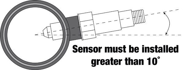

Arnold Posted August 21, 2015 Posted August 21, 2015 (edited) The tip needs to be lower than the wiring. See attached image Edited August 21, 2015 by Arnold Quote
5e colin Posted August 21, 2015 Posted August 21, 2015 whats the tech behind it is it liquid filled or something ????? Quote
karl. Posted August 21, 2015 Posted August 21, 2015 I think its to do with condensation Colin, from memory if its any lower the sensor will need replaced more frequently. Quote
