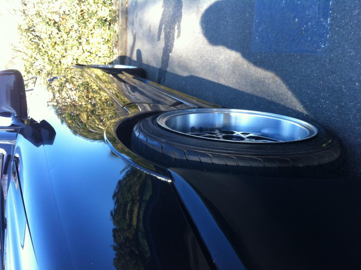

lew777 Posted August 31, 2015 Posted August 31, 2015 16x8 on the front with 10mm spacers to fill out live sports fenders. 16x7.5 on the back can't remember offset exactly but they was lower then et22 Quote

lew777 Posted September 1, 2015 Posted September 1, 2015 I had 16x8 et10 all round before they was to big rubbed all the time. Quote

lew777 Posted September 2, 2015 Posted September 2, 2015 I had the arches rolled and took out those little screws in the lip of the arch they where the main problem . Quote
