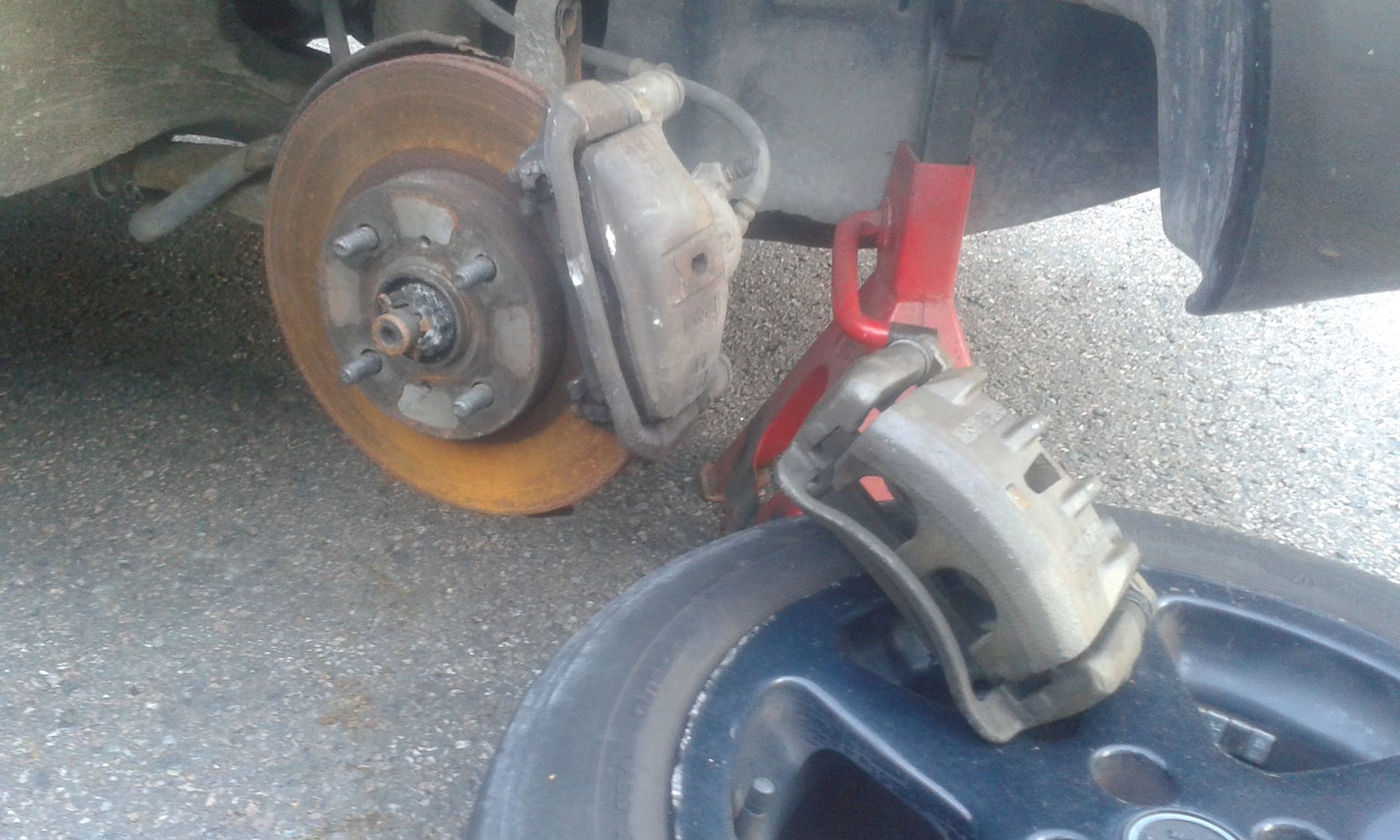

lukEp Posted September 16, 2015 Share Posted September 16, 2015 I've just been and measured the front disks on my paseo as the wheels are off and they are about 250mm. I'm I right in thinking they are bigger than my starlet SR disks? Think there 229mm none ABS info from Euro car parts. Quote Link to post Share on other sites

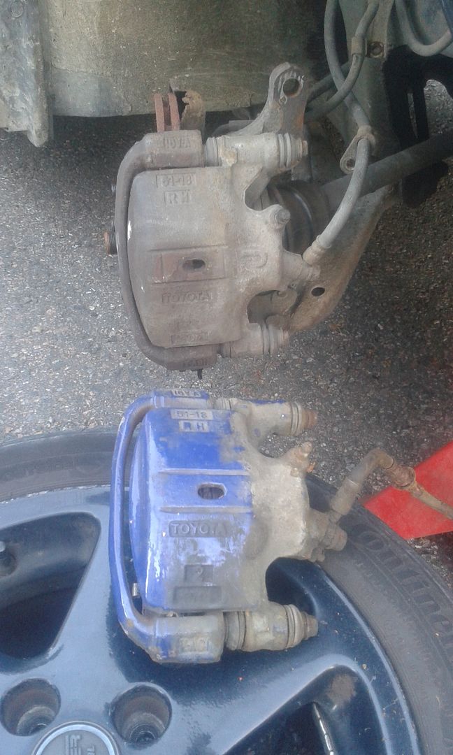

MR-2 Posted September 6, 2016 Share Posted September 6, 2016 I have 85-87 AE82 GT Corolla brakes and found that those are identical with -96 Paseo, thanks Toyota Quote Link to post Share on other sites

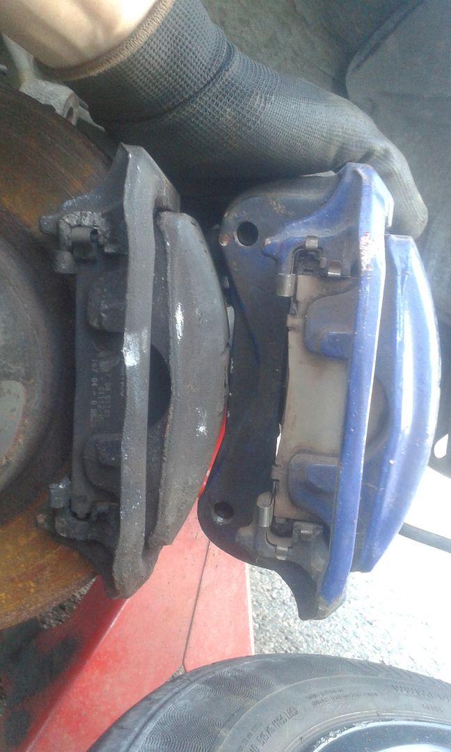

MR-2 Posted September 9, 2016 Share Posted September 9, 2016 My Paseo front disks are 245/18mm and single pistons are 51mm. And here is Levin AE111 Corolla 275mm and Gti AE82 Corolla 255mm disks. Not coming to this Paseo, gona use Levin brakes to my EP70... Quote Link to post Share on other sites
