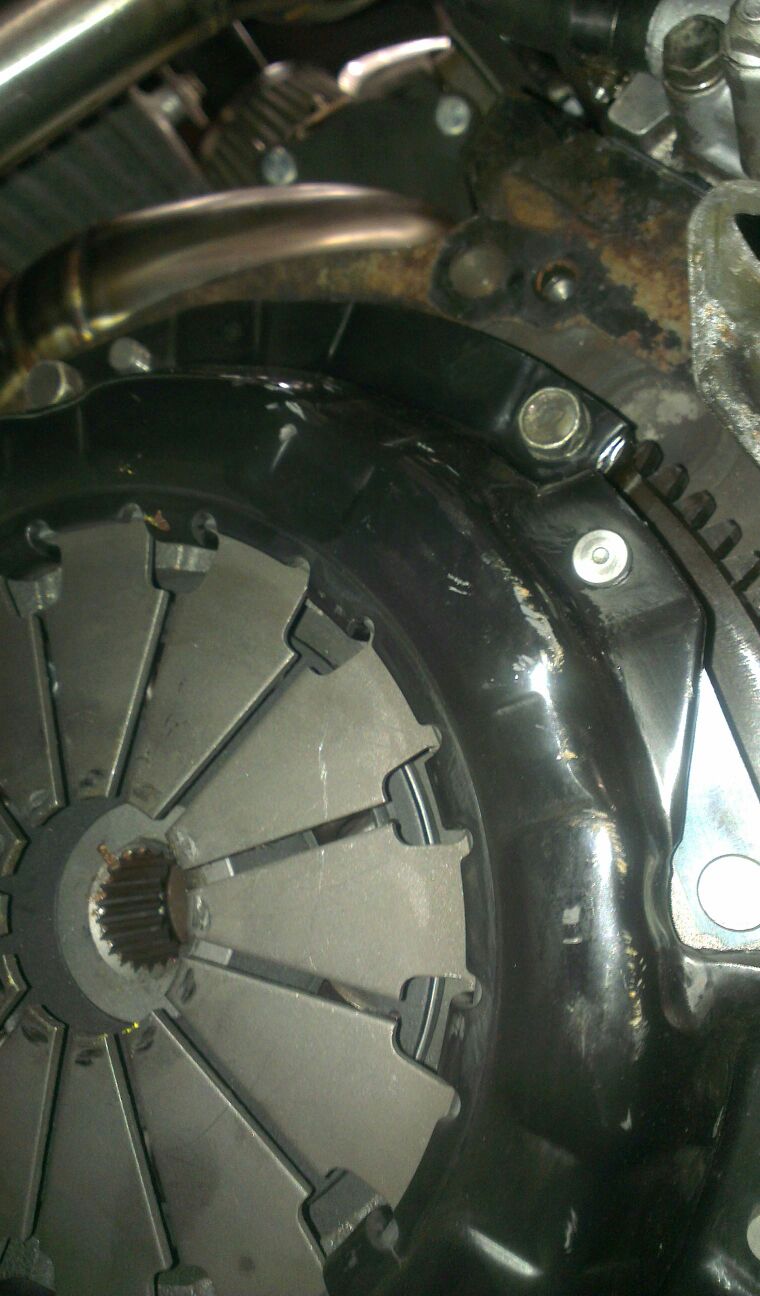

Andymcm Posted November 23, 2015 Posted November 23, 2015 I have a competition stage 4 clutch and flywheel kit and when fitted the clutch catches on the bell housing, what could the issue be ? See attached Quote
akyakapotter Posted November 23, 2015 Posted November 23, 2015 need to grind the bell housing i believe mine done the same Quote

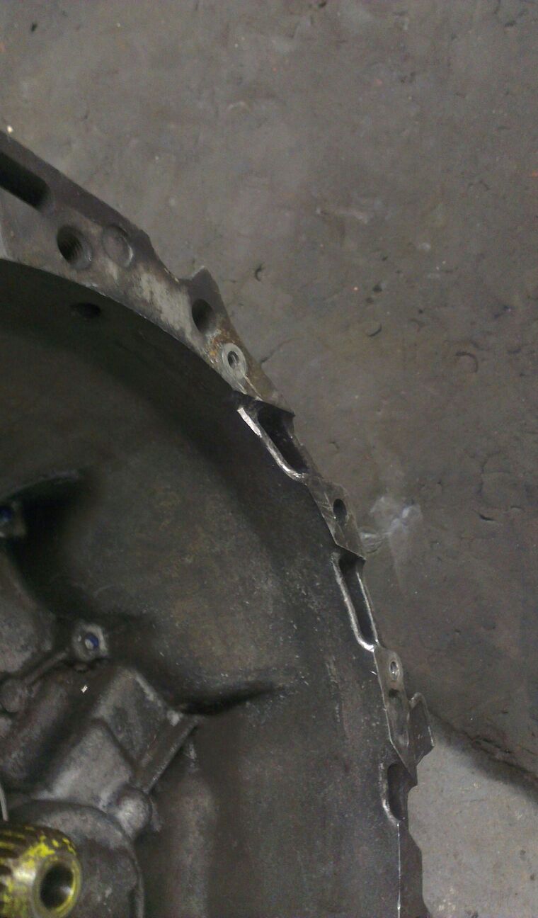

fordie_glanzaV Posted November 25, 2015 Posted November 25, 2015 This is what my issue is... gearbox off on weekend and some quality time with the grinder lol Quote
Ollieh17 Posted November 25, 2015 Posted November 25, 2015 Not that much, just make sure you do enough the first time! Quote
fordie_glanzaV Posted November 25, 2015 Posted November 25, 2015 Yeh i will dont worry... Box aint coming off again!! Cheers again.. Quote
