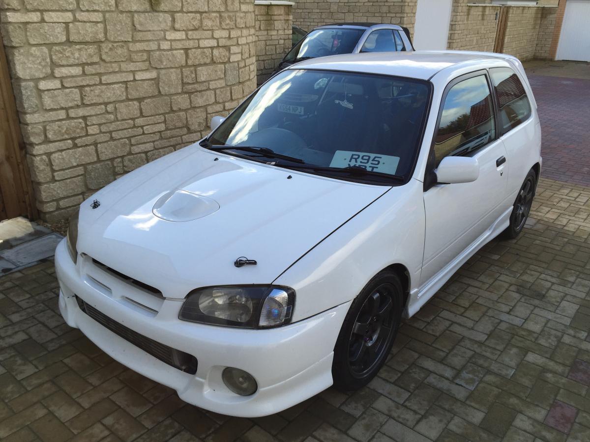

Dan507 Posted December 7, 2015 Posted December 7, 2015 Hey guys, i'm sure most of the older members know me, but if not here is a background, http://www.ukstarletowners.com/topic/29716-dan507s-red-glanza-s/Red Glanza S, which i sold a few years back to Matt heard, who sold it to my Girlfriend, Meganhttp://www.ukstarletowners.com/topic/71174-dan507s-white-glanza-v/Old white Glanza, sold that in june 2014 to charlie, who is turning it into a crazy monsterhttp://www.ukstarletowners.com/topic/47616-dan507s-mazdaspeed-rx8/An Lastly, My track RX8http://www.driftworks.com/forum/drift-car-projects-builds/240054-dan507s-streetcar-s14-thread.htmlAnd lastly, My s14'shttp://www.driftworks.com/forum/drift-car-projects-builds/240054-dan507s-streetcar-s14-thread.htmlSo, i bought this Glanza a few weeks back. It was pretty cheap so it's a bit hanging compared to my last glanza's but i'm going to slowing make it better and look less boring. here are a photo, i only have one lol Quote
Dan507 Posted December 7, 2015 Author Posted December 7, 2015 (edited) Spec is WEPR TD04 kitTial EX/WG and screamerjperfomace FMICTD ignition kitblitz catbackWalbo 255gizzmo boost controllerebay filterdastek piggy back ecuinovite wheelstoyo t1r'sWMS 4 pottein lowering springspanhard rodbraided linesyellow stuff front padsreacro bucketsluke harnessesomp wheelI only had the car for 3 days before the engine decided to let go, so it's off the road already. lolstill waiting to strip the engine down, i'll either rebuild and go forged or get a second hand forged lump, got my eye on one already. Other plans, coilovers,cagedecent 15's Edited December 7, 2015 by Dan507 Quote
Gainzy Posted December 7, 2015 Posted December 7, 2015 Gizzmo killed it I reckon pushed 20 bar boost through..looks nice fibreglass bonnet? Needs more Jam parts ;) Quote
Dan507 Posted December 7, 2015 Author Posted December 7, 2015 (edited) Gizzmo's are horrible, hate them with a passion. Luckly i have a spare greedy pro fec bi do have a JAM splitter which i need to repairand metal bonnet, it doesn't have the standard bonnet catch Edited December 7, 2015 by Dan507 Quote

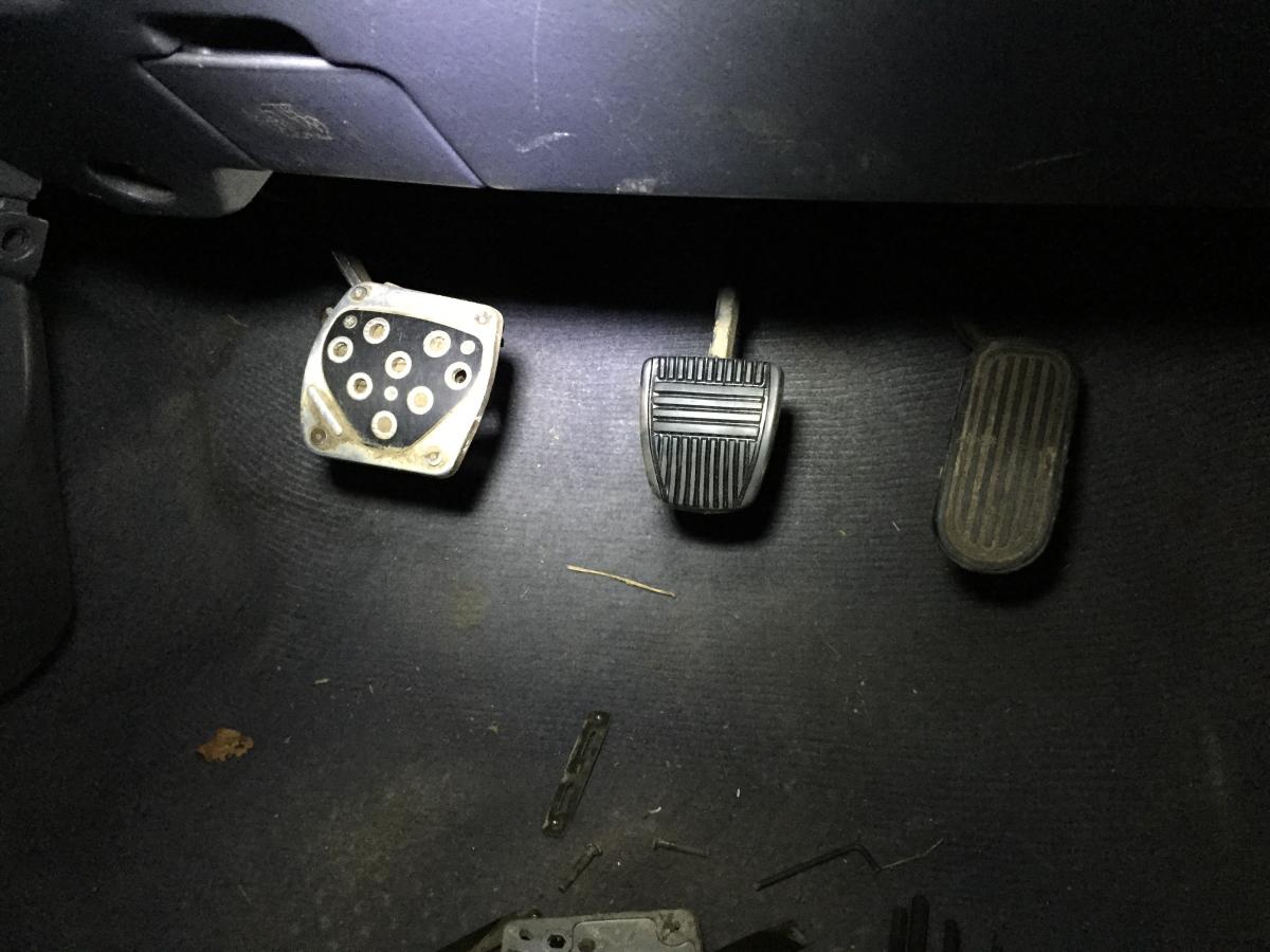

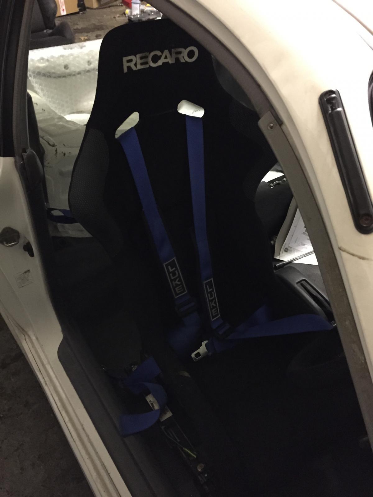

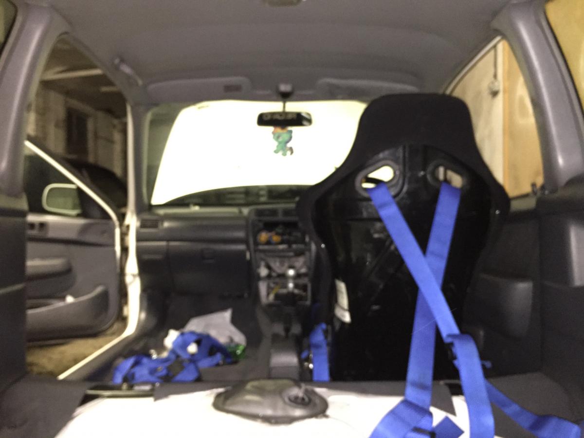

Dan507 Posted December 15, 2015 Author Posted December 15, 2015 Not really much to update, done a few personal touches to the car, got rid of the horrible metal pedals and replaced them with some rubber onesremoved the Evo recaros, and replaced them with my fixed recaro SPG's from my RX8, still trying to find a passenger rail. might have to settle for a standard passenger seat for now. Also sorted out the harnesses, before they where attached to the c-pillar brace lol. i'm going to stripping down the engine over the christmas holidays as my work shuts down for 2 weeks. Quote
Gainzy Posted December 15, 2015 Posted December 15, 2015 Haha c pillar power! Nice seat that one of my fave's cage time I reckon ;) Quote

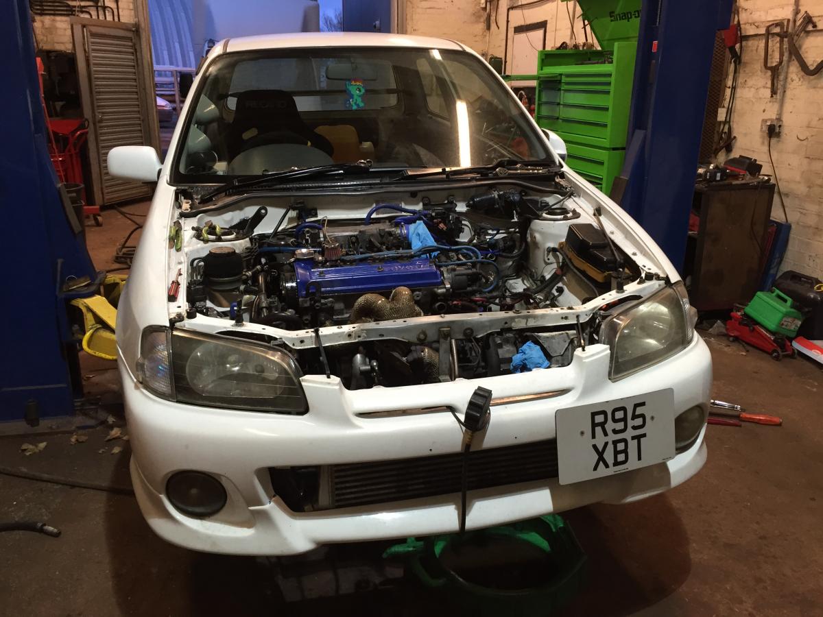

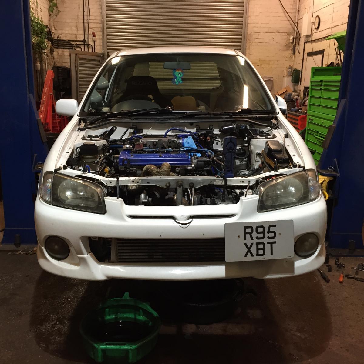

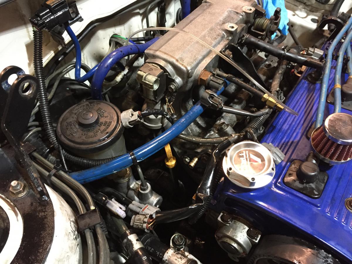

Dan507 Posted December 18, 2015 Author Posted December 18, 2015 Started on the engine this afternoon. done a few tests and the car had low oil pressure when its warm. it's also pissing oil out of it left right and centre. front and rear crank and driveshaft seals. i've taken the sump of to fines lots of swarf. In cylinder one the rod has so much play in it you can move it with your hand and the shells are completely ruined. Looks like a complete rebuild. unsure what to do at the minute. i'm in two minds in either i keep the car. whether to rebuild and sell or go to town and forge it. Engine ready to come out in the morning. hoping to have the engine apart by the afternoon and see what condition the block and crank is in. Quote

Dan507 Posted December 27, 2015 Author Posted December 27, 2015 So, engine is stripped down! The shell had welded it's sled to the conrod lol. I've decided I'm going to forge it. And I will end up getting the forged ft from TD haven't ordered t yet because I'm not sure what size Pistons and shells I'm going to need. Crank has been replaced with a better one, still needs a slight reground and polish but it's mines better than my other one. I've ordered lots of parts from ID WORKZ In this Boxing Day sale so more goodies coming soon. Quote
