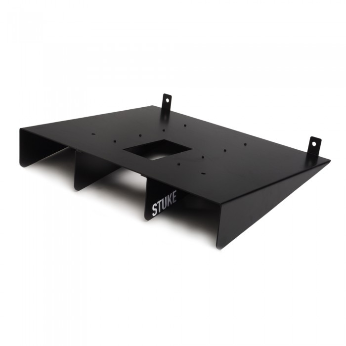

starletezy Posted January 13, 2016 Posted January 13, 2016 Does anyone know if the stuke rear diffuser and front splitter really work as aero or are they made more for looks and style Quote
Whitenoize Posted January 13, 2016 Posted January 13, 2016 Just looks mate they need to bolt up to the chassis for aero I think the stuke stuff is more of just a bumper lip ? Quote
starletezy Posted January 13, 2016 Author Posted January 13, 2016 Just looks mate they need to bolt up to the chassis for aero I think the stuke stuff is more of just a bumper lip ? This is the rear diffuser it bolts to the chassis in the description apparently it does provide aero dynamic stability but there's no way of telling looks like it would do the job would be great saves me from getting one made up Quote

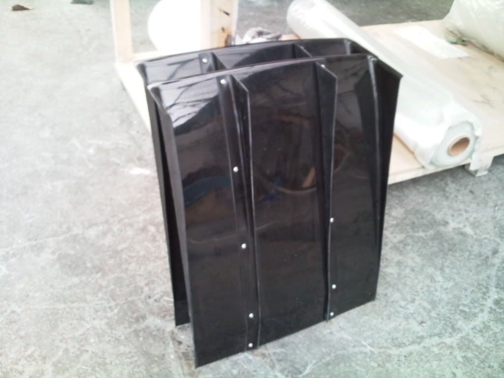

starletezy Posted January 13, 2016 Author Posted January 13, 2016 there's also larger fibber glass ones Quote
TimD Posted January 13, 2016 Posted January 13, 2016 For a diffuser to work effectively you really need a flat floor, so air which is forced under the splitter travels cleanly to the diffuser. Quote
starletezy Posted January 13, 2016 Author Posted January 13, 2016 For a diffuser to work effectively you really need a flat floor, so air which is forced under the splitter travels cleanly to the diffuser. Yeah I know that mate the starlet floor is pretty much flat if not will be getting floor pans made out of sheet metal Quote
