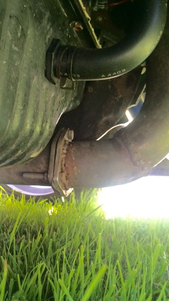

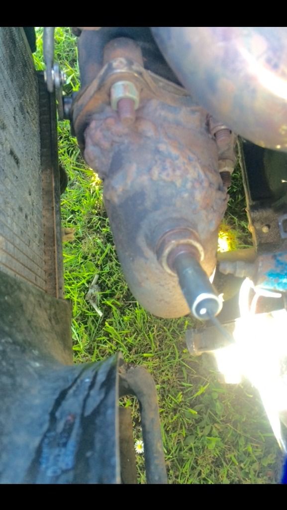

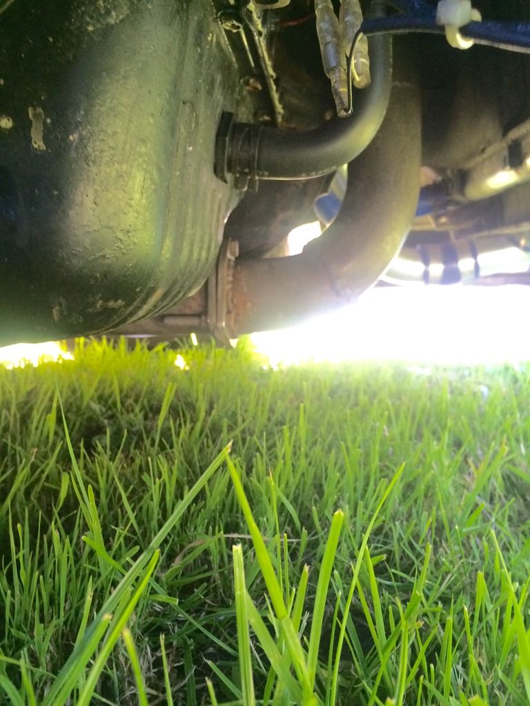

patman Posted January 13, 2016 Author Posted January 13, 2016 (edited) Yes mate I shall definitely get some ramps sorted very soon, this decat I got on at the moment isn't braced, I have a braced one to go on, and another powerflow exhaust to go on but it's gonna have to be at the end of the month when I get payed, the exhaust and decat I got on at the moment is an absolute disgrace what the person before me did to it.This is why I can't put my brace decat on at the moment mate pics blow, until I get the powerflow exhaust fitted what I brought of ryanep82 on here but as it stands at the moment mate it's shocking. Edited January 13, 2016 by patman Quote
