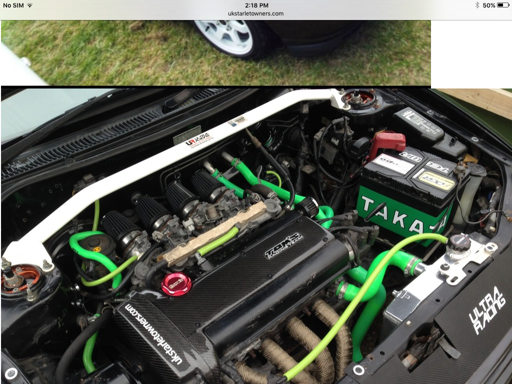

Sparkythestarlet Posted February 2, 2016 Author Posted February 2, 2016 All sounds very interesting would it possible to put this sorta thing on a n/a I know it's a different engine in the pic I'm just wondering Quote
Sparkythestarlet Posted February 3, 2016 Author Posted February 3, 2016 yeah mate lovely car and enigne by the way Quote
gorganl2000 Posted February 3, 2016 Posted February 3, 2016 the 4age 16/20 valve transplant into the ep chassis has been very popular over the years...and i think stock its about 150/160bhp it seems to be one of the "easier" conversions to undertake i know its very popular for rally cars too Quote
