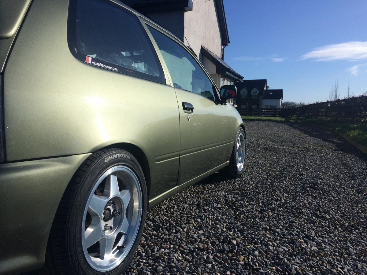

SpikeyJp_68 Posted February 18, 2016 Posted February 18, 2016 (edited) I've 7J et25 on mine. Had to roll the rear a good bit for even them to fit. I'd imagine that size on the rear would be way too wide Edited February 18, 2016 by SpikeyJp_68 Quote
Phil Posted February 18, 2016 Posted February 18, 2016 I've 7J et25 on mine. Had to roll the rear a good bit for even them to fit. I'd imagine that size on the rear would be way too wide image.jpegI think that's rather nice Phil Quote
SpikeyJp_68 Posted February 18, 2016 Posted February 18, 2016 I think that's rather nice PhilCheers mate, lot more pics on my build thread Quote
