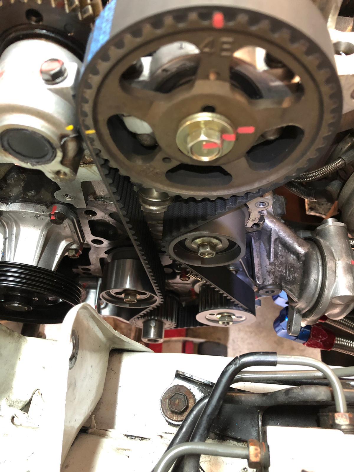

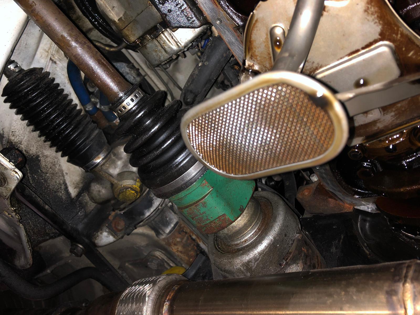

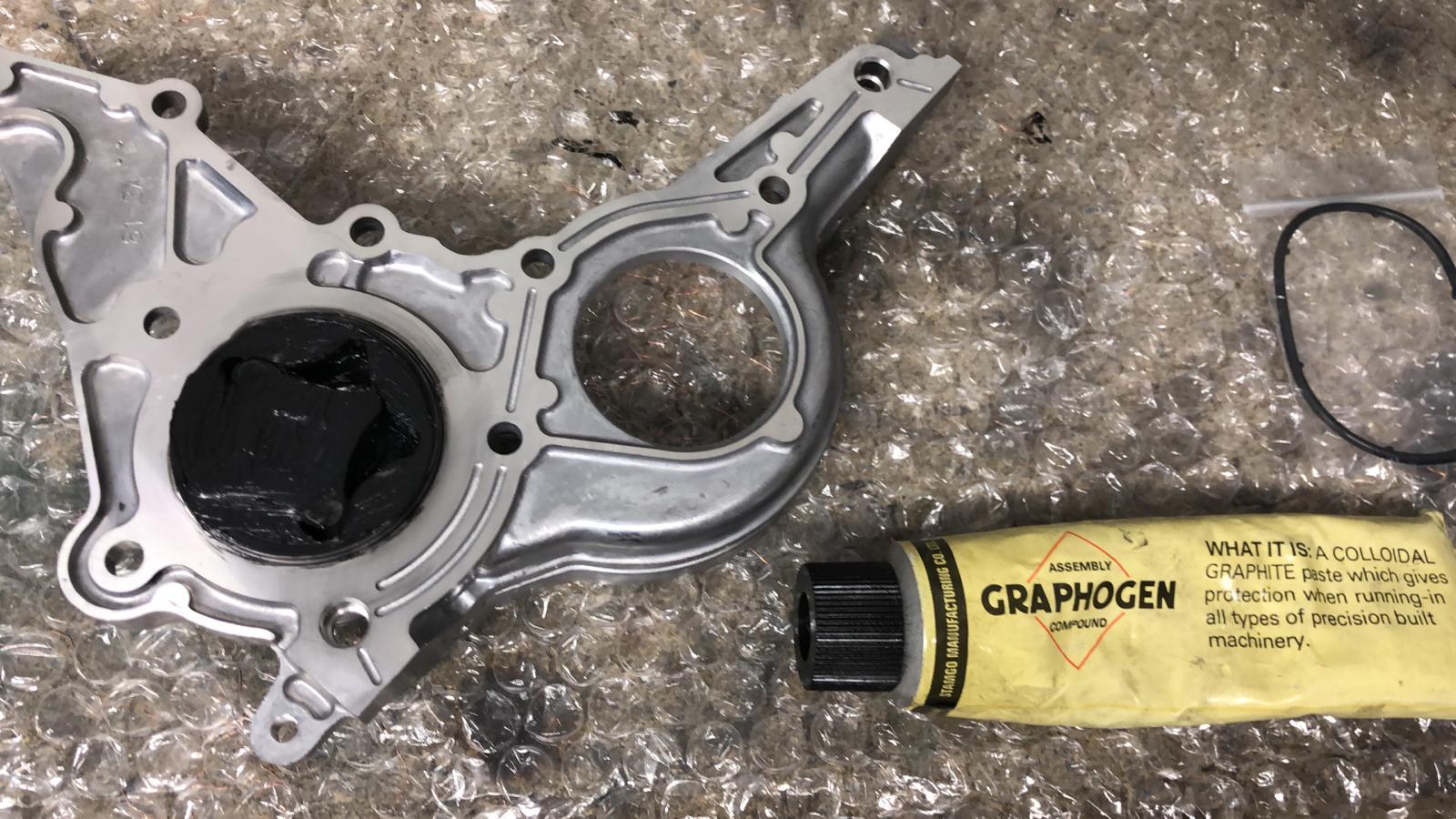

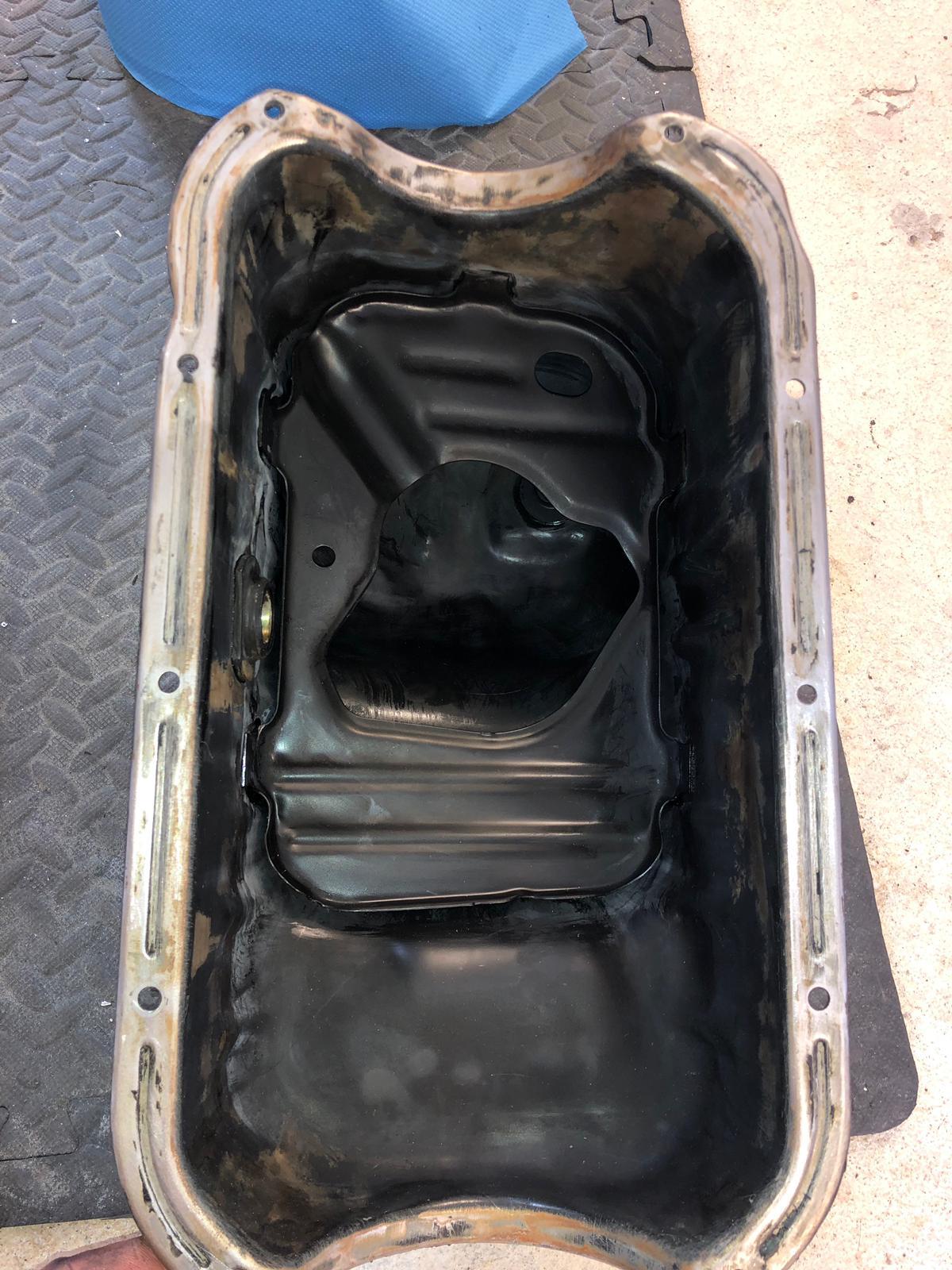

Few more updates - Ever since I bought it was leaving big blobs of oil on the drive so my mate stripped it all and so far we have replaced OEM oil pump - old one was severely worn Timing belt and tensioners and water pump Crankshaft seal, Camshaft bung, Rear main seal, distributor o ring seal, rocker cover gasket, basically any seal we've replaced, ORC Ogura is going in it soon with miller's gearbox oil Also bought a carbon spoiler from Fiske which should look good And relocated the battery
