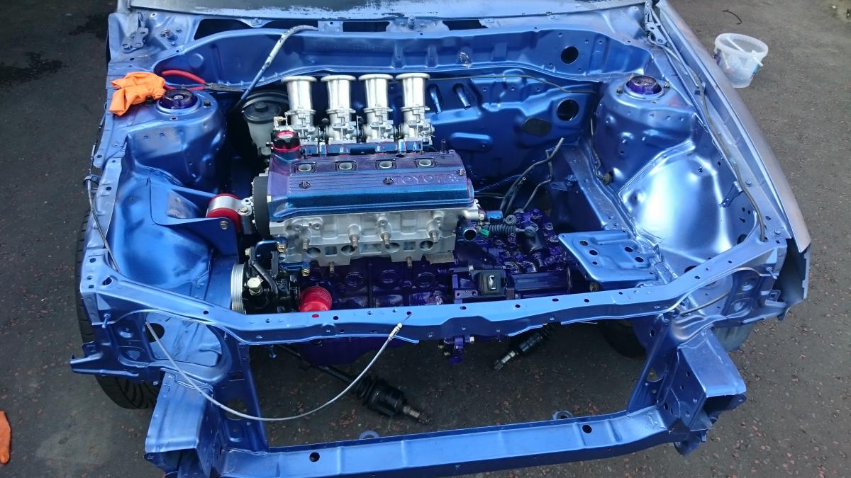

richardc9052 Posted May 7, 2016 Posted May 7, 2016 Use triumph tt600. Cut a standard Mani Down and connect the two using reinforced silicone joiners. Make a throttle cable bracket, make a bracket to hold the itbs, use thin tin plate to fit the Toyota tps to the triumph itbs. Quote

iano21 Posted May 17, 2016 Author Posted May 17, 2016 well got a set of tt600 throttle bodies for good value so going to give them a try. . just wondering what runner lengths people are using?? or trial and error ha thanx Quote
richardc9052 Posted May 17, 2016 Posted May 17, 2016 I used the calculator on the jenvey sight. You need 300mm from head to inlet side of throttle body. That will give you top 3rd of 7krpm. 350mm gives you mid to top end, 400 gives mid, 450 bottom to mid, 500 bottom. With the space in the bay you will probably end up 400 max. I went with 330mm but I did plan on fitting trumpets to bring that closer to 400. Never got round to it. 330 didn't bring the power band low enough for me so I'd definitely try to go as long as you can fit. Quote
