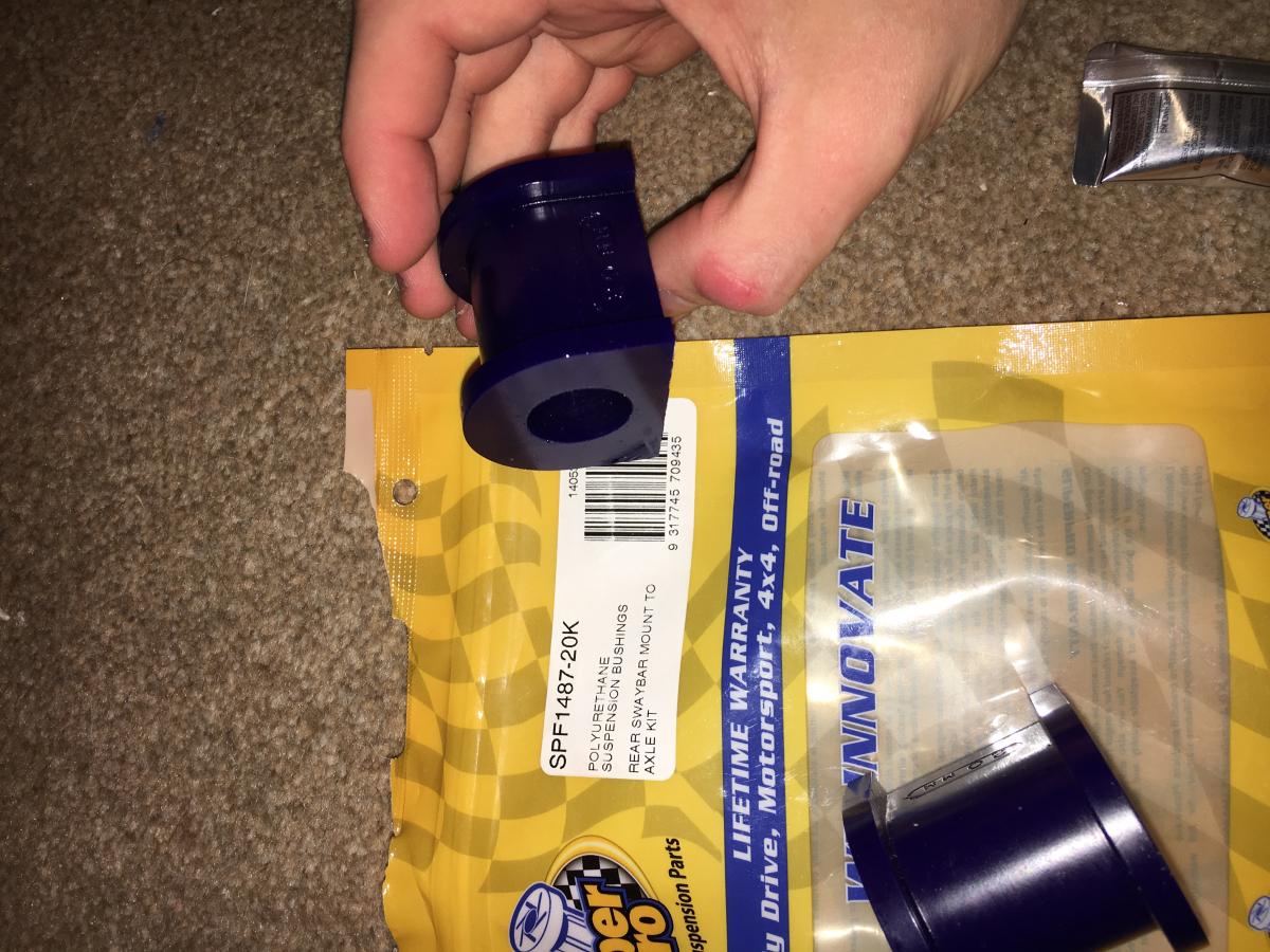

SpikeyJp_68 Posted July 16, 2016 Author Posted July 16, 2016 (edited) It will be personal preference for a lot of it. Front arb, first off i had mine poly bushed, tried a whiteline 24mm and didnt like how it drove so swapped back to the oem bar with polybushes. Rear arb i didnt really notice but i fitted mine after i had already fitted my coilovers so probably isnt working as hard as it would with shocks and springs. (Most people rant and rave about the improvement from a rarb)If you havent already i would get an anti lift kit, i found that made the car much more positive and direct.I might concider a rarb after the coilovers and do it bit by bit until I'm happy. No point buying a rarb if it handles the way I want with coilovers. I had a look at my pollybushes now and then googled an anti-lift kit and noticed the bushes look the same (remember buying wishbone bushes now) can you buy the metal brackets separately ?pics below as my membership had expired Edited July 16, 2016 by SpikeyJp_68 Quote
SpikeyJp_68 Posted July 16, 2016 Author Posted July 16, 2016 Membership renewed, no problems you'll be glad to hear Here's a picture of the bushes I've bought. The others I have are for the arb Quote
morgey Posted July 16, 2016 Posted July 16, 2016 Not sure if you can get them separately but any bit of plate with 2 holes in it would do lol.The other thing the ALK is repositions the rear of wishbone slightly further out, not sure what affect that has though? Quote
richardc9052 Posted July 16, 2016 Posted July 16, 2016 Not sure if you can get them separately but any bit of plate with 2 holes in it would do lol.The other thing the ALK is repositions the rear of wishbone slightly further out, not sure what affect that has though?It pushes the balljoint further forward giving even more castor. Quote
morgey Posted July 16, 2016 Posted July 16, 2016 It pushes the balljoint further forward giving even more castor.Top man, knew it served a purpose but couldn't think what. Quote
SpikeyJp_68 Posted July 16, 2016 Author Posted July 16, 2016 Cheers lads, will fab my own brackets in that case. Am I right in saying the castor determines how quickly the wheel centers it's self after a bend ? Quote
richardc9052 Posted July 17, 2016 Posted July 17, 2016 It allows you to run less camber as the increased castor cc auses camber when turning Quote
SpikeyJp_68 Posted July 17, 2016 Author Posted July 17, 2016 It allows you to run less camber as the increased castor cc auses camber when turningMeaning the tyre is in full contact with the road when turning ? Quote
richardc9052 Posted July 17, 2016 Posted July 17, 2016 Meaning you can maintain more contact in a straight line as well as in a corner. Usually without castor you have to add more negative camber to achieve the same level when in a bend which then decreases grip in a straight line. Have a google and watch a few vids on youtube. There are some very interesting pieces. Quote
SpikeyJp_68 Posted July 17, 2016 Author Posted July 17, 2016 Meaning you can maintain more contact in a straight line as well as in a corner. Usually without castor you have to add more negative camber to achieve the same level when in a bend which then decreases grip in a straight line. Have a google and watch a few vids on youtube. There are some very interesting pieces.Ah yes I get you now, it's the best of both worlds Quote
5e colin Posted July 17, 2016 Posted July 17, 2016 you will need the off center bushed to ad caster the plate on its own wont work with normal pollys Quote
SpikeyJp_68 Posted July 17, 2016 Author Posted July 17, 2016 you will need the off center bushed to ad caster the plate on its own wont work with normal pollys Will get a pic of the bush later. The hole looks to be off centre. Quote
