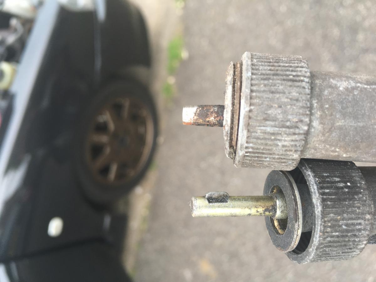

Any one experienced there speedo being incorrect, showing 40mph on the dial but actually going 30mph... showing 85 but actually going 70.... obviously not in kph. Surely it can't be the dails or needle being moved as it'd stay 10mph out all the time if that was the case?
On an auto box

My speedo was out for ages then gave up all together, turns out where someone had had the speedo drive off before and damaged the connection to the box, being cable tied on it slowly wore it away, swapped a new cable on a solved the issue, this was a manual box tho

This won't help my situation unfortunately as the difference increases the faster you go... if it was out by how you say then it would still be 10mph out at 70 odd rather than 15/20mph.

Starlets speedo drive is mechanical. so the difference will be more the faster you go but not by much. Do the correction for 40 and then check with GPS at 30 and 70 which are the most common speed limits. At least you'll know what the errors will be. Also by readjusting the needle position on the speedo, the spring tension will change. So the errors may be even less.
They are usually a percentage out. My corolla is 10% out, 33mph speedo is 30 and 100 is actually only 90.
Other than swapping dials for a different set i dont know any way to fix it. Bar changing wheel/tyre size
I understand that they'll be out but mine is as much as 25%. My other 4paw running the same wheels 50/15 was about 10% out like you say morgey which is fine. I have another set of dials but the car im having issues with is auto and I have manual dials, do you know if I could still used them to test with?
