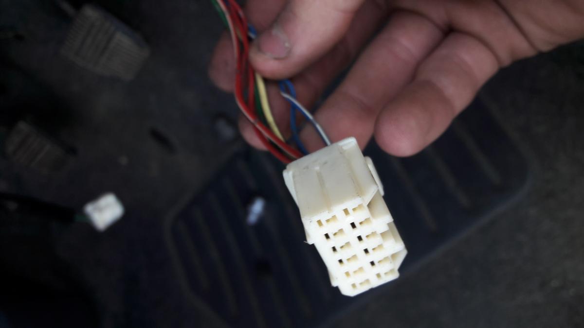

SpikeyJp_68 Posted March 25, 2017 Posted March 25, 2017 Im doing a turbo conversion om my 98 n/a and the fuel pump isnt coming on when switched to ignition. Checked all fuses and still nothing. I have a suspision it may be to do with the plug shown below. Its just to the rhs of the accelerator and i cant seem to find where it plugs in ? Any help appriciated as im shit with electrics Quote
SpikeyJp_68 Posted March 25, 2017 Author Posted March 25, 2017 I should also mention i have changed the engine, dash and loom that goes to the fuel pump and changed the fuel pump to a glanza one. All bits off the same 98 glanza Quote

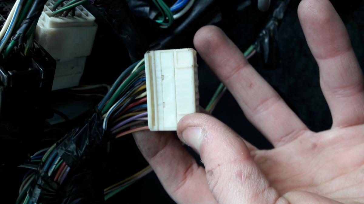

SpikeyJp_68 Posted March 26, 2017 Author Posted March 26, 2017 Okay so i think ive found the problem. The plug in the previous pic is for the abs controll module ive been told. There is also a plug coming off the rear loom that looks to carry the live for the pump (blue with a white tracer). This is down by the acceleratorI tried mocking it up on the old na dash and rear loom but the same plug is still redundant ? If anyone could tell me where this plug goes im hoping that should solve my problem. Any other help is greatly appriciated Quote
5e colin Posted March 26, 2017 Posted March 26, 2017 the bleu and white wire is for the pump in my gtt its behind the kick panel but my plug is more square not really helpful today am i ha ha Quote
SpikeyJp_68 Posted March 26, 2017 Author Posted March 26, 2017 the bleu and white wire is for the pump in my gtt its behind the kick panel but my plug is more square not really helpful today am i ha ha Ill let you off this time Colin hahaha.It looks like the ABS controll module links the 2 plugs ?? My car hasnt got abs but the loom has all the plugs for it Quote

SpikeyJp_68 Posted March 27, 2017 Author Posted March 27, 2017 (edited) Ive bridged b and fp in the diagnostic ports and it pumps when switched to ignitionThe 2 plugs have been plugged into the abs unit Edited March 27, 2017 by SpikeyJp_68 Quote
