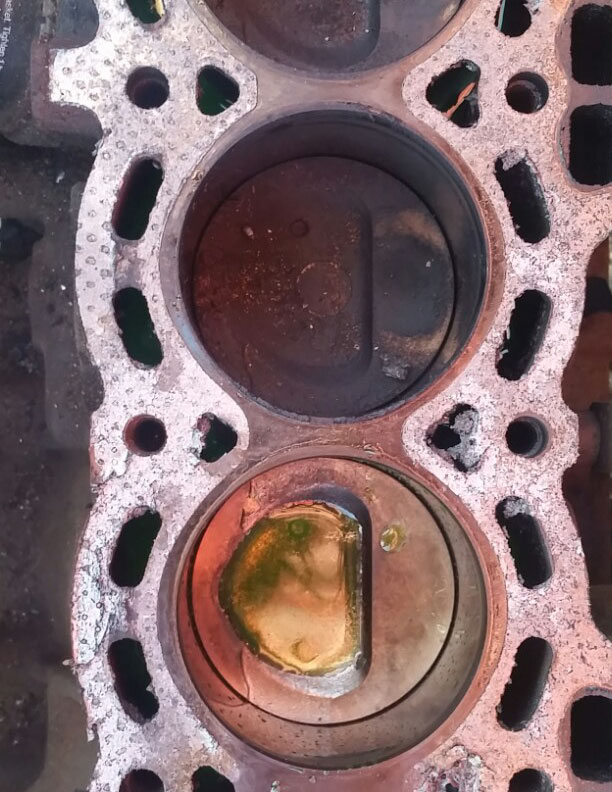

Ok, I got down to the block at last. This was a serious lesson in bolt removal, quite a few techniques employed, thankfully no welding. So the head is off now and the block exposed, see the photos attached. You can see the coolant in the chambers clearly, lots of gunk all over the show, but what other things can I read from this? Need to put a straight edge on the block and if that's ok, I guess I can crack on with grinding down the surface of the head, clean everything up, new gasket, and put it all back together? What about the pistons, do they need to come off for anything? Can I grind with them in? What would you do now?
Cool, well it's bound to have coolant in it, you've just removed the head.
be sure to smear oil in the bores to stop rust from forming.
What do you mean by grind? It's a specialist job to have the head skimmed.
I doubt the block is warped, but a straight edge will help with that.
You'll want to remove all of the valves and be prepared to lap them back in. Collets should go with the collets they came with. Same with buckets and shims. The cam caps also need to be reseated where they came from.
If you're unsure, then I'm sure an engine firm will sort this all out, at an added charge.
Get the head skimmed, clean up the block and fit a new head gasket.
Nothing looks too out of the ordinary, just old and crusty, but not broken beyond repair.

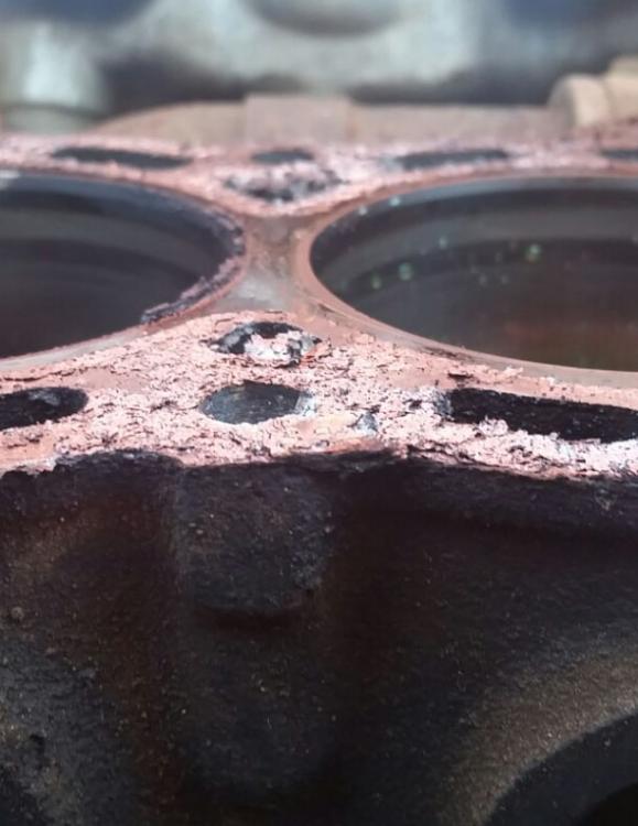

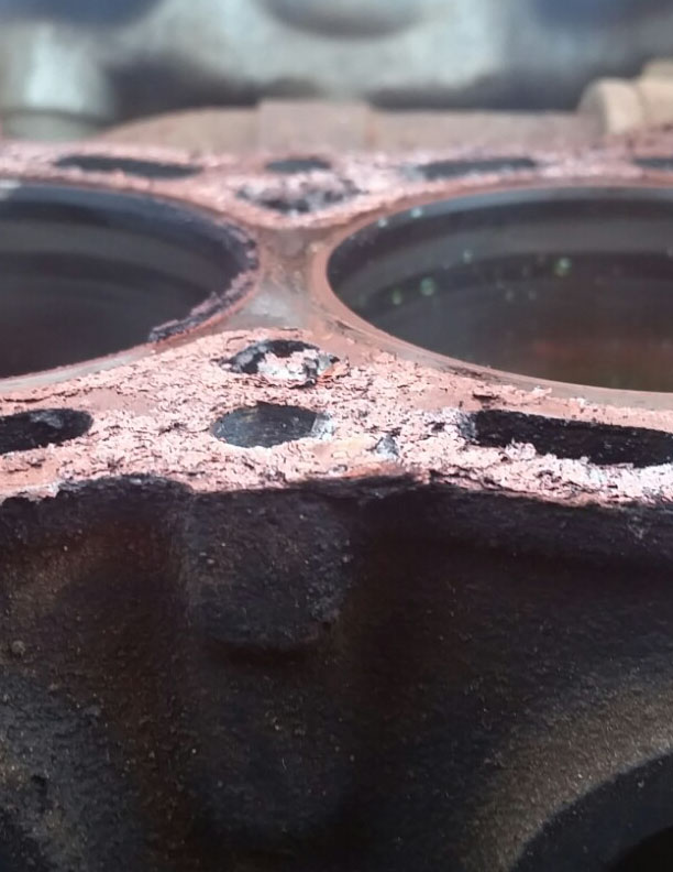

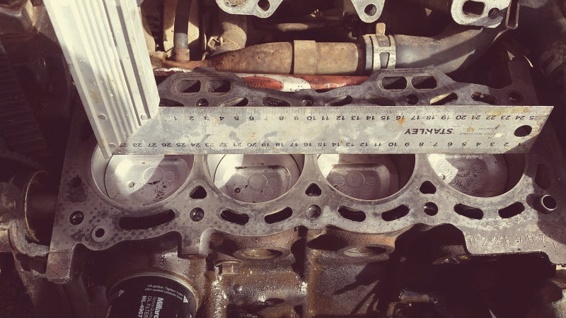

I've cleaned up the block, see the pic below. Looks like between cylinder 2 and 3, where the 16th cm is on the ruler, it's lower there than anywhere else and so there's a gap. Does this mean the block is warped and I can't do anything about it? Or will the head gasket expand to fill that space? Also, does that look clean enough, or do I need to go further?

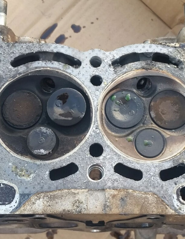

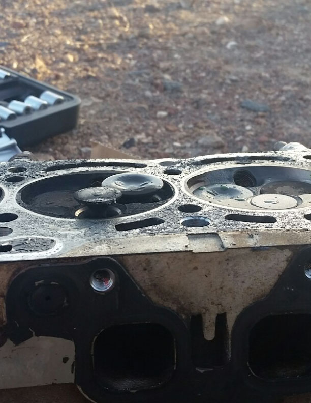

Bought a feeler gauge at last, helpful tool! The block seems fine after all, I couldn't get a 0.05mm feeler under a straight edge, so I guess that's ok. However, I've now gone to clean up the head and take a look there. I've checked with a straight edge there and it's about 0.10mm between cylinders, so likely this will need to be ground down. Whilst cleaning though, I've noticed a pretty gaping flaw in the head which can't possibly be from the factory like this. If you see the attached photos, one without the gasket, one with the gasket over it so you can see how the gasket warped, and then a wide shot to see the whole head. Looks like some of the head melted in that top left coolant hole. This can't be a good thing, it looks horrendous. Or maybe this is ok? What do you reckon? Time to give in and admit defeat?
