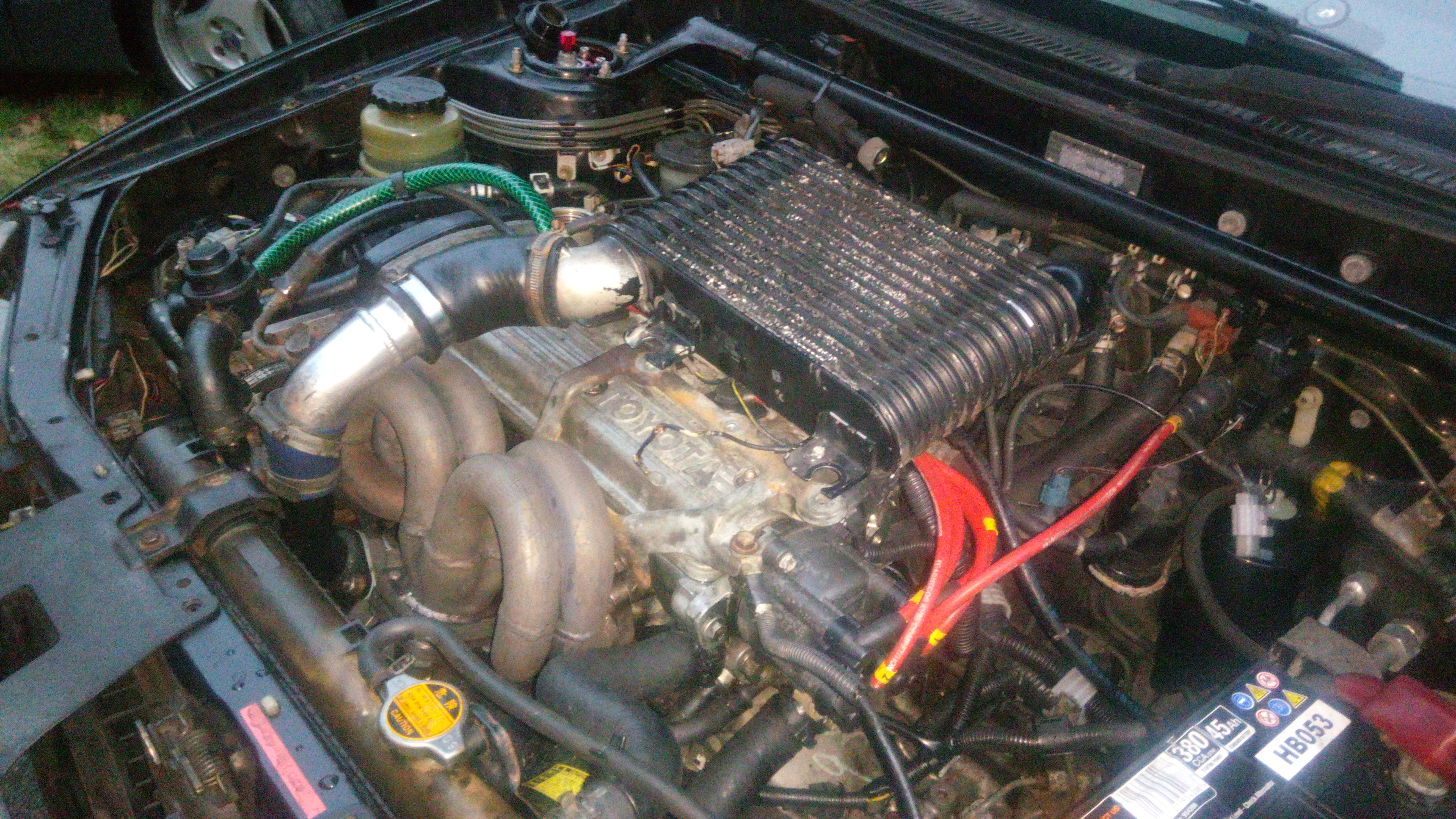

Shyam Posted February 18, 2018 Share Posted February 18, 2018 Good evening people, So i spend this weekend fitting my hybrid turbo, manifold and downpipe. I'm having to run my intercooler hotpipe like 1.5 inch away from manifold with it having ramhorn geometry. Is this bad for the engine? I'm assuming it will effect performance?? Thanks Quote Link to post Share on other sites
gorganl2000 Posted February 19, 2018 Share Posted February 19, 2018 can you may be wrap the inter-cooler pipe with heat reflective material? Quote Link to post Share on other sites
Shyam Posted February 19, 2018 Author Share Posted February 19, 2018 2 hours ago, gorganl2000 said: can you may be wrap the inter-cooler pipe with heat reflective material? Yeah I'm going to do that. I also won't be using a hose pipe, that was just short term to draft up one length I need and so I can move it around lol. Quote Link to post Share on other sites
5T4R7ET N/A Posted February 19, 2018 Share Posted February 19, 2018 Ideally a front mount is what you want. The top mounts a prone to heat soak because of the location of them. Quote Link to post Share on other sites
Shyam Posted February 19, 2018 Author Share Posted February 19, 2018 3 hours ago, 5T4R7ET N/A said: Ideally a front mount is what you want. The top mounts a prone to heat soak because of the location of them. Yeah I get that heat rises and it soaks into the intercooler. My concern is that my hotpipe goes directly up and over my ramhorn manifold. As a result, the air being accelerated from the turbo into the intercooler is going to be warmer than with the stock arrangement. Would that be an issue? Or will the intercooler cooling will be sufficient enough to cool it down enough before the air enters the engine? Quote Link to post Share on other sites
maddox710 Posted February 20, 2018 Share Posted February 20, 2018 Stock tmic isn't really good enough for the stock ct9 mate I'd get a rx7 tmic they'e loads bbetter Quote Link to post Share on other sites

Shyam Posted February 21, 2018 Author Share Posted February 21, 2018 (edited) 17 hours ago, maddox710 said: Stock tmic isn't really good enough for the stock ct9 mate I'd get a rx7 tmic they'e loads bbetter Ah right, it's not even stock no more mate...CT9 hybrid built by Liam at Midland Turbos. I suppose I'm definitely going to need better cooling then... 16 hours ago, Walker96 said: Have my rx7 tmic still if you still want it..... Really want it pal but I've had an offer accepted on a house since we spoke about it and my missis aint letting me spend any money on car parts! Another reason I'm using hose pipe! if you can do anything with the price on a one time offer then hit me up with a PM buddy, I'll see what I can do. Like I said, I can collect with cash on collection. Edited February 21, 2018 by Shyam Quote Link to post Share on other sites
