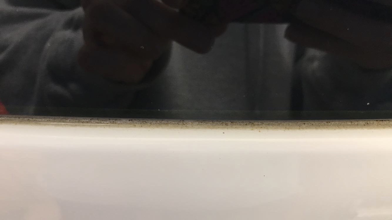

iamkierram Posted April 1, 2018 Posted April 1, 2018 I’ve tried so many things to get rid of the stubborn stuck on grime that sits around the edge of the rear window on the paint. I’ve had cotton buds and polishing compound on there but with no success, I’ve heard citrus cleaners are good but I don’t know what to get. Does anyone have any ideas on how to get rid of this? Quote
maddox710 Posted April 1, 2018 Posted April 1, 2018 Will need wet sand from 1000wet dry down too 2000. But being on a curved part of the panel you may hot spot the paint so be very careful, has the car/panel ever been repainted? Quote
iamkierram Posted April 1, 2018 Author Posted April 1, 2018 My to my knowledge, not while it’s been with me. Wet sanding scares me haha, I’ve never done it before because I’m worried I will damage the paint! Quote
ChristopherEP70 Posted April 1, 2018 Posted April 1, 2018 Try a clay bar on it. It should remove it. Something like Bilt Hamer clay bar Quote
iamkierram Posted April 1, 2018 Author Posted April 1, 2018 Yea I’ve read about this since online, think it’s going to be the best idea, just trying to find one in my town might be a bit difficult and I wanted to do it tomorrow haha Quote
ChristopherEP70 Posted April 1, 2018 Posted April 1, 2018 Halfords is probably your best bet so Quote
akyakapotter Posted April 2, 2018 Posted April 2, 2018 Halfords compound worked for me. Cheers nick. Quote
lukEp Posted April 2, 2018 Posted April 2, 2018 (edited) 6000 finishing pads just done mine as it was the same and it's gone now. It's like tissue paper.... actually used worse tissue paper. I used these https://rover.ebay.com/rover/0/0/0?mpre=https%3A%2F%2Fwww.ebay.co.uk%2Fulk%2Fitm%2F132562016491 Edited April 2, 2018 by lukEp Quote
