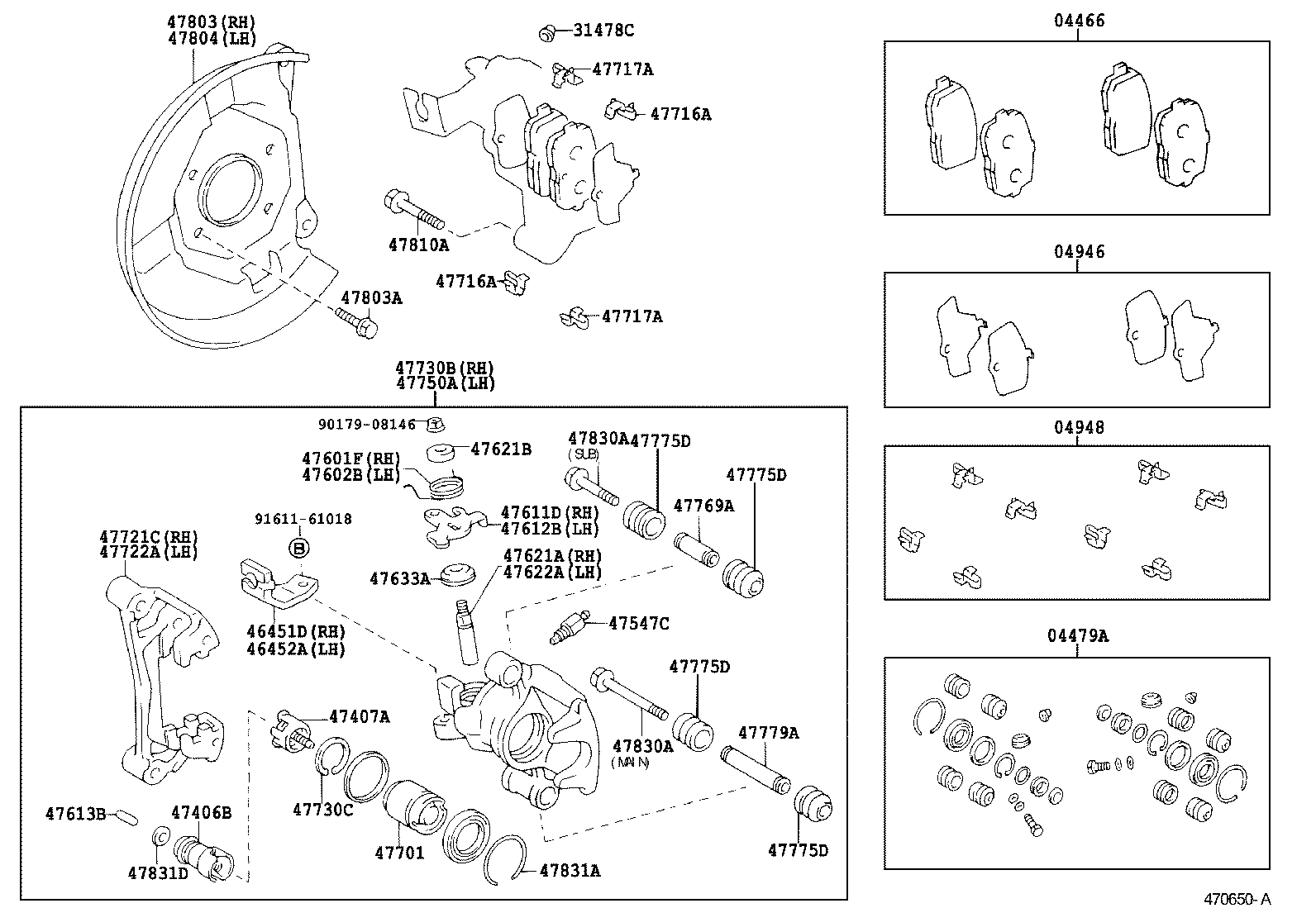

Ive had a look at it today and the cables are poor yes but with the calliper bolted on with the cable off, when turning the mechanism by hand (without the bracket for the cable) it only bites right at the very end of its throw and ive managed to turn it far enough that the pin has slipped out of the hole and the mechanism is now stuck.
My question is, are the pins in the inner piston prone to wear ? Or the mechanism that turns that it sits into ? Pin is 47613B and turning mechanism is 47621A
The same thing happend me and the C ring 47730C was out off place. remove the piston again and see in the bore did the C ring out off place..after fitting them did you bleed the brakes and bring the car for a drive to bed in the pads again?
