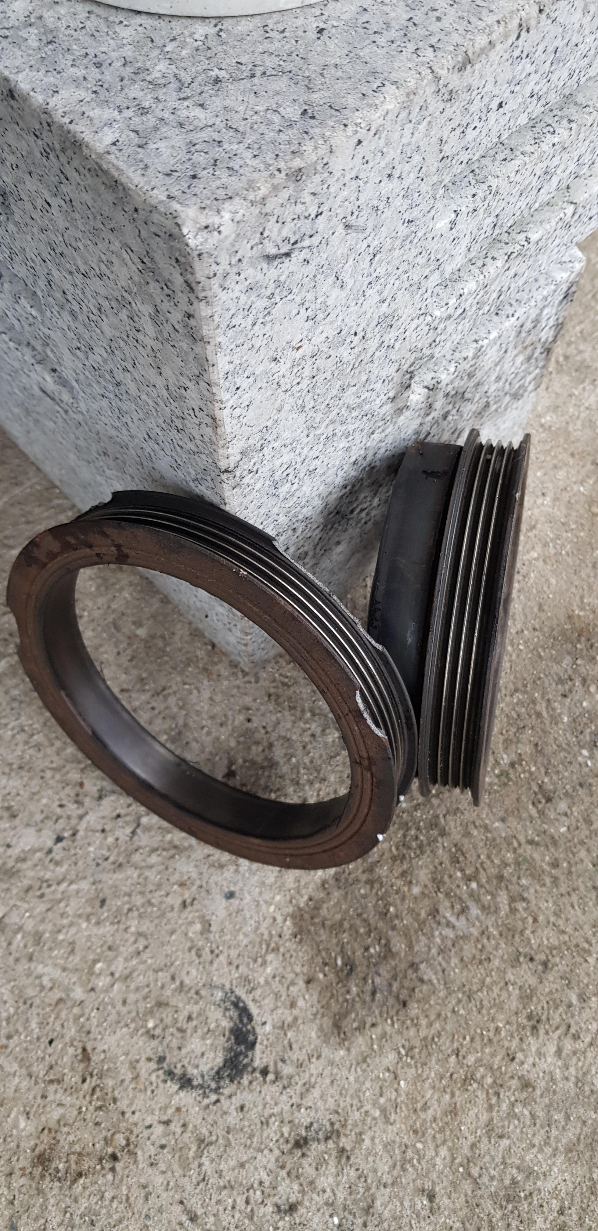

JDMfreak Posted December 24, 2018 Author Posted December 24, 2018 Found what had caused the horrid squeal rattle one funked bottom pulley swapped it out for another one and were all good to go unfortunately it had made the bottom casing a right state so will have to pull it apart again and replace it along with belt and water pump Quote
H_D Posted December 25, 2018 Posted December 25, 2018 11 hours ago, JDMfreak said: Found what had caused the horrid squeal rattle one funked bottom pulley swapped it out for another one and were all good to go unfortunately it had made the bottom casing a right state so will have to pull it apart again and replace it along with belt and water pump Wow never seen this happen before. Possibly caused by an over tightened belt or the pulley may have been dropped or not removed/installed correctly causing the structure to weaken. Always use pulley pullers to remove or install the main crank pulley and the belt should only be tightened enough so it only twists when approx 10kg of force is applied. Seen so many people remove crank pulleys with a pry bar and install them with a hammer and socket Quote
Calum122 Posted December 25, 2018 Posted December 25, 2018 Yeah that would make sense, since they're harmonically dampened. You're really lucky that that's the worst. I heard when they go, they explode! Quote
