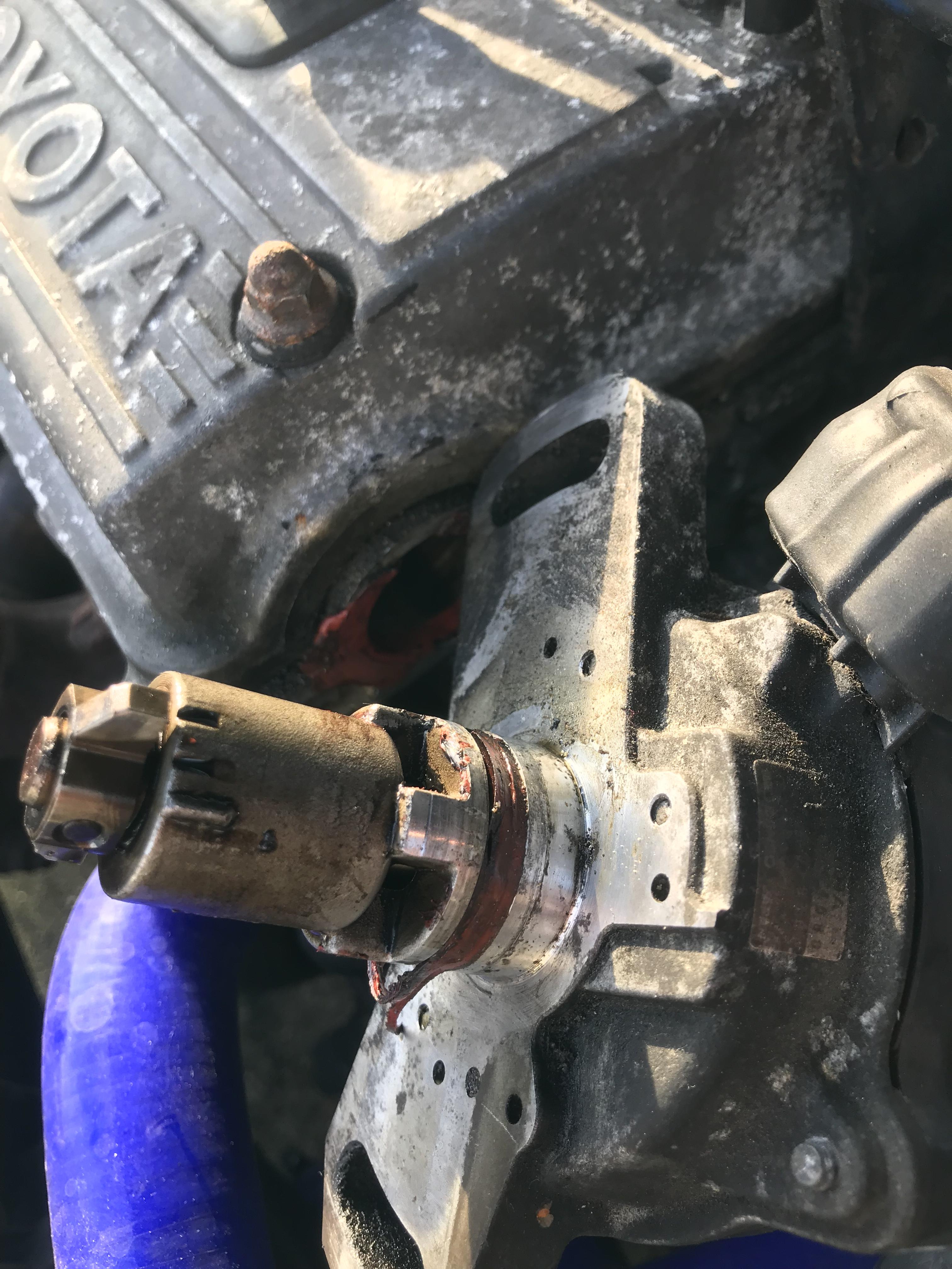

Nilz90 Posted January 4, 2019 Author Share Posted January 4, 2019 I’ve think I’ve found the issue now the rear bolt of the distributor was causing it to be loose. Do you guys now where the best place to get the red seals in the picture below would be? Or can i use sealant? Link to post Share on other sites
H_D Posted January 4, 2019 Share Posted January 4, 2019 (edited) that seal is not correct, it should be a black 'O' ring, Toyota sell them for abt £3. its a weird size so you wont find them in a regular set of 'O' rings - part number is 90099-14088, I see you have lots of sealant around the area where the dizzy goes in, remove the rocker cover and get rid of all of that sealant before re-installing Edited January 4, 2019 by H_D Link to post Share on other sites
Nilz90 Posted January 4, 2019 Author Share Posted January 4, 2019 26 minutes ago, H_D said: that seal is not correct, it should be a black 'O' ring, Toyota sell them for abt £3. its a weird size so you wont find them in a regular set of 'O' rings - part number is 90099-14088, I see you have lots of sealant around the area where the dizzy goes in, remove the rocker cover and get rid of all of that sealant before re-installing Thanks buddy I just checked already have that seal under the red sealant. I’ll clean it all up and put it back in. Fingers crossed its all fine after that. Link to post Share on other sites
H_D Posted January 4, 2019 Share Posted January 4, 2019 (edited) if they had to use sealer to get it on then its perished or the wrong size and will leak oil, get it replaced remove the excess sealer for the sake of £3. Edited January 4, 2019 by H_D Link to post Share on other sites
