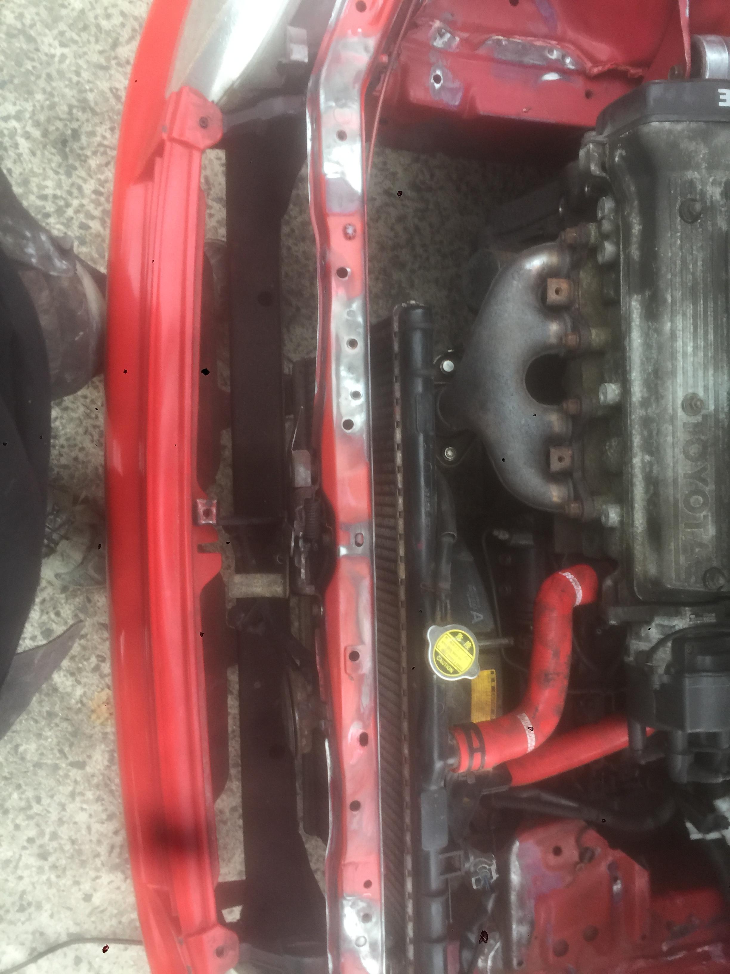

Thonfella259 Posted March 14, 2020 Posted March 14, 2020 (edited) time for a little update🙂 car has been done for a while now but can’t get it on the road due to Covid 19. Had to tidy up a few thing but only recently I have got my hands on some triumph tt600 itbs, det3 and a AEM wideband👌 Will also be using DIY det cans to detect knock as I want to play about with timing (can post a tutorial) Will hopefully get the car started with the itbs fitted this weekend if all goes to plan, will definitely be throwing up some videos and pictures when the time comes will leave all my old pictures up for all to see👍 Edited November 9, 2022 by Thonfella259 Quote

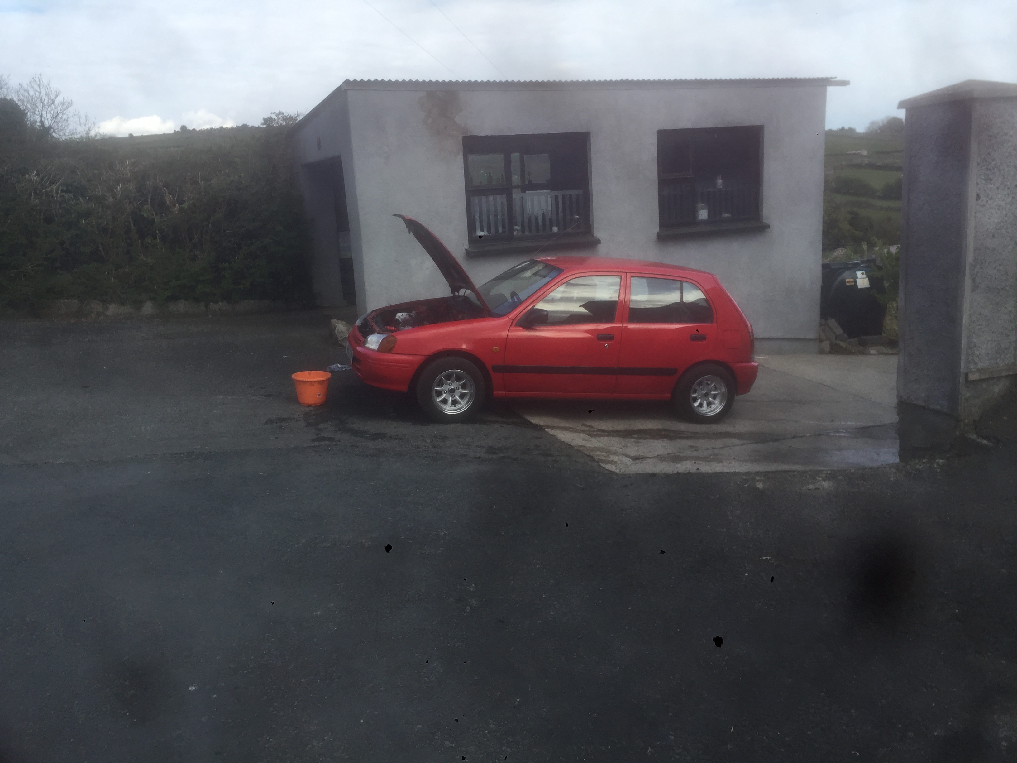

Thonfella259 Posted March 14, 2020 Author Posted March 14, 2020 (edited) Well sam👋,now the paint is faded from sitting outside for 4 years so I’ve bought a buffer and I’ll try and restore it as much as possible and then hopefully get a respray in the future👍 Edited June 23, 2020 by Thonfella259 Quote

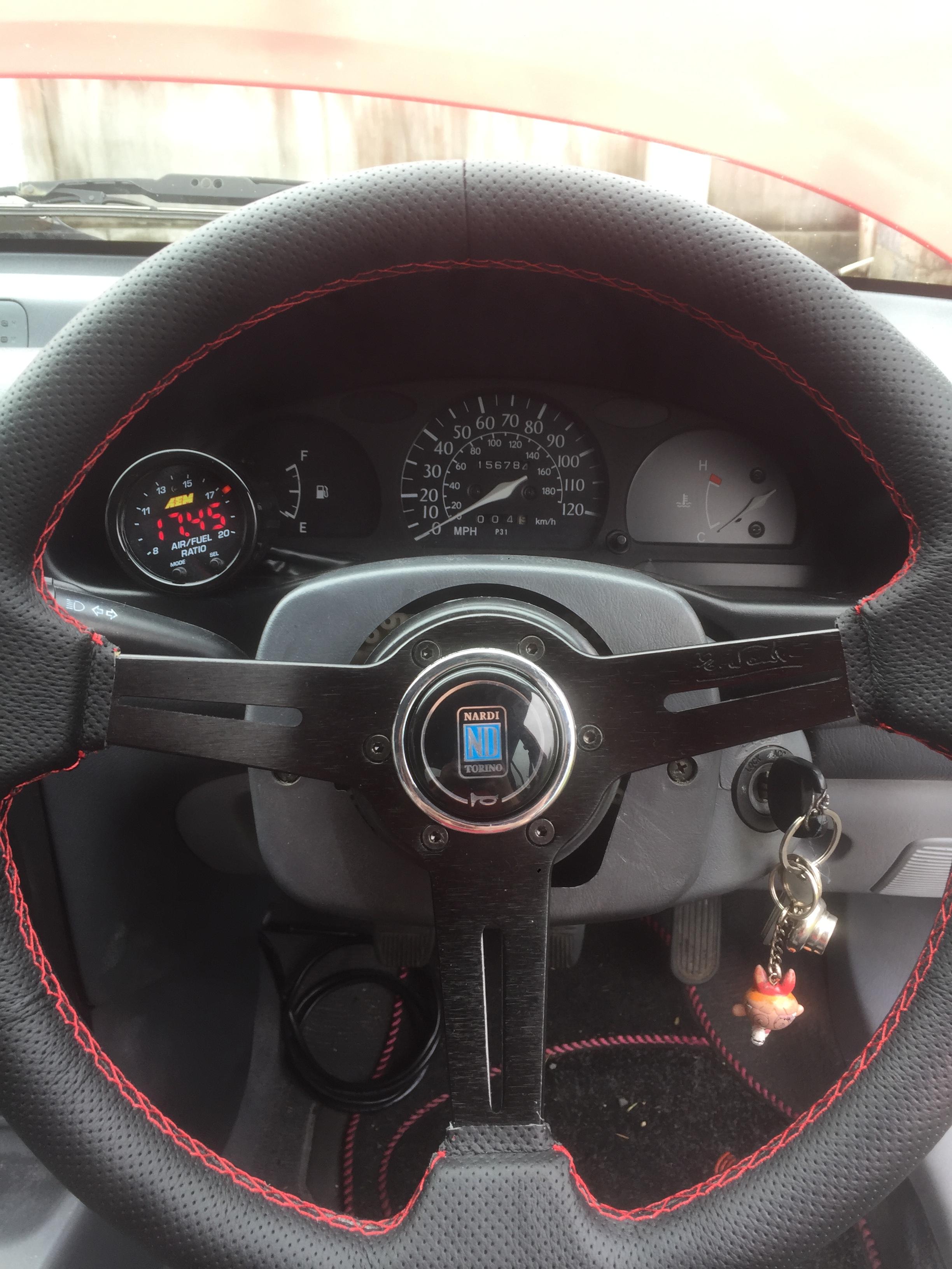

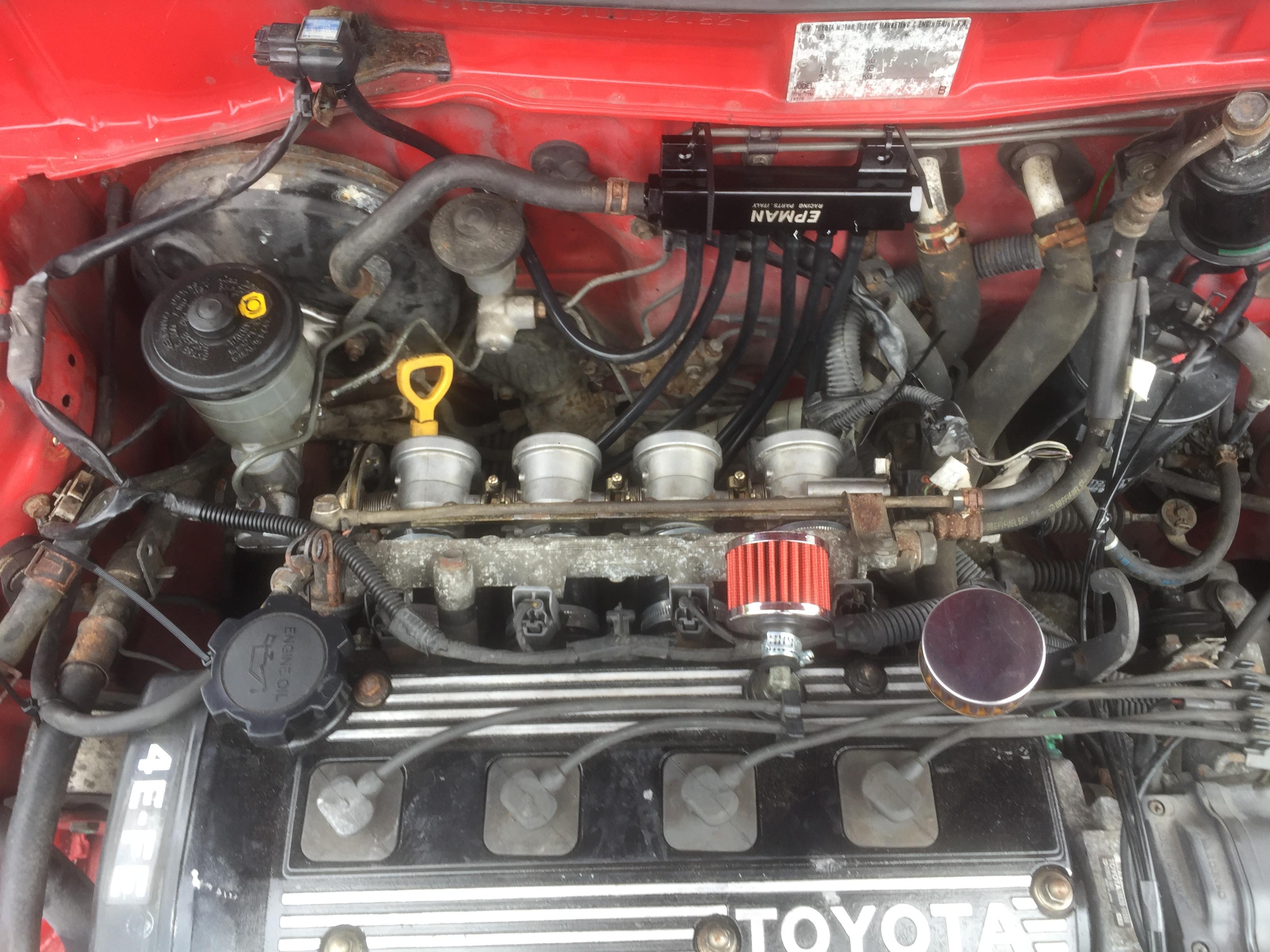

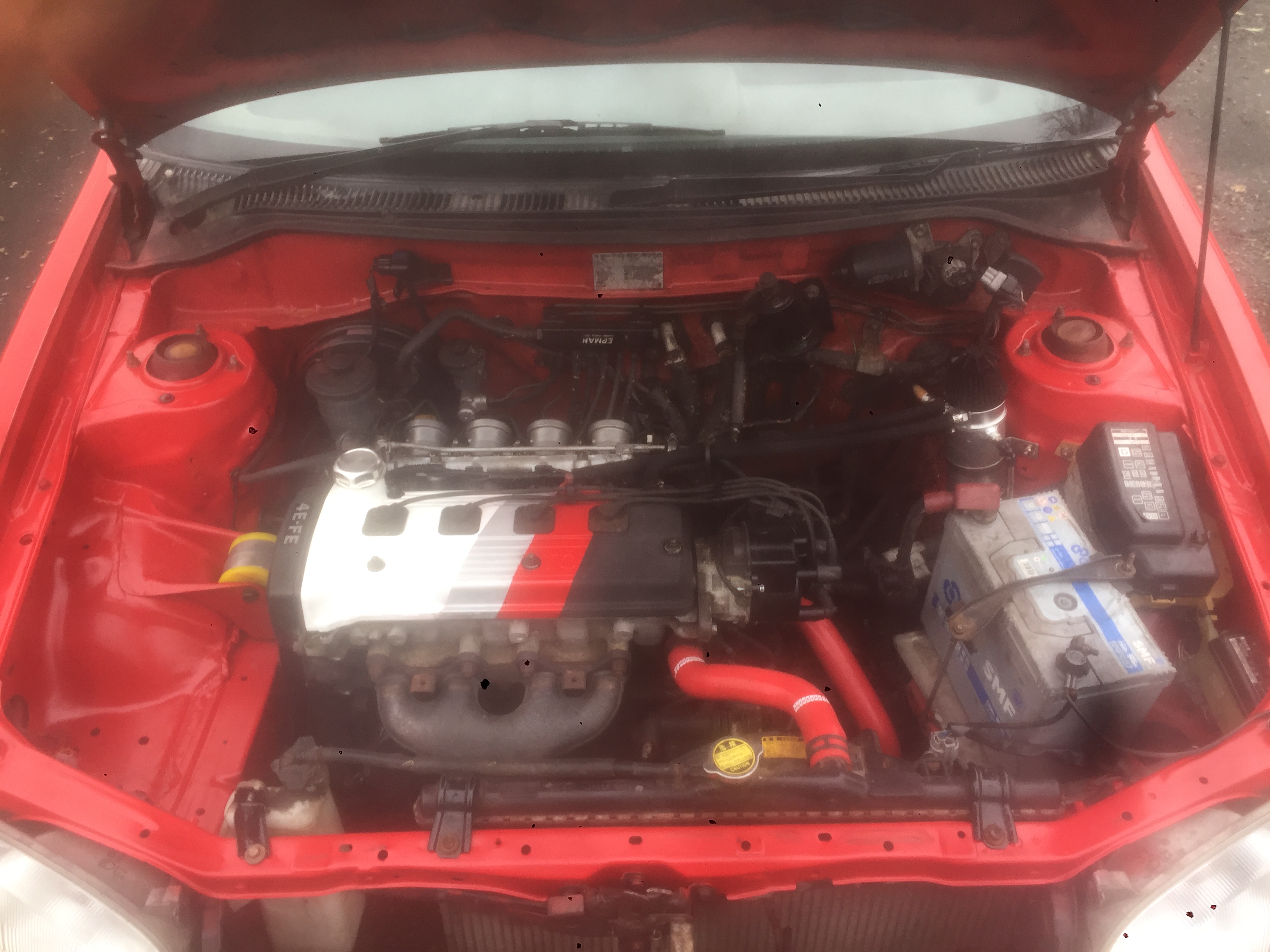

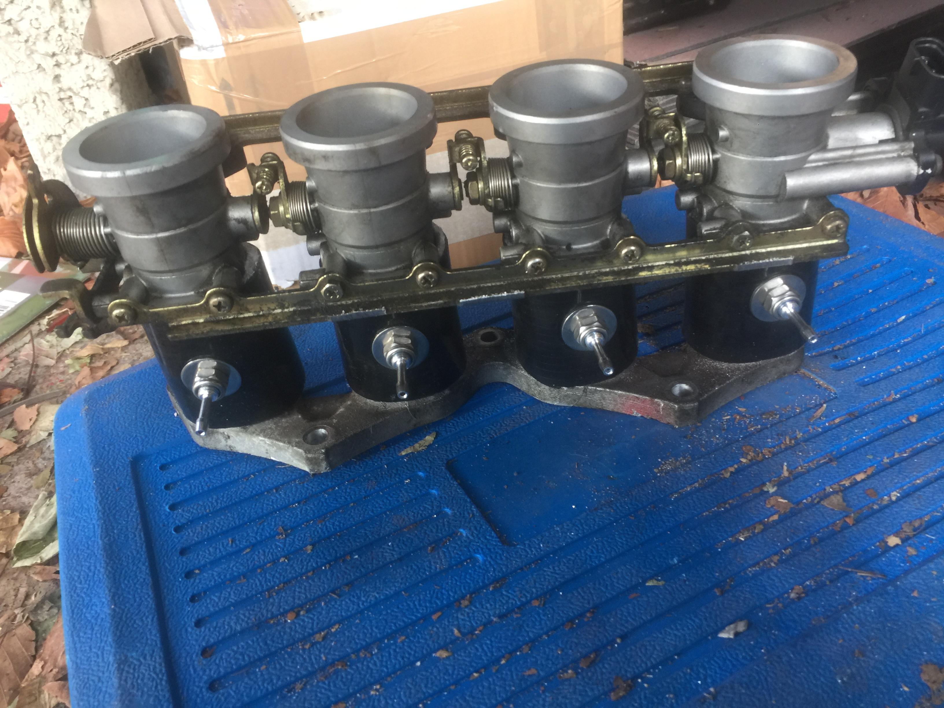

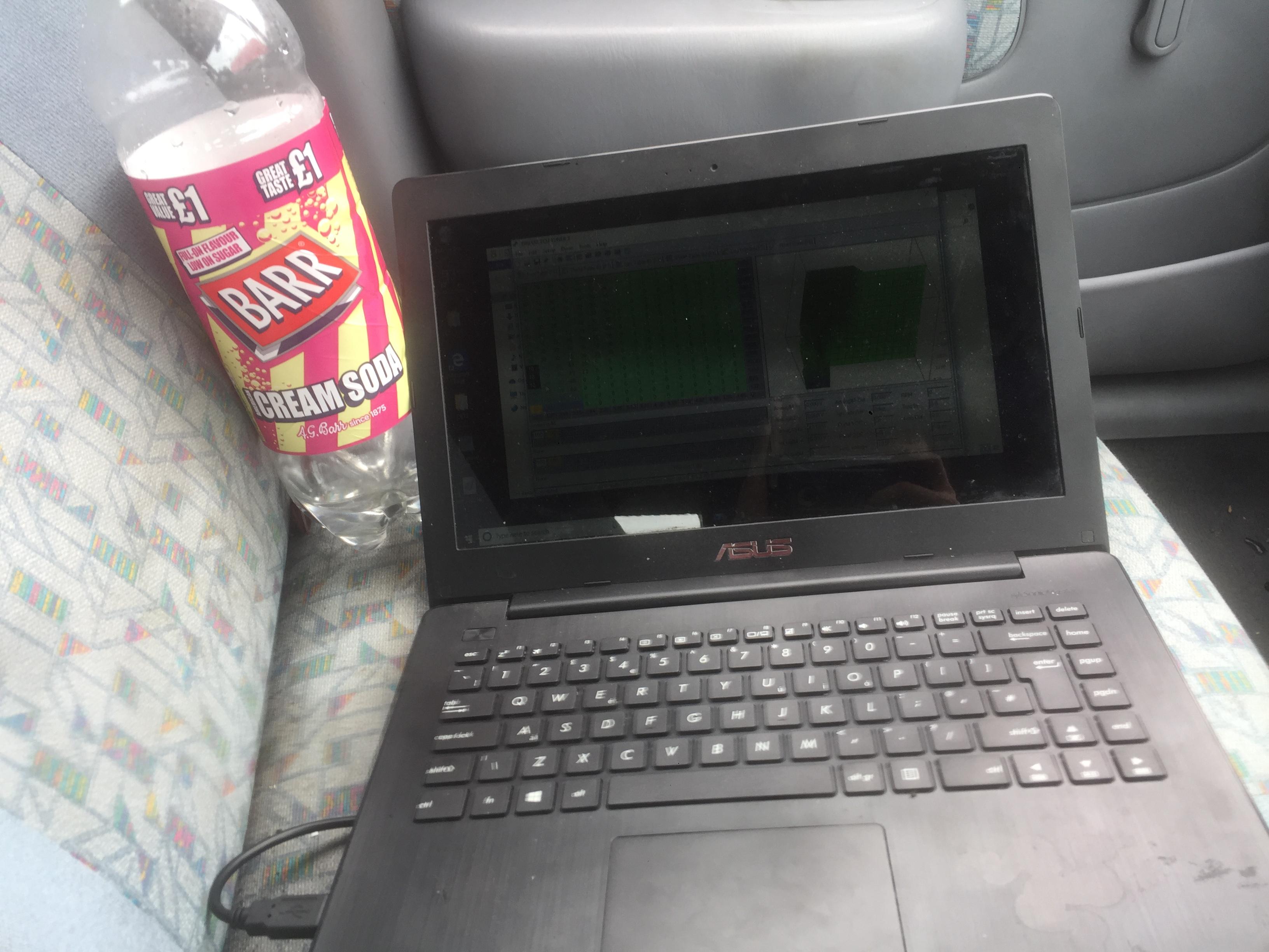

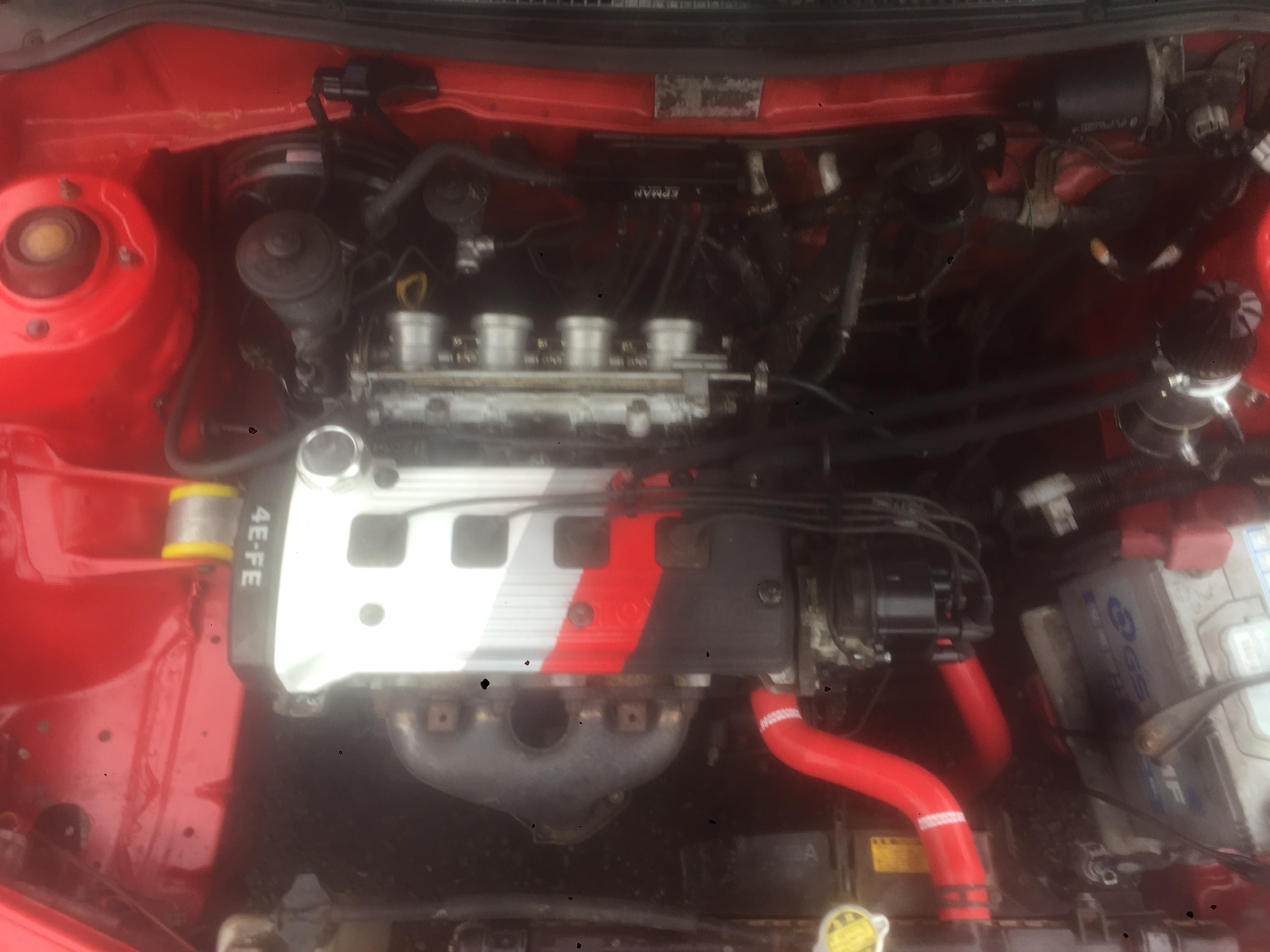

Thonfella259 Posted July 4, 2020 Author Posted July 4, 2020 Another update folks, got the itbs on, vacuum pipes sorted and mapped her myself with the det3 with aem wideband using datalogging💪👌 Quote
Sam44 Posted July 4, 2020 Posted July 4, 2020 Loving this nice work. What size itb have you gone for. Quote
Thonfella259 Posted July 5, 2020 Author Posted July 5, 2020 55mm Sam, will have to get a video from under the bonnet because theydo sound class👌, have some velocity stack coming aswell🤤 Quote
Claymore Posted July 5, 2020 Posted July 5, 2020 Think they're 45mm I/D mate according to danstengineering. https://danstengineering.co.uk/Velocity-Stack-Kit-for-Triumph-TT600-Throttle-Bodies-All-Lengths Also I believe they taper to a smaller diameter at the head side. (37mm according to a mazda miata website post). 55mm is too big for a 1.3 litre revving to 6k rpm. FYI my previous car had 46mm itb's, 2.3 litre revving to 7k rpm. Quote
Sam44 Posted July 5, 2020 Posted July 5, 2020 3 hours ago, Thonfella259 said: 55mm Sam, will have to get a video from under the bonnet because theydo sound class👌, have some velocity stack coming aswell🤤 Big itb setup. Keep up the good work. What management have you gone for?. Keep me posted on the results please if possible. Quote
Sam44 Posted July 5, 2020 Posted July 5, 2020 2 minutes ago, Claymore said: Think they're 45mm I/D mate according to danstengineering. https://danstengineering.co.uk/Velocity-Stack-Kit-for-Triumph-TT600-Throttle-Bodies-All-Lengths Also I believe they taper to a smaller diameter at the head side. (37mm according to a mazda miata website post). 55mm is too big for a 1.3 litre revving to 6k rpm. FYI my previous car had 46mm itb's, 2.3 litre revving to 7k rpm. Thanks for this information, yeh about a 37/38mm for the reasons you have mentioned. So the 37mm internal diameter is bang on. My 1.6ltr cvh MK1 fiesta had pinto 2ltr side draft 45mm delortos on it and these were a mistmatch. Quote
Thonfella259 Posted July 5, 2020 Author Posted July 5, 2020 55mm is the outside diameter on the intake side🙈, as for management I’m just using a det3 on piggyback mode with aem wideband, only real adjustments I had to make is try to make it idle and it was running slightly rich up top and lean down low in the revs which I have corrected but other than that shes sweet👌 Quote
Thonfella259 Posted July 11, 2020 Author Posted July 11, 2020 View of the throttle bodies under the bonnet😫😍 6DD95247-227B-4E9F-B626-D55F3C122D6B.MOV Quote

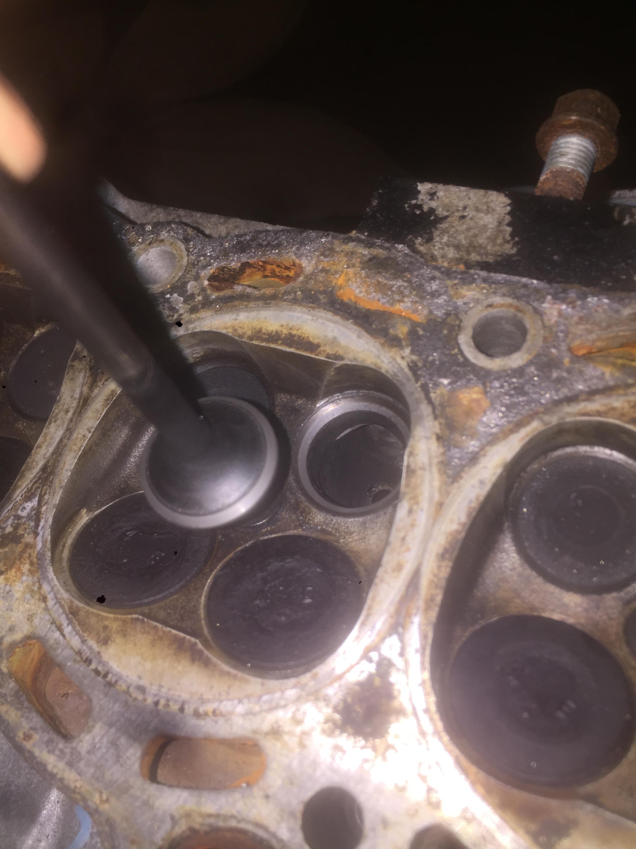

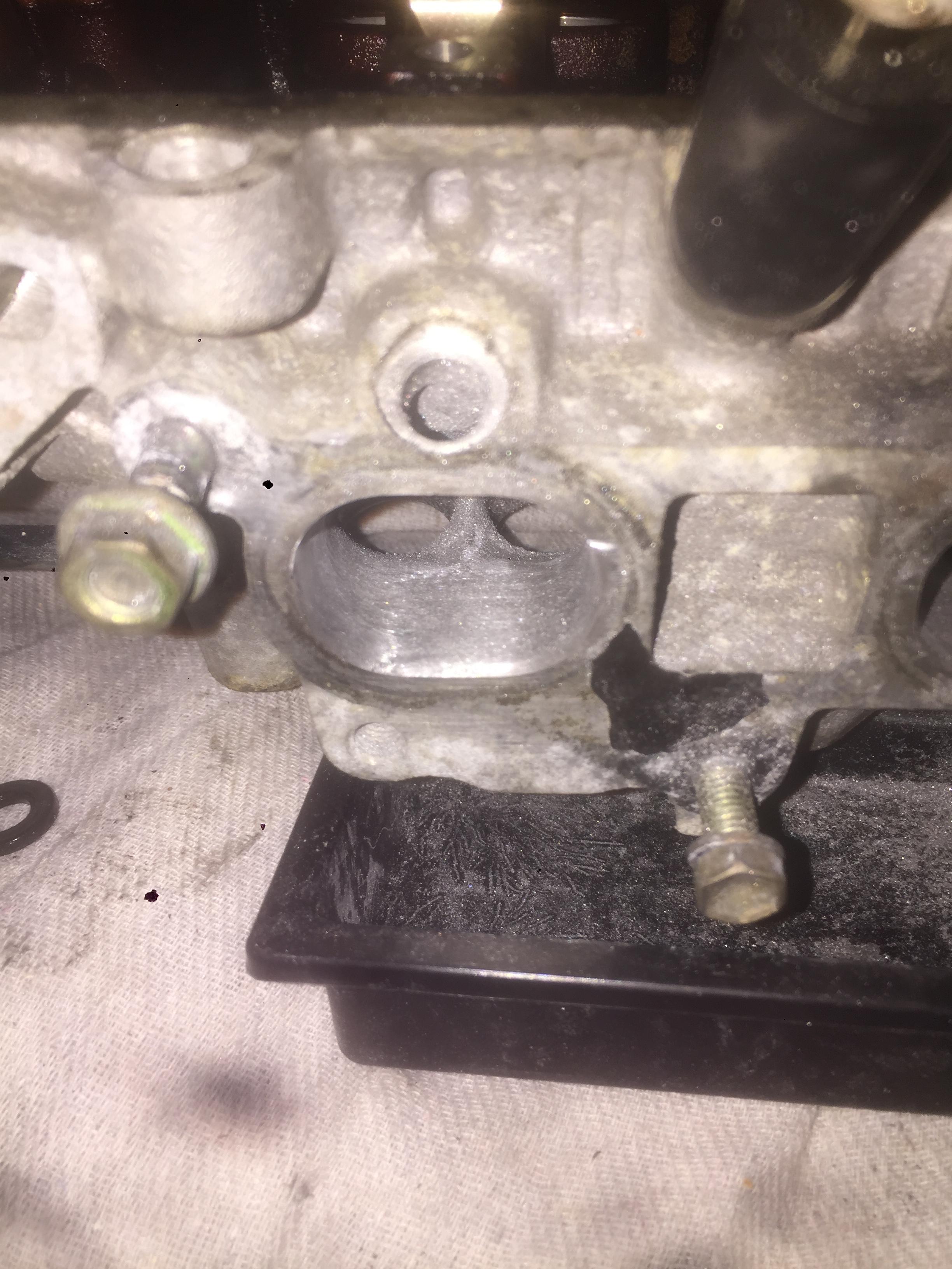

Thonfella259 Posted May 10, 2021 Author Posted May 10, 2021 Haven’t been on here in a whiiiile, few more things done to the car •rebuilt head •port and polish •fidanza lightened flywheel •and a lovely set of superlites👌 Quote
