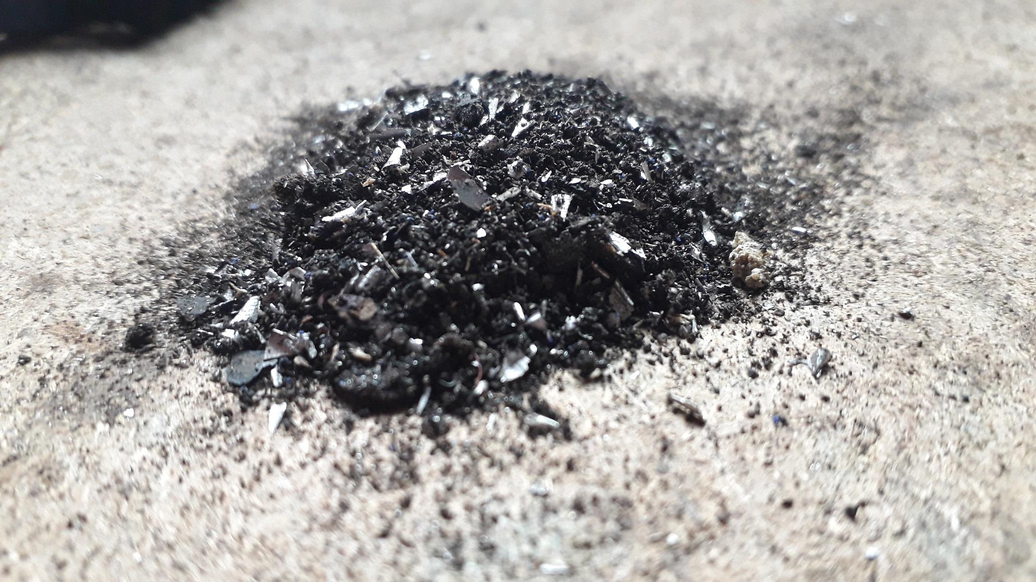

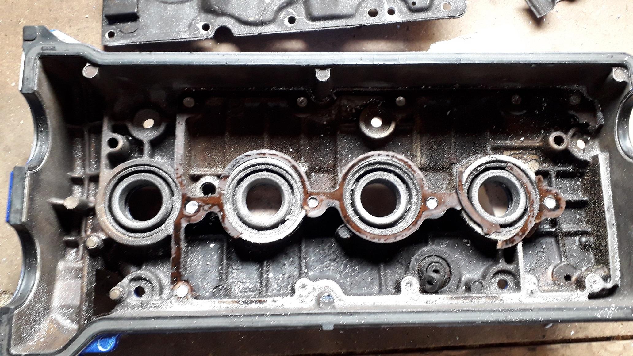

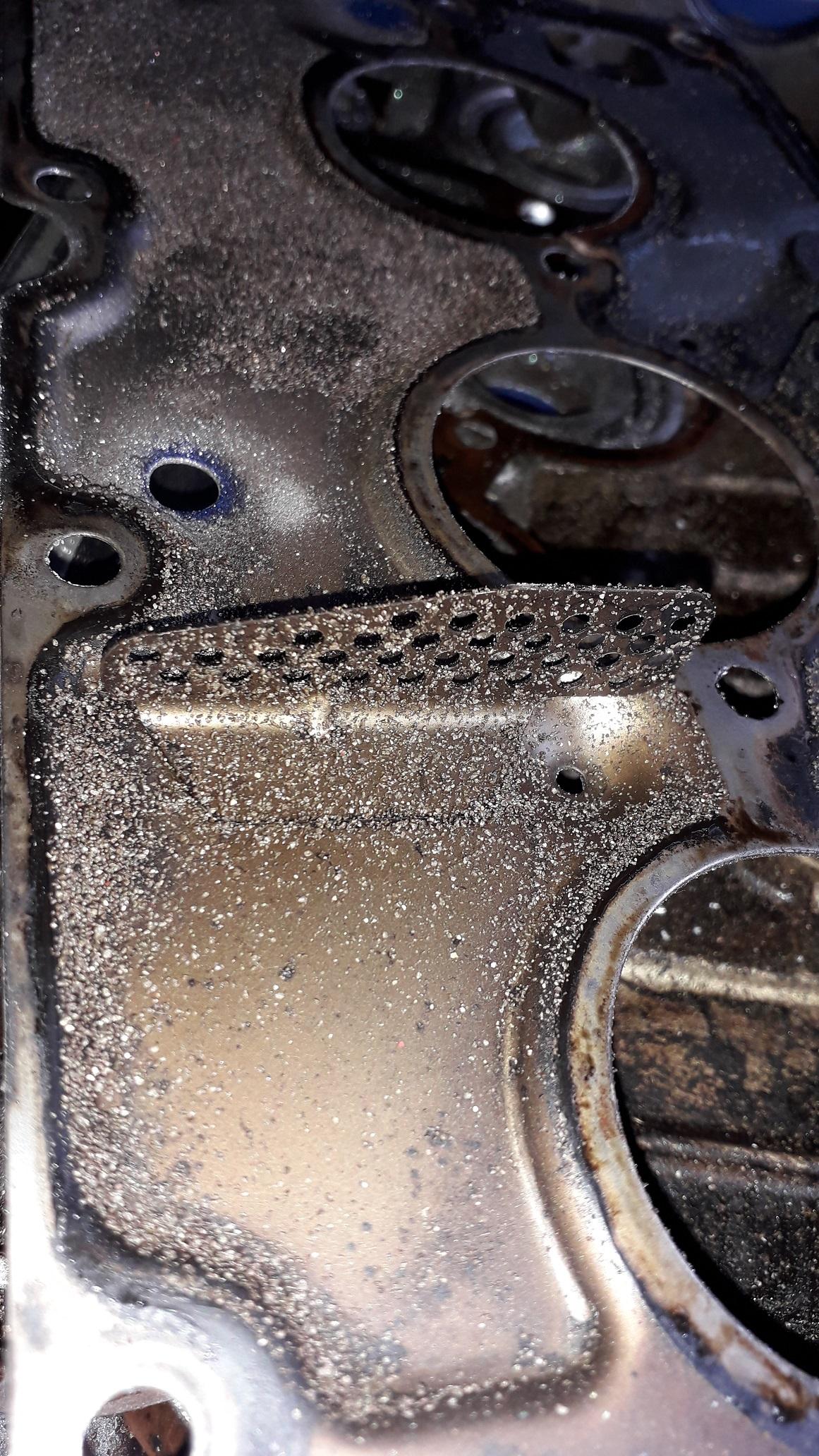

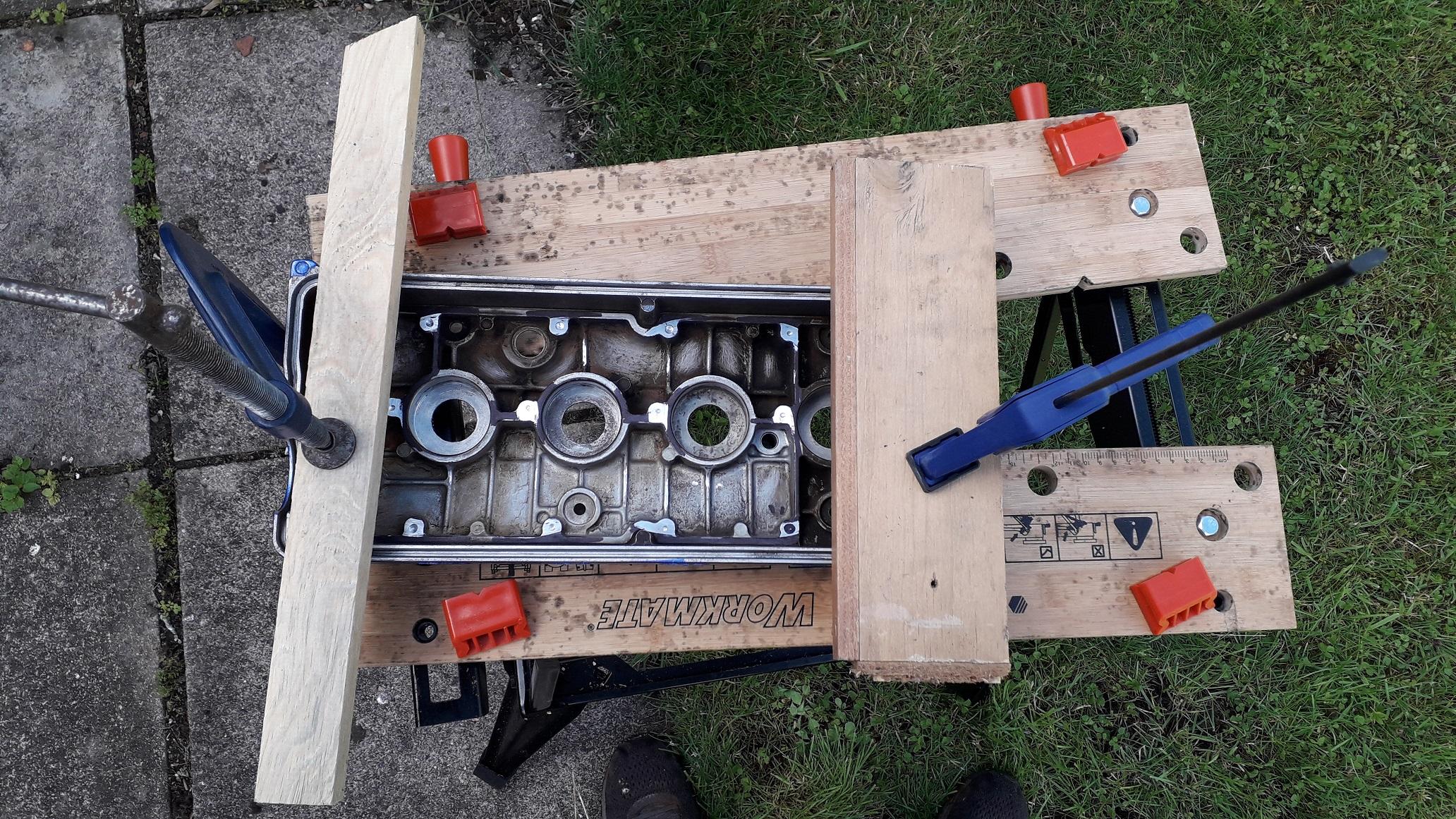

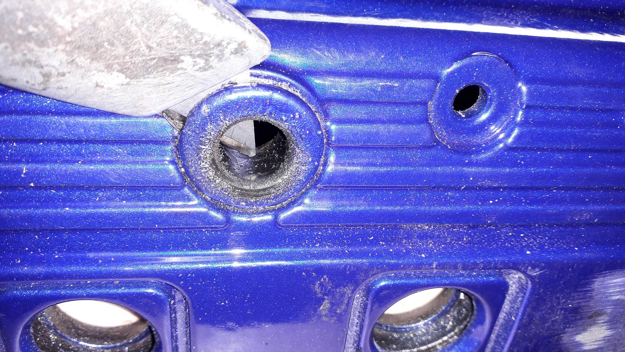

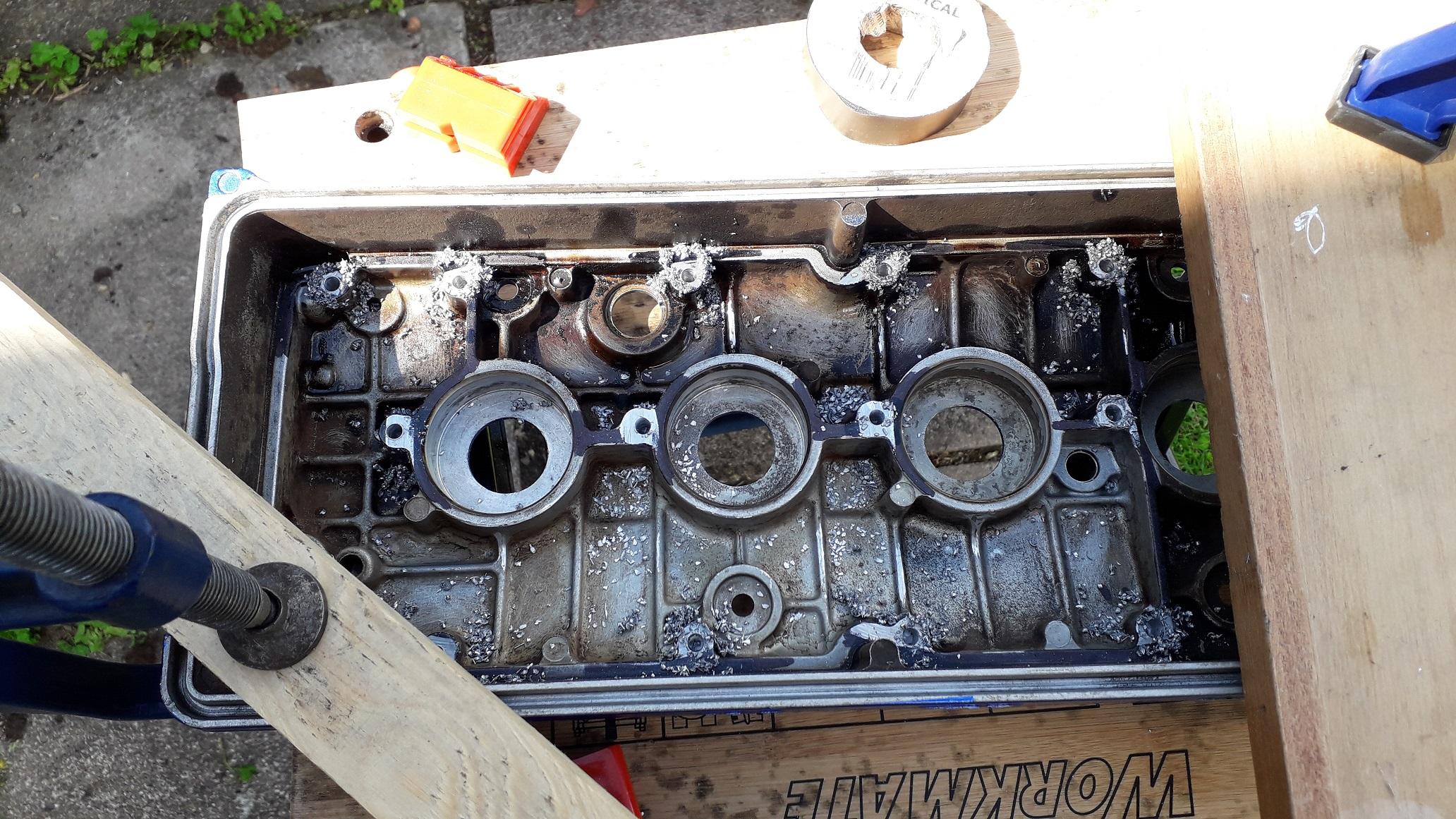

4efte Cam cover baffle removal:

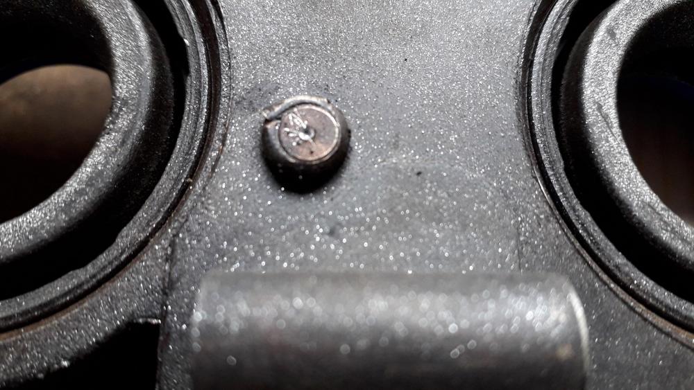

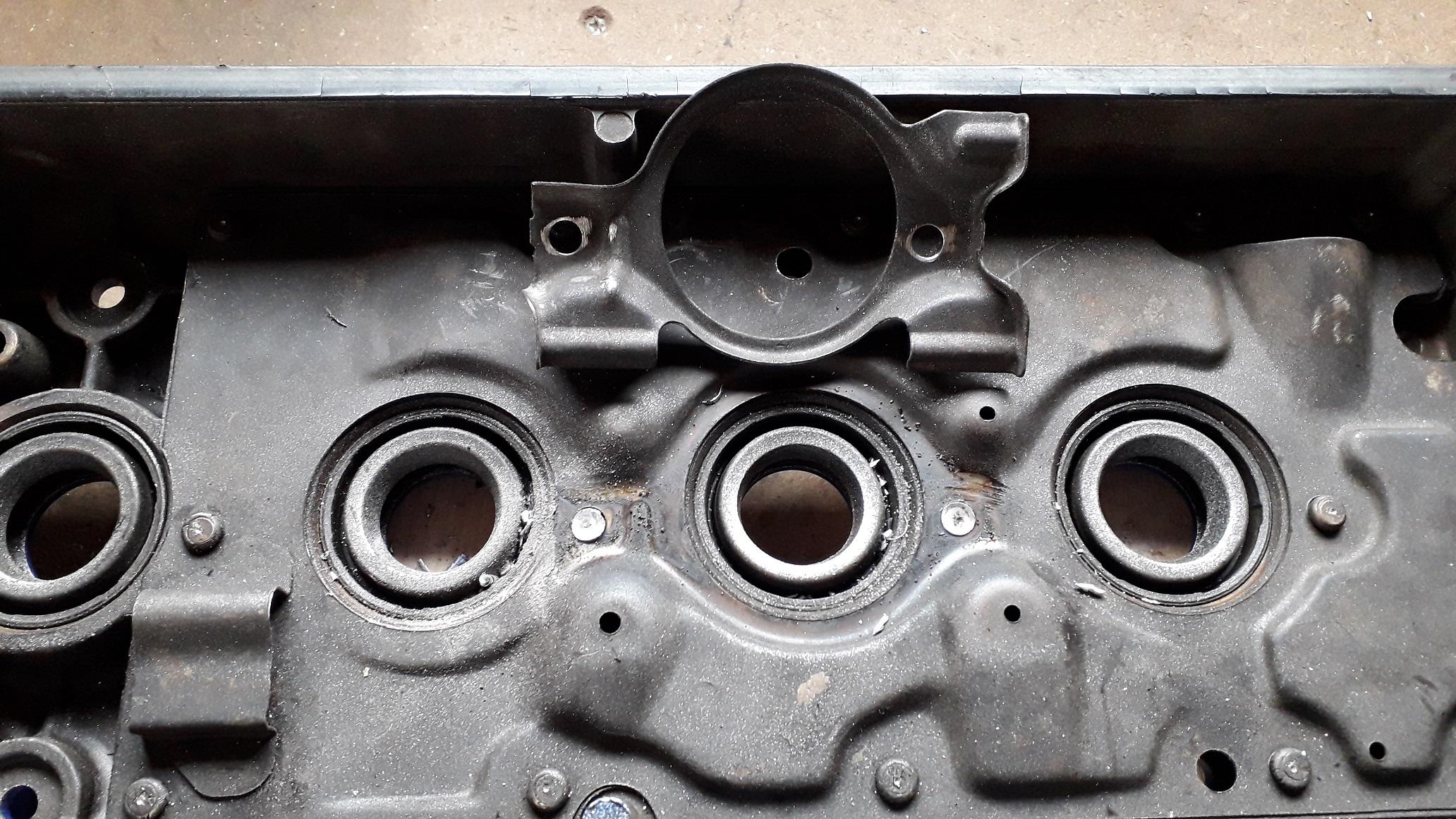

First had to remove the baffle plates, centre punched the riveted aluminium posts on the cam cover to prevent the drill bit slipping.

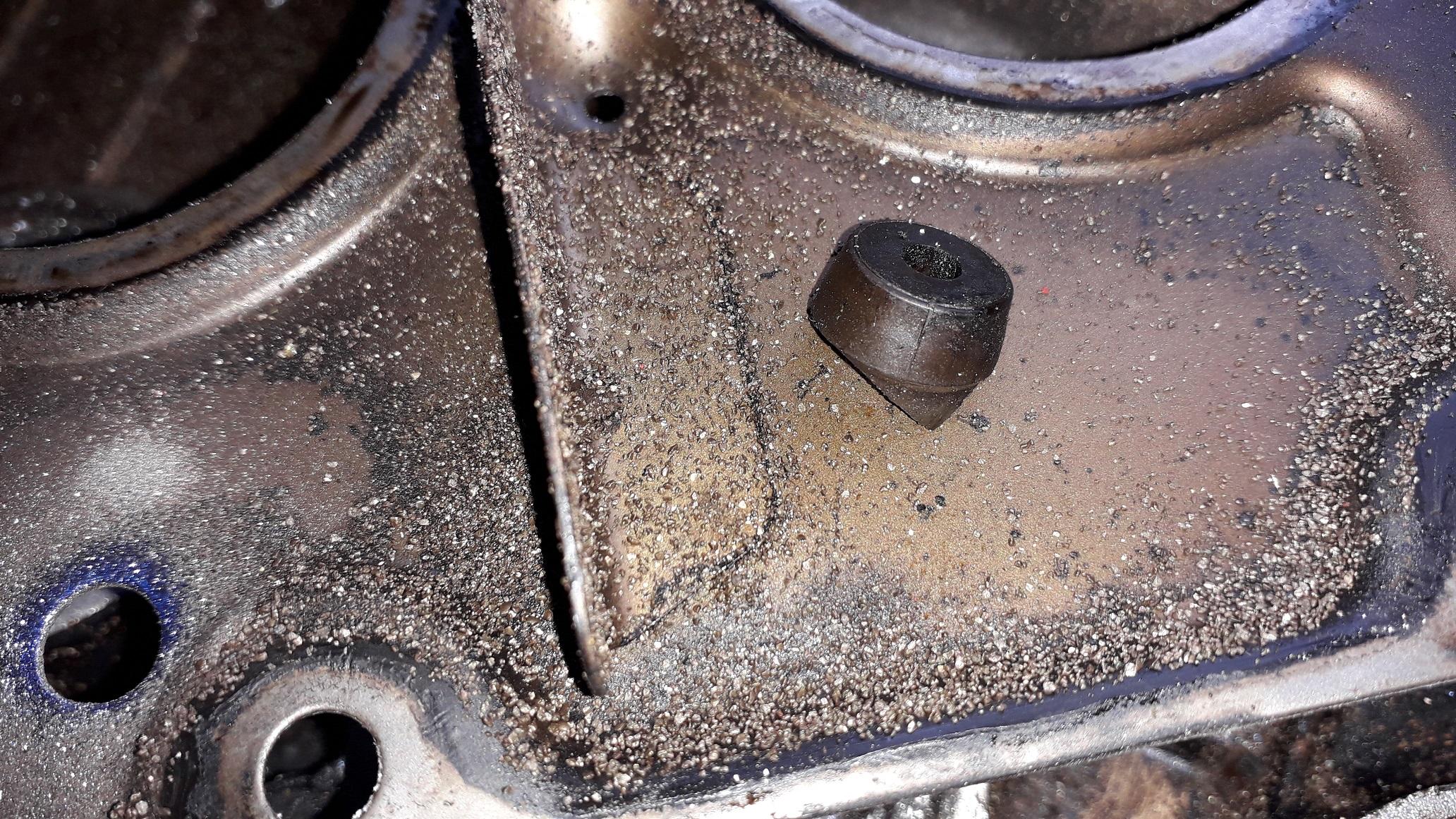

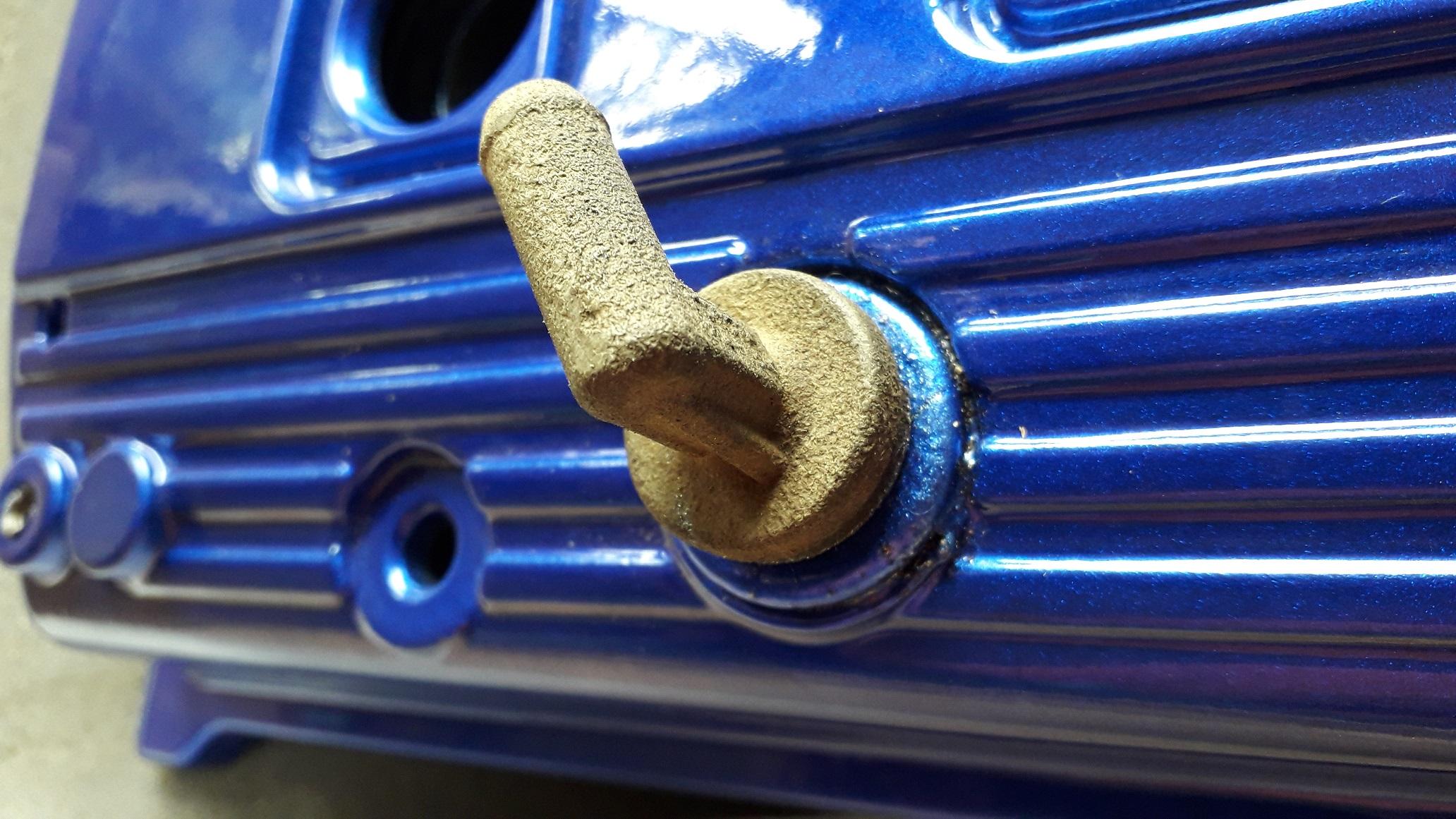

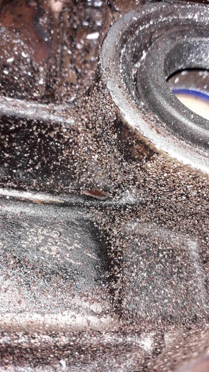

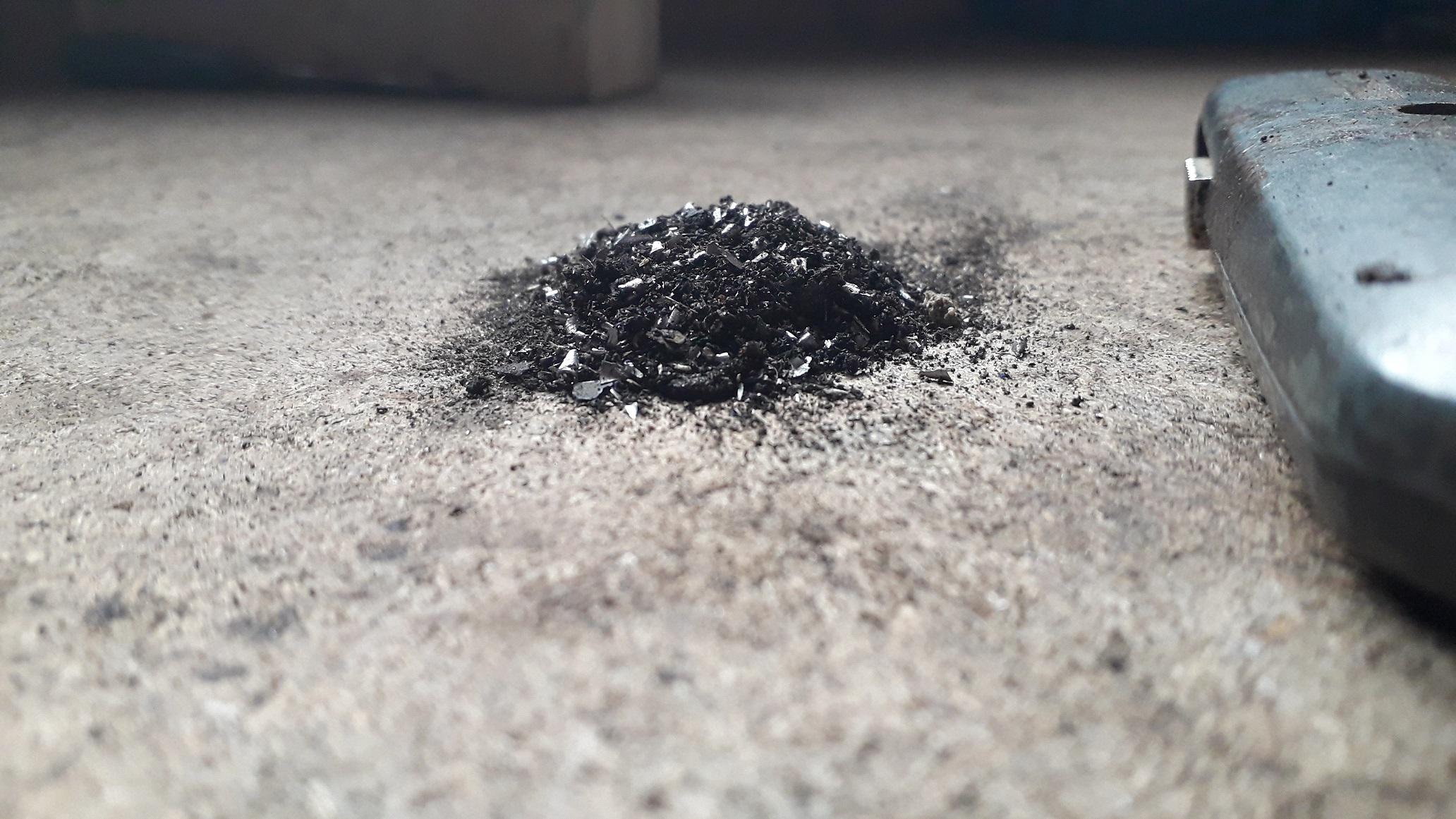

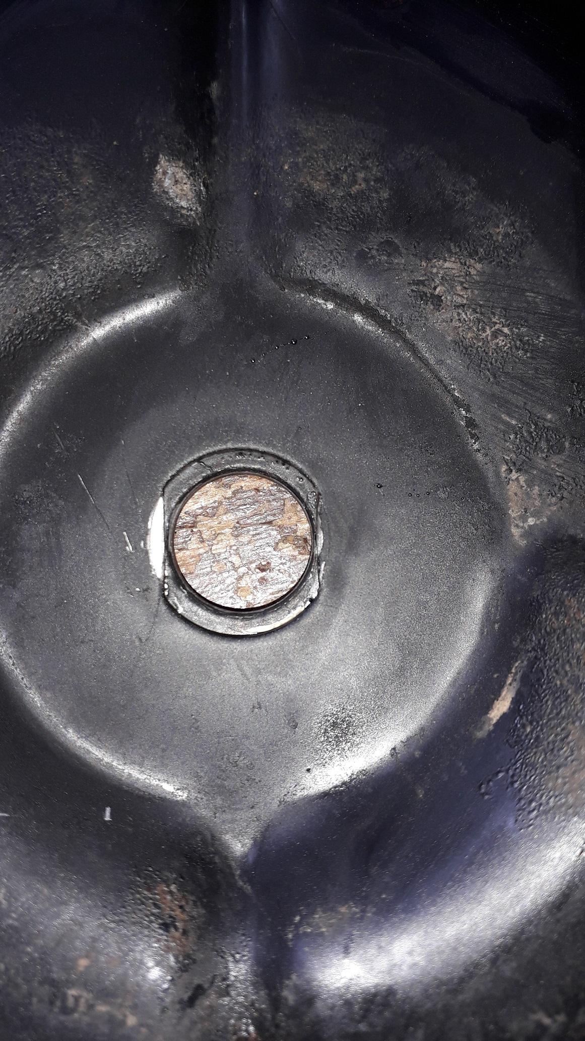

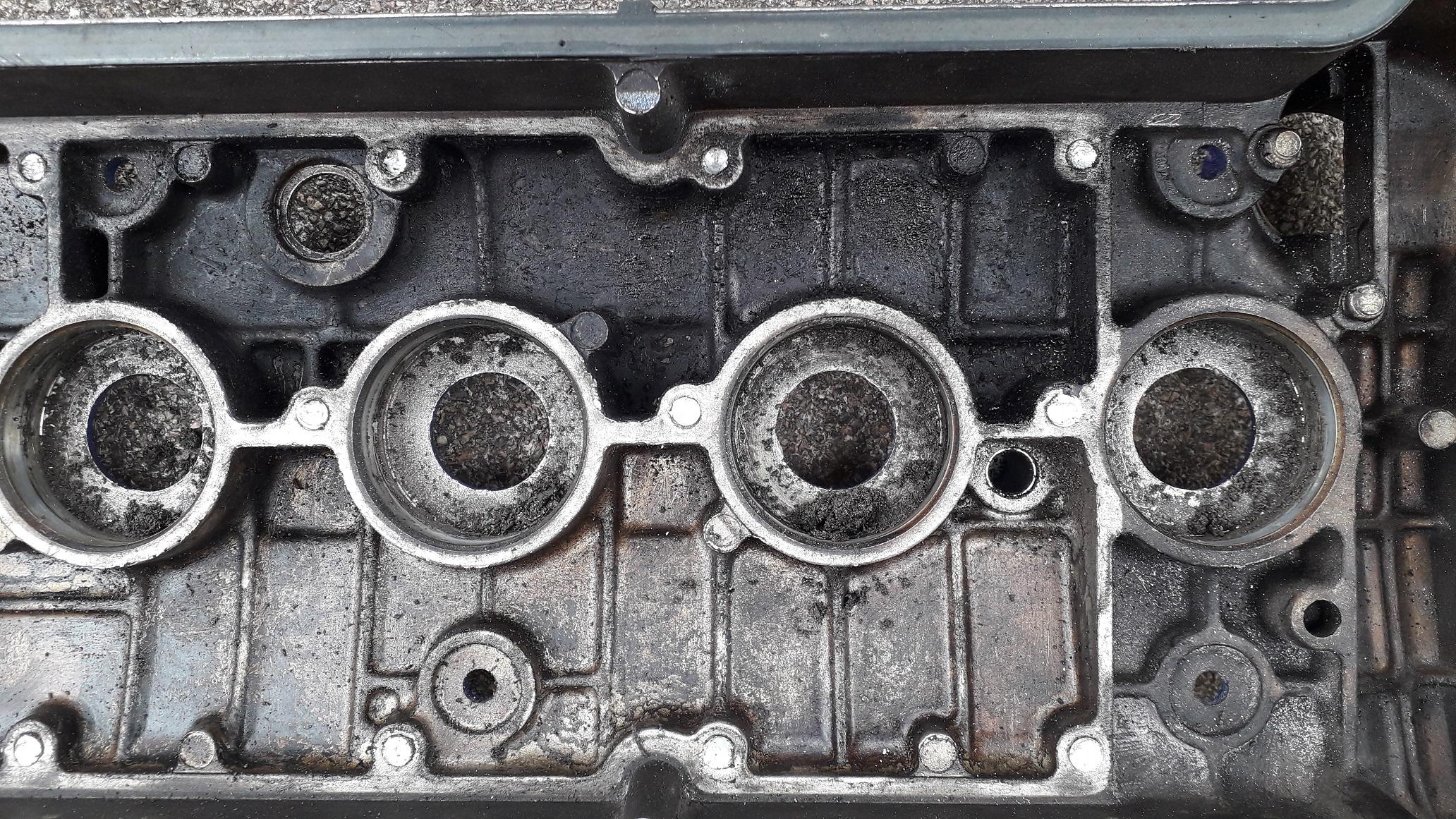

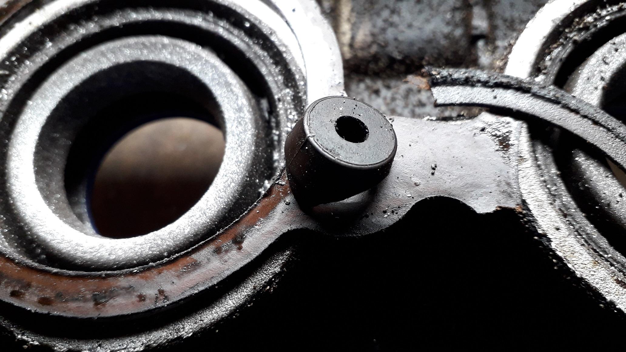

When the parts arrived the PCV valve showed clear evidence of sand blasting erosion, first sign of trouble. The second was the rattling sound when you moved the cam cover and sand fell out!
All rivets punched ready to drill
Drilled the heads off the centre 2 first with an 8mm bit as these hold a mini drip tray onto the cam cover. (Note the 3 holes in the upper baffle plate that release oil onto the "trays" of the mini baffle.)
Drilled the remaining rivets off, had to use a small drum sander and burr to help out but eventually freed the baffle plate, thankfully virtually unmarked. Note the card gasket from the factory install.
Mystery item turned out to be the tip of a previous PCV valve. Obviously had been replaced and snapped off in the process, left for me to find. Thanks :shok:. Large enough not to be able to escape into engine but may have impeded the flow around the PCV area.
Deffo been sand blasted then.
Plenty of it stuck to the oil residue on the cover.
Plenty of it stuck to the oil residue on the baffle plate too.
Cut the old PCV grommet out with the Stanley.

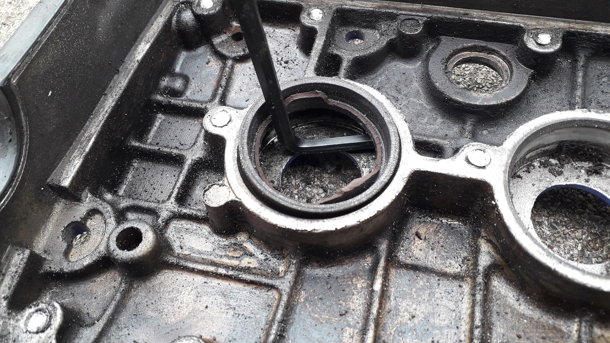

Snapped the central rings out of the seals and then carefully levered out the rest of the spark plug hole seals a few mm at a time, kept moving the "lever" round the hole. Was careful not to score the walls of the cover with the lever end.

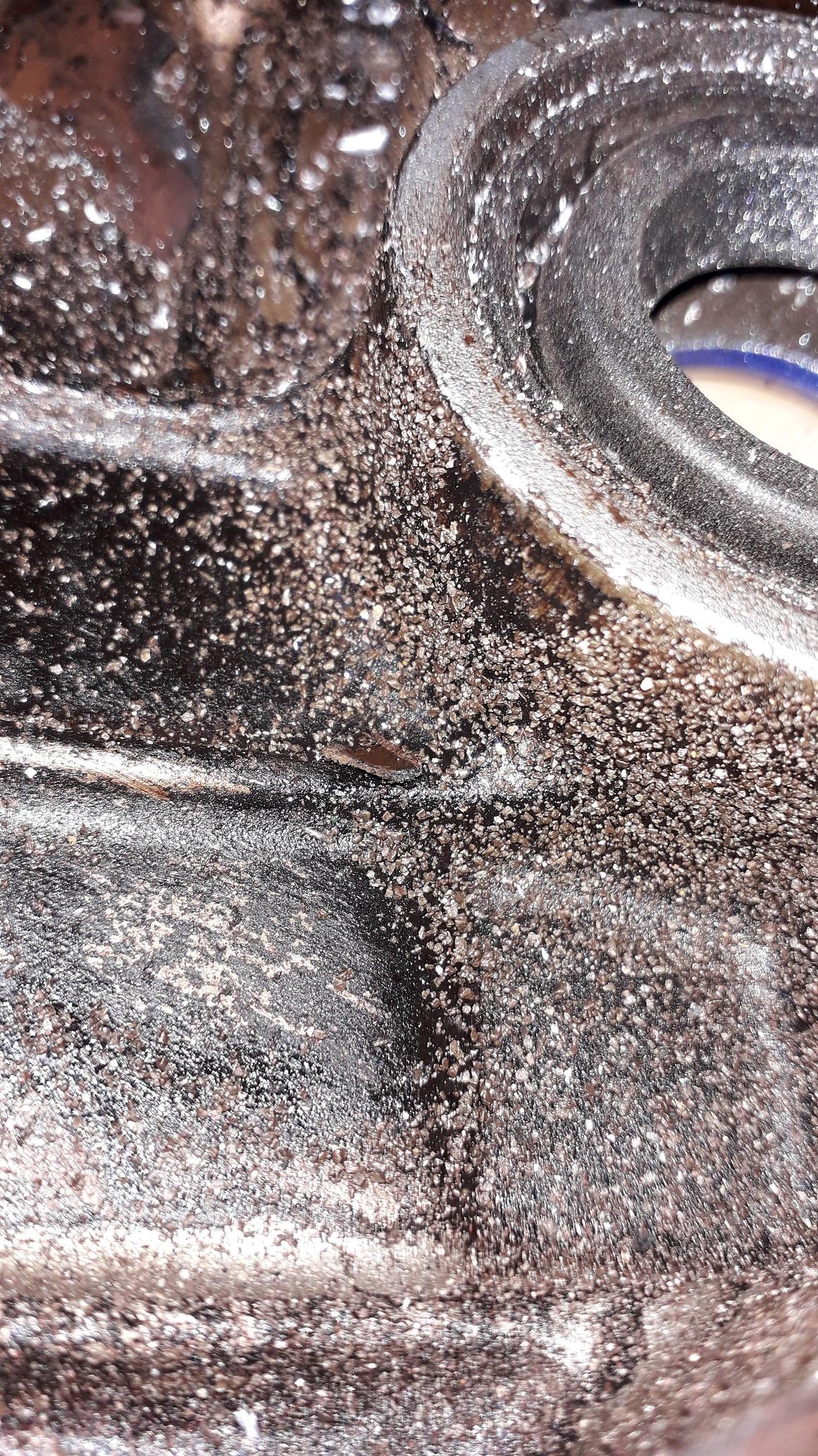

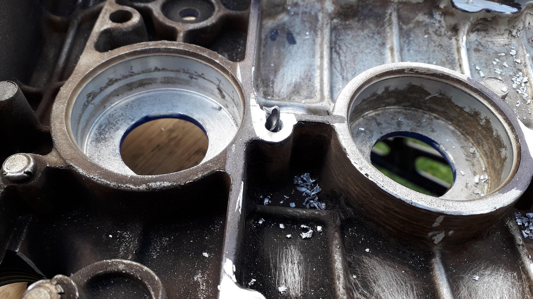

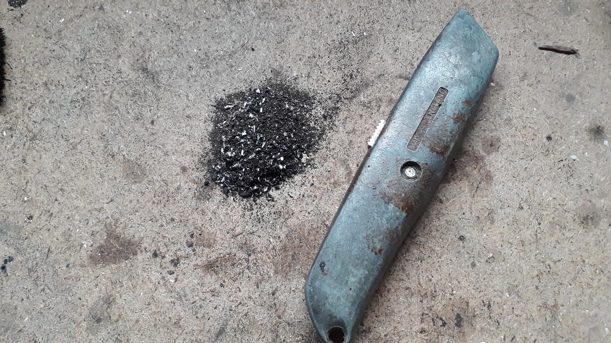

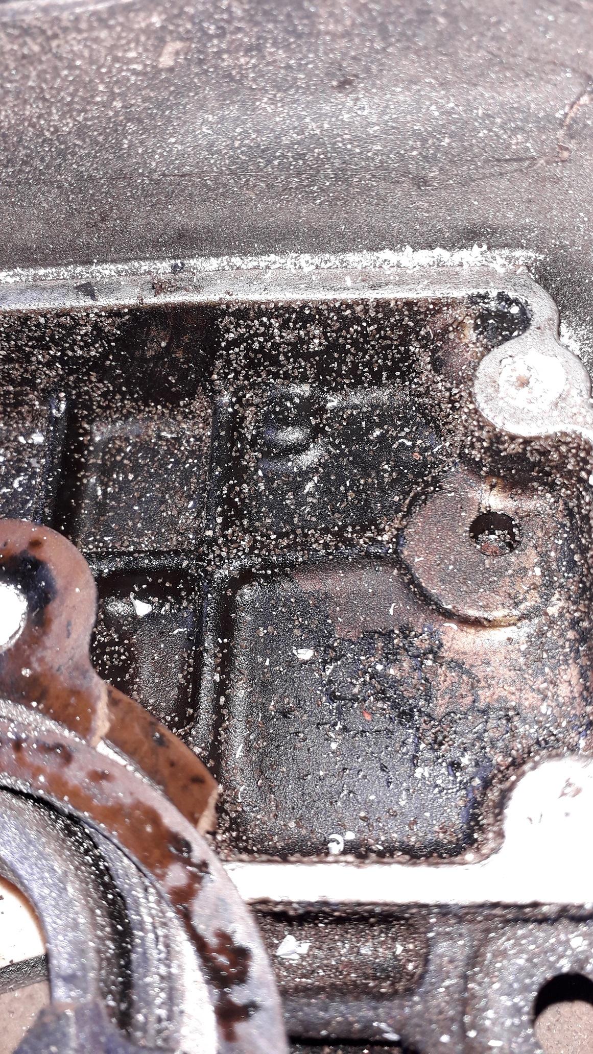

Greeted by yet more sand blasting media under the seals. Thankfully these would have only fallen directly into the bores at spark plug change time :crazy:
Pile of unwanted-ness
Stanley for scale
All in all I would say I removed over a table spoon of just sand from the baffle (after taking into account the alu swarf from drilling and the sand that was already removed from vacuuming / falling out). I had thoroughly vacuumed the ports before investigation to see if it would have any effect. There's no way that parts washing would have been able to remove all the particles from the cover with the item assembled.
Cleanup / reassemble to follow.
YouTube video of the latest cover I've refurbishedhttps://www.youtube.com/watch?v=e0tlJcCMhP4
Edited by Claymore

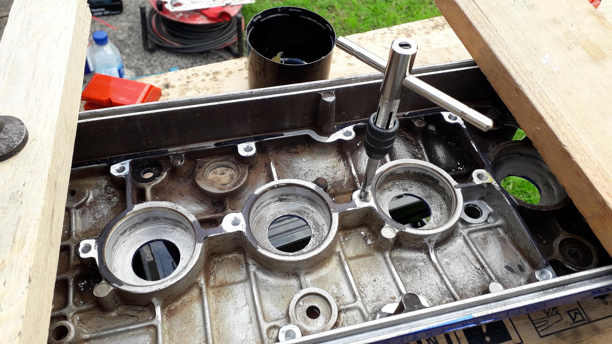

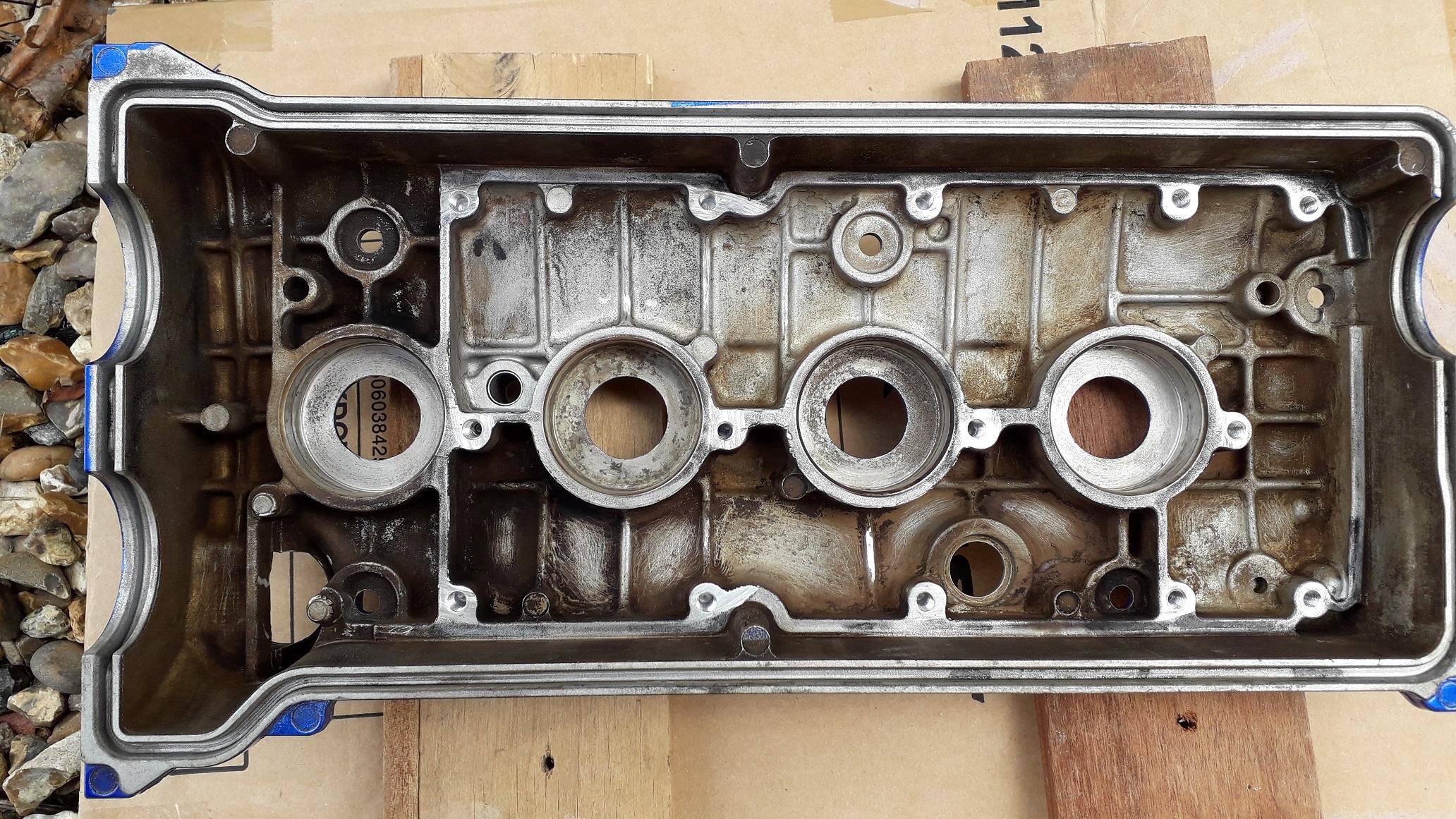

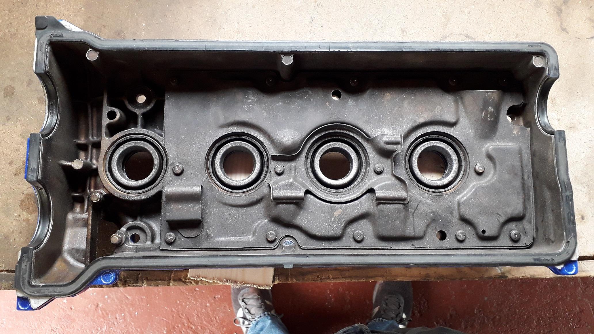

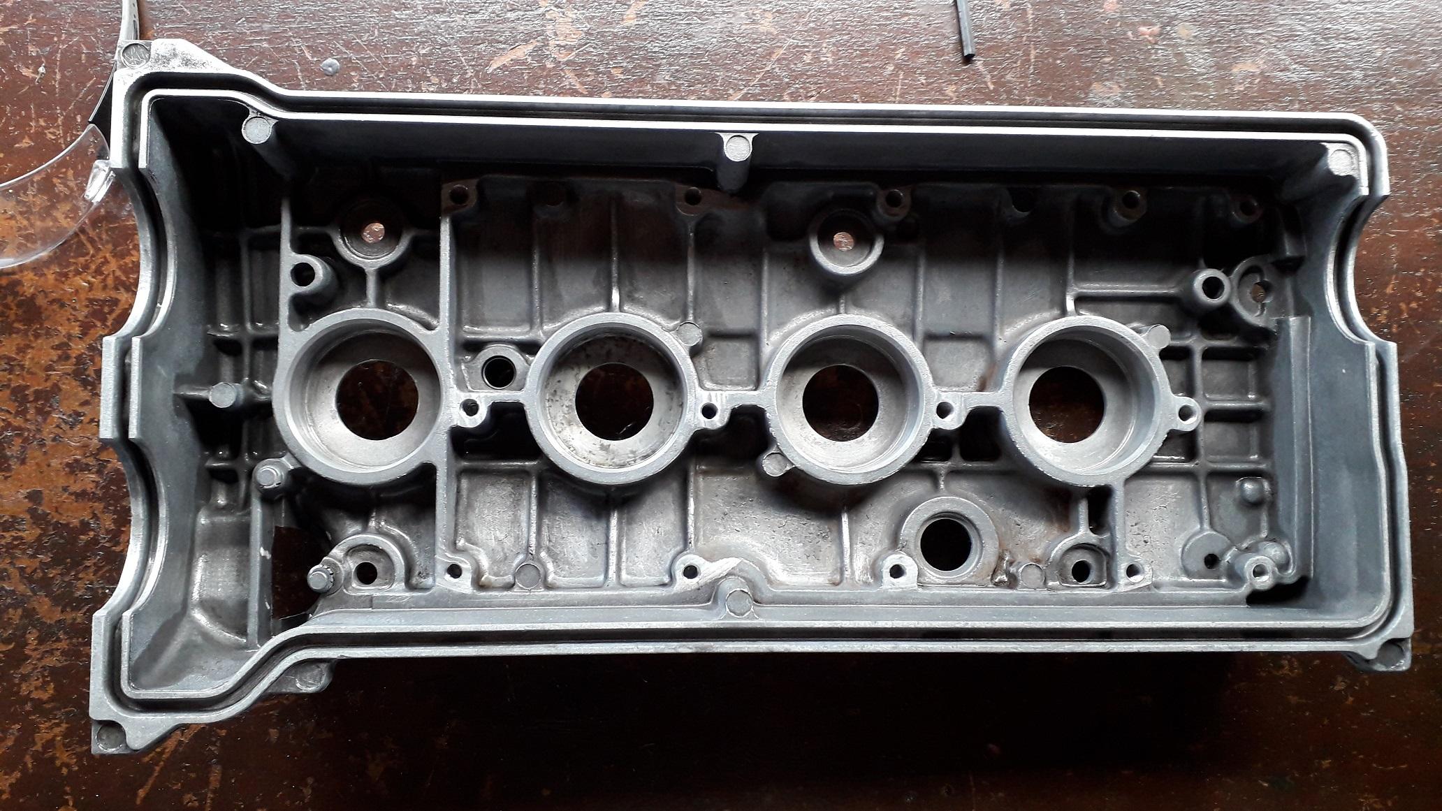

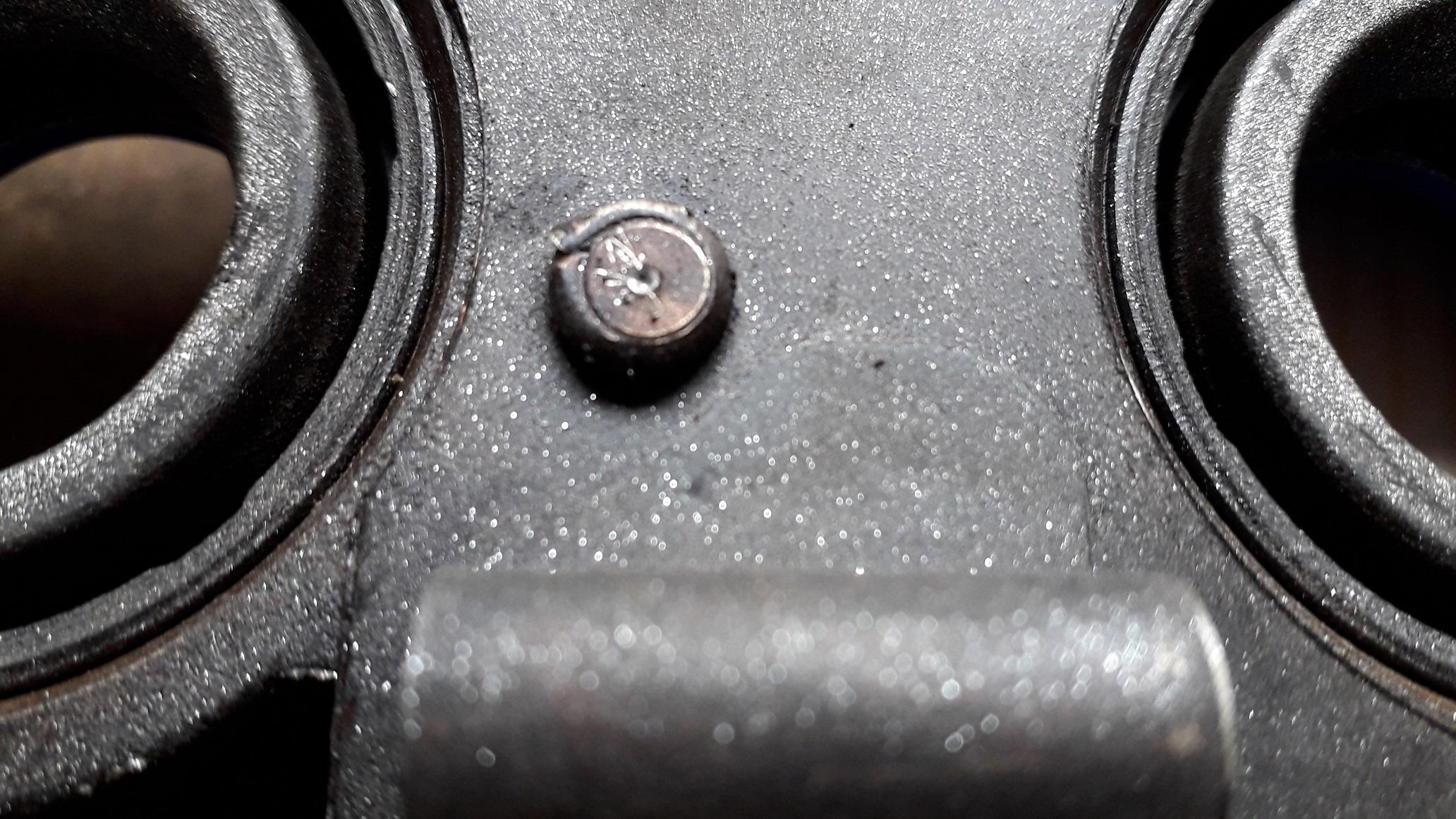

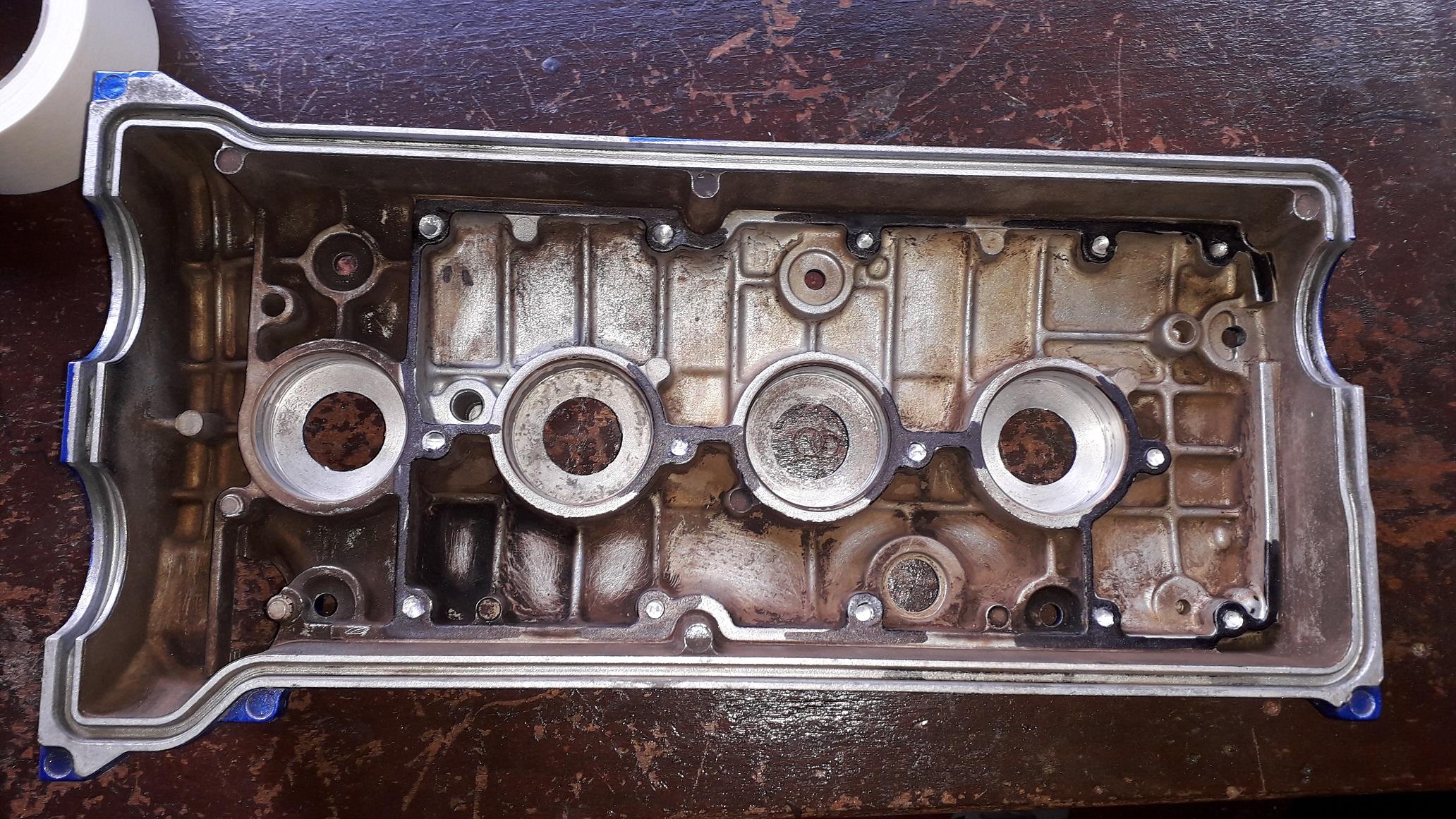

4efte cam cover re baffle.

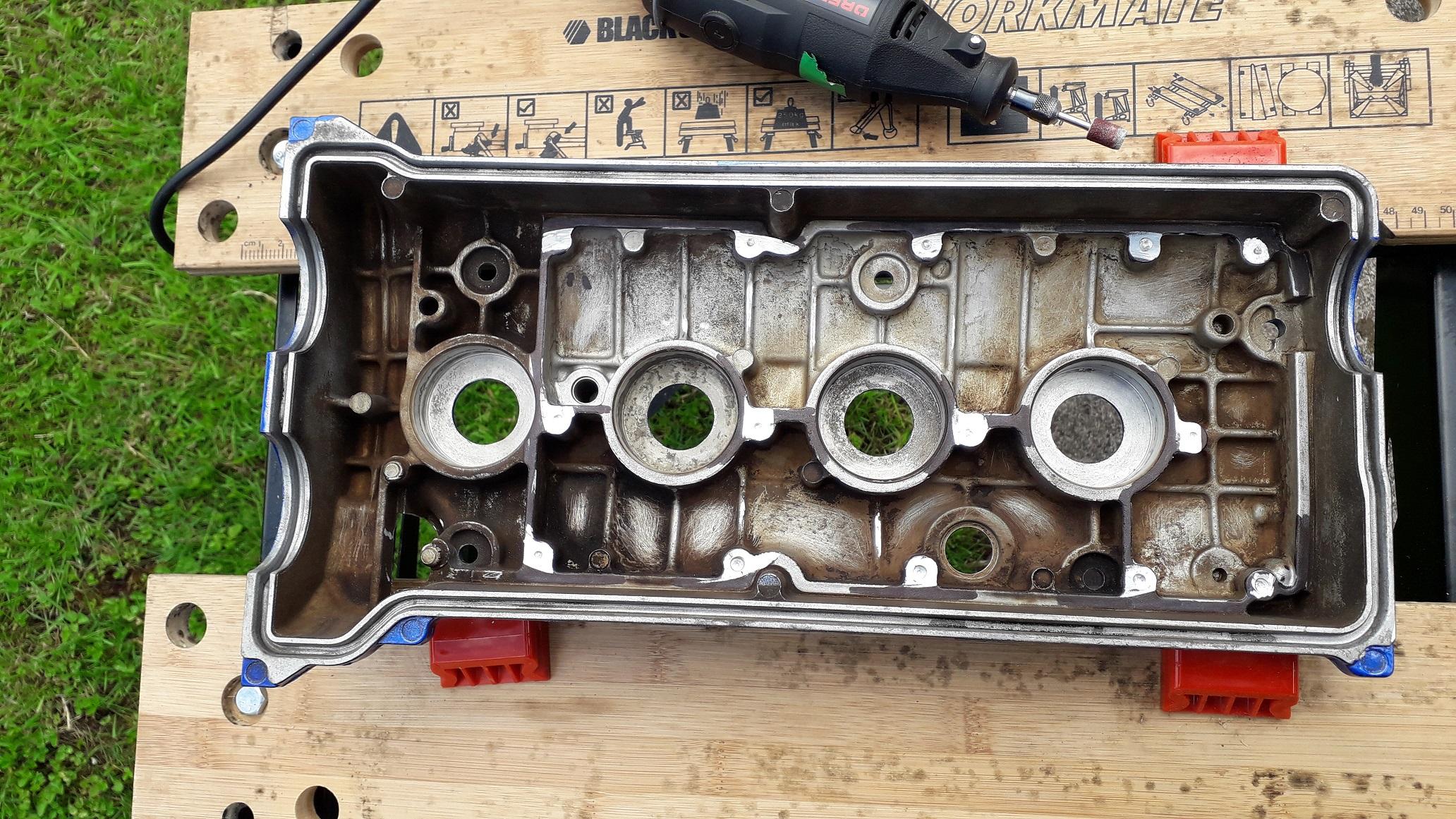

First I coloured the areas around the remains of the alu rivet posts with a sharpie (so I could see when I had removed all the post)
Sanded down the posts with a sanding wheel on the grinder and had to get the last 2 in the corners with the dremmel and drum sander. Also cleaned up the rougher parts of the casting while I was at it.
Decided that as my pillar drill bearings are totally boolaxed (leading to a nasty "wandering chuck"), I'd stand more of a chance using a cordless hand drill, so I clamped the cover to my workmate. I then carefully drilled 3mm pilot holes in the required locations.
Next I had to open the holes out to 5mm (drill size to tap M6).  First hole, broke my 5mm bit off.🤬
Note to self, don't buy cheap eBay drill bits, HSS means high speed (not slow speed because your scared of punting a hole right through) and there's always time for lubricant.
Thankfully the bit came out by hand, found a spare 5mm bit and the rest of the holes were no problem lubed up at speed.
M6 taper tap with grease (only another 12 holes to go) followed by modified plug tap (ground down tip to make into bottoming tap) to send the threads to bottom of the blind hole.
All done, ready for paint stripping.
Edited by Claymore

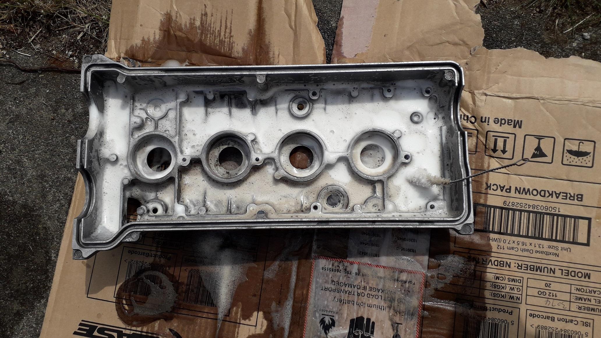

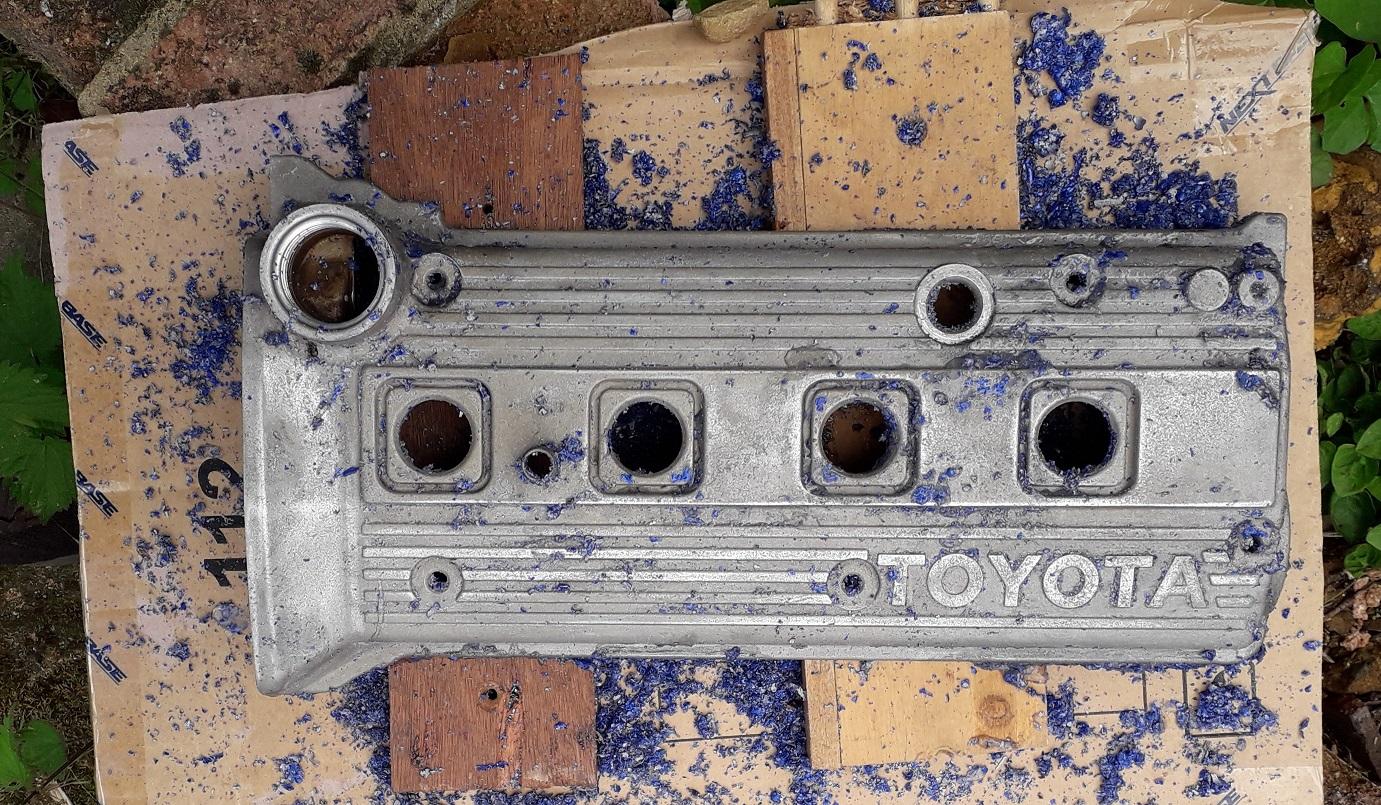

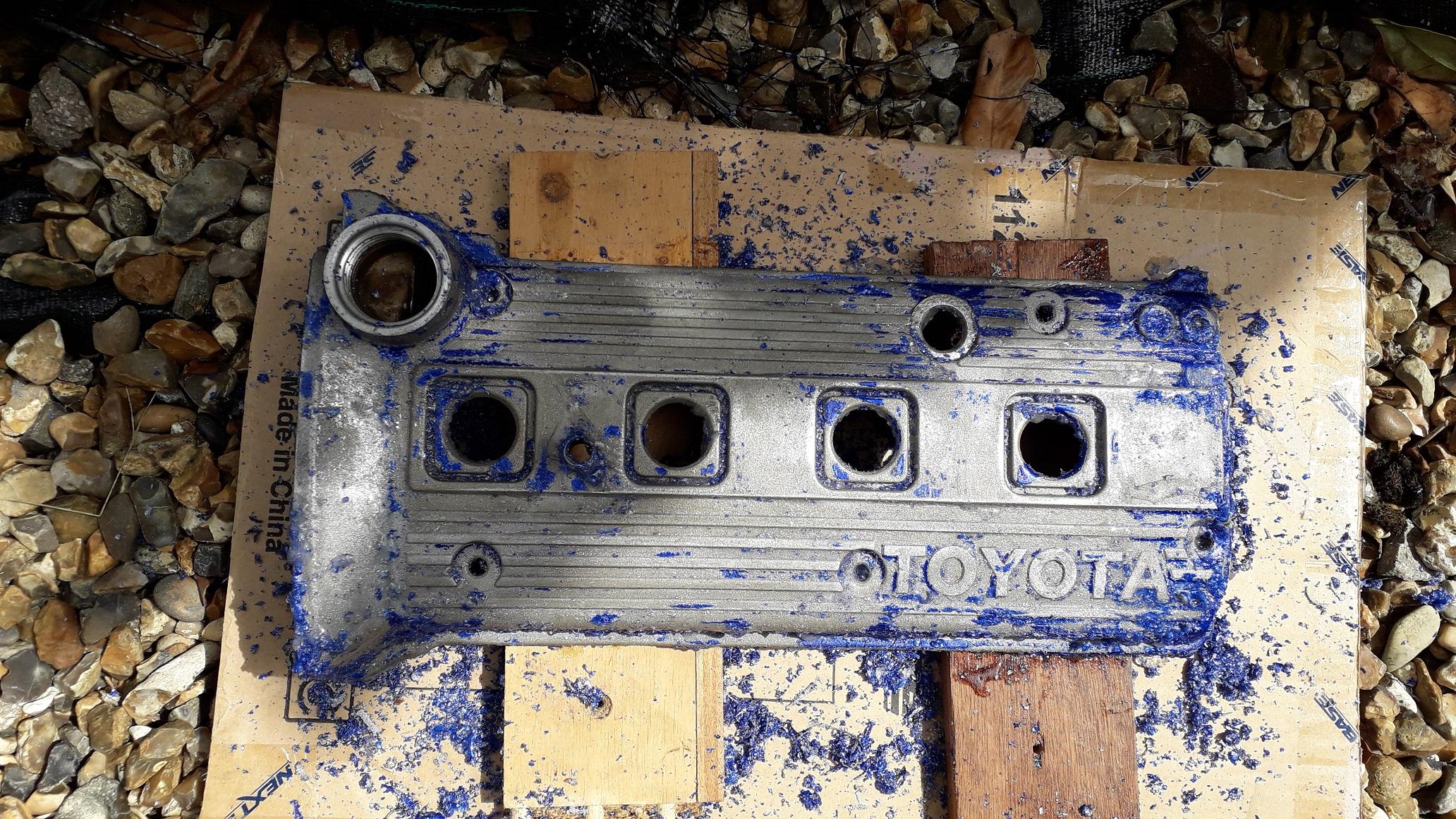

Paint stripping / internal de grease.
Bought some Power Strip paint stripper (saw it on another build thread). Pretty evil stuff, two coats had turned 90% of the paint to jelly.
Third coat did the rest.
After scraping off some remaining flakes, I rinsed it out with water and scrubbed it with a stiff brush to remove the remains of the paint stripper and paint. Its only 3 photos but it took about 3 hours and was not pleasant working with chemicals like these.
Needed to clean the varnish / oil residue off the inside. Decided to use alloy wheel cleaner this time and it worked a treat. Wire brush was used to scrub the residue while the cleaner fizzed the rest away. 3 rounds later I was happy.

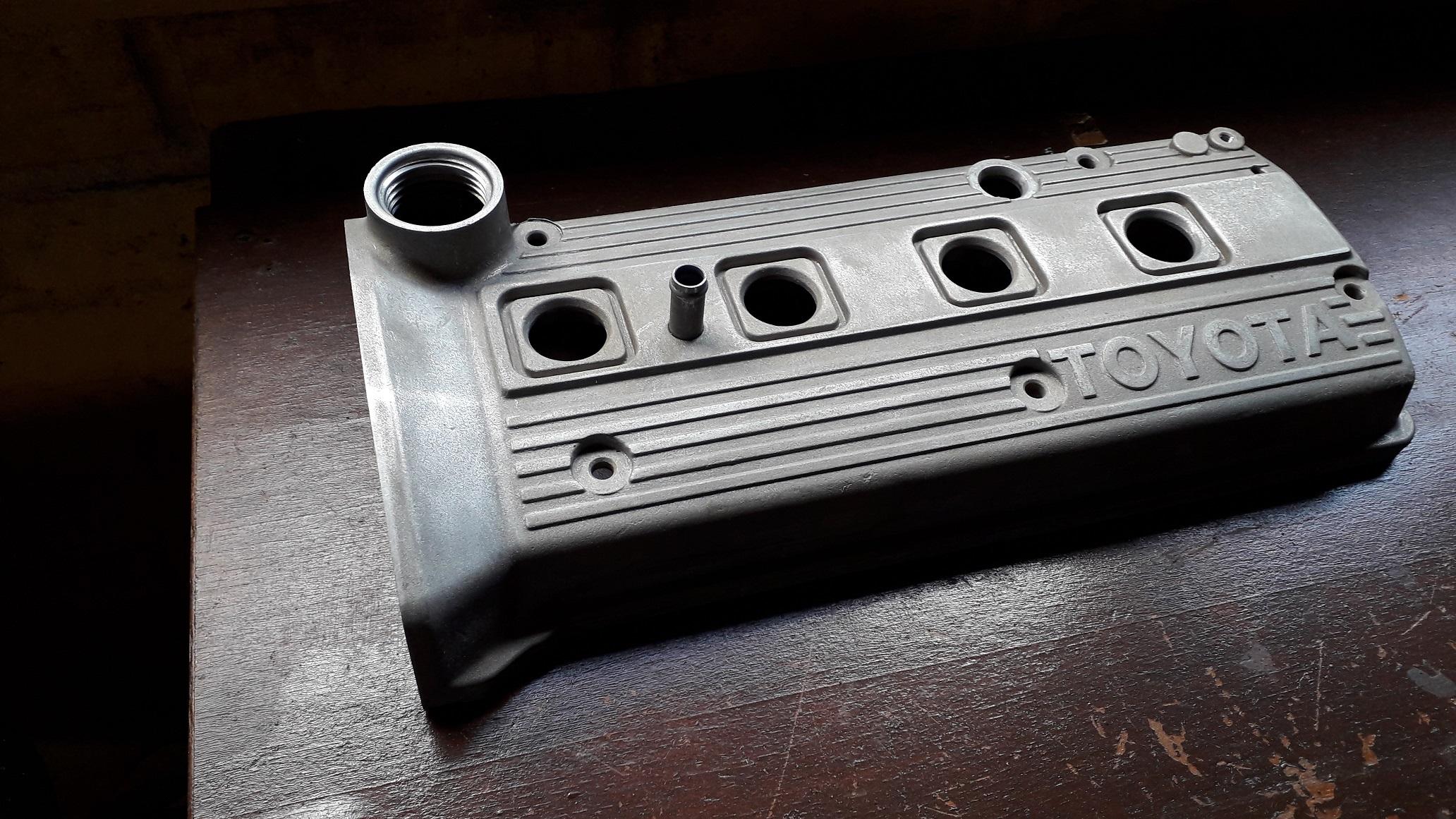

Cleaned out ready to re assemble. Might get the baffle plates re plated before hand so its all fresh.
Took a total of 12hrs from start to this point. A labour of love but better than chucking it.
Edited by Claymore

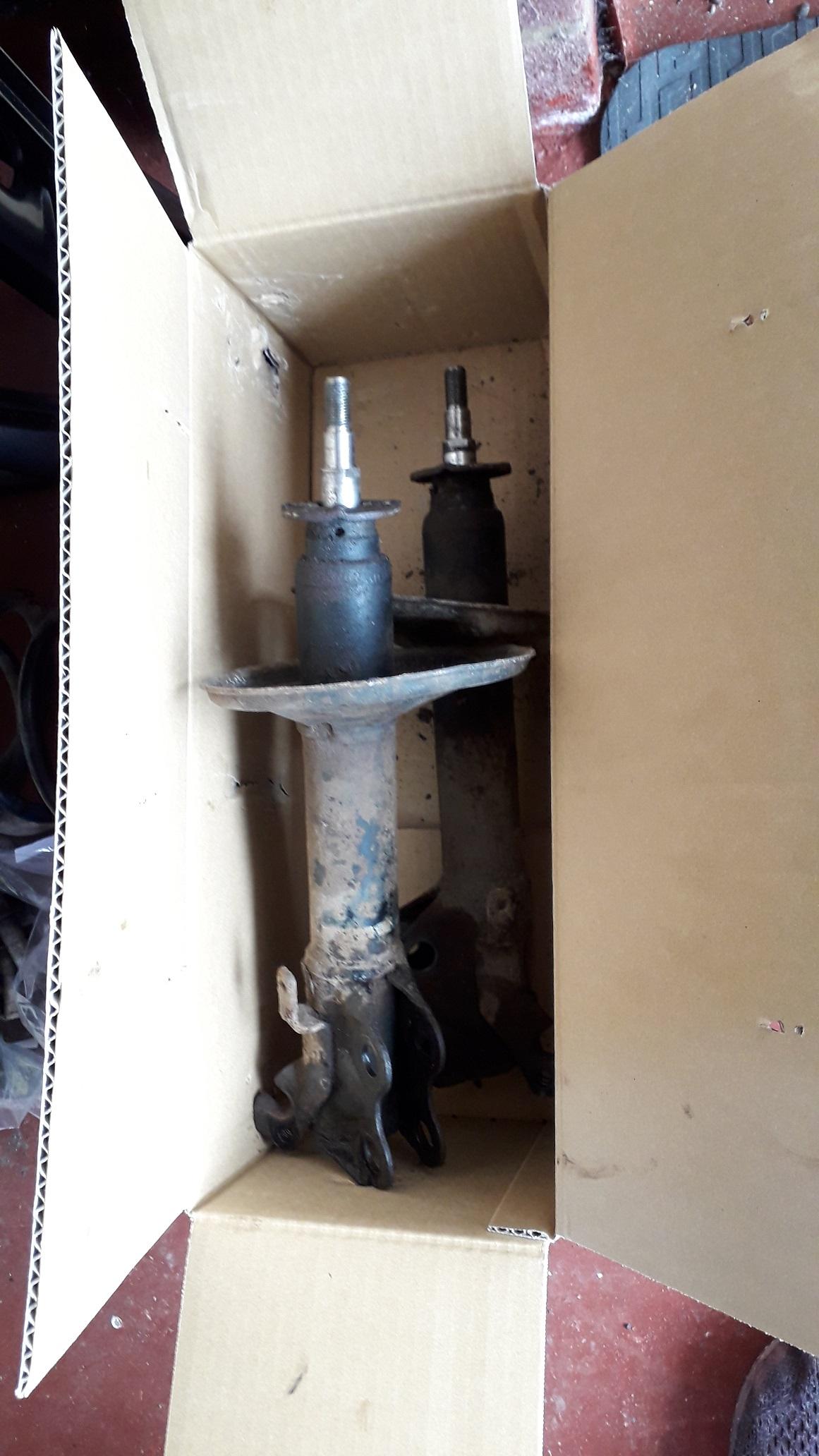

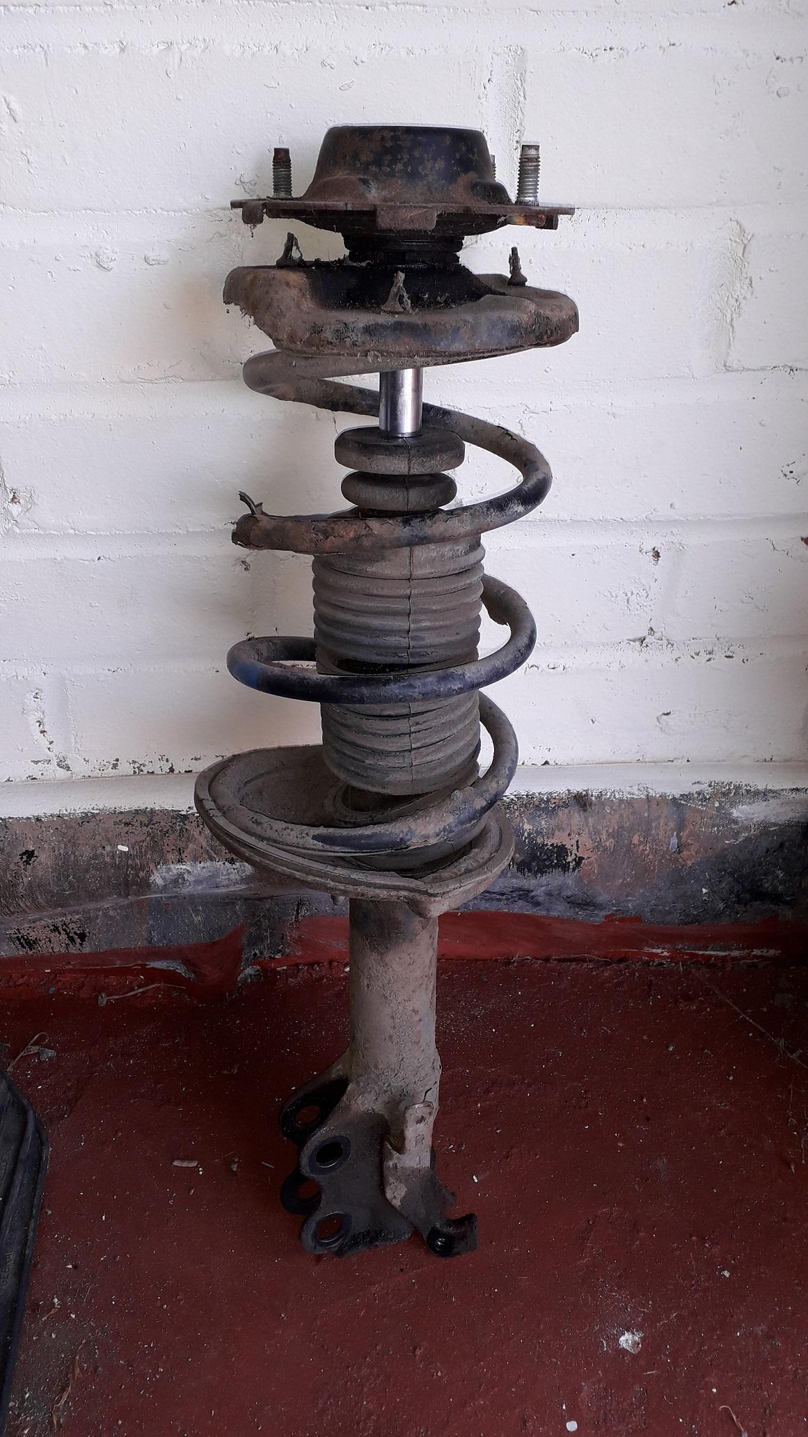

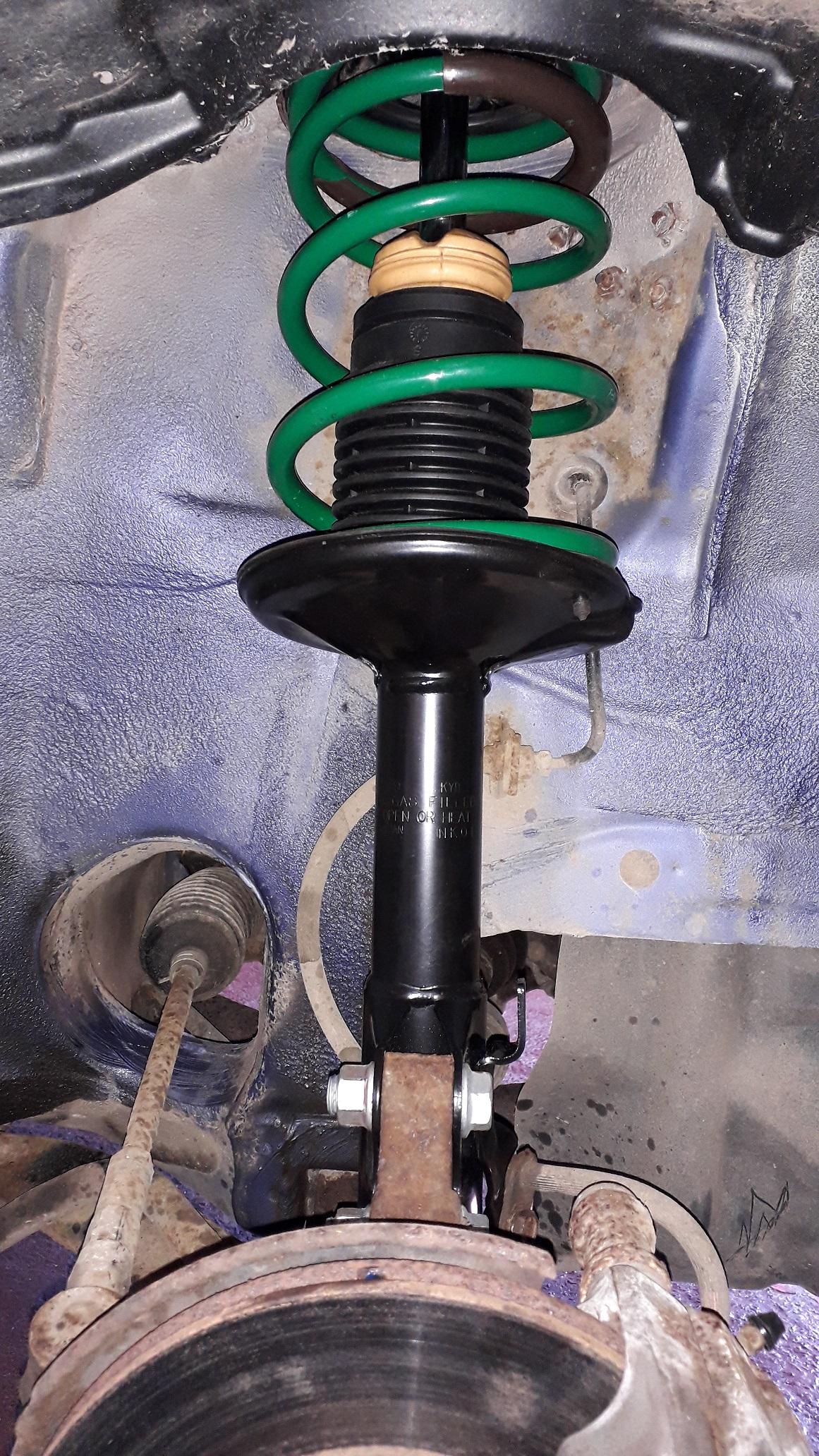

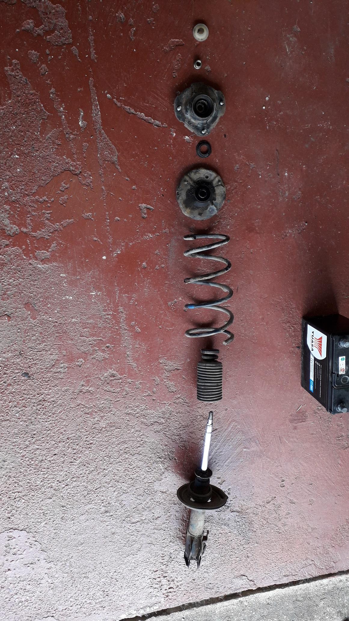

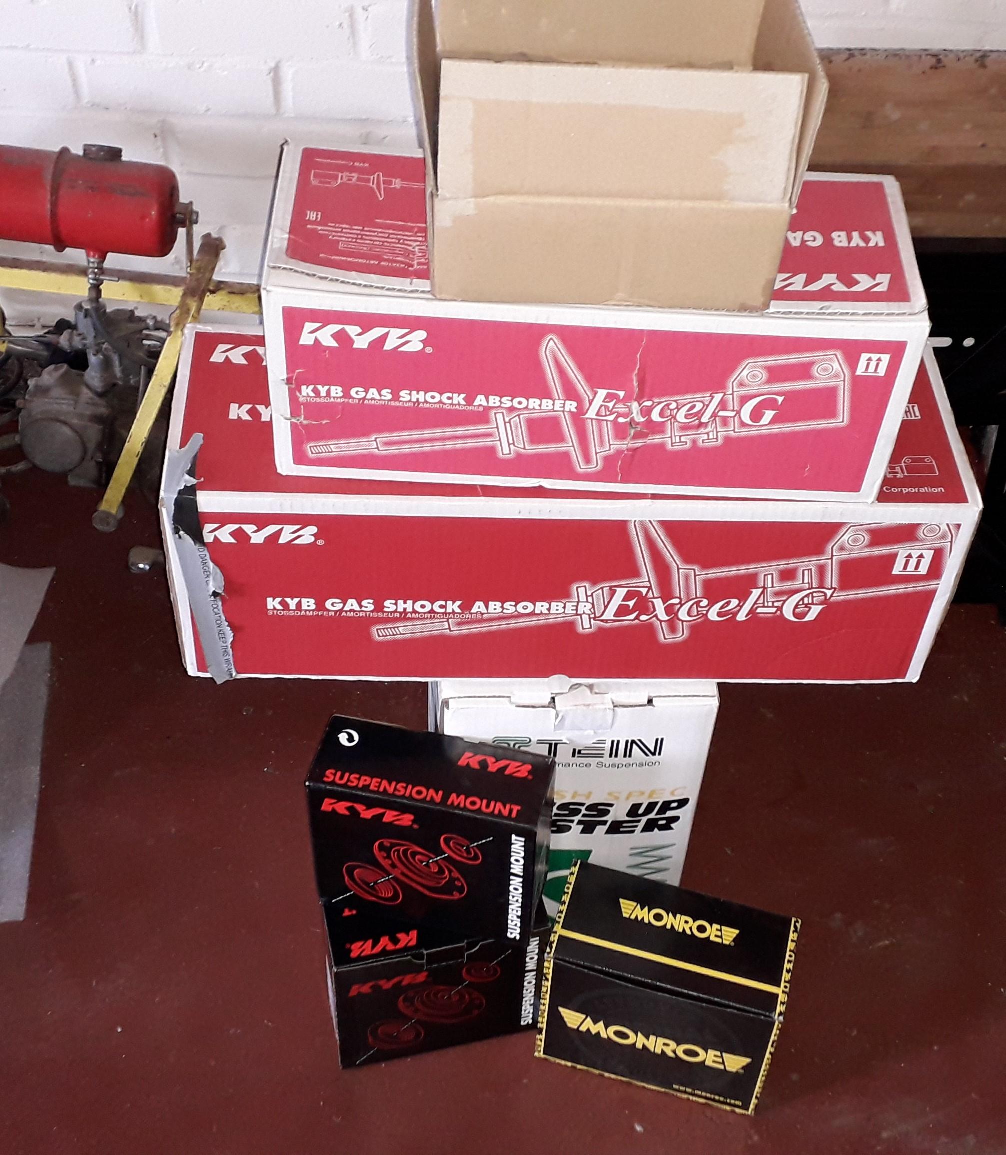

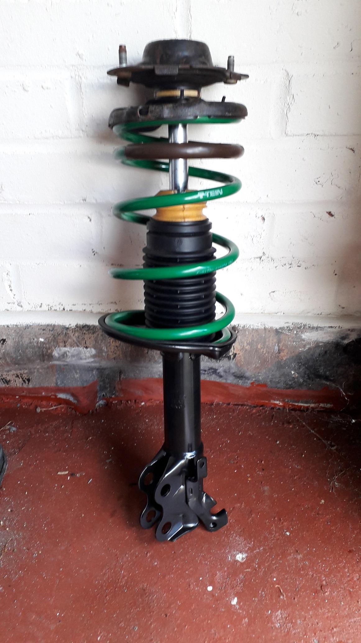

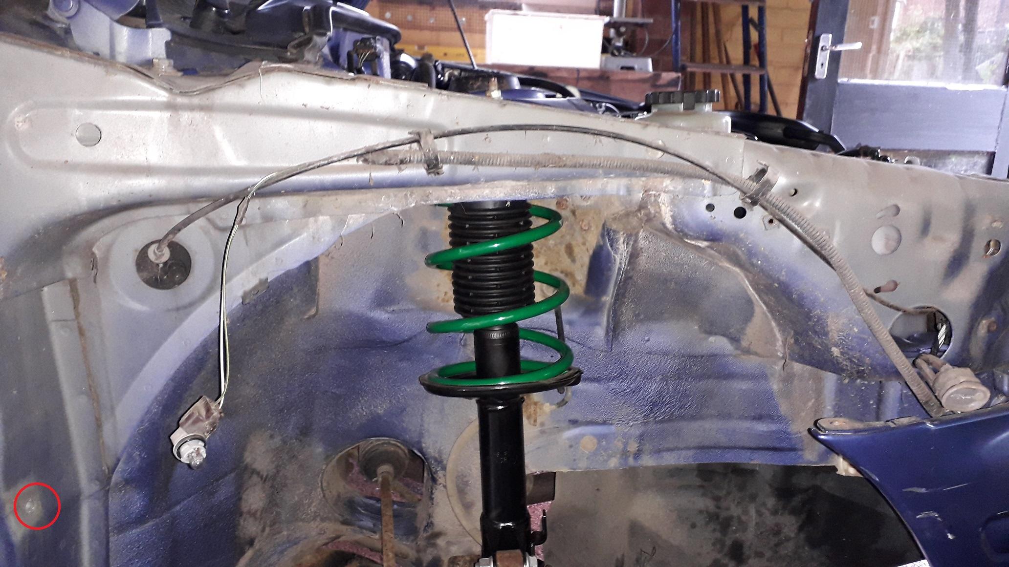

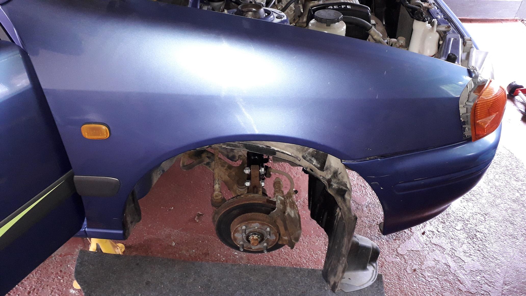

Front KYB Excel g shocks and Tein springs install.

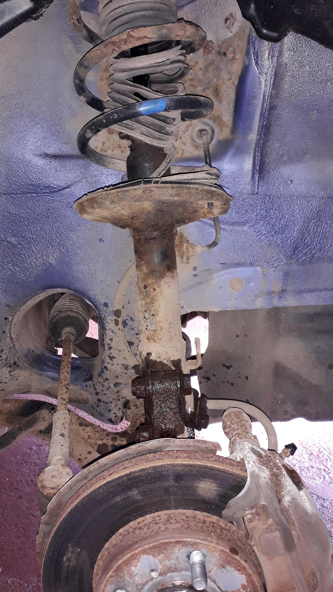

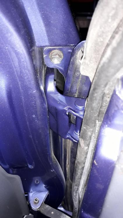

The suspension was pretty tired and both front shocks were weeping slightly, upon inspection they were branded Toyota so I believe they are most likely the original shocks. Got some new top mounts (didn't fit but more on this later), Monroe bump stops (PK054), spring pads, lower bolts and nuts and dust seals and KYB shocks (333209, 333210).

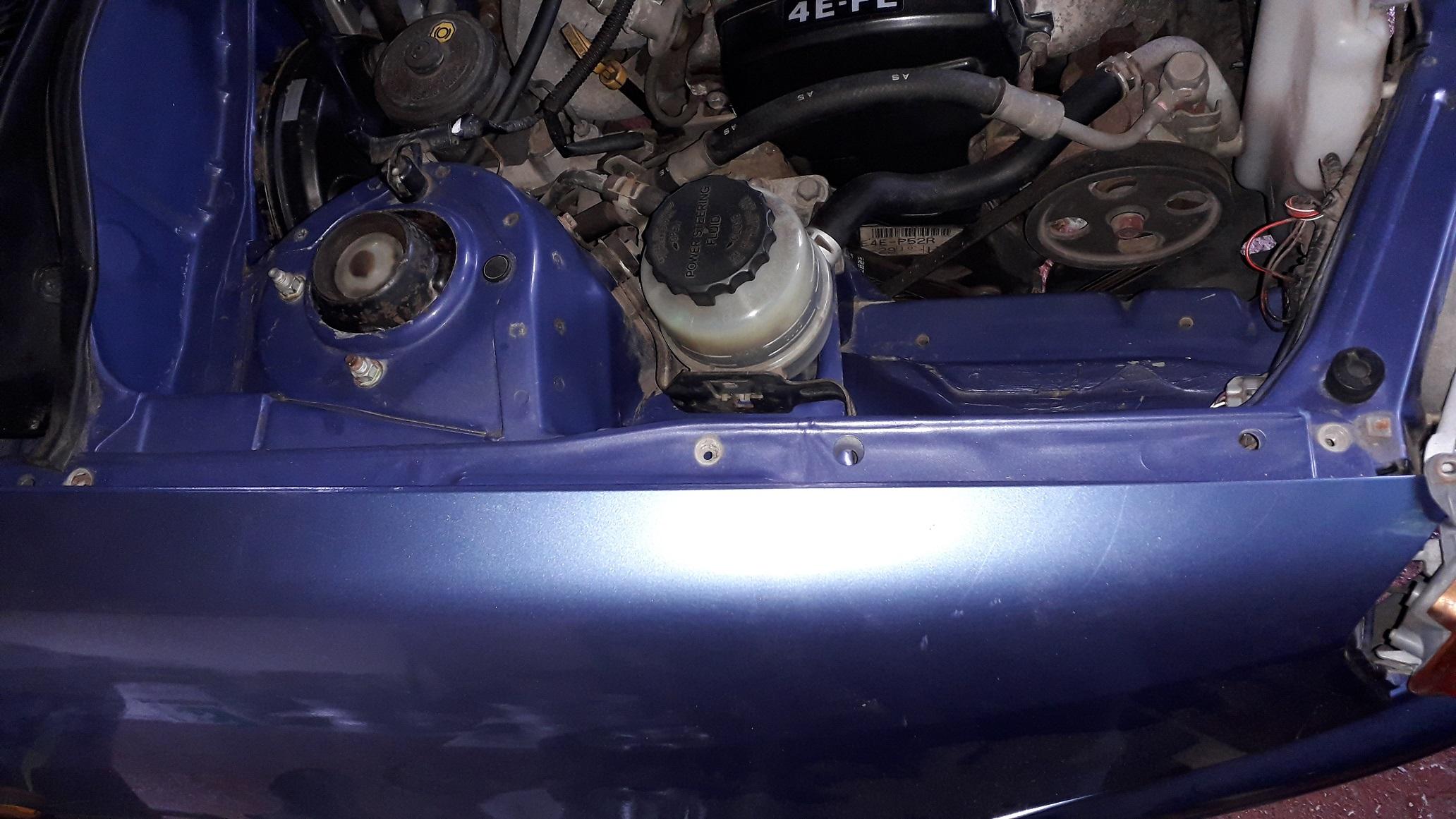

Firstly I loosened the 3 x top shock mount nuts in the engine bay and then removed the bolt holding the brake line to the bottom of the shock. After letting the 2 x lower shock nuts soak for a while in WD40 I loosened and removed them with the help of 2 x large breaker bars. Removed the 3 x top mount nuts and the shock assembly was all mine. Easy Peasy.
As removed, rusty leaky mess, bump stop bellows were perished, lower spring pad was shagged too.

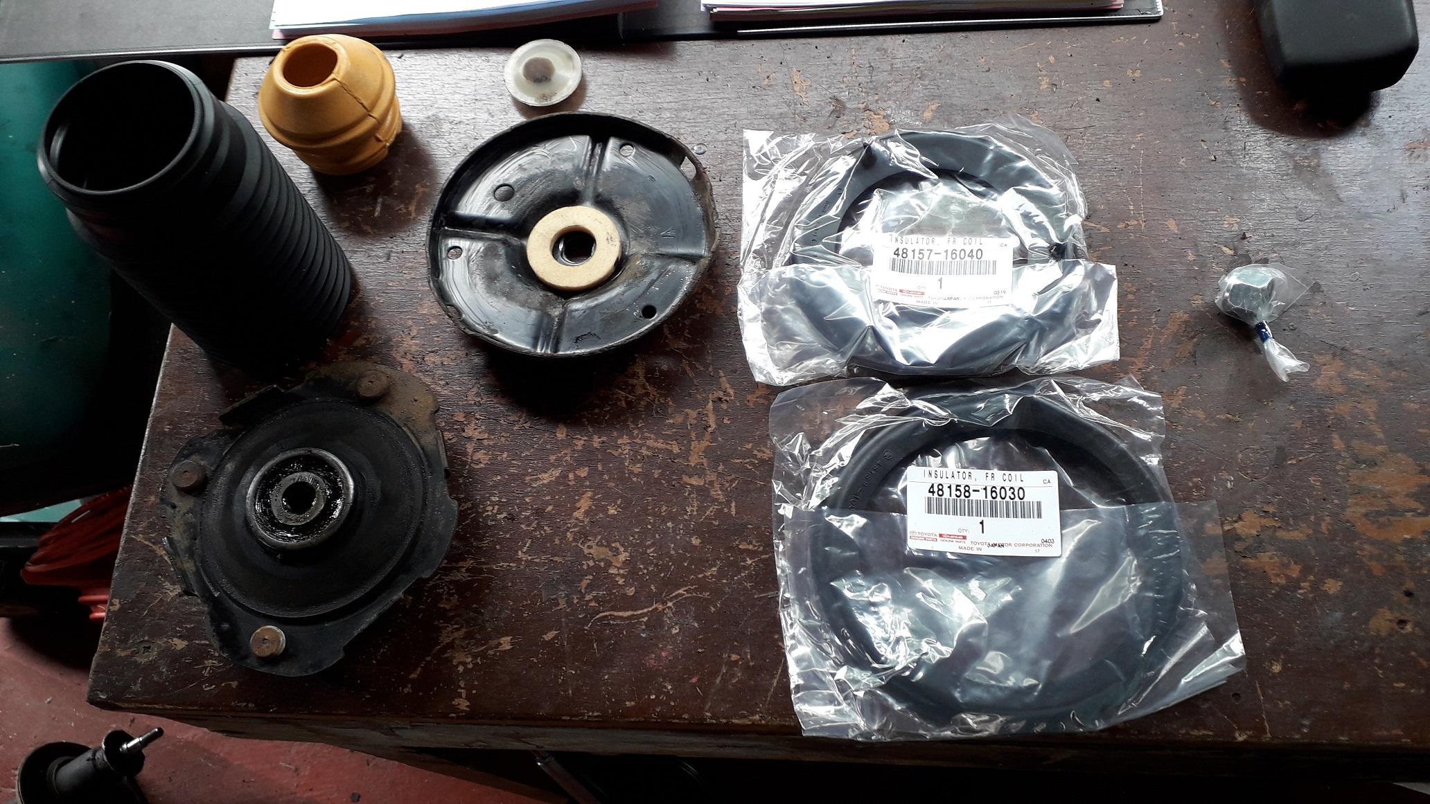

Used the spring compressors to compress the spring which took the tension off the top mount, I removed the dust cover to reveal the top shock nut which I removed.

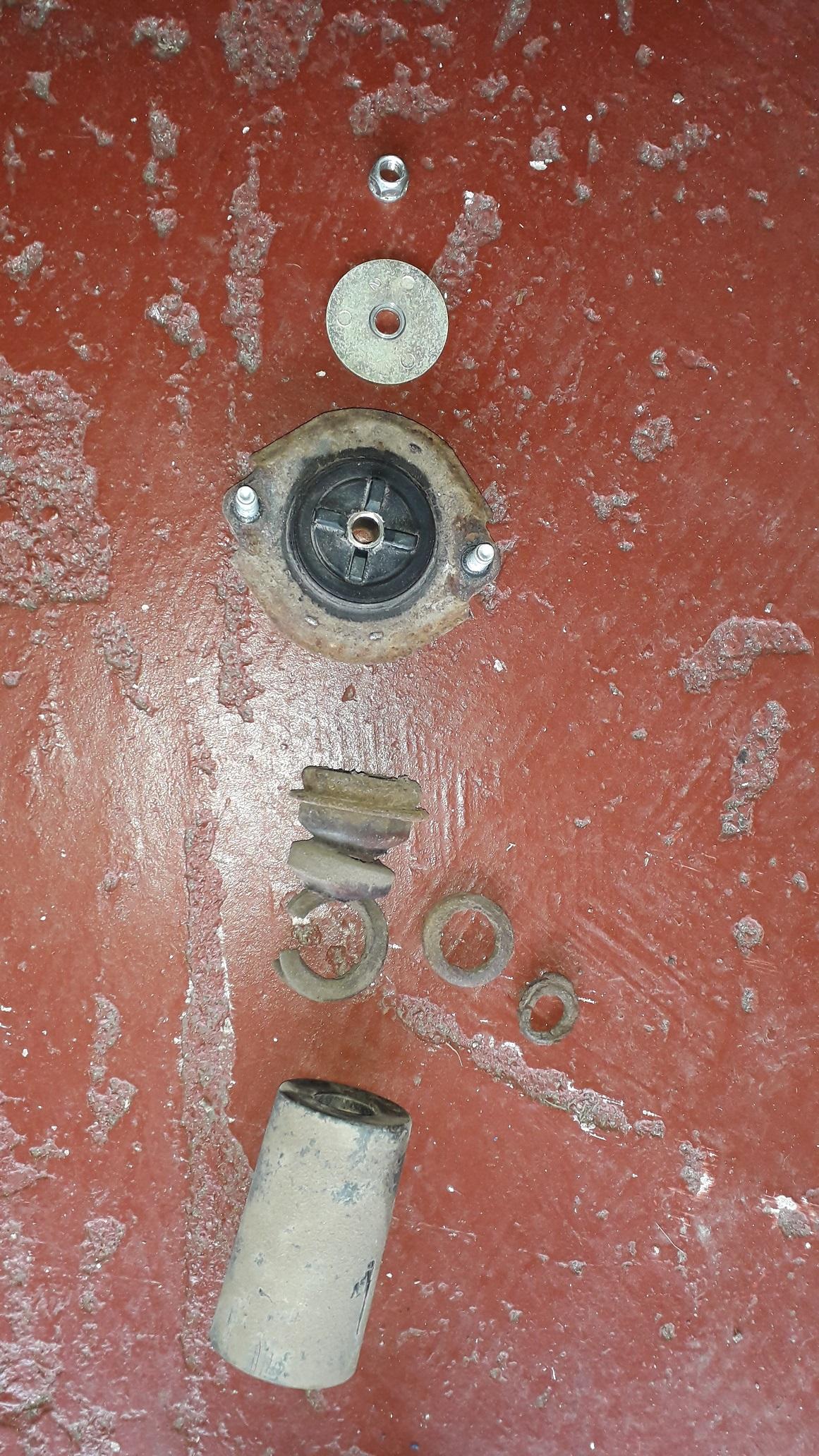

The laid out components below are: dust cover, top shock nut, top mount, sponge dust shield (to protect top mount bearing), upper spring perch (with upper spring pad fitted), spring.

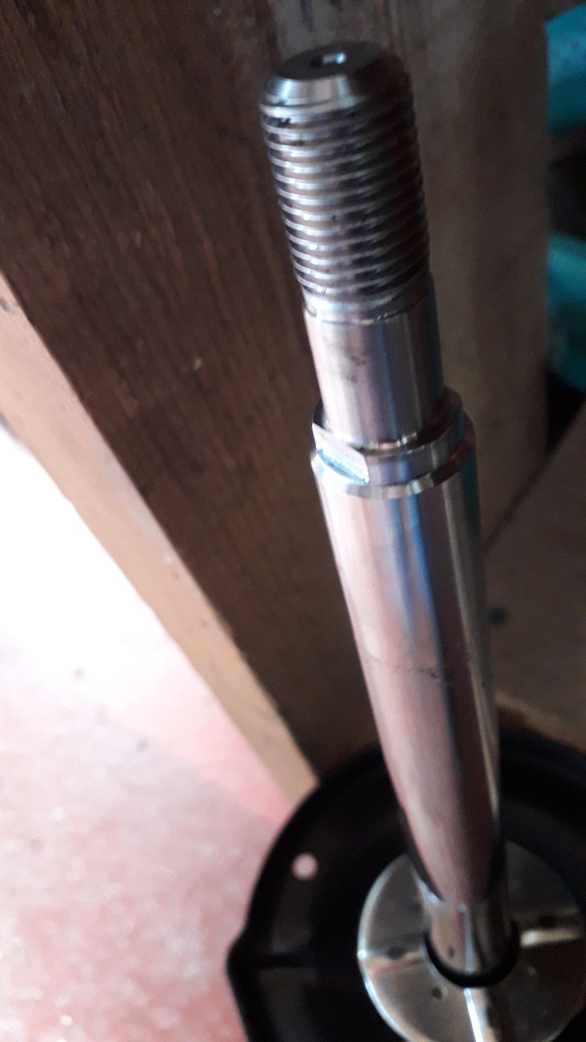

Old shocks were so knackered they couldn't even push out their own piston rod.
Just a note, there are 2 different types of upper spring perch, the internal and external. These are the external type which wrap over the outside of the spring. There are 2 x flats on the inner hole and these line up with...
the 2 x flats on the sides of the shock shaft.

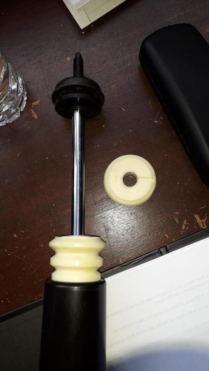

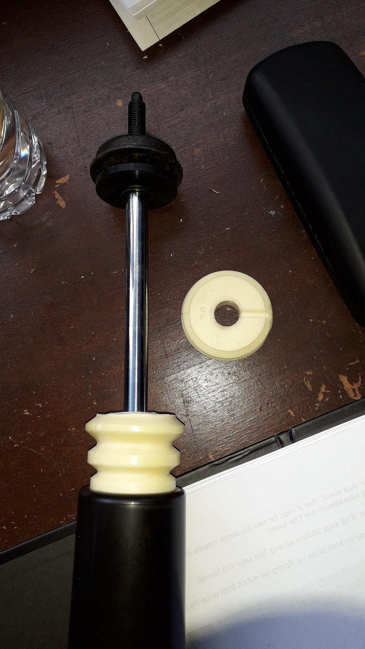

New and old parts prepared for assembly. Had to use the old top shock mounts as the new KYB ones specified for the vehicle on eBay don't fit. 🤬. the new mounts had a 15mm hole in the centre and the shock is only 14mm so it rattled like a dick in a bowler hat. Thankfully the old mounts were serviceable so I had to use those instead. The sponge dust shield goes on top of the spring perch (not in it as shown below). Tidied up the old components with rust treatment and painted them.
So, I replaced the lower spring pad, fitted the new bump stop and bellows, compressed the new spring and fitted it, added the upper spring perch with new spring pad, new dust seal, shitty old top mount 🙄 and new nut and dust cover.
Back in it went, top mount nuts attached loosely first, then bottom bolts (bought new bolts and nuts as its quite likely the old ones will be rusty and may well damage the threads upon removal.) Fully tightened the top nuts, then bottom bolts. Finally bolted the brake line back on as well.
Repeated for other side. Rears next...
Edited by Claymore
Part numbers added

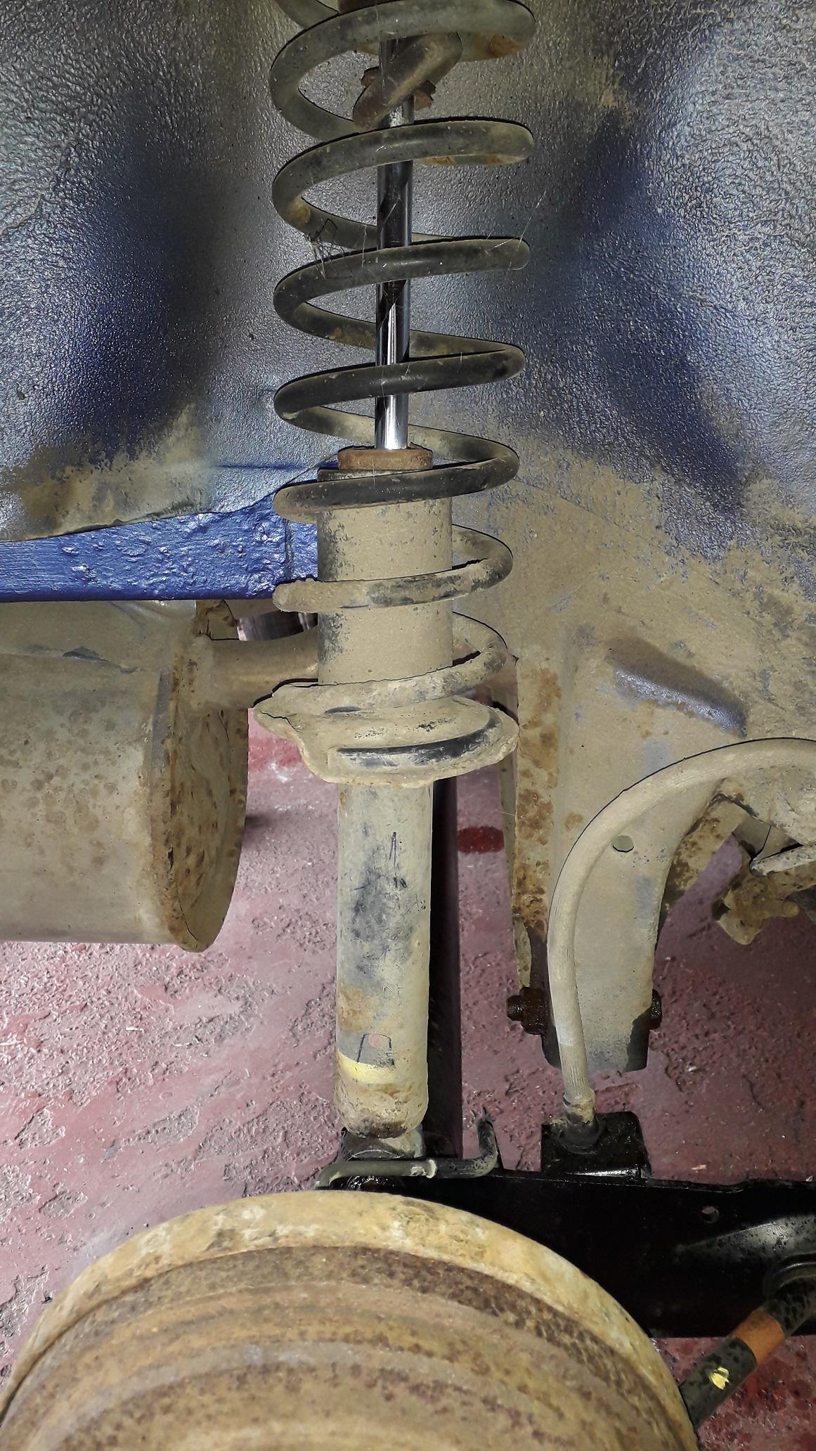

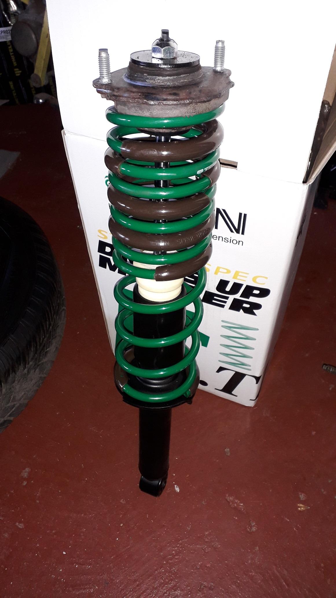

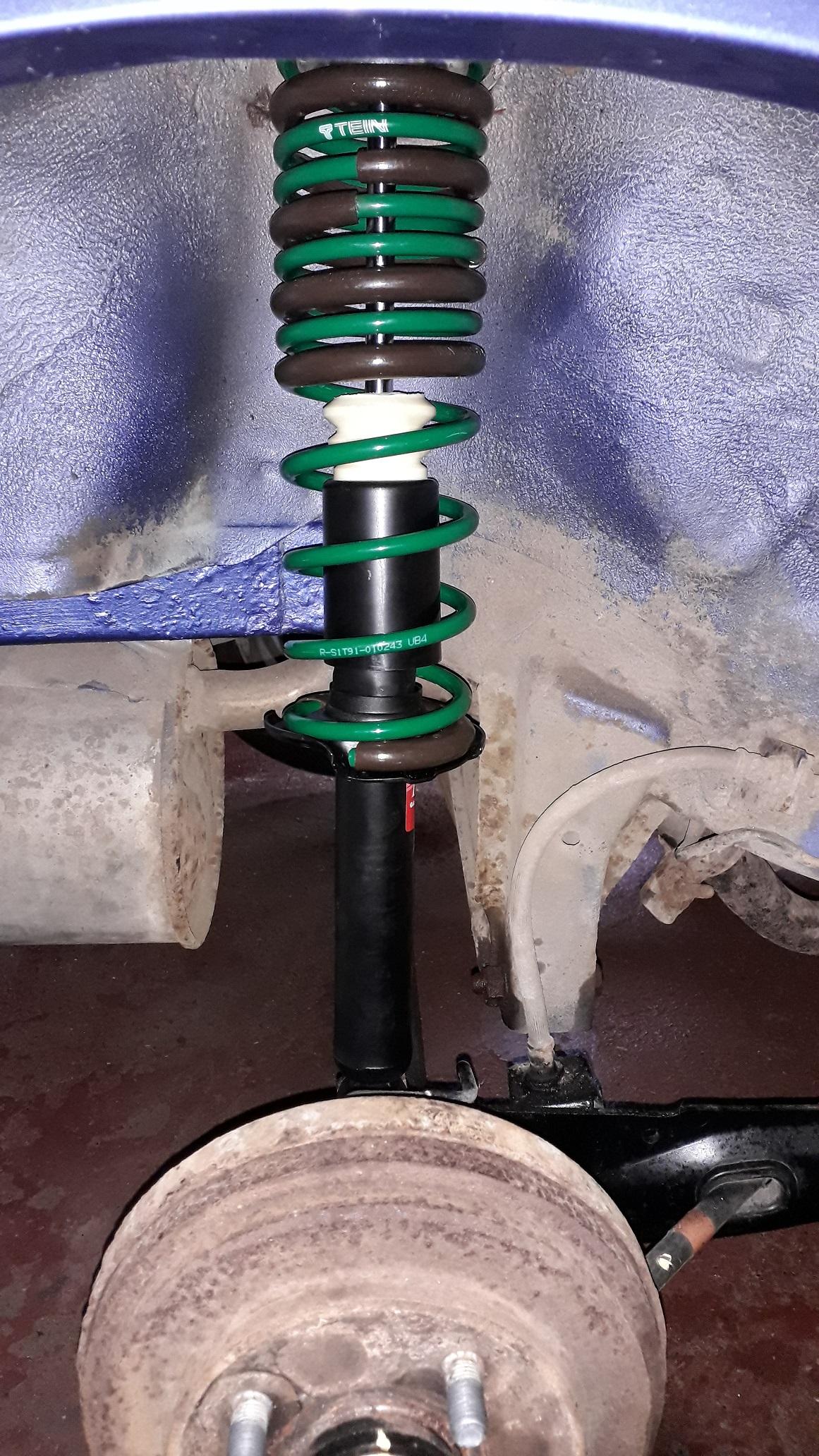

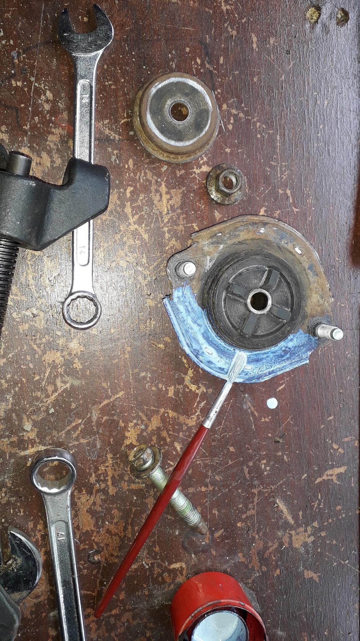

Rear KYB Excel g shocks and Tein springs install.
Again both rear shocks were branded Toyota so I believe they are most likely the original shocks. Got some new top mounts (didn't fit AGAIN but more on this later) and KYB shock absorbers (341191). The bump stop had rotted and was disintegrating.
Firstly I loosened the 2 x outer top shock mount nuts in the boot under the plastic covers (not the middle nut).
After letting the lower shock mount nut soak for a while in WD40 I loosened and removed it. Removed the 2 x upper mount nuts and the strut was out.
Used the spring compressors to compress the spring which took the tension off the top mount, I removed the top shock nut  using a ring spanner with an open ended spanner on the flats on the end of the shock shaft.

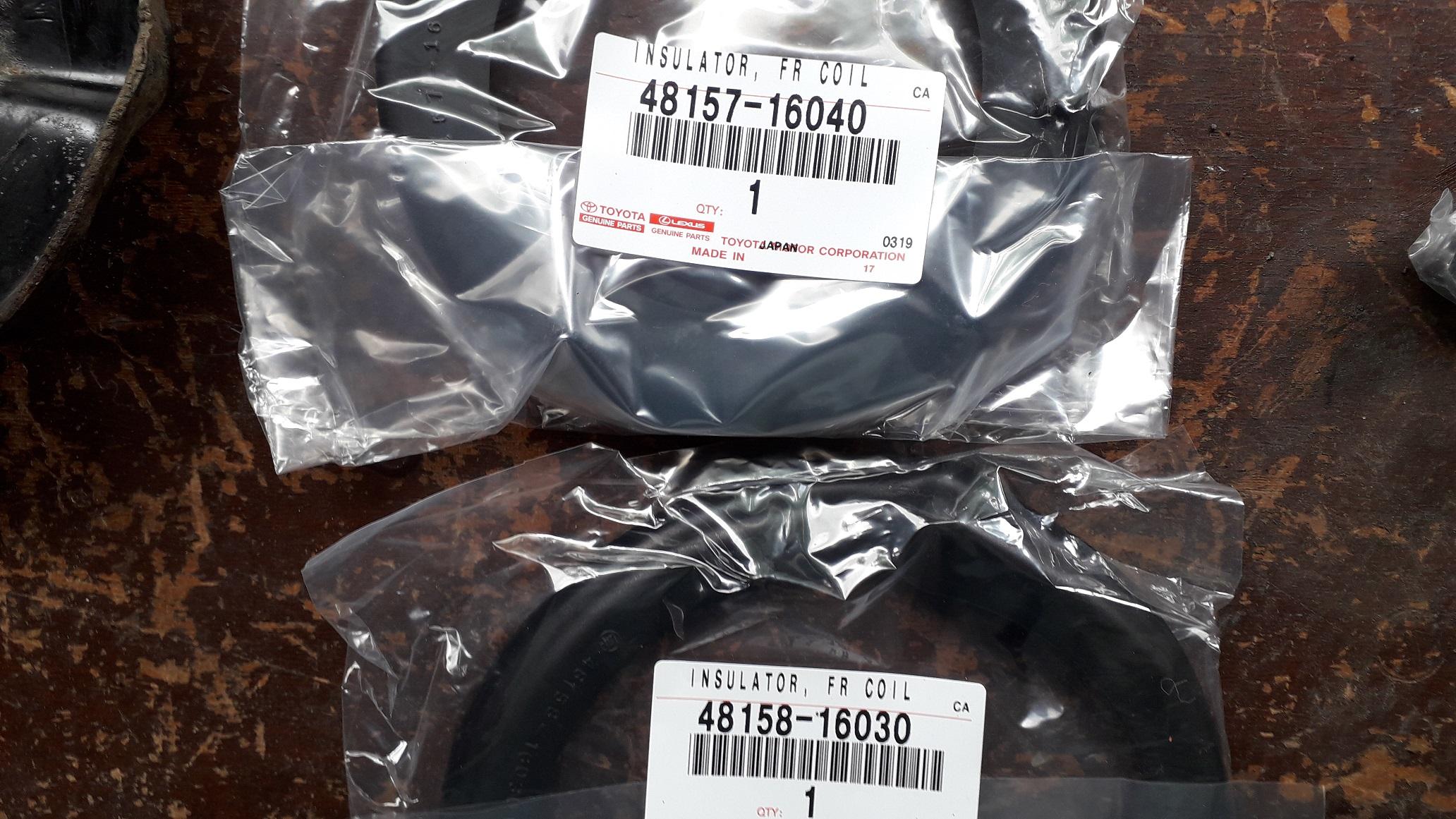

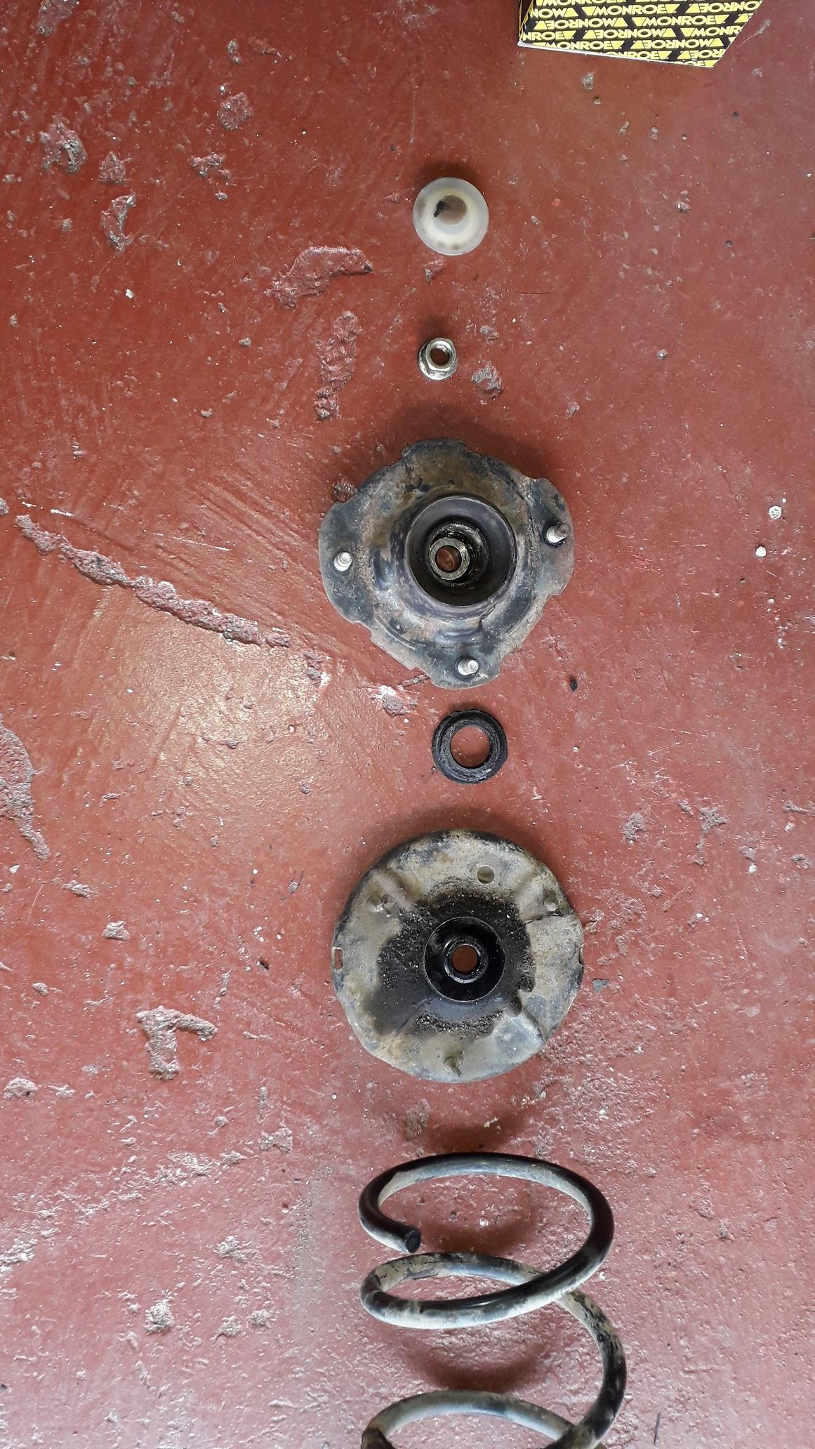

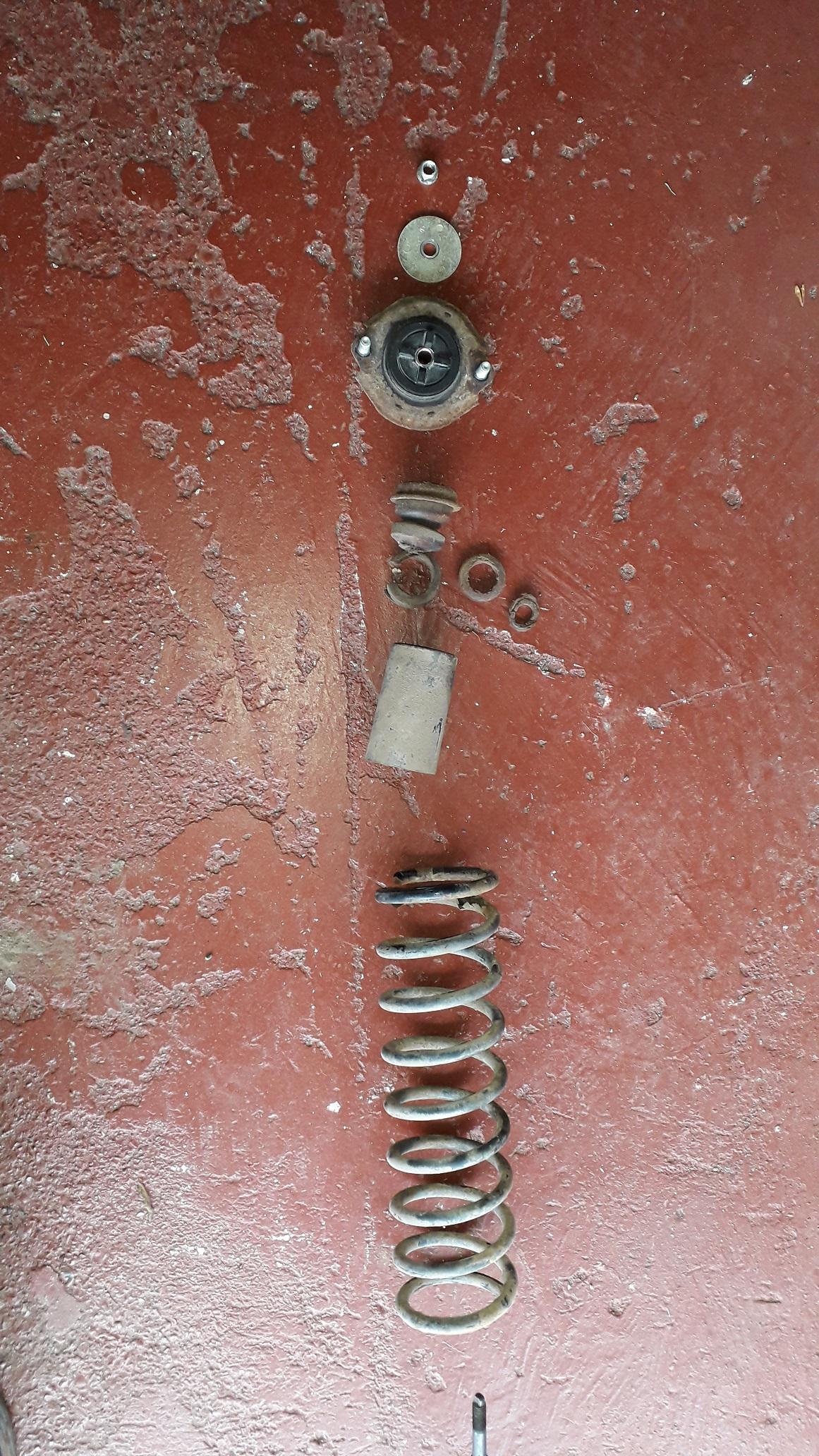

Components shown below: Top shock nut, mount washer, top shock mount, metal cup washer for bump stop, knackered bump stop, dust shield.

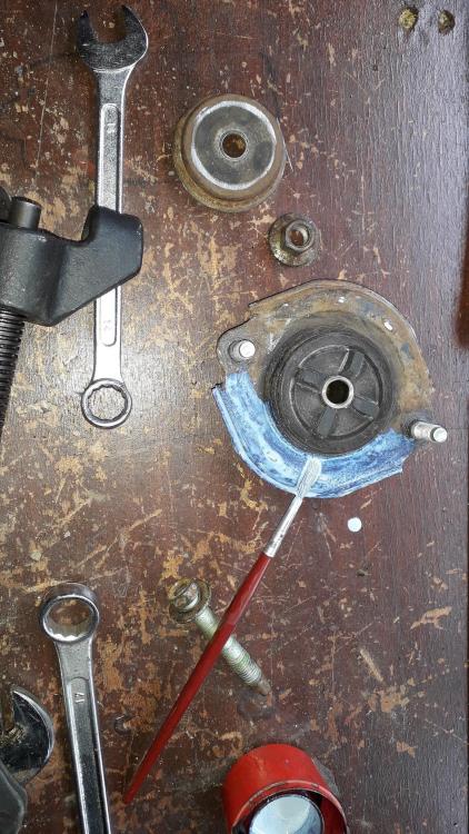

Turns out the rear top mounts listed on eBay don't fit either! This time the spring perch was too small for the internal diameter of the spring so this time it was the mounts turn to be the dick in the bowler hat!
Treated the rusty parts and painted them.
Decided also to cut approx. 12mm off the bump stop as there was less travel with the shorter springs and the stops were pretty hard. I left the fronts at full length as they were quite soft and could be compressed with reasonable force by hand.
So, I fitted the new bump stop and dust shield, compressed the new spring and fitted it, added the metal cup washer, shitty old top mount with integral spring pad 😤, mount washer and new nut. I set the top mounting bolts at a 45 degree angle to the lower mount hole as rotating it with the spring pressure on is impossible.
Back in it went, top mount nuts attached loosely first, then bottom bolt and nut. Fully tightened the top nuts, then set the car at ride height before tightening the bottom bolt.
Rinse and repeat for other side.

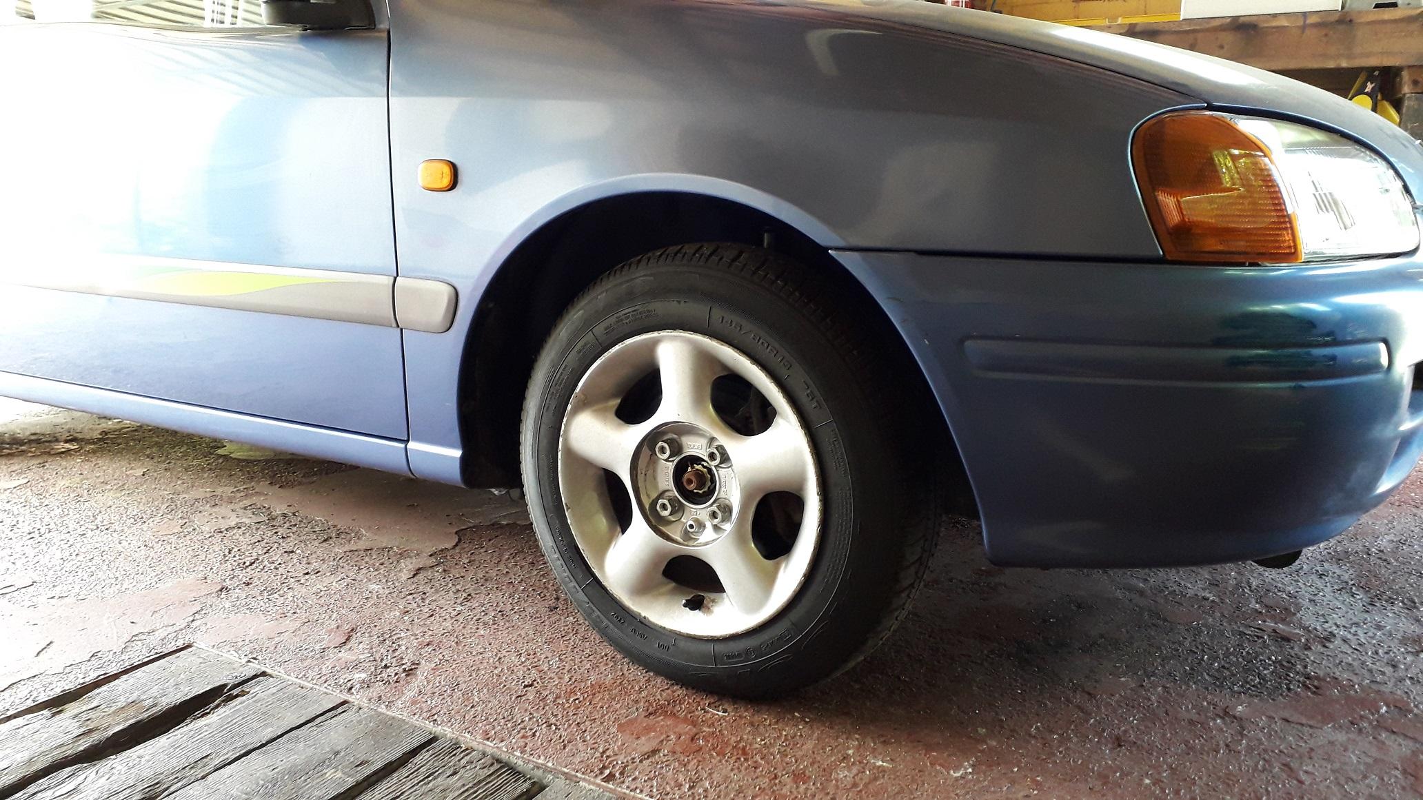

It sits about 40mm lower all round, I think its just right for a sleeper and may settle a bit more after driving it a bit.
Edited by Claymore
Part number added

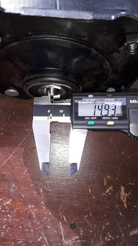

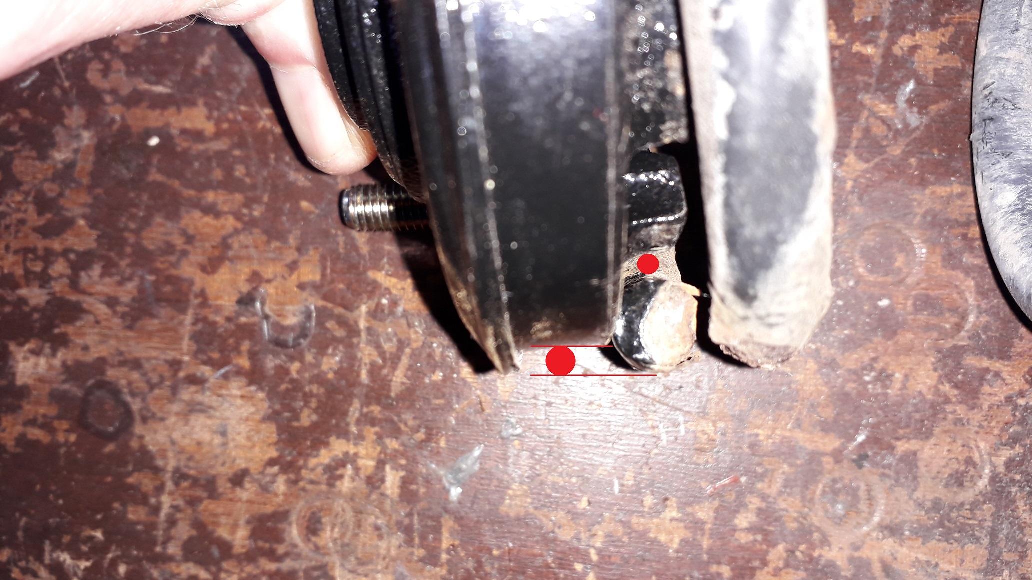

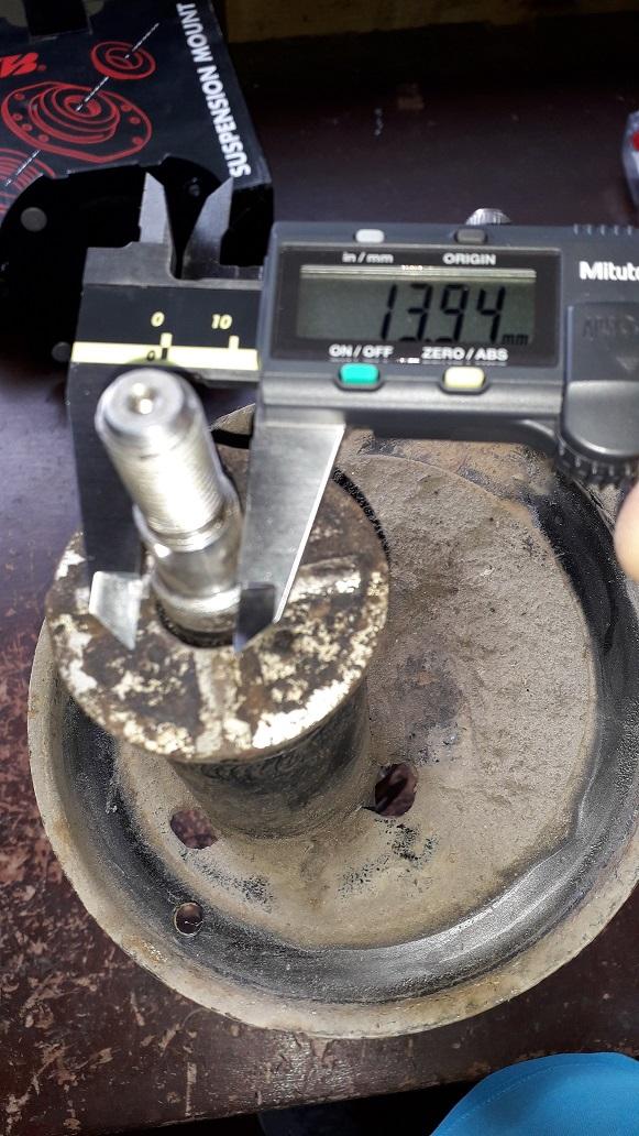

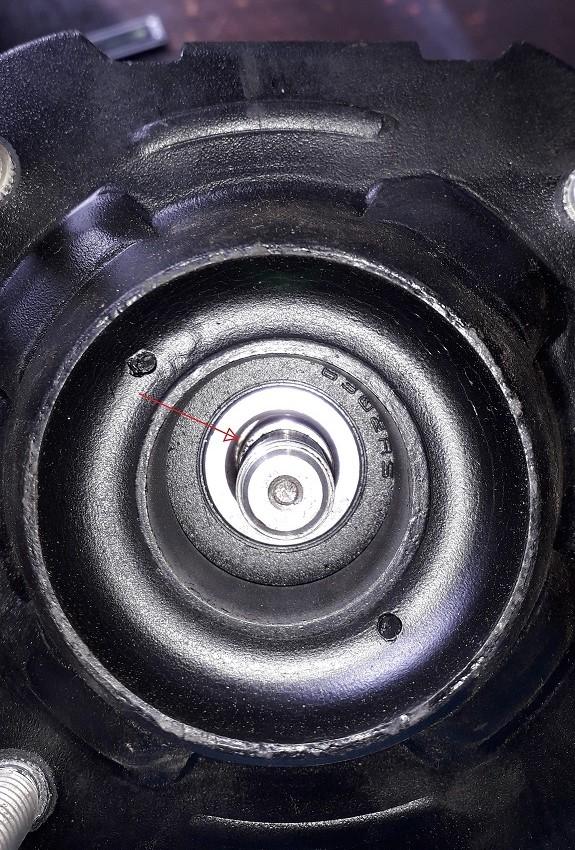

Wrong mount detail:
The fronts were KYB SM5089, they were listed on eBay as fitting the EP91. I even sent the vehicle details to the seller to confirm.

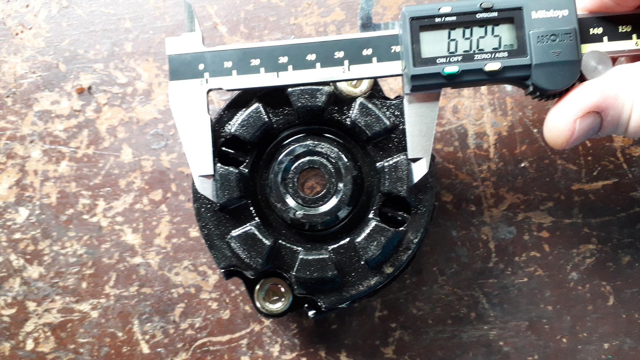

The shock mount hole is 15mm and the top mount has 3 x studs and a nut insert making 4 mounting fasteners where the EP91 only uses 3.
Both original Toyota and KYB Excel g replacement shock absorbers were 14mm shaft.
Gap shown with arrow, deffo not suitable for the car / shock.
I have done some quick research into the possible fitments and they might be the mounts for an EP82. Can't confirm physically unless someone out there has measured up an EP82? Sent back now for a refund anyhow. I have also informed KYB who said they will investigate.
The rears were Magnum A72015MT also listed for the EP91 and Again confirmed with seller before purchase.

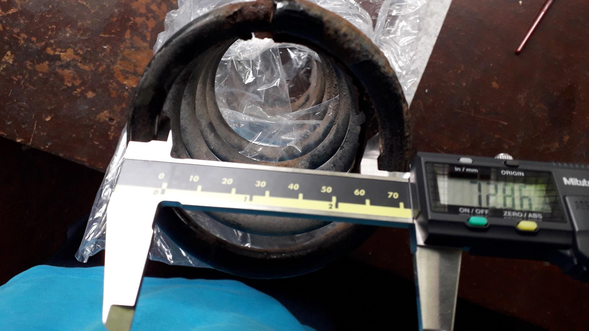

Spring seat diameter 69mm.
Inner spring diameter 73mm.
Spring was loose on the mount by 4mm. Wouldn't seat correctly.
Hopefully this will save others wasting their time.

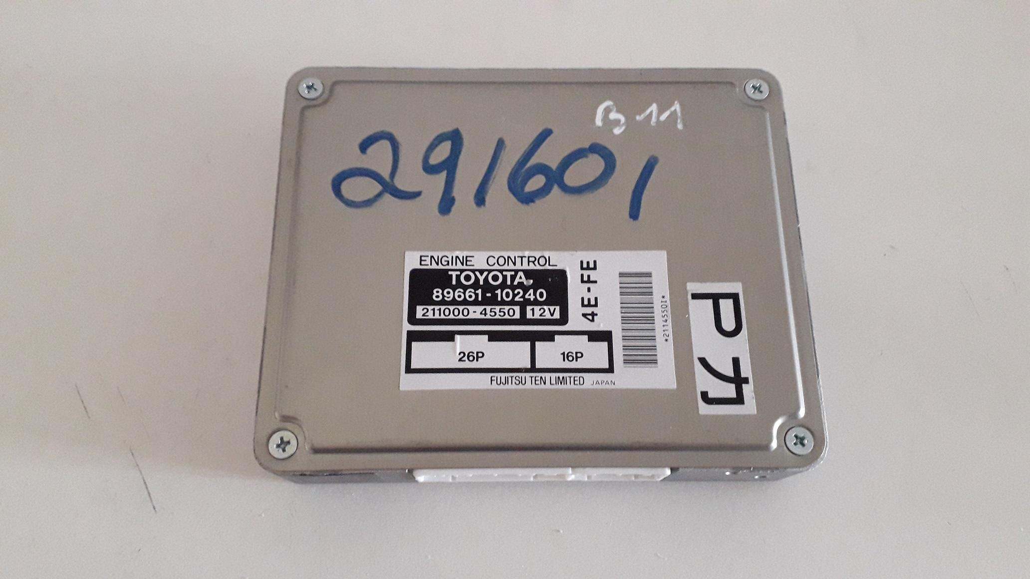

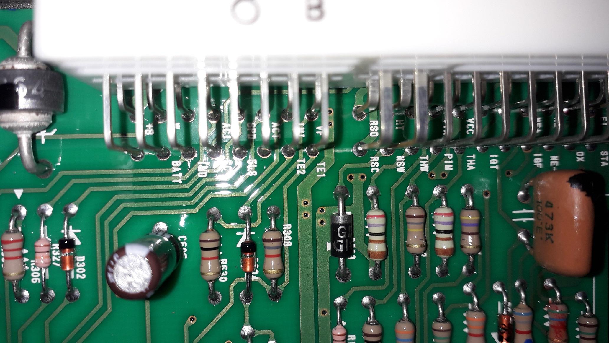

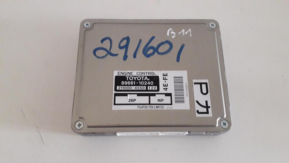

Been looking for information regarding ECU pinouts for the upcoming piggy back fitment and found several different versions online that vary in accuracy and also most contradict each other! Some refer to wires for the gtt or glanza and some have their intended purposes mixed up. I also couldn't find one that was for the particular ECU part number and we know that the 96/97 car wiring is different to the 98/99 wiring.
In all fairness the 4 important wires for the piggy back are almost correctly listed but curiosity got the better of me so I managed to find and purchase this. Although it is the European/German version there are English equivalent diagrams and explanations, plus it easier to translate German than Japanese.
Also purchased a spare ECU to play with, they're only cheap and I've had ECU's crap out on me before.
Upon opening the ECU to check its condition I was happy to see that the board is also labelled with the connectors pins intended purpose! So if you need to know which wire does what you can always remove your ECU and check under the cover.
I have checked and the ECU board pinout matches the wiring diagram in the book 😃. I'm looking into making an ECU pinout table for this ECU part number.
Edited by Claymore

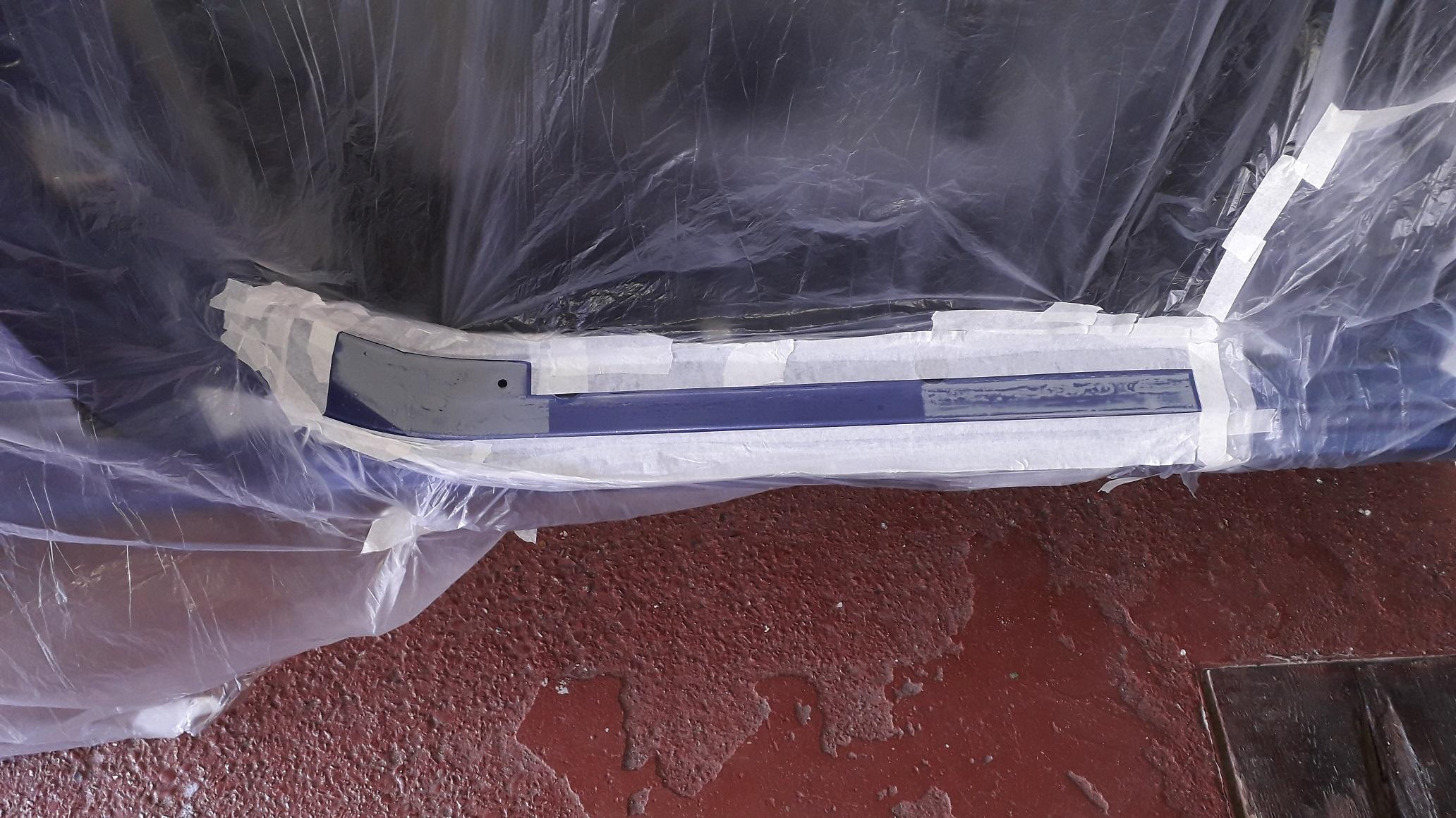

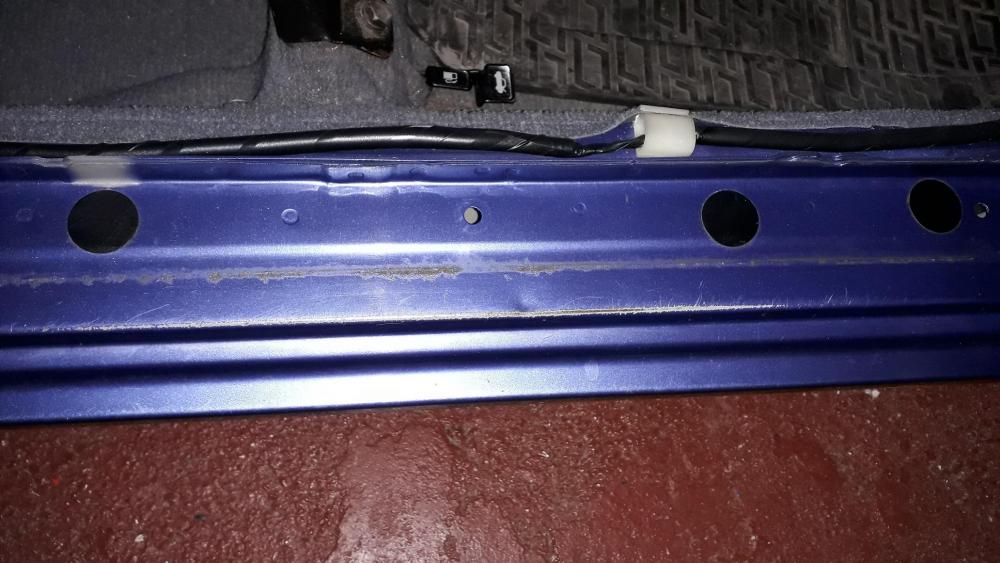

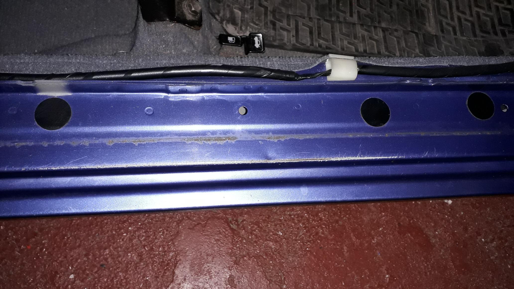

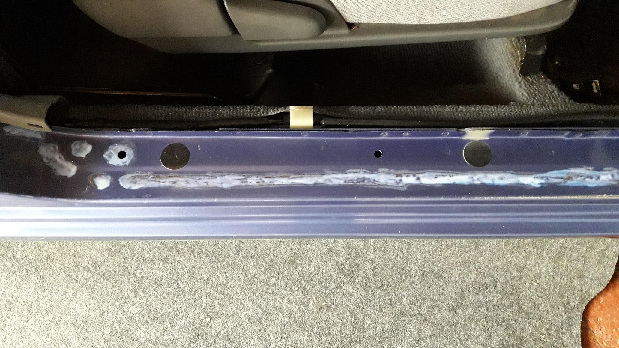

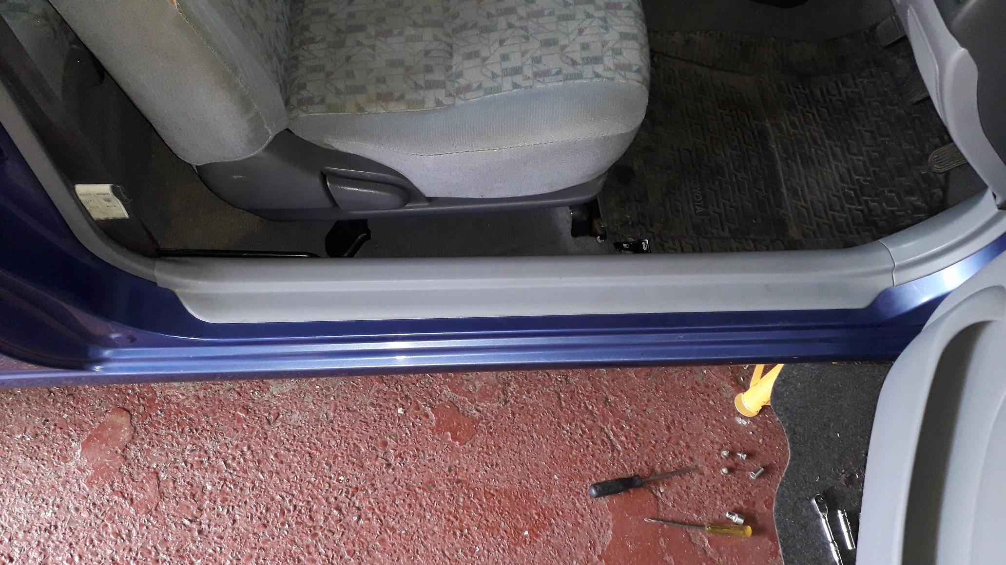

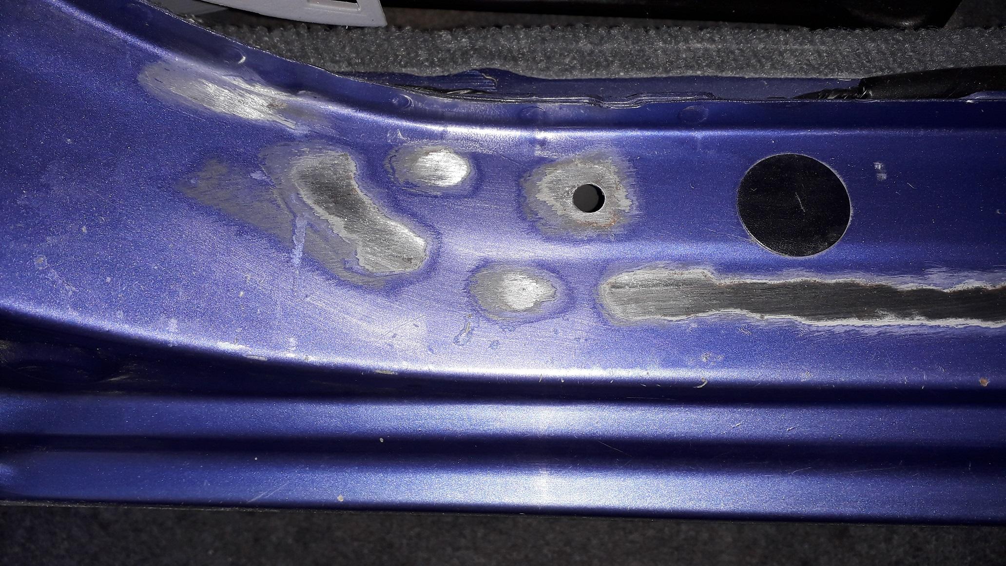

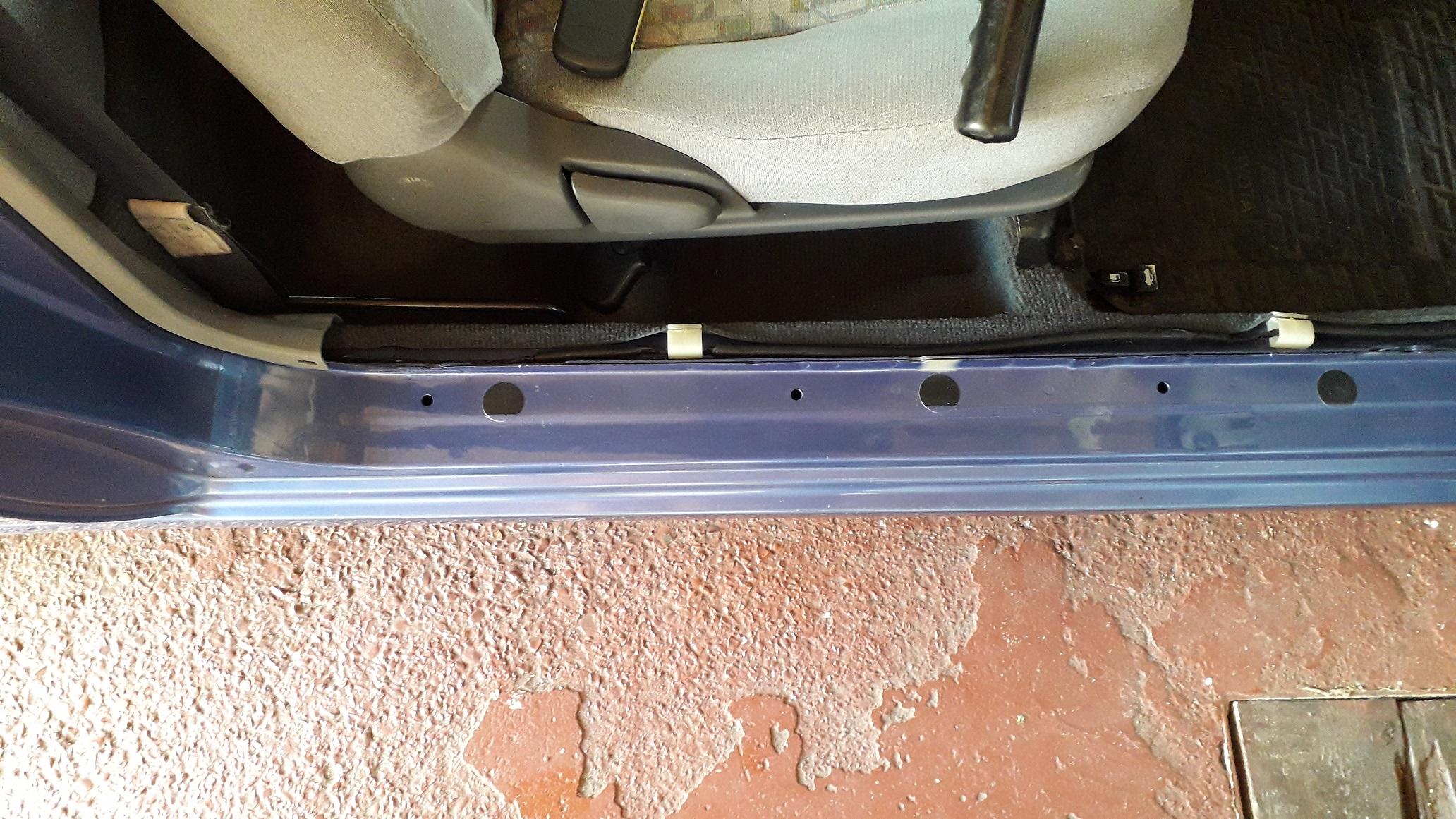

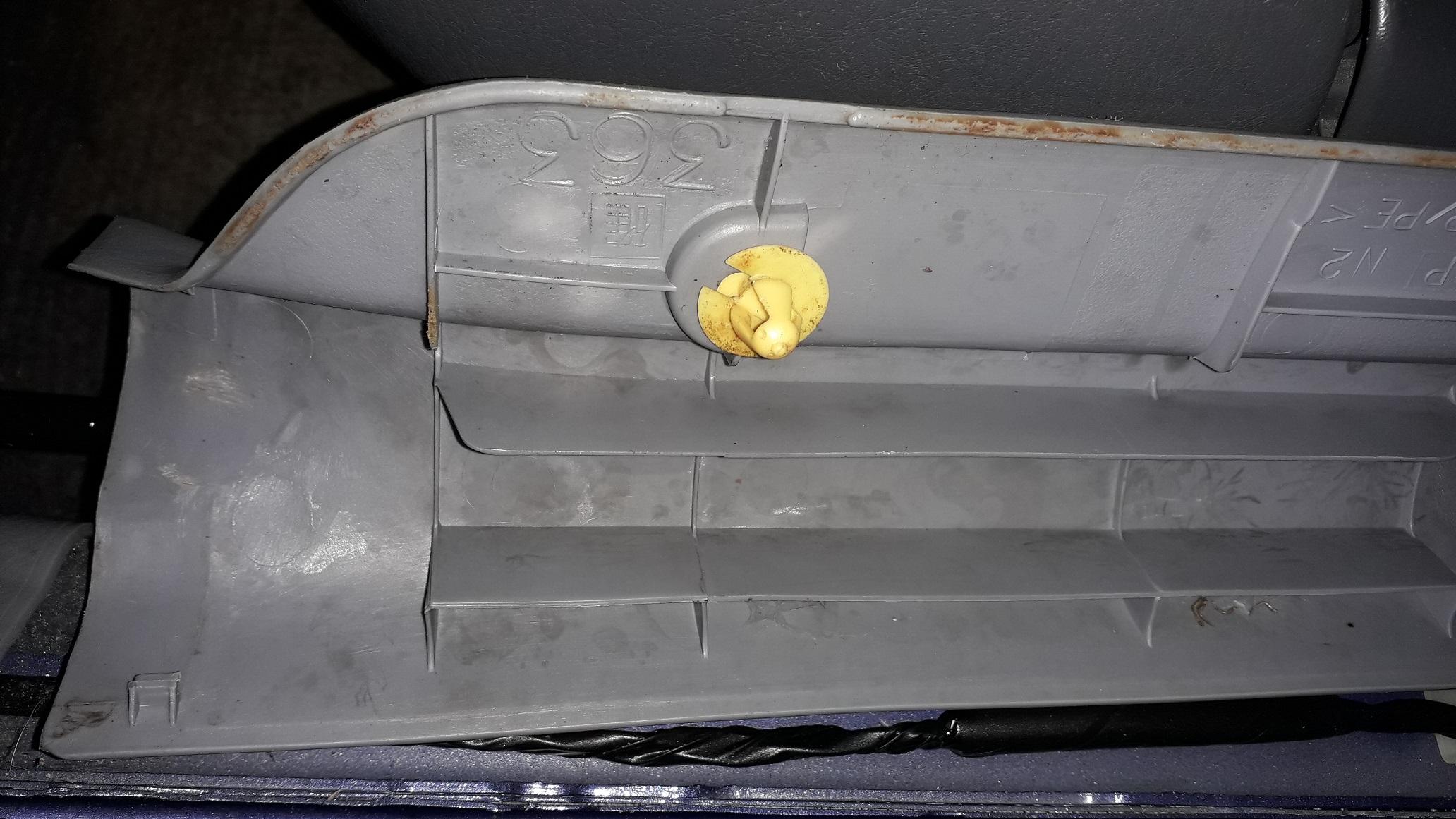

Door sill paint:
When I bought the car i noticed the sill area under the kick plate was rusty and needed investigation.
First I removed the kick plate, un-clipped the front end from the foot well trim, pulled straight up to un-clip the sill fasteners and unhooked the other end from the lower B-pillar trim. Cleaned up the rusty edge.
Thankfully only a thin line of surface rust.
Cleaned off carefully with an abrasive filament wheel.
Hydrate 80 rust treatment just in case.
Masked up, primed, sanded ready for top coat.
Nice warm day for spraying so 3 x layers of top coat (10 mins. between coats), then 2 x layers clear lacquer (10 mins. wait also).
Kick plate back on after 7 days drying.
Good as new.
Edited by Claymore

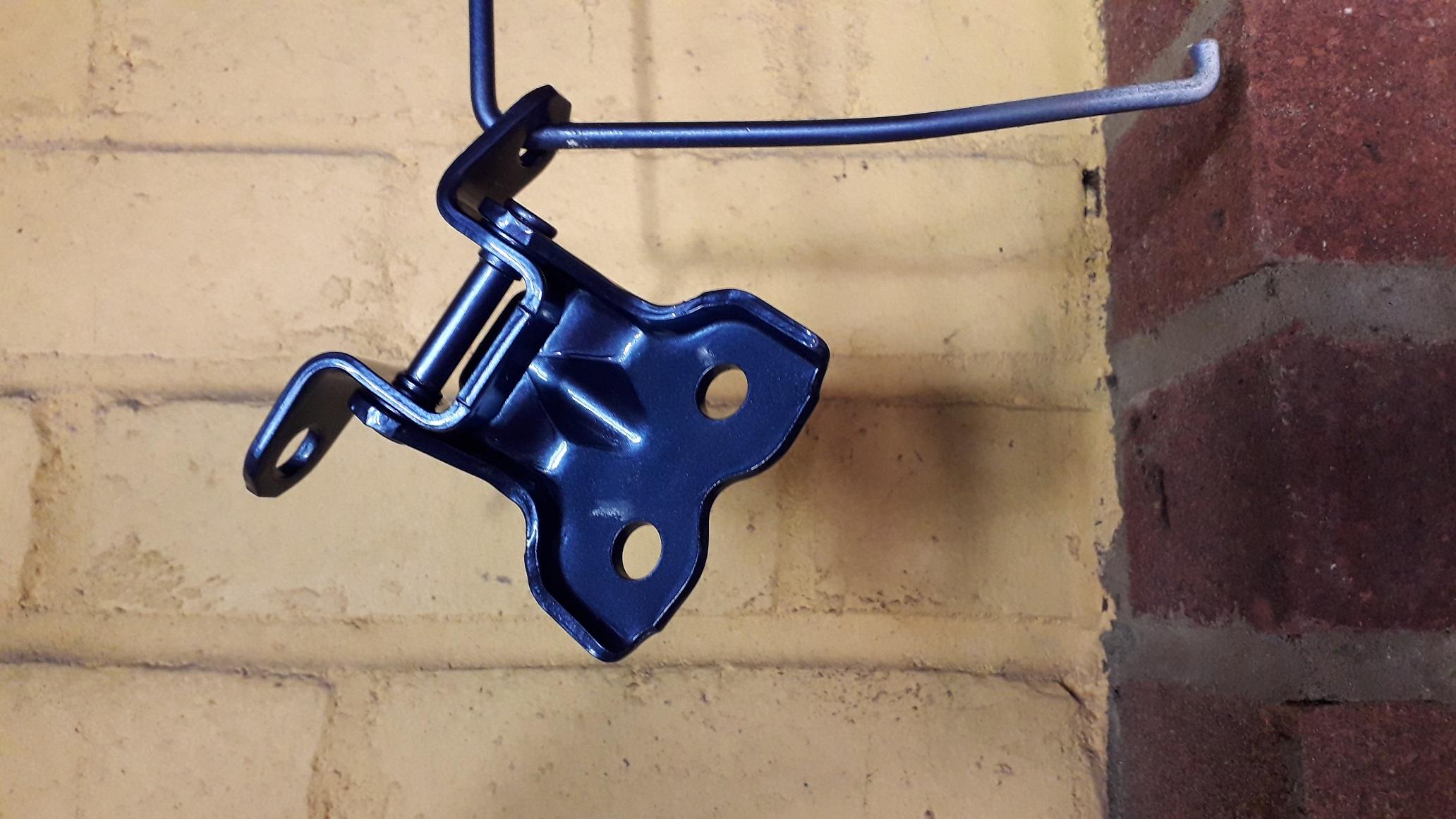

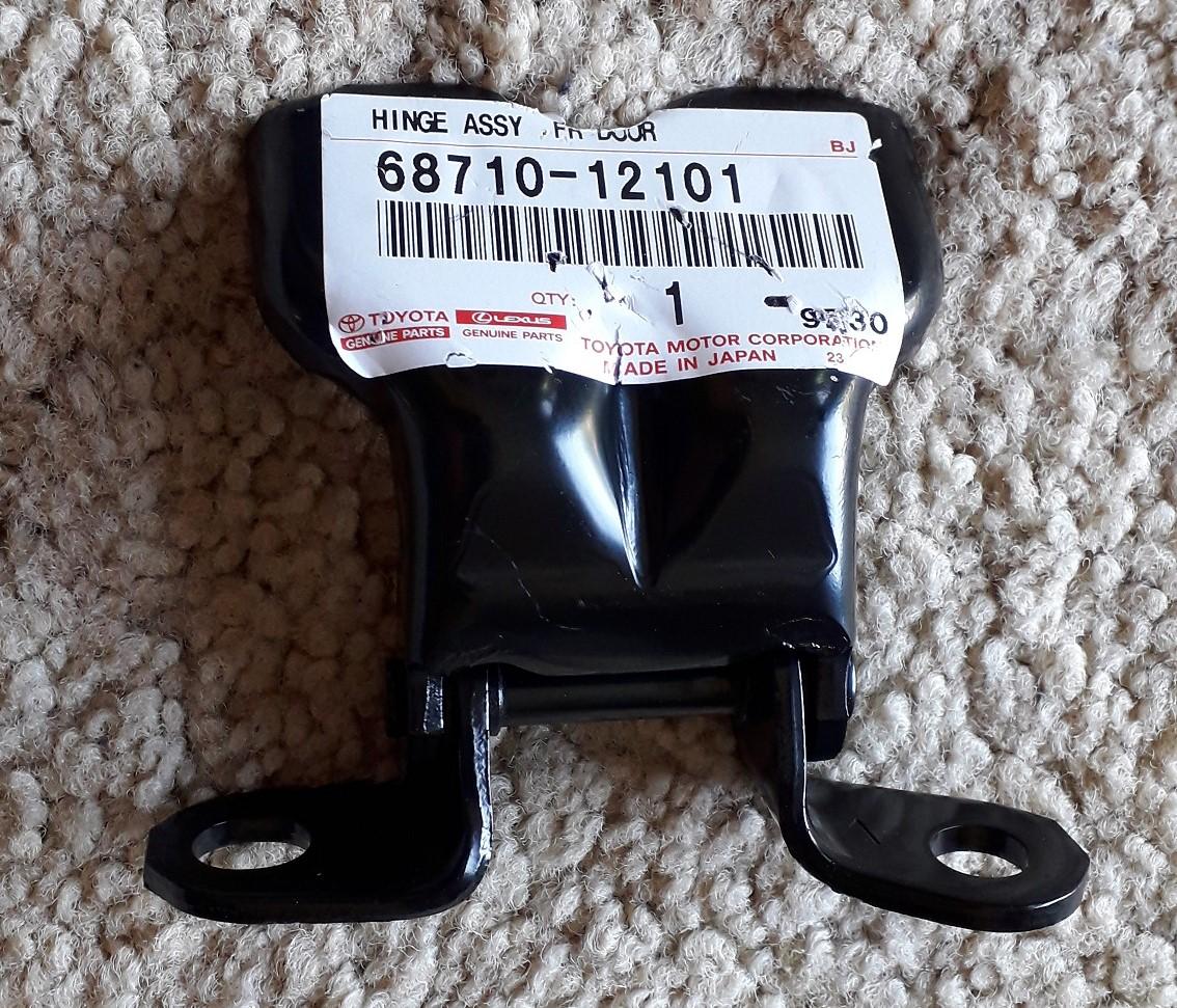

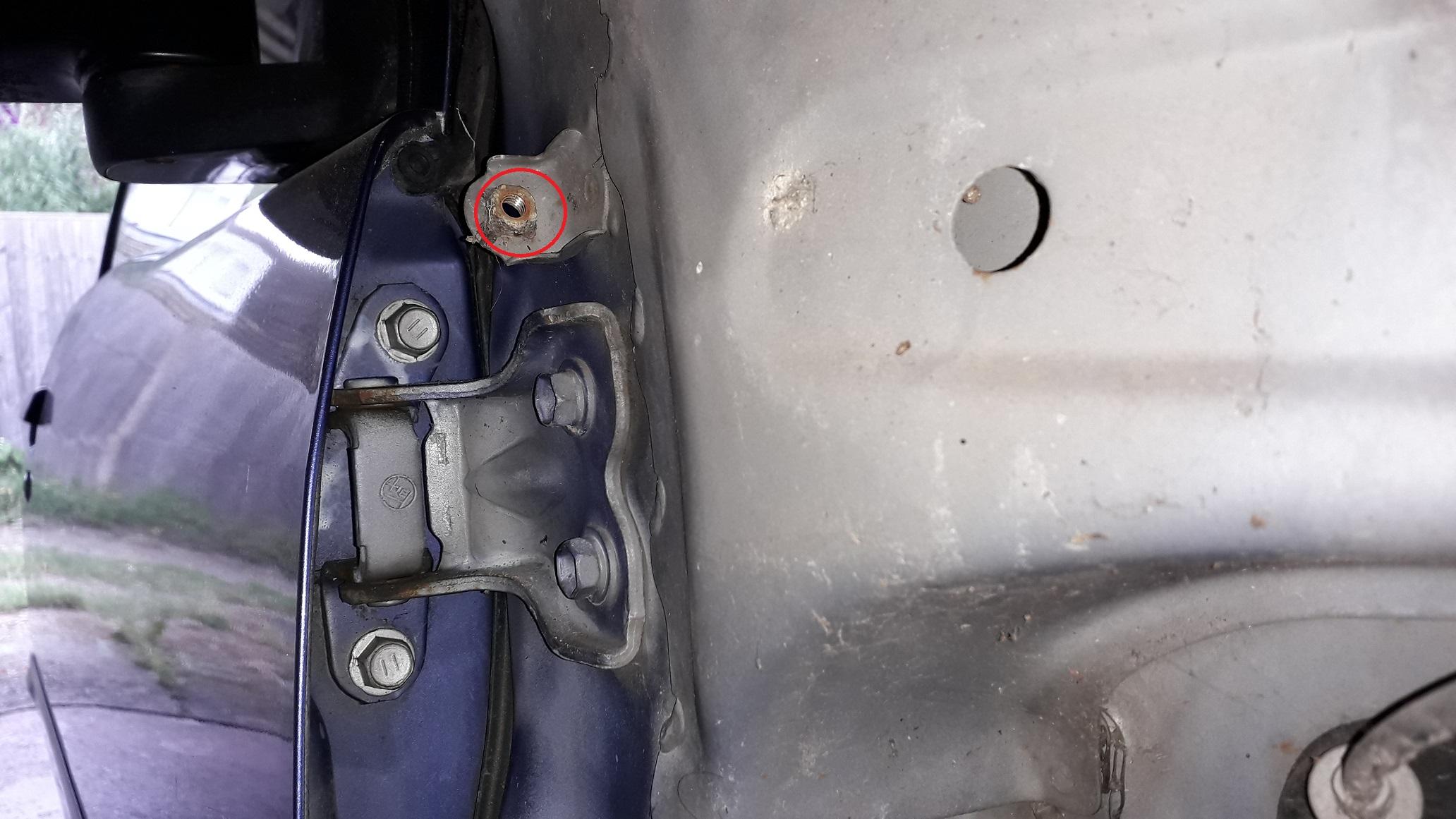

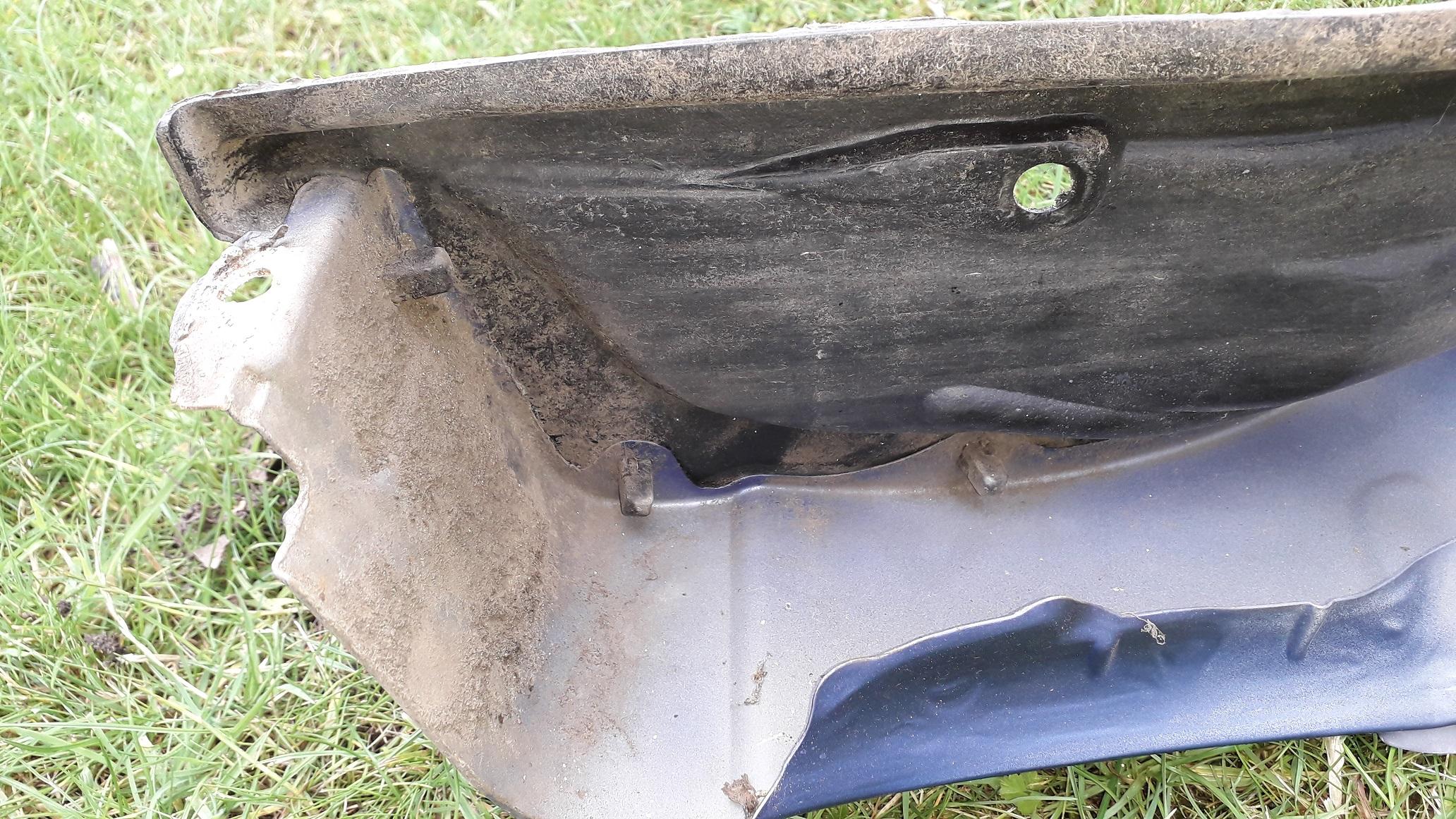

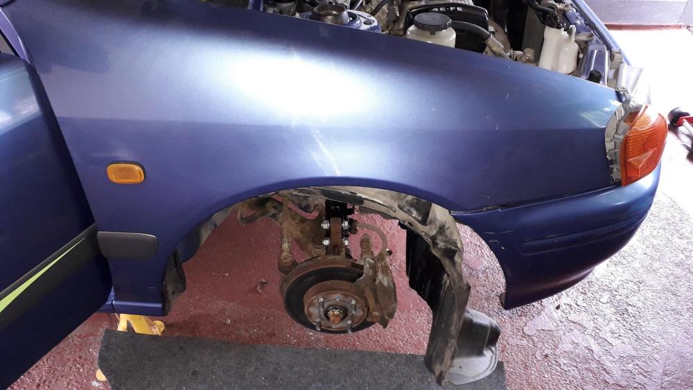

Door hinge replacement.
Noticed that the drivers door dropped when you opened it, so it was time to address this. Looking at the old hinge there was approx. 1.5mm of slack in it which caused the door to drop almost 10mm.
Bought a new drivers side, front, upper hinge from Toyota (68710-12101), worked out at about £50.
Keyed the surface for primer, then 3 x top coat and 2 x lacquer as per the usual method.

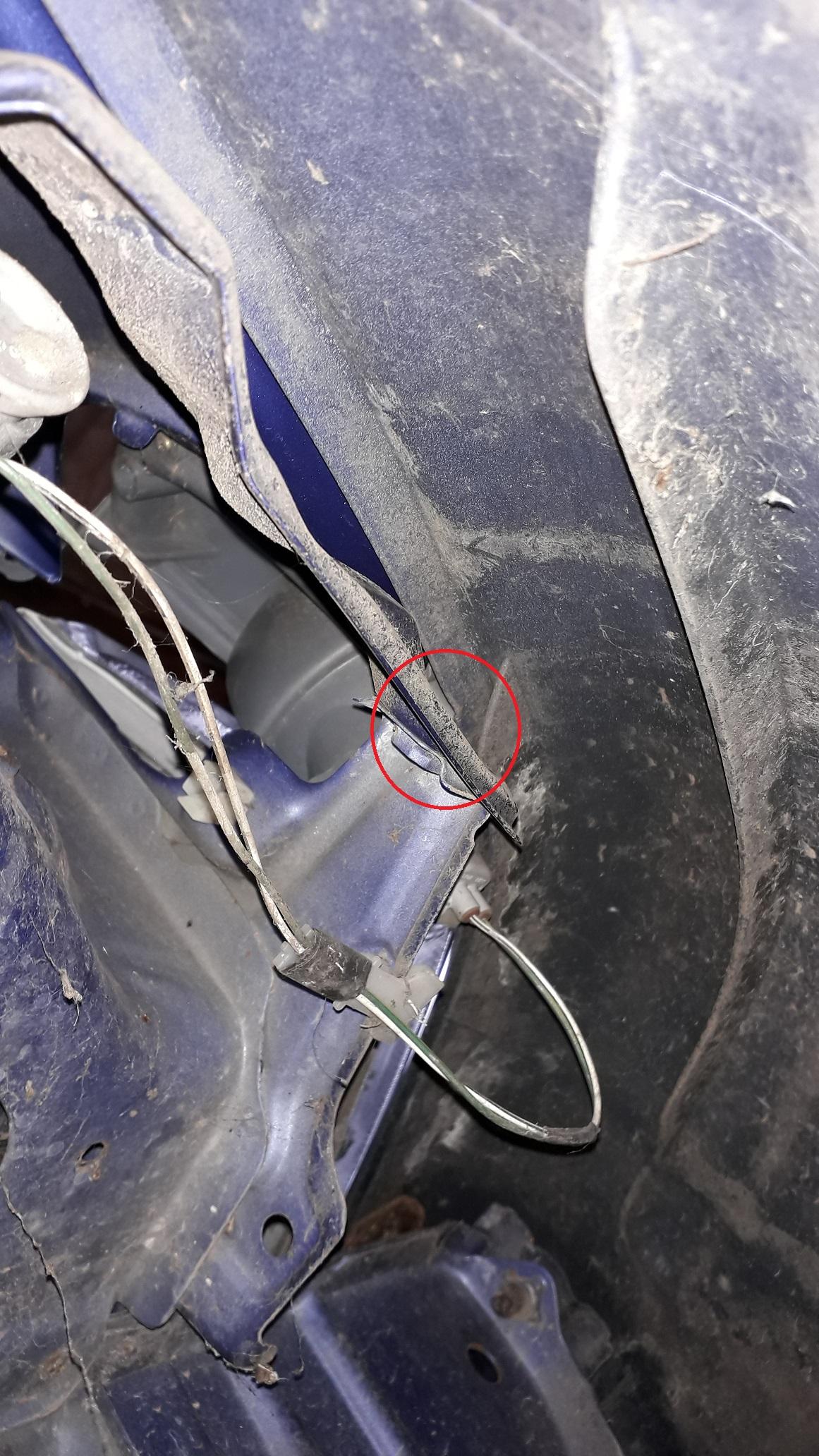

To get at the hinge, first I had to remove the wheel arch liner (a mixture of hex head screws and push fit fasteners which have a circular button to pry open to remove and then the legs usually shatter off the clip) you can't remove the liner completely as the lower 3 x plastic push in fasteners that have a hole in the middle are one way fitment only.
Removed the indicator (one screw at top and pull forward) disconnected bulb holder. Loosened the front bumper (removed the screw at top of grill, next to number plate  and 2 x underneath on front cross member). Disconnected side repeater bulb holder (1/4 turn).
Unscrewed the bolts holding the wing on, 7 in total (three on the top in engine bay).
One bolt in front corner behind bumper
Rear view of arch showing the lower 3 x one way fasteners
One screw under car to attach bottom of arch to sill, one screw behind arch liner.
Final screw was in the door hinge area accessed with door open. Closed the door and removed the hinge as I was doing this job on my own. Replaced hinge and bolted it loosely to the car and door, then gradually tightened all 4 screws, then opened the door carefully and supporting the weight I loosened the 2 x car side screws and lifted the door slightly too high and re-tightened the bolts to the car side again. When I released the door it took out the slack in the new hinge and sat well. It will bed in and probably need adjusting but its a huge improvement.
Put car back together paying attention to panel gaps before fully tightening any mounting bolts, new hinge in place (note the 7th wheel arch bolt above)
Tightened the lock keep to the B- pillar and I no longer have to slam my door shut. :drinks:
