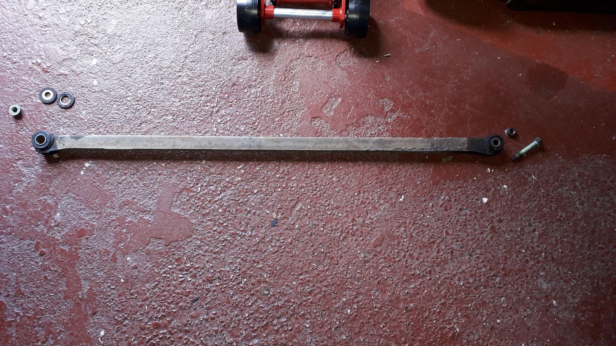

Also check the panhard rod is bolted tight and the bushes are in good condition. Problems with this can cause knocking and steering alignment can be affected as the rear beam can move about.
Never heard of a panhard rod lol, is that the long skinny bar?
Share this post
Link to post
Share on other sites
Yes, its the long bar that is attached to the rear beam on the passenger side and the car chassis on the drivers side. It keeps the rear beam in line with the centre of the car body / chassis.
Ah yes okay so I'm sure I've seen it when looking, it sits a bit diagonally doesn't it? Starts at bottom right and goes up left when looking from behind?
Yes, correct.
