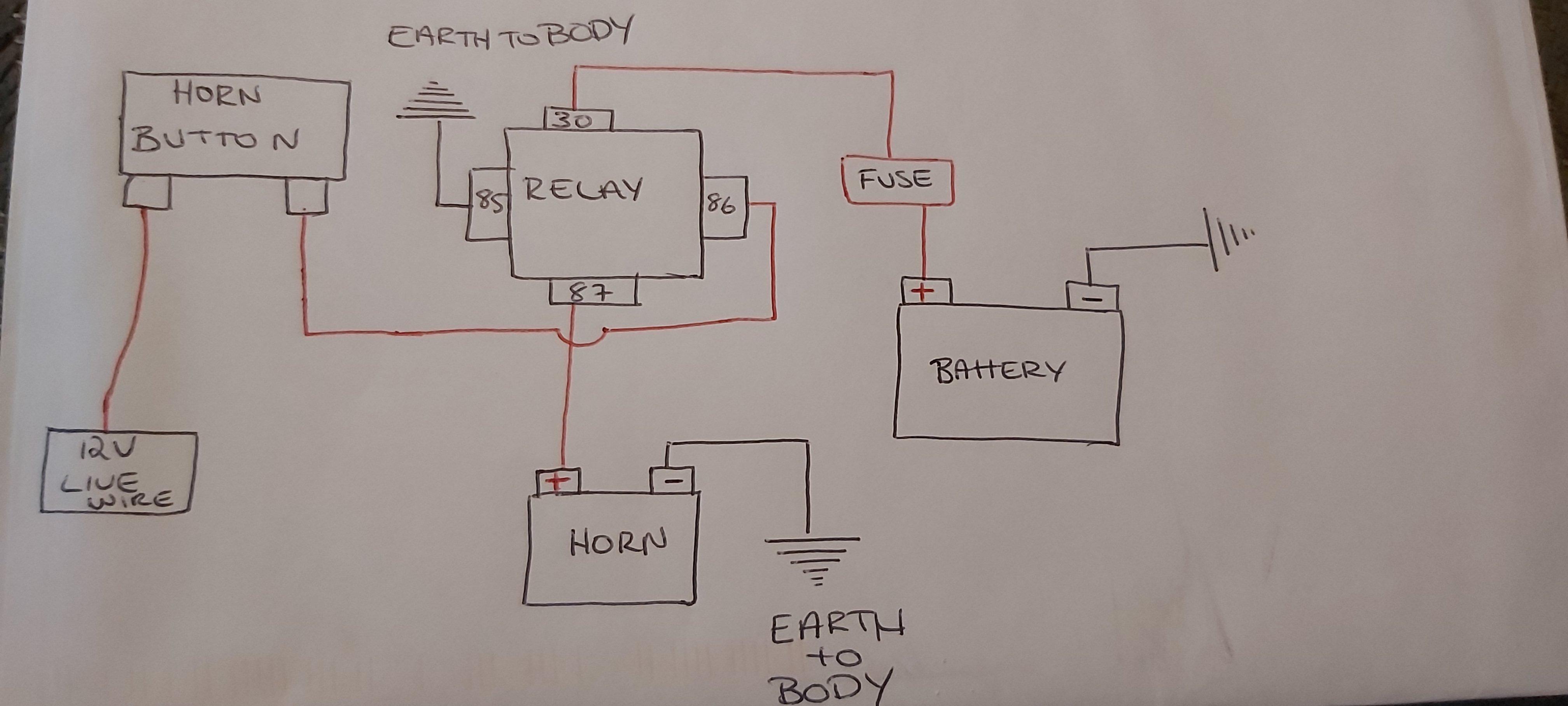

So I tired wiring it up separately to a 4 pin relay but the relay clicks but no horn and when I earth the horn on the body its on constant. Maybe I done it wrong. Would one of the two connections on the horn button be an earth?

I've it wired up to a switch, when I press the switch the relay clicks but no horn working. If I earth the horn on the body it works constantly
