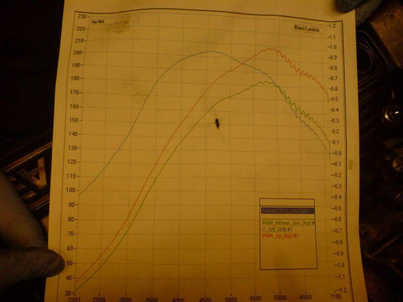

Sam44 Posted August 24, 2020 Author Posted August 24, 2020 (edited) This is not the graph from the setup above in the video but a very impressive graph for a 4efte on a ct9 hyb. Mods are: - Tongs turbo G-spec hybrid HKS actuator - (1bar) Dave B mani and decat heat wrapped Kakimoto cat back Relocated air filter behind grill Baileys dump valve FMIC Walbro fuel pump 315cc Supra injectors TRD ignition leads SARD RRFPR at standard pressure 2.3bar Blitz Access ecu Civic Ali radiator Standard internals I'd expect the graph to look like this sharp torque drop out at 5.5krpm spec wasemanage blue maped by Chrissps manifoldautofix decatopen turbogt spec hybridblitz ssbcautobahn fmicbuddy club race spec 2 This torque drop out looks like this if you pick the wrong play ground to play in. The first graph would more than certainly match the tdo4 and might even beat it as the tdo4 will still see a torque drop at 5.5krpm on standard cams. Tdo4l hyb graph Edited August 24, 2020 by Sam44 Quote

RobSR Posted August 24, 2020 Posted August 24, 2020 I’m not sure that a CT9 hybrid that produces peak torque of 180ft lb at 6k rpm is seriously impressive? 🤷♂️ Sounds pretty terrible to me.. Quote

Sam44 Posted August 24, 2020 Author Posted August 24, 2020 (edited) 2 hours ago, Claymore said: Can you elaborate on this please? The mods look very similar (except for the fuel side of things). In your opinion why does one drop off and the other not? I don't see a different cam listed in the mods spec. so it can't be that. Turbo design? If only compressor maps were more common! Its a tuff 1 going off the setup, this looks very similar to the 5e graphs I've seen but these normally produce more torque at these hp levels. I'd say it's a 4efte with the offset of hp to torque levels. It has to be cam setup. I've seen others, and tried to hold on that torque with turbo design and it's a balancing act with spool up. The 4efe cam setup make it even harder with a smaller turbo. I'm wondering if the cams have not been timed right upon installation at some point. I'm reading something about 5e builds bring set on 4e cam Mark. I've studied alot of Toyota e series graphs in the past 8 month. What's your thoughts? Edited August 24, 2020 by Sam44 Quote

RobSR Posted August 24, 2020 Posted August 24, 2020 35 minutes ago, Sam44 said: Just out of interest what figures would you be happy with on this setup. I'm finding good figures on the plug and play blitz Access ems. When I search them. Also the hks fcon The peak figures are ok, it’s just the curve is not fab, very laggy/unresponsive. Peak torque should be a lot lower, but no doubt down to having an ecu that’s not correctly calibrated to the cars setup. Quote
Sam44 Posted August 24, 2020 Author Posted August 24, 2020 (edited) Yeh its a funny 1. Possibly a false ct9hyb/4efte graph. It was more the topend power I was foucesing on. Like you say we could improve big time the lowwer rpm band using a ct9+ But 222hp @1bar is close to peak hp from this turbo at this pressure. from what I can find. I've found the highest so far is 227hp daztec ems. I'm looking for the graph now. peak torque at 6.5krpm is lowwer. Edited August 24, 2020 by Sam44 Quote
Claymore Posted August 25, 2020 Posted August 25, 2020 (edited) 11 hours ago, Sam44 said: Its a tuff 1 going off the setup, this looks very similar to the 5e graphs I've seen but these normally produce more torque at these hp levels. I'd say it's a 4efte with the offset of hp to torque levels. It has to be cam setup. I've seen others, and tried to hold on that torque with turbo design and it's a balancing act with spool up. The 4efe cam setup make it even harder with a smaller turbo. I'm wondering if the cams have not been timed right upon installation at some point. I'm reading something about 5e builds bring set on 4e cam Mark. I've studied alot of Toyota e series graphs in the past 8 month. What's your thoughts? This is the puzzle. 2 largely similar spec cars (already built) producing different power and torque curves. How can anyone tell which element is making the increase or decrease unless each mod is tested separately or analysed first hand with all the required information? Does the exhaust manifold design add low down torque by spooling the turbo earlier or is it a characteristic of the Hybrid turbo design? Is the gt spec hybrid choked up top because its based on the CT9a using a restrictive exhaust wheel / housing or is the down pipe and exhaust too restrictive top end? Then let's not forget these cars are getting on a bit now and may have various levels of maintenance and or inherent faults that weren't diagnosed and rectified before sending to the dyno (a simple boost leak?). My point is we don't know for sure when only reading words on the internet. Neither graph plots boost pressure or AFR so we don't know how that is affecting the power curve either. Obviously we can't see what timing has been pulled or added (in the Blitz). I understand that most regard the "plug n play" ecu's as having more aggressive timing and leaner fuel (again, anecdotal evidence from internet forums ?, not analysed under laboratory conditions and yes I know that it's not practical to do so). I have always been taught to challenge results and findings and to analyse the methodology to validate the results. It seems with so many influencing factors (parts, problems and tuning) it can be difficult to specify / guarantee that using parts A, B and C will get you X, Y and Z. There is also a lot of gains to be had from a fully mappable / piggyback ECU with good tuning which will make the best of any parts setup as RobSR has quite rightly stated (no doubt from years of tuning experience). Also having the system analysed first hand by knowledgeable tuners will highlight areas to rectify regarding parts. I'm going with: make sure your car is well maintained, add sensible (obvious) mods, get a good tune from a company that knows their stuff and see the results for myself on my engine. Then based on my own results with help from a tuning house, address any areas that need attention one piece at a time. Edited August 25, 2020 by Claymore Quote
Sam44 Posted August 25, 2020 Author Posted August 25, 2020 (edited) The way I'm reading it is as follows. This graph in question (build)has big diameter items on it (exhaust and inlet). Aimed at peak power levels (to produce as much hp peak rpm as possible). This explains both the low rpm lack of power (engines low rpm gas flow rates) and high rpm good power, but not the torque curve at 6.5krpm being were it is. In order to get the good hp figures, afr can't be to far out tbh Normally you wouldn't hit top figures if there were a afr or ignition advance issues. There are always anomalies that can happen to produce a graph like this. (Cam timing out, afr and ignition timing not quite balanced at optimum Saying this the graph looks nothing like a ct9 sized turbo. The spool up power characteristics are missing, as well as the 4efte cam characteristics, droping torque off at 5.5krpm. with the small turbo hitting this drop off curve hard (high exhaust back pressure). The peak power figured and hp to torque difference of the engine do match a ct9 hyb and 4efte. Making this graph very interesting. Could incorrdct cam timing produce this. If so could changing engine items as well as afr/ignition advance help produce more. Also I've been looking at the blitz access plug and play ems. There's some great ct9 figures using this ems. I'm trying find how these are setup/do they share the same maps. The other points of interest for me: injector size on the ems as well as set fuel pressure. Edited August 25, 2020 by Sam44 Quote
Claymore Posted August 25, 2020 Posted August 25, 2020 3 hours ago, Sam44 said: The way I'm reading it is as follows. This graph in question (build)has big diameter items on it (exhaust and inlet). Aimed at peak power levels (to produce as much hp peak rpm as possible). This explains both the low rpm lack of power (engines low rpm gas flow rates) and high rpm good power, but not the torque curve at 6.5krpm being were it is. In order to get the good hp figures, afr can't be to far out tbh Normally you wouldn't hit top figures if there were a afr or ignition advance issues. There are always anomalies that can happen to produce a graph like this. (Cam timing out, afr and ignition timing not quite balanced at optimum Saying this the graph looks nothing like a ct9 sized turbo. The spool up power characteristics are missing, as well as the 4efte cam characteristics, droping torque off at 5.5krpm. with the small turbo hitting this drop off curve hard (high exhaust back pressure). The peak power figured and hp to torque difference of the engine do match a ct9 hyb and 4efte. Making this graph very interesting. Could incorrdct cam timing produce this. If so could changing engine items as well as afr/ignition advance help produce more. Also I've been looking at the blitz access plug and play ems. There's some great ct9 figures using this ems. I'm trying find how these are setup/do they share the same maps. The other points of interest for me: injector size on the ems as well as set fuel pressure. Hey Sam, I don't want to turn this into a bun fight. I've said my bit as you asked me for my opinion. If you feel you can find the "Ultimate" spec for Glanza's by trawling through umpteen graphs and spec lists and deciphering what the car "actually" has and its unknown settings from them, then feel free. Cheers Quote
