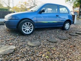

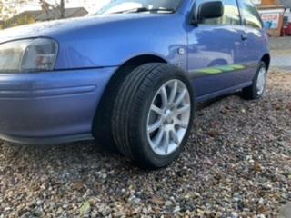

Rikardo77 Posted October 23, 2020 Posted October 23, 2020 (edited) Clear indicators and side lights on, just bought these bad boys! Just getting them refurbished and gloss white. Can’t wait to get them on.. Edited October 23, 2020 by Rikardo77 Quote
Claymore Posted October 24, 2020 Posted October 24, 2020 7 hours ago, Rikardo77 said: Clear indicators and side lights on, just bought these bad boys! Just getting them refurbished and gloss white. Can’t wait to get them on.. Looking good mate, nice colour! Is it Purplish blue (8k9)? Quote
Rikardo77 Posted October 24, 2020 Author Posted October 24, 2020 1 hour ago, Claymore said: Looking good mate, nice colour! Is it Purplish blue (8k9)? It is more blue but yes has a tinge to it. Thanks I’m loving the starlet life haha. Quote
Sam44 Posted October 24, 2020 Posted October 24, 2020 welcome. there are quite a few owners in the northwest especially greater Manchester and Preston area. as said really nice color and she does look very clean, nice choice on the wheels.   Quote
burty Posted October 24, 2020 Posted October 24, 2020 loads of Na popping up recently welcome aboard Quote
