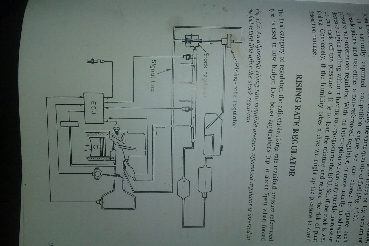

RobSR Posted December 13, 2020 Posted December 13, 2020 It’s getting more and more frustrating seeing terrible advice and wild claims posted. For the love of god any owners reading this please run a vac referenced FPR on your boosted setups. P.S still waiting for examples of all these failures for every reason under the sun 🤔 There is going to be some real catastrophic failures if some of this advice is followed Quote

Sam44 Posted December 22, 2020 Author Posted December 22, 2020 (edited) this is how i mapped the d16 turbo standard n/a map sensor. ON THE ECU DET3 MASTER PIGGY BACK first i used analog 1 input/output on the map sensor (this shows voltage 0-5v) then i narrowed my tables resolution in the setup menu to the correct redline rpm (ignition menu) and voltage of the map sensor (this allows for better/finer fuel/voltage step adjustments). with the low table resolution this is a key area. i also set my voltage out min and max to my tables resolution. i then used the voltage offset at -1v output in the setup menu to give a constant -1v drop on the output signal. using bigger injectors what i also found this to do, other than not hitting fuel cut, was that because the baseline output voltage was lowwer@idle. the larger injectors started very close to 0 (incremental adjustment value used) on the fueling table. the injectors were 2.5x bigger than stock units. I also set the voltage incremental adjustment Down 1 setting to .0098v from .01v i then had to use the forced start up voltage option at 1.4ish volts to allow the car to start up when cold (coke), until the engine hit operating temp. this was due to the lad not using an idle valve on a aftermarket throttle body. there were alterations made to the ignitions table made in and out of boost pressure. he was using a T3/T4 turbo at .8bar of boost. it has just been dynoed yesterday @ 220+hp i was waiting for him to shake it down and get the all clear from the dyno before i shared just to make sure there is no catastrophic failures. this car is also running a constant 4bar fuel pressure. all good reported back from the dyno, hes loving it. my personal opinion of the piggy back ecu. it is what it is a very cheap option. the aem and emanage are much better, this is reflected in the price difference. i think that extra hp would have been able to have been unlocked using the aem that i have been using. Edited December 27, 2020 by Sam44 Quote
Claymore Posted December 22, 2020 Posted December 22, 2020 (edited) On 12/22/2020 at 3:52 AM, Sam44 said: this is how i mapped the d16 turbo standard n/a map sensor. ON THE ECU DET3 MASTER PIGGY BACK first i used analog 1 input/output on the map sensor (this shows voltage 0-5v) then i narrowed my tables resolution in the setup menu to the correct redline rpm (ignition menu) and voltage of the map sensor (this allows for better/finer fuel/voltage step adjustments). with the low table resolution this is a key area. i also set my voltage out min and max to my tables resolution. 0.88v to 5v. i then used the voltage offset at -1v output in the setup menu to give a constant -1v drop on the output signal. using bigger injectors what i also found this to do, other than not hitting fuel cut, was that because the baseline output voltage was lowwer@idle. the larger injectors started very close to 0 (incremental adjustment value used) on the fueling table. the injectors were 2.5x bigger than stock units. i then had to use the forced start up voltage option at 1.4ish volts to allow the car to start up when cold (coke), until the engine hit operating temp. this was due to the lad not using an idle valve on a aftermarket throttle body. there were alterations made to the ignitions table made in and out of boost pressure. he was using a T3/T4 turbo at .8bar of boost. it has just been dynoed yesterday @ 220+hp i was waiting for him to shake it down and get the all clear from the dyno before i shared just to make sure there is no catastrophic failures. this car is also running a constant 4bar fuel pressure. all good reported back from the dyno, hes loving it. my personal opinion of the piggy back ecu. it is what it is a very cheap option. the aem and emanage are much better, this is reflected in the price difference. i think that extra hp would have been able to have been unlocked using the aem that i have been using. Did the det3 have an internal map sensor? What was the rating of the standard Honda Map sensor, 1bar? Another car you have been involved with that isn't vacuum referenced to the FPR? Even with the addition of a turbo? Even the 4efe is vacuum referenced for the fpr to maintain constant fuel pressure from idle to red line. I'll deffo be running a reference for my build. The force startup voltage doesn't work for cold start enrichment as far as I can work out from the DET3 instructions its to prevent error codes. Also it has no parameters to change back when the engine is at operating temp: "The possibility to set the value of the device’s initial voltage is an additional option. DET3 needs about 7ms for the initialization and to start working. During this process, voltage of the analog output equals 0V. It is possible to enforce a given initial voltage during the initialization process. It may be required for some ECU, which at this time is reading the voltage from a sensor (MAP sensor, MAF sensor), and in case of 0V, to report an error. In such situations, the initial voltage value should be set to the sensor’s reading when the engine is turned off." The only way I can see to make it work is to splice into the coolant temp' sensor and use it as a correction input on the fuel table. It can then be used to add a percentage value to the fuel cell value when cold and as the coolant temp. increases the enrichment can be stopped. Edited April 21, 2021 by Claymore Quote
Sam44 Posted December 22, 2020 Author Posted December 22, 2020 (edited) 1 hour ago, Claymore said: Did the det3 have an internal map sensor? What was the rating of the standard Honda Map sensor, 1bar? Another car you have been involved with that isn't vacuum referenced to the FPR? Even with the addition of a turbo? Even the 4efe is vacuum referenced for the fpr to maintain constant fuel pressure from idle to red line. I'll deffo be running a reference for my build. yeh its the det3+ i believe, it had an internal map sensor. not sure if the honda denso map sensor is a 1bar, but its off the b16y8 engine. yeh its up to you to run a reference signal. this build did have high pressure screw on fuel line/fastenings (which id recommend) for over 3.5bar of fuel pressure. ill put up some information ive found in a tunning book on the subject. hopefully it will help ease any worries. here is how i use the fpr as described at the top of the page. fixed pressure. Edited December 22, 2020 by Sam44 Quote
Claymore Posted December 22, 2020 Posted December 22, 2020 1 minute ago, Sam44 said: yeh its the det3+ i believe, it had an internal map sensor. not sure if the honda denso map sensor is a 1bar, but its off the b16y8 engine. yeh its up to you to run a reference signal. this build did have high pressure screw on fuel line/fastenings (which id recommend) for over 3.5bar of fuel pressure. ill put up some information ive found in a tunning book on the subject. hopefully it will help ease any worries. Lol, I'll take the advice of RobSR (experienced tuner) over a forum regurgitated book reference any day. You worry me sometimes. Quote
Sam44 Posted December 22, 2020 Author Posted December 22, 2020 (edited) 1 hour ago, Claymore said: Lol, I'll take the advice of RobSR (experienced tuner) over a forum regurgitated book reference any day. You worry me sometimes. the book was written by graham bell look him up. and of course its up to you how you do it. some more use full info now because we use a map sensor on the 4e engine this references inlet manifold pressure. which directly has an affect on the fuel volume injected by the injector vacuum sucks more out/pressure pushes it back in/restricts the flow. we have this under control. Edited December 22, 2020 by Sam44 Quote
Claymore Posted December 22, 2020 Posted December 22, 2020 (edited) On 12/22/2020 at 2:17 PM, Sam44 said: the book was written by graham bell look him up. and of course its up to you how you do it. some more use full info Graham bell was a skier dude 🤣 No wonder! You mean: A. graham bell? Modern engine tuning? (first published 1989) or 4 stroke performance engine tuning, turbo tuning etc. (yes I can google) I get that the author is an experienced tuner, however the method you have chosen from that book also says it is for a naturally aspirated engine, choosing this option has led you to what I can only describe as an "unorthodox" fuelling setup that has never been required before. This is not what the author wanted. I would also be wary about the advice in that passage about adjusting fuel pressure on the fly at the track to compensate for barometric pressure differences. Ulp! The things like the addition of a rising rate regulator along with the existing one also point to the age of this book (modern adjustable fpr's would replace the existing unit). Basic lessons / theories still ring true but tuning methods seem out of date. I'll second that sentiment, its up to you how you do it too. Edited December 26, 2020 by Claymore More edits to answer Quote
Sam44 Posted December 22, 2020 Author Posted December 22, 2020 (edited) any way i hope your not to stressed about this all, and the information on the det3 tunner helps you. its working so far on the honda and passed dyno with good results. i had it fully road mapped in after around 3week. if you could share any finding on the 4efe+t when you do yours would be very much appreciated, im going to get an e11 running on 1 in the new year. Edited December 22, 2020 by Sam44 Quote
Claymore Posted December 22, 2020 Posted December 22, 2020 2 hours ago, Sam44 said: now because we use a map sensor on the 4e engine this references inlet manifold pressure. which directly has an affect on the fuel volume injected by the injector vacuum sucks more out/pressure pushes it back in/restricts the flow. we have this under control. I feel it's only fair that I get a chance to reply to your edit: I see this as a problem. The Map sensor references the manifold pressure, telling the ecu to add more or less fuel electronically (and also influences the timing). Without a vacuum reference to the fpr to counteract manifold pressure changes, the fuel pressure regulator now creates more fuel pressure than the base setting in vacuum at low load (vacuum sucking out fuel) and less pressure than the base setting on boost (boost pressure pushing fuel back in) I believe its called delta 🤓. Surely it just makes the tuning potential worse? Raising fuel pressure at low load where it isn't required (leading to very short injector pulse requirements and small injectors) and reducing fuel pressure as boost increases where it is required (requiring longer injector opening times, larger injectors and higher capacity fuel pump requirements)? If your lucky you'll be able to tune around this problem if you have an over specced fuel system and full control of the ECU. At worst you will run lean and melt the engine. Hence my decision to run referenced. 2 hours ago, Sam44 said: any way i hope your not to stressed about this all, and the information on the det3 tunner helps you. its working so far on the honda and passed dyno with good results. i had it fully road mapped in after around 3week. if you could share any finding on the 4efe+t when you do yours would be very much appreciated, im going to get an e11 running on 1 in the new year. Not worried at all, I've got a plan I'm happy with. I've researched alot. Nearly finished my plug 'n' play harness for the install and have explored the det 3 tuning software to figure out the settings already. Its slightly different to your description above as I will be using a 2 bar MAP sensor so no problems with boost cut / n/a sensor not reading boost etc. I'll update my build thread with the results. Can't see how the ignition side of the gen 3 corolla will work with the det 3 as there is only one ignition signal input available but I'm sure you'll figure it out. Quote
Sam44 Posted December 23, 2020 Author Posted December 23, 2020 (edited) interesting so you think the fpr responds 1:1 with the fueling table. if not how reliable is the fueling adjustments being made. a very valid point on high loads on the injectors and pumps and also injector sizing. Edited December 23, 2020 by Sam44 Quote
Claymore Posted December 23, 2020 Posted December 23, 2020 (edited) On 12/23/2020 at 8:07 AM, Sam44 said: interesting so you think the fpr responds 1:1 with the fueling table. if not how reliable is the fueling adjustments being made. a very valid point on high loads on the injectors and pumps and also injector sizing. No, not the point I was trying to make. My point was about fuel pressure on and off boost regarding vacuum reference. Preserving the desired fuel pressure as manifold pressure changes. Wasn't thinking about ecu. I'm going with "reliable enough". I'm sure you've got some point to make about it. Probably to do with your vacuum delay ball thing? you said before about the map responding at a different rate to the reg? Relocating the map sensor to the manifold for better response. etc.... But the thing to bear in mind is does it actually make a difference worth bothering with? You must think so or you wouldn't have bothered. Might be spending alot of effort for what others consider minimal gains whilst adding complications and flirting with danger. Edited December 26, 2020 by Claymore continuity for the reader / answering edits Quote
