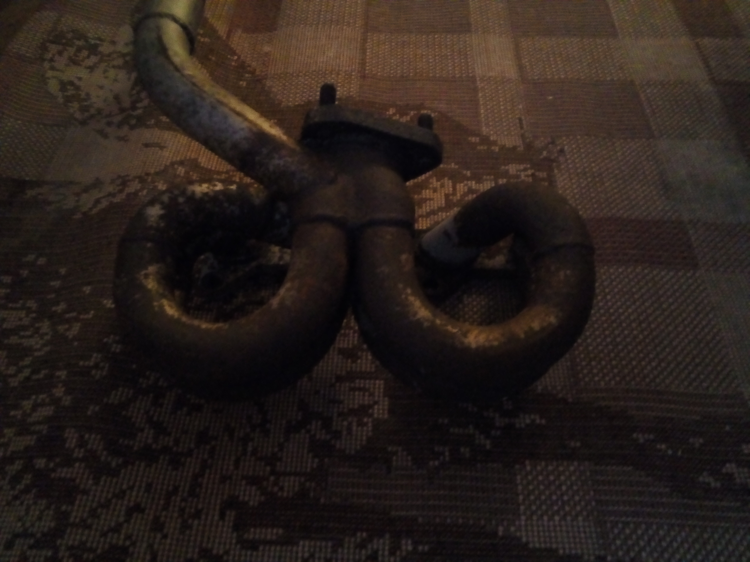

The original zisco exhaust manifold from my turboed ep going on soon.

I'm also waiting for the tdo4 exhaust flange to turn up so I can use do the zisco exhaust mod.
