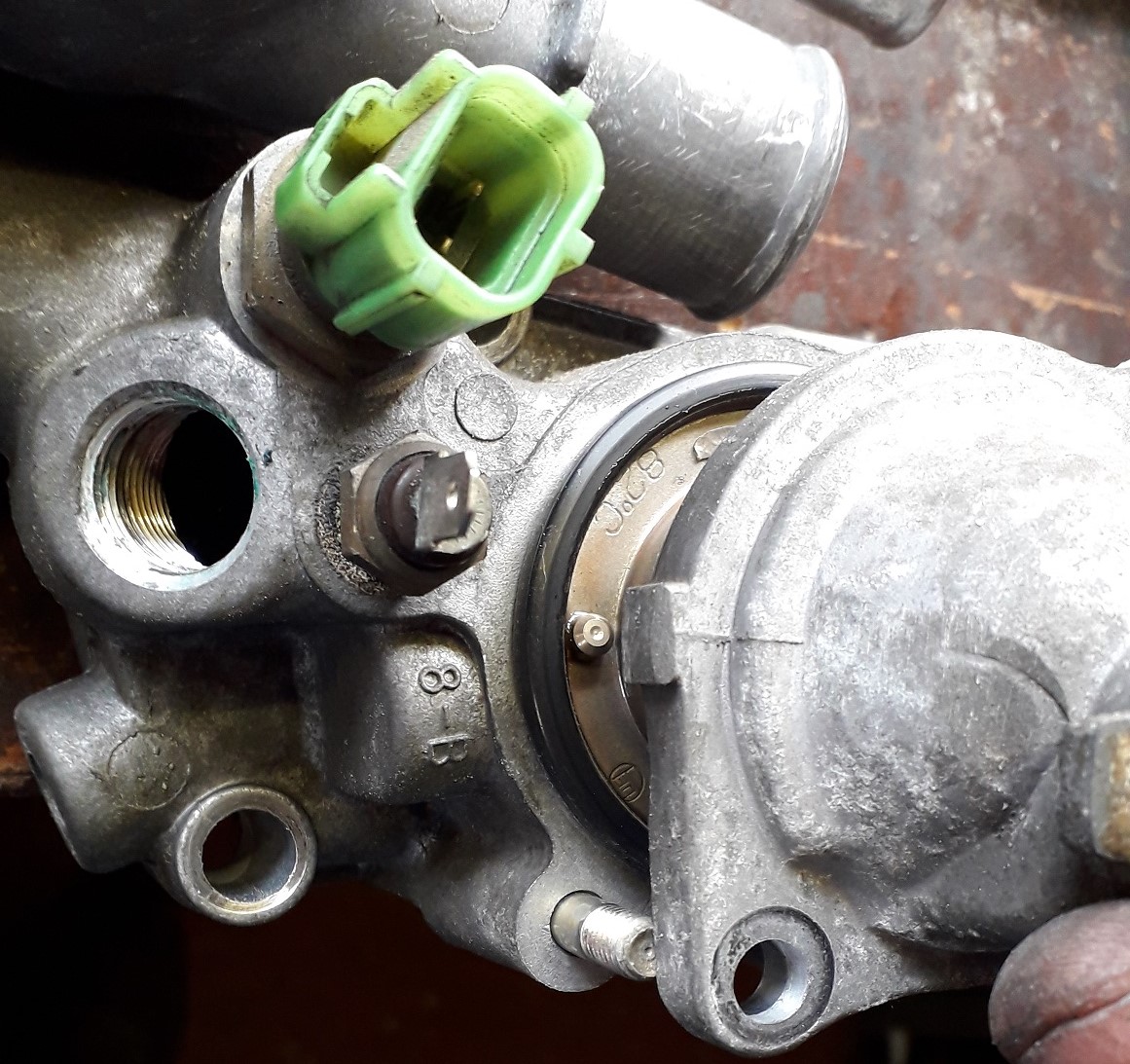

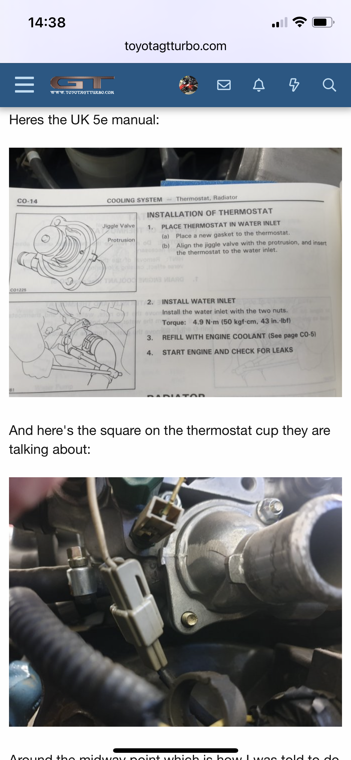

Claymore Posted November 18, 2021 Share Posted November 18, 2021 (edited) On 11/17/2021 at 9:07 PM, Djaniero said: Thanks a lot for this Claymore. You learn something new everyday on here. I thought the thermostat could only fit one way....I didn't know that it had to be fitted with the correct orientation. I'll drop the coolant, flush the system, check the stat orientation and try the above bleed procedure you mentioned. A few members on the FB group said that the issue could be that my civic dual core ali rad is cooling the car down too much (which is never a bad thing I guess)..and I should try wrapping it with cardboard or tin foil (1/3 the rad) to see if that makes a difference? Expand The thermostat can only fit in the housing one way but you need to turn it so the jiggle pin is in the correct place. I used the 5efe build manual (Edit: it was actually the Haynes manual) and it said to turn the thermostat so the jiggle pin lines up with the square step on the cap: The radiator shouldn't affect it. More efficient radiators can reduce coolant temps more quickly and handle higher loads but the thermo regulates the minimum temp of the coolant. It keeps the coolant at 82 deg C (at cruise) and this heated coolant is sent to the heater matrix from the head side of the thermo housing. If the thermo is broken it will over cool, but a working thermostat will keep the coolant in the engine at a minimum of 82 deg C. Edited November 18, 2021 by Claymore Haynes manual, not 5efe manual Quote Link to post Share on other sites

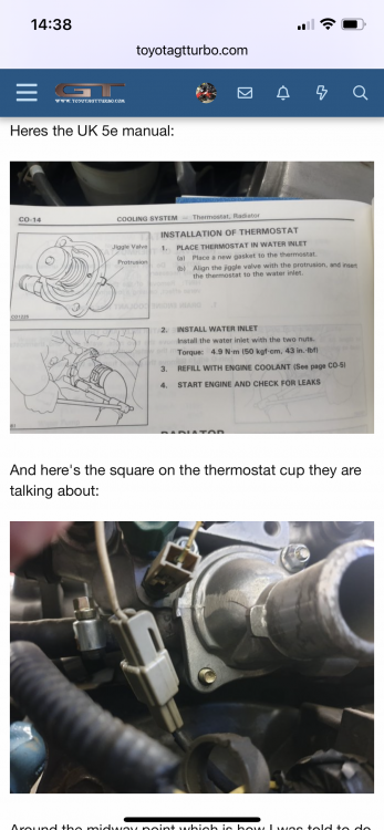

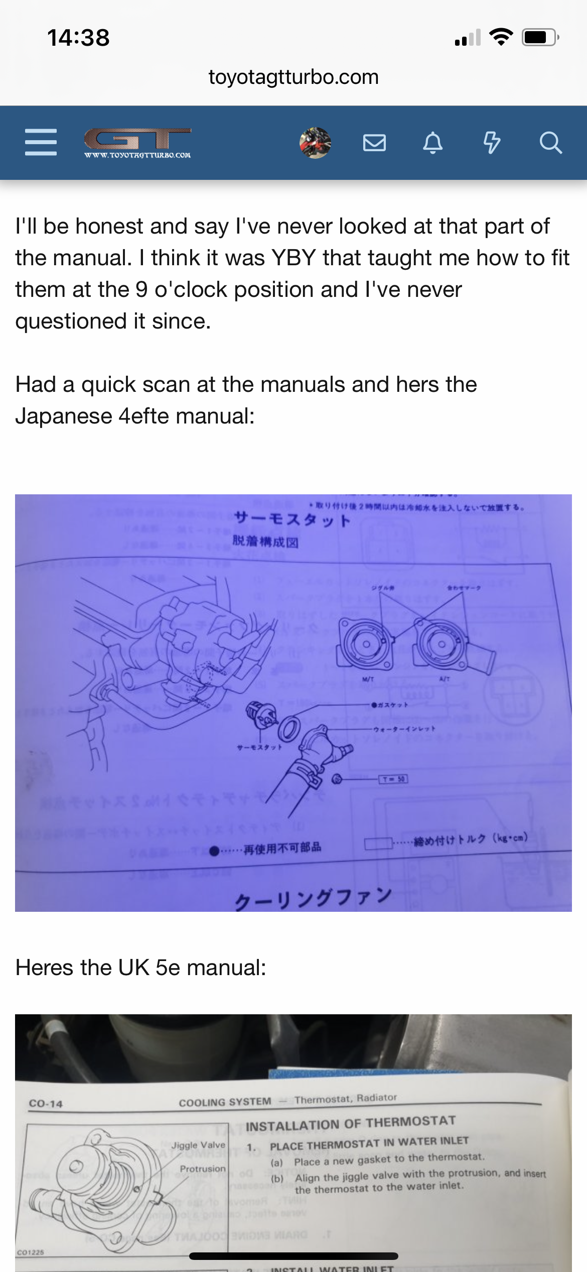

Djaniero Posted November 22, 2021 Author Share Posted November 22, 2021 I had a chat with Jay and here were his findings. Quote Link to post Share on other sites
Claymore Posted November 22, 2021 Share Posted November 22, 2021 On 11/22/2021 at 2:40 PM, Djaniero said: I had a chat with Jay and here were his findings. Expand Good Stuff, always nice to get confirmation from the Toyota manual. Quote Link to post Share on other sites
