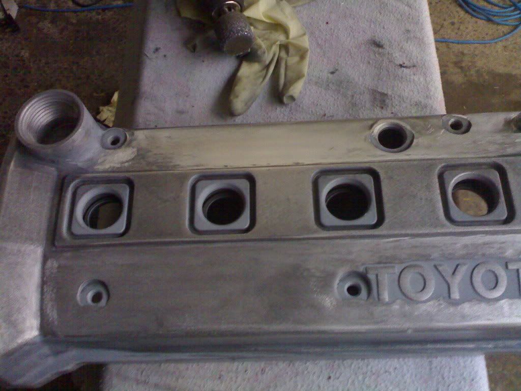

nic1.3 Posted May 6, 2008 Posted May 6, 2008 ok i was doing some work to a spare rocker cover over the weekend,(grinding down the lines on the cover) getting it ready to paint, when i had a bit of a problem....here's my work so far.i had tapped up all the plug holes and pcv hole was blocked when my old man went and took them off to have a look at it and afterwards i found some tiny metal dust particles in and around the plug holes ad pcv valve hole, i intended to washer the rocker cover very well before painting it my question is will the rocker now be safe to use, if the metal dust has gotten into the inner surfaces will the cover be safe to use once cleanedas i don't want the metal articles mixing with the oil, will cleaning the cover be enough to prevent any damage being caused to the engine whenits in use??? Quote
StarletRick Posted May 6, 2008 Posted May 6, 2008 put it in the dishwasher mate ^^ just give it a real good clean up first. i wouldnt worry about it Quote

StarletRick Posted May 6, 2008 Posted May 6, 2008 yeah no need for that, good old rinse out will be fine. Quote
keirz Posted May 6, 2008 Posted May 6, 2008 and blow off with airgun if you have access mate. should be ok. Quote

montanajr Posted May 6, 2008 Posted May 6, 2008 Just power wash the bastard! Will get rid of any bits of metal filings etc! Quote

StarletRick Posted May 6, 2008 Posted May 6, 2008 one thing with these. make sure they are warm when you lay the paint on. because its a lump of metal, it holds the cold really well. and can lift the primer when drying. i put mine on the gas hob for a few mins before i painted mine! Quote
