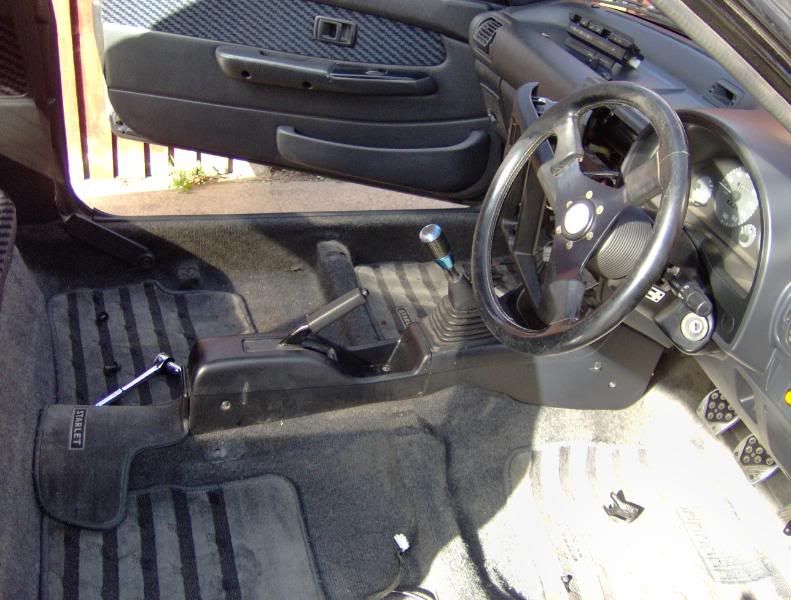

first to go, is those god awful, standard seats, very very uncomfortable, and although im not a particuarly tall guy, i found that even i was to tall for the seats.

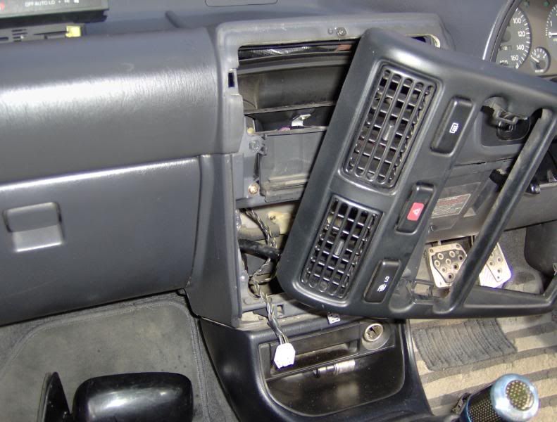

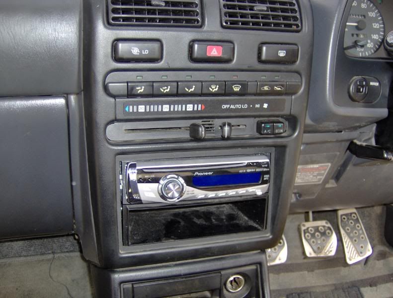

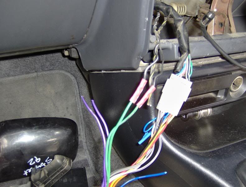

whilst the seats were out i decided i would fit another stereo, as the one that was in it, was for the japanese market, and also there were no speakers,
doing the re-wiring, the japs love to bodge wires,
finally finished fitting stereo, and i also repaired the buttons, for the air vents, as 2 were broken.

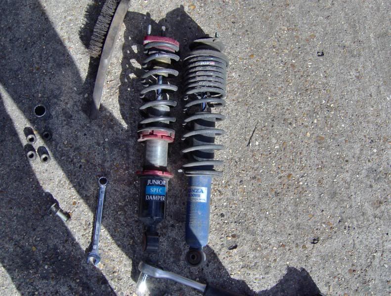

i swapped the suspension over.
this is the stuff that was on the car.
rear shocks
rear springs
front shock and spring

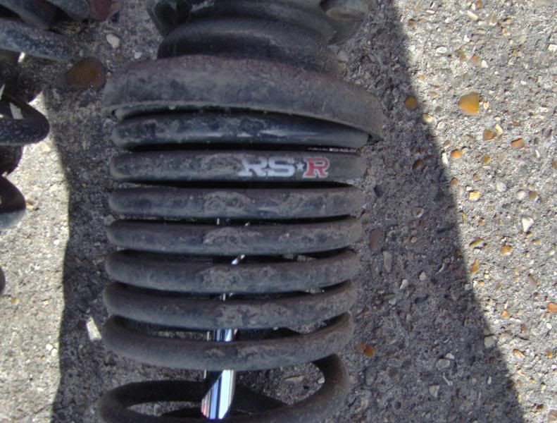

its strange why itr had rs*r springs on the back and (i'm guessing here) monza springs on the front.
the car did have monza shocks all round, which were very firm, for a shock and spring setup, and was quite good round the twisty's.
my old buddy clubs, next to the shock i just took off.

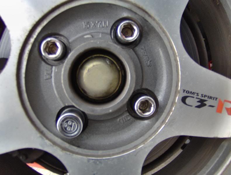

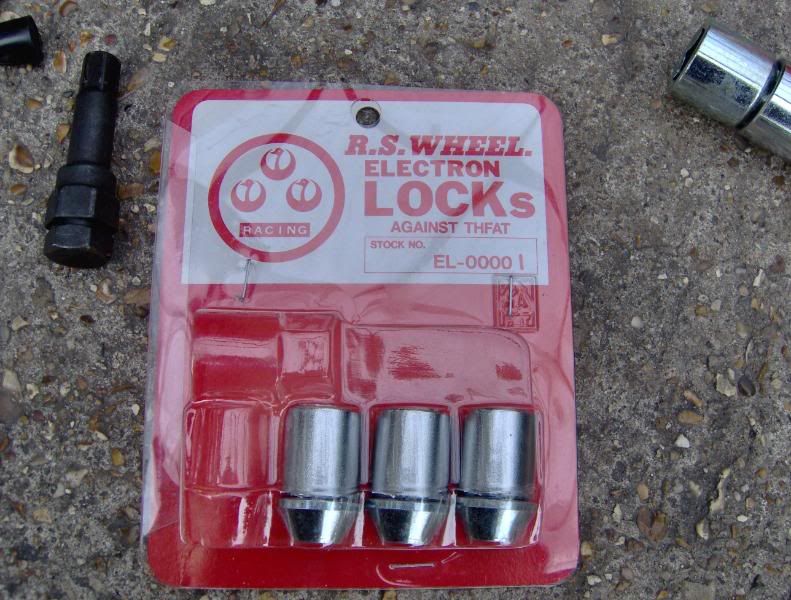

also fitted watanabe locking nuts
watanabe nuts fitted, and autobahn tuner nut's fitted.

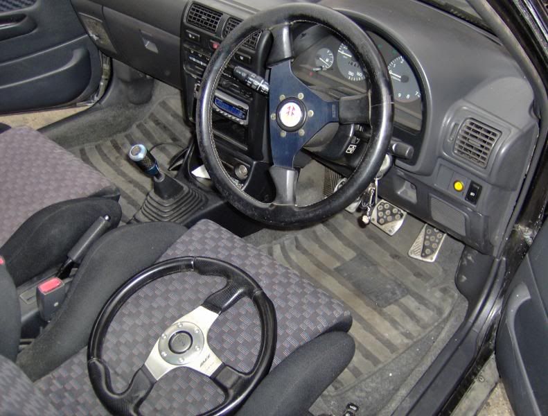

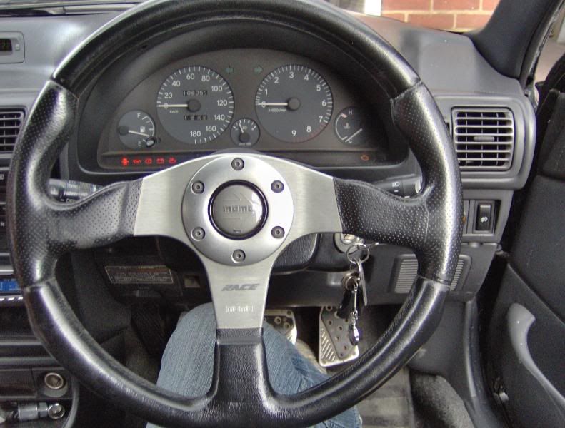

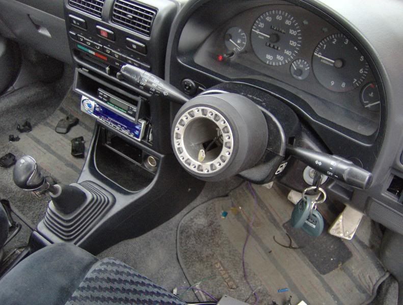

swapped the steering wheels over, as the one in the new car was a little worn,

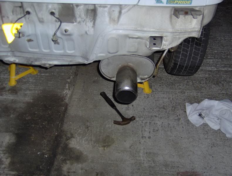

Decided to swap the exhaust from my old car to my new car as it was a 5zigen, and actually made a noise.
the main reason for me swapping the exhausts
the 5zigen, so much smaller and lighter, then the unknown one that was on the car

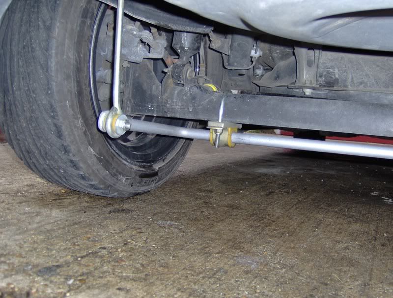

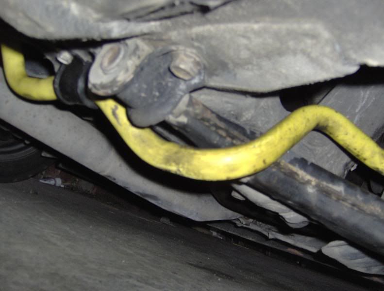

The TRD anti - roll bar also got swapped,

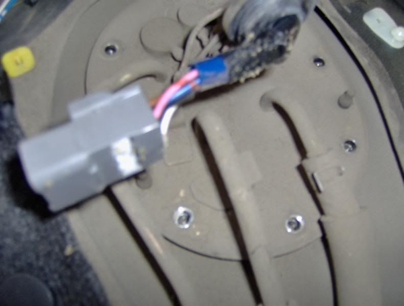

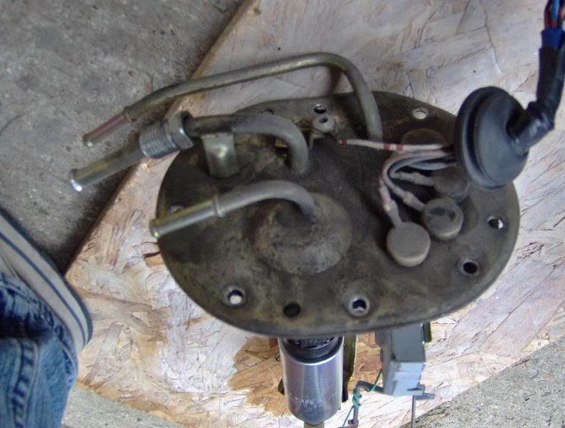

swapping the fuel pumps over,
new pump
old pump, super dirty
I must say, big shout out to kei aka Glanza k31, for helping me swap the exhausts and anti-roll bars over, couldnt have done it with out his help.
and it earnt him some brand new TRD roll bar bushes, as they wont fit on mine lol

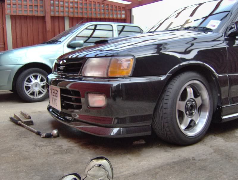

I also fitted my sideskirts back on, and put on my front lower arm bar.

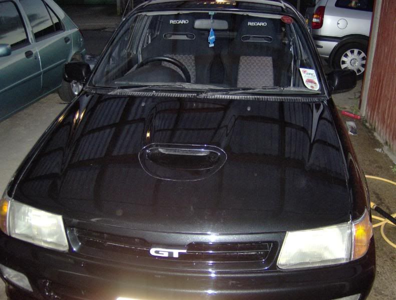

also cleaned the headlights with some polish, as they were very yellow, i think they came out not to bad

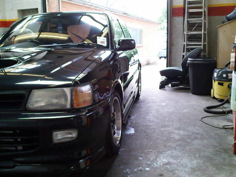

i havnt got many pics, i just took some of the outside of the car
its still filthy dirty as i not had chance to clean it, and it was starting to get dark out, and my camera is a pile of poo, so they havnt come out to well.
when i get round to washing it, and the weather is good and i nick my dads camera, i'll get some decent pics.

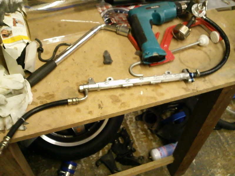

tomorrow im swapping the fuel pressure regs over.

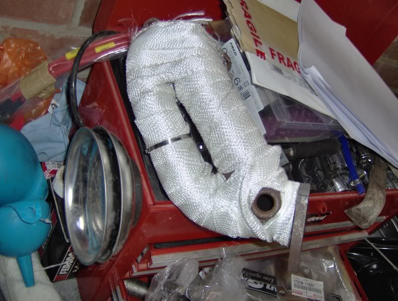

and decided to heat wrap my decat, as it was rusty

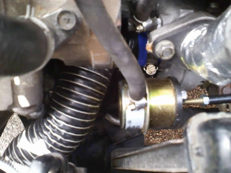

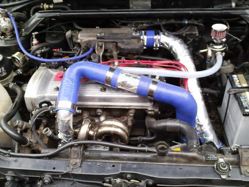

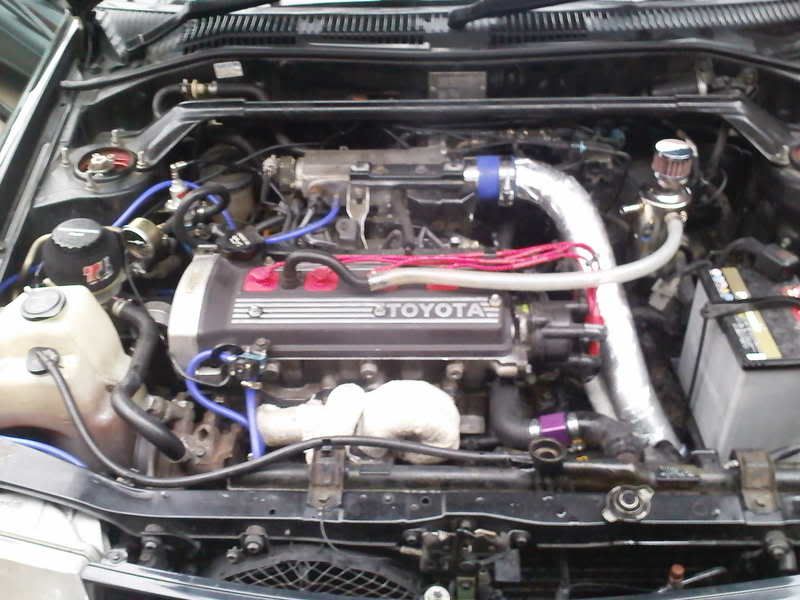

catch tank fitted
manifold - which is still bloody blowing grrrrrrrrr

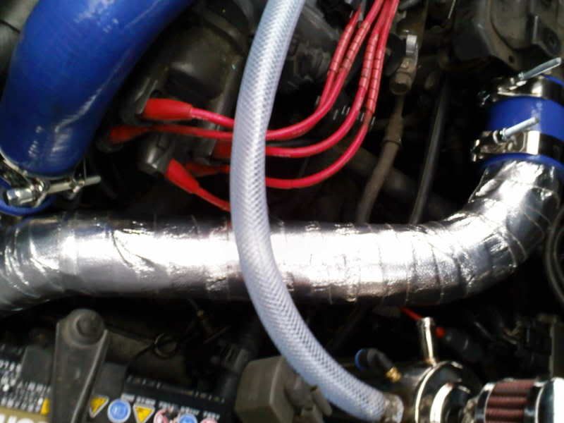

modified intercooler piping
piping with heat reflective tape
and everything back together
i now have only 0.4 bar of boost max as the mani is still blowing, and it takes an age to get to speed. so i shall be taking it easy on the way to le mans.

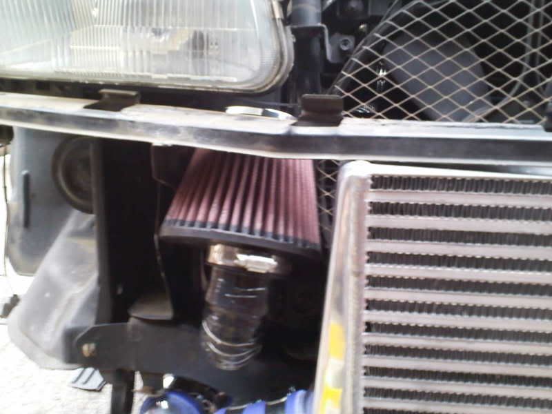

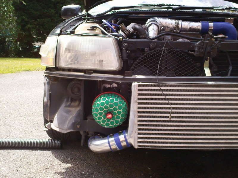

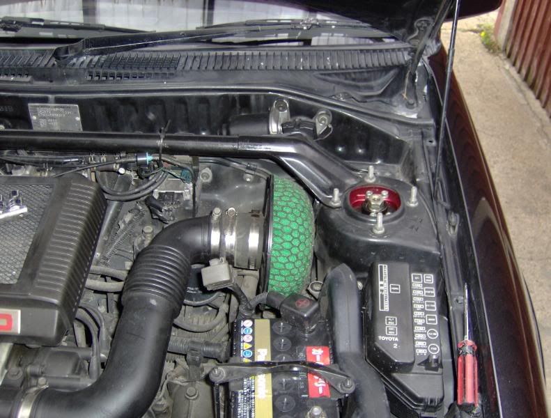

decided that the corsa k&n filter just would suck enough air, and decided that a 45mm lenth of pipe never done the trick either.
so on goes a hks air filter from a skyline, and a lengh of 51mm pipe.
and i must say i'm impressed that i still have air con to go with it.
all i need to do now is adjust my actuator arm, and get it tuned, hopefully be sometime this week or next.
after that the cars just gonna be driven and have the uprated brakes i have lying around, i'm bored of spending money on it now
and that is how long the piping is, its a very short route, and has minimal bends in it

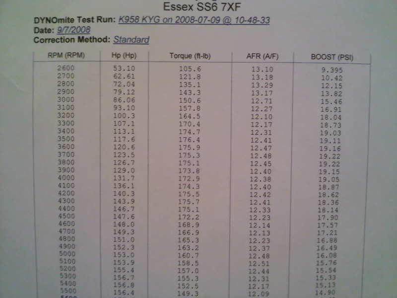

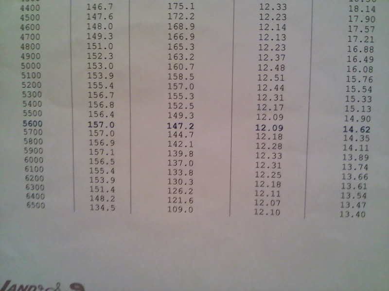

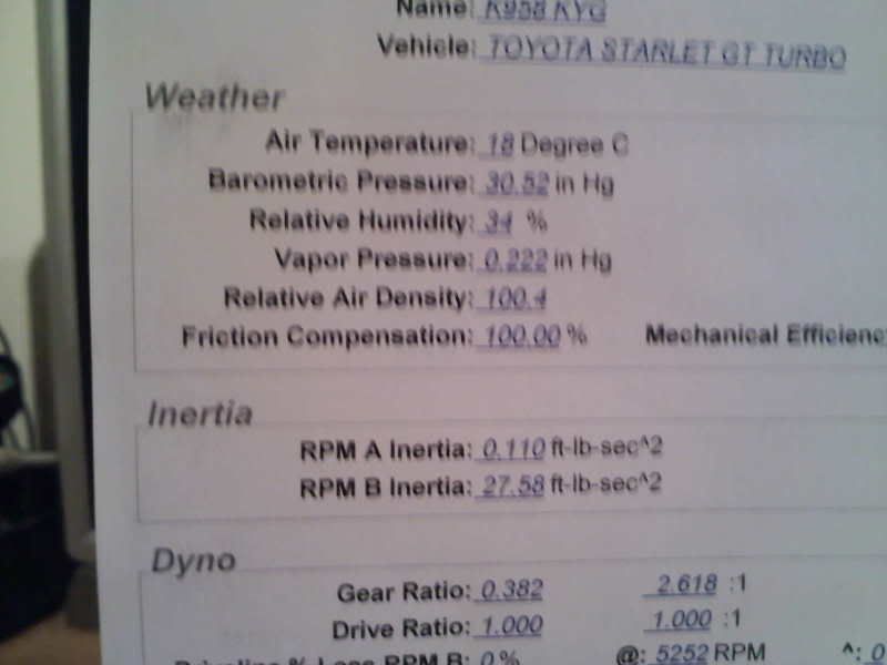

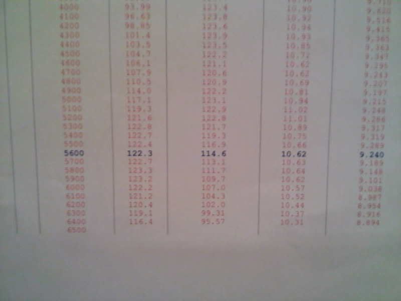

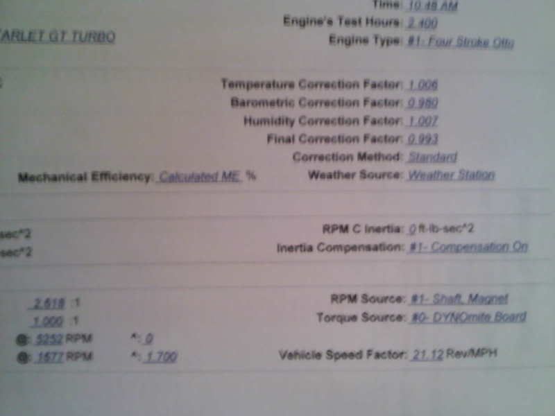

got it tuned
it made 177lb/ft of torque, and 157.1 hp @ the wheels, which i'm pretty happy about to be fair :o

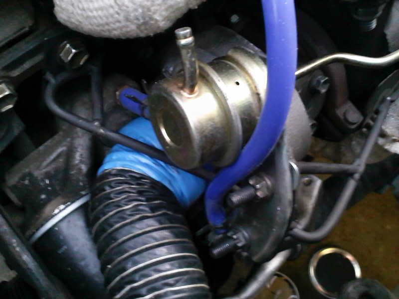

unfortunately the crack in the wastegate is causing a boost drop of 9psi, it starts at 19 psi and drops down to 13.5 psi, it's not really noticable on the road but i think it could have made more power.
also my headgasket is on it's way out as the overflow bottle was filling up.
and my tuner reckons my piston rings might be on there way out as there was a lot of air coming out the breather, but it's not burning any oil and isnt running on less than the 4 cylinders, so i am unsure.
but i have decided to go forged anyway and wack the boost to 1.4bar, but this wont happen for a few months yet :D
as soon as photobucket is working again i shall upload the power graph and the video :D
sorry for the blury graph, the blue line is the torque, the red line is the wheel power and the yellow line is the boost, black flat(ish) line is the a/f
i cant get a better pic of the graph as the lines are to small for a scanner, and a camera cant take a better pic.
you need to sort that fmic bodged pipework mate, looks like quite a restriction in that, which you could do without as the core is quite large anyway, you want it flowing as efficient as possible.
what was wrong with the original fmic pipework routes? what you've done there is just pikey, and prob what is causing your loss of power (or lag anyway).
well to be honest it was done because i was told a manifold i bought would fit with the blitz/autobahn pipework, and unfortunately it didnt.
and i needed the car to go to france with, so for the time being the pipework was bodged, its really not that pikey to be fair mate, maybe its the reflective lagging makes it look worse.
but re-routing the piping is next, it's just a bit difficult when your trying to keep the a/c, and it's not really ideal to clock the turbo as im using an actuator, and will need to get brackets made up.
another reason it hasnt been done before it got tuned was because it was sort the piping route out, or get the car running safely as money is a bit of an issue at the moment because of unforseen circumstances, naturally i would rather get my car running safely.
the boost loss is more than likey due to a crack in the waste gate, and spool is almost the same as riko's, mainly to do with the manifold design, but its really not that much later than stock.

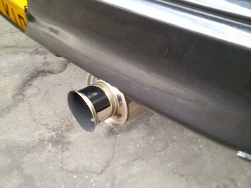

he used some type of metal polish on my exhaust, whatever it was made it shine oh so good and imo miles better than autosol
also got some pics of my front mounted air filter (these were taken before car was cleaned)
all pics were taken on a camera phone

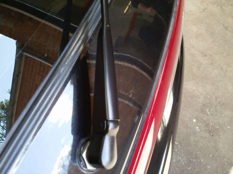

also repainted all my wiper arms, as they were all rusty, really to make such a difference.

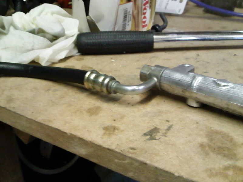

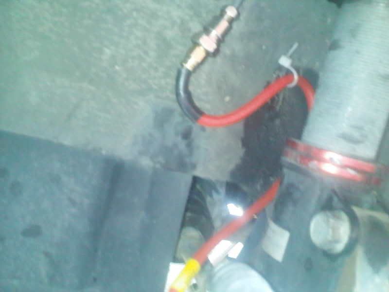

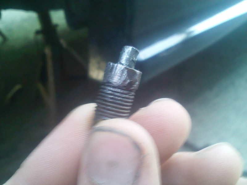

decided to fit braided brake lines today, i thought it was about time seeing as i have had them for just over a year now, and the power of the car has upped lol
was a bad idea,

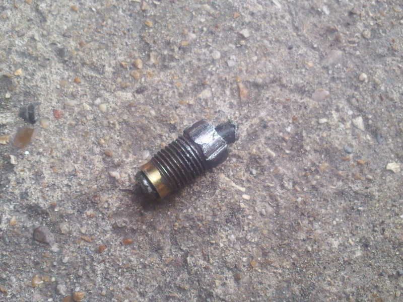

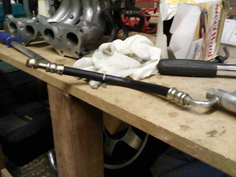

the brake pipe union rounded off, and for love nor money would it budge, so i went out and bought a brake flaring tool, got home and realised that the flaring tool couldnt do steel pipe, which the starlet has, bugger.
so i perservered and got the union undone, yay,
then i went to move it and the the brake line split :rolleyes:
but after hours of making the flaring tool work on steel pipe (perseverence is key)
i finally got the fronts fitted (it was the passenger side that was a pain, drivers side was a peice of cake)
the reason the brake lines are now in a different position is because the buddy clubs used to keep undoing themselves on the brake line brackets bolted to the chassis, so the only option was to move them.
also decided to fit my FERODO DS2500 brake pads that i have had for 6 months,
and decided to fit my new discs also
next weekend i shall do the rears, and pray that everything works ok.

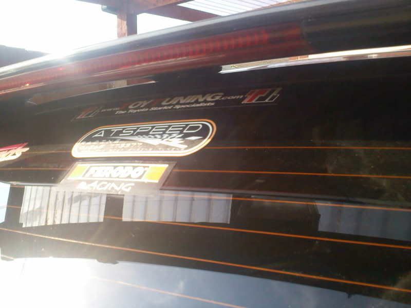

oh also added some stickers
thought i would get some proper pics of my rr fraphs and tables.
before it got tuned:
after
the temp the booth was set to etc etc
final graph (again)

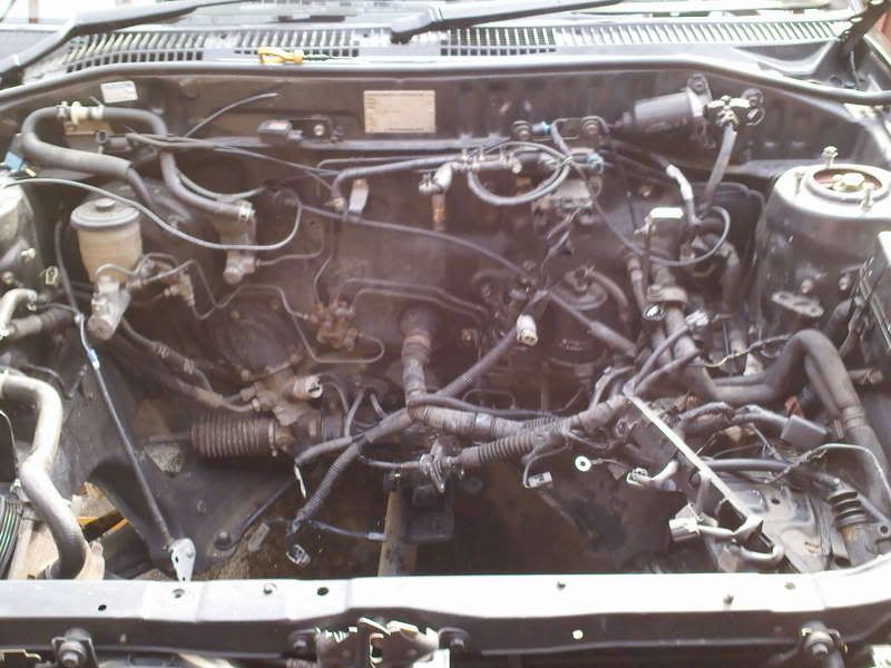

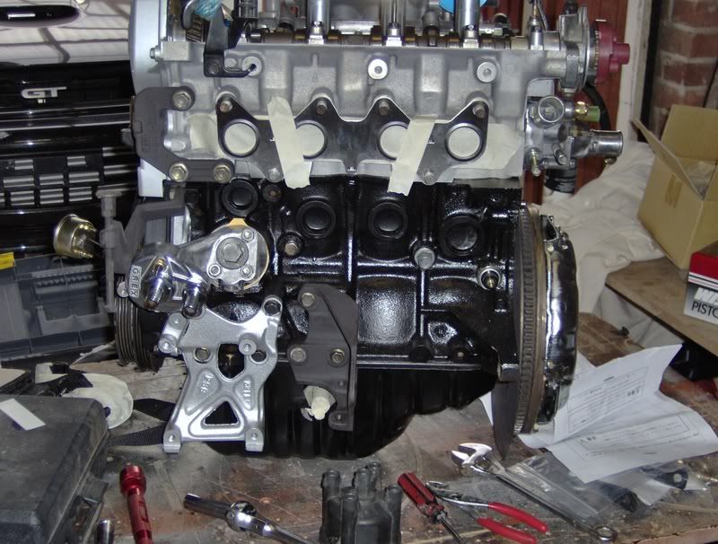

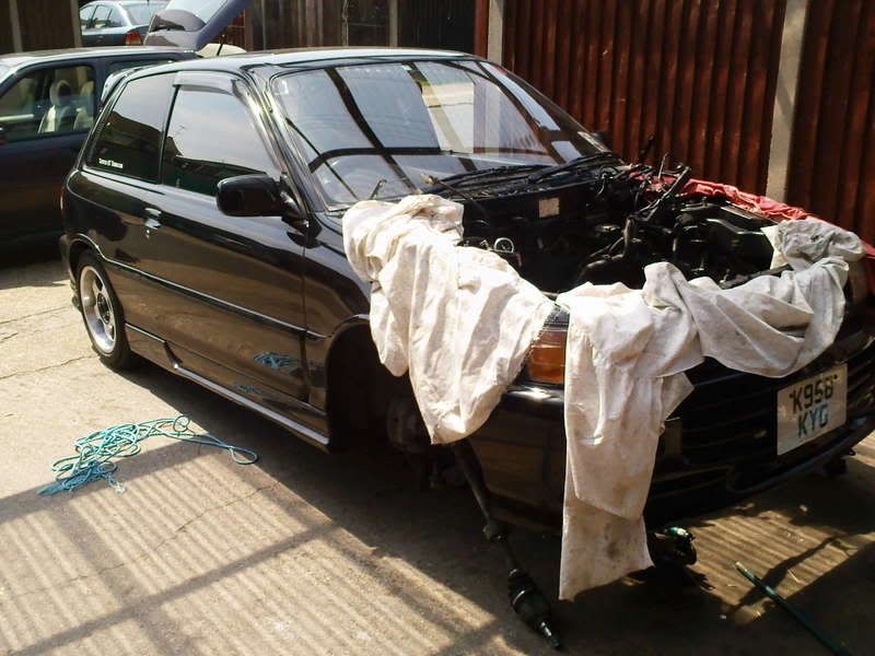

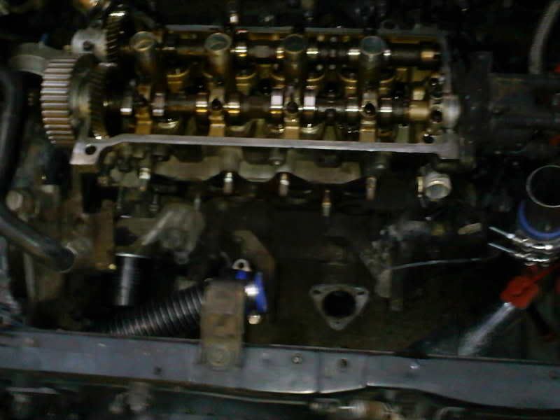

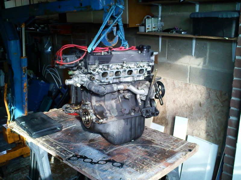

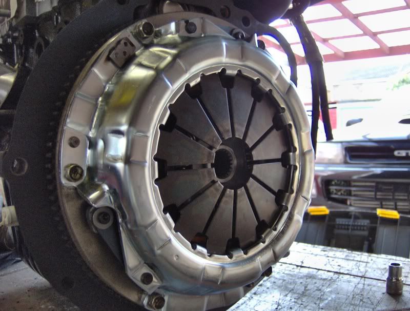

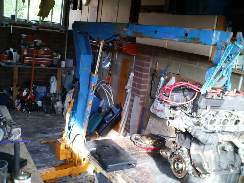

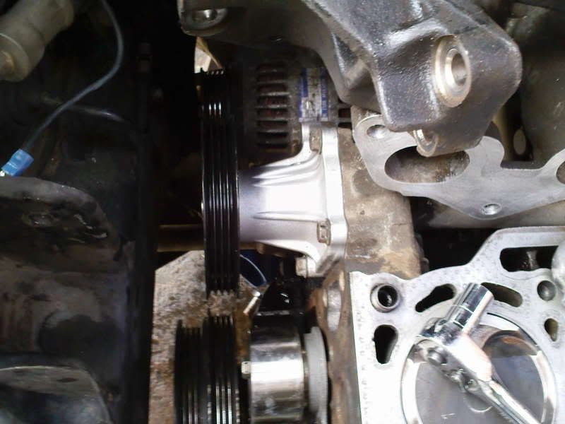

starting to strip the car down to replace head gasket.
would have got a lot further if my dad hadn't taken the keys to the shed where me tools are, out with him
fitted new water pump today, whilst its easy to get to.
i dont know if having the extra blade will cause any problems but we soon find out i guess lol, it fitted fine so i assume it will be ok.
also just been generally cleaning things today, in fairness to get best results in cleanliness the engine needs to come out and just lay in a bath of jizer for a few days,
how do engines with no oil leaks get so dirty is beyond me

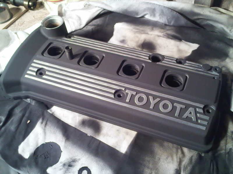

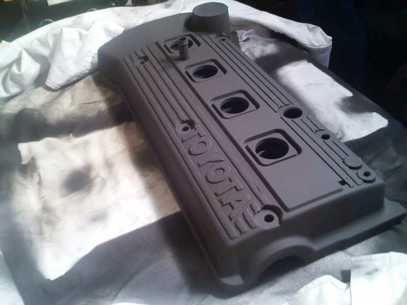

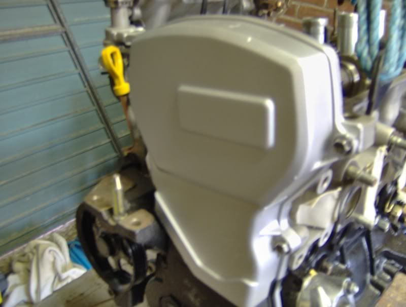

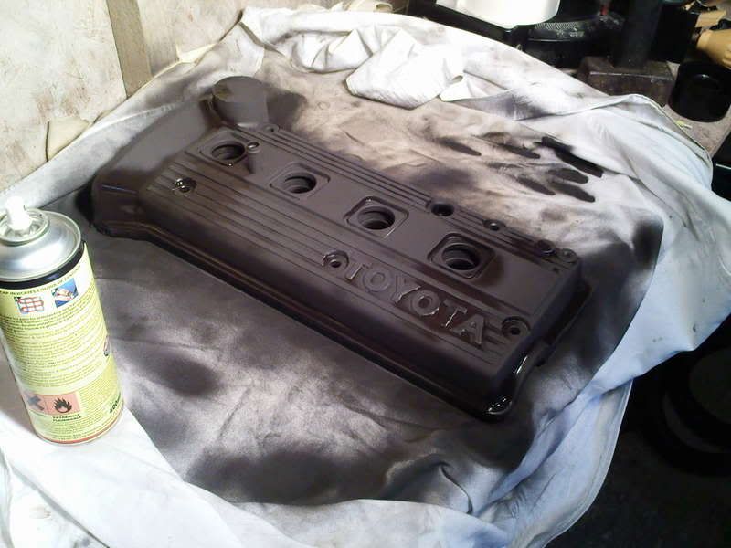

decided to paint my rocker cover
during painting:
finished painting:
i shall be changing a fair few things while it's all apart, including that intercooler piping ecksjay.
crackin car u got there such a change to see a non quadlamp and also some1 who does not decide to cut away the bumper for intercooler looks much better wheels i must say r stunning write ups r ace also mate keep up the good work
bit of an update from during the week.
i seem to have deleted a load of pics though which is rather annoying.

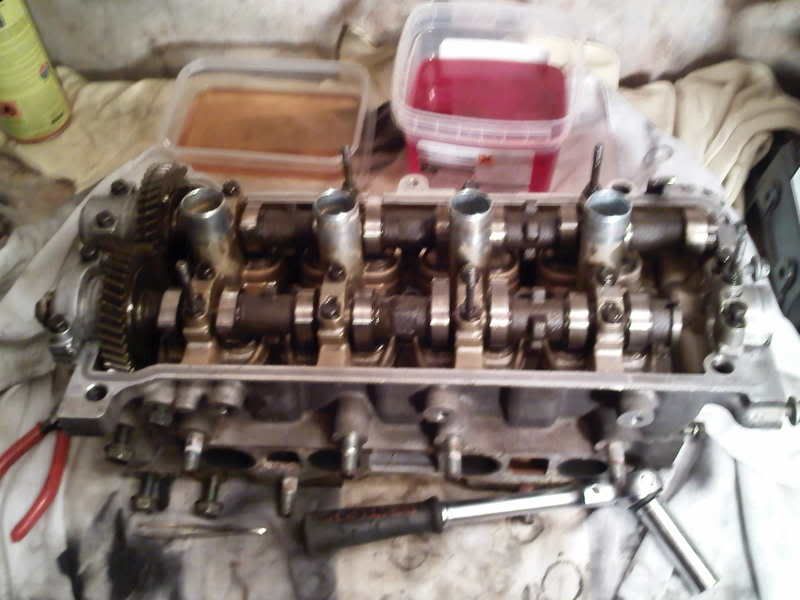

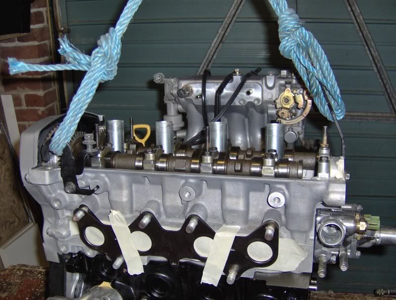

any way, i done the valve collets, and rebuilt the.
i needed to check the valve clearances now that i have reground the valves.
red pot is jizer so i could clean each part before it went back in the head, the orange pot is oil. i have never seen oil so clear, i thought i would buy some shell helix fully synthetic and i cant beleive the difference between valvoline and shell.
any way after buggering up the fitment of the head the first time, my fault for being tired and not concentrating on what i was doing.
any way got a new gasket from work and some new head bolts, well lets just say whoever sayd that aftermarket stuff isnt as good as OE i can say is rubbish.
i bought a PAYEN headgasket and bolts and compared them to toyota and i could not tell the difference, the payen gasket even came in the same celephane that the toyota one does, i was highly impressed.
sadly no pics though.

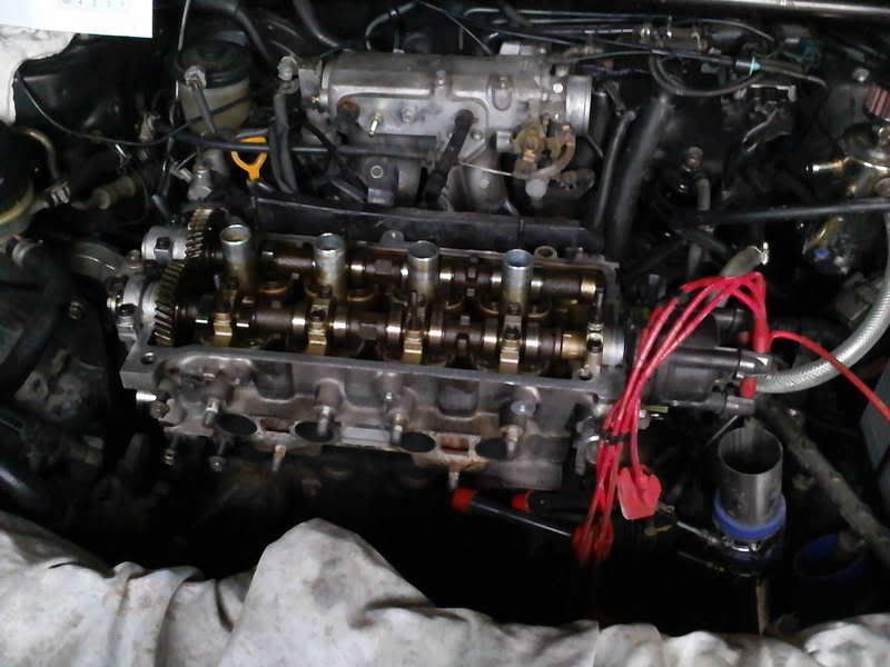

any way got head on and distributor, and the timing belt is now on also.

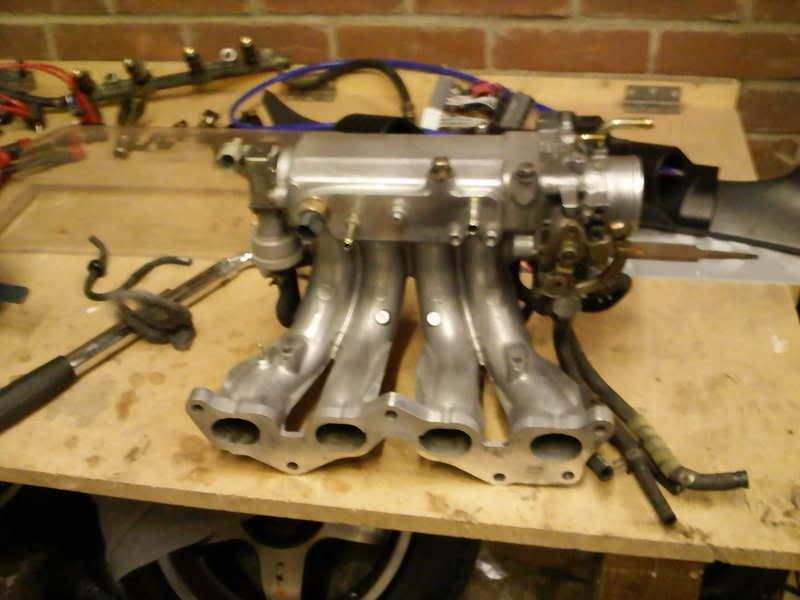

tomorrow i need to fit the injectors and the inlet mani, then my mate is coming round sunday and we gonna re route the inter cooler piping and refit the turbo, and reweld the mani and make a custom actuator bracket.
i cant wait to feel boost again :)

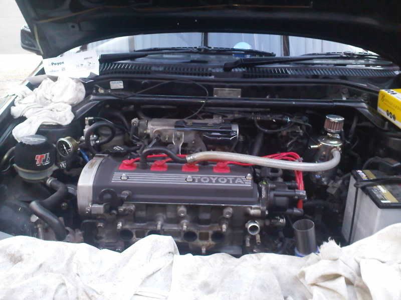

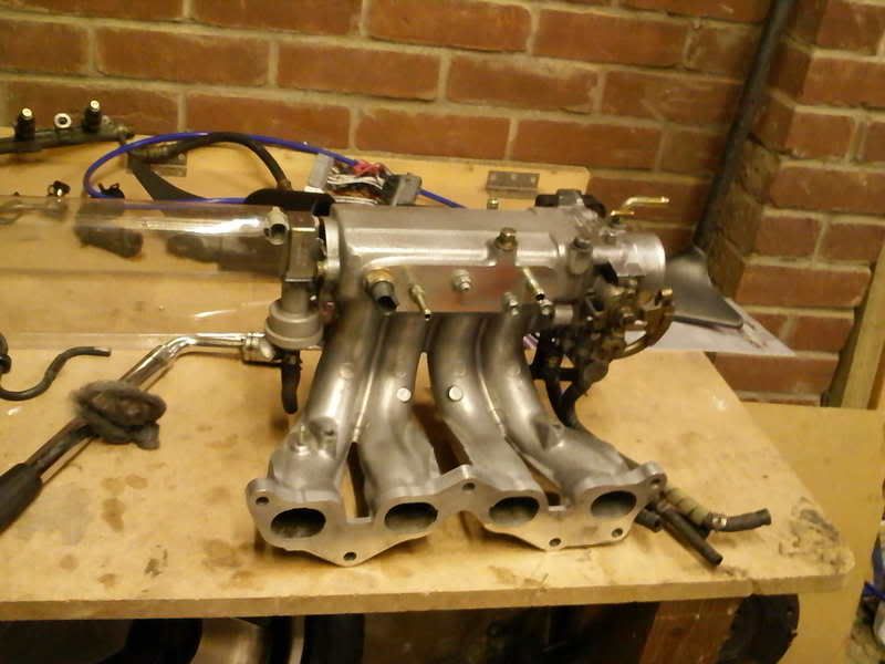

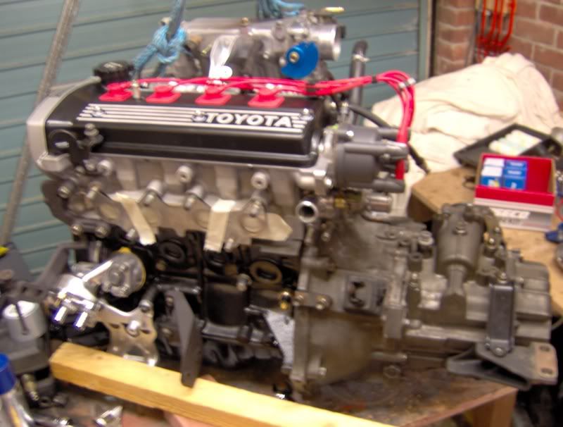

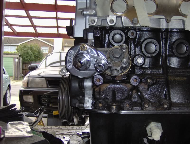

well finally getting there with my car,

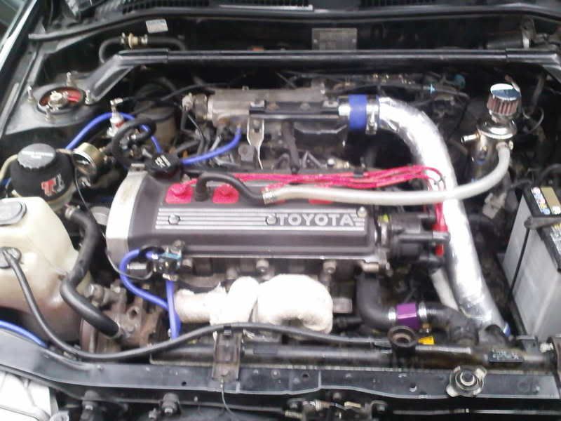

inlet manifolds on, and all sensors and wiring is in place, just gotta make my custom piping, and actuator bracket, then fit it all together. hopefully have it running tomoorrow.
pics of progress:
also fitted my cusco master cylinder stopper, i've had it for over a year now and i just forgot about it, till today lol.
hopefully it will make a difference.

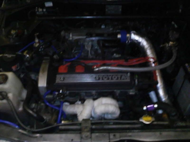

been a very very hard weekend.

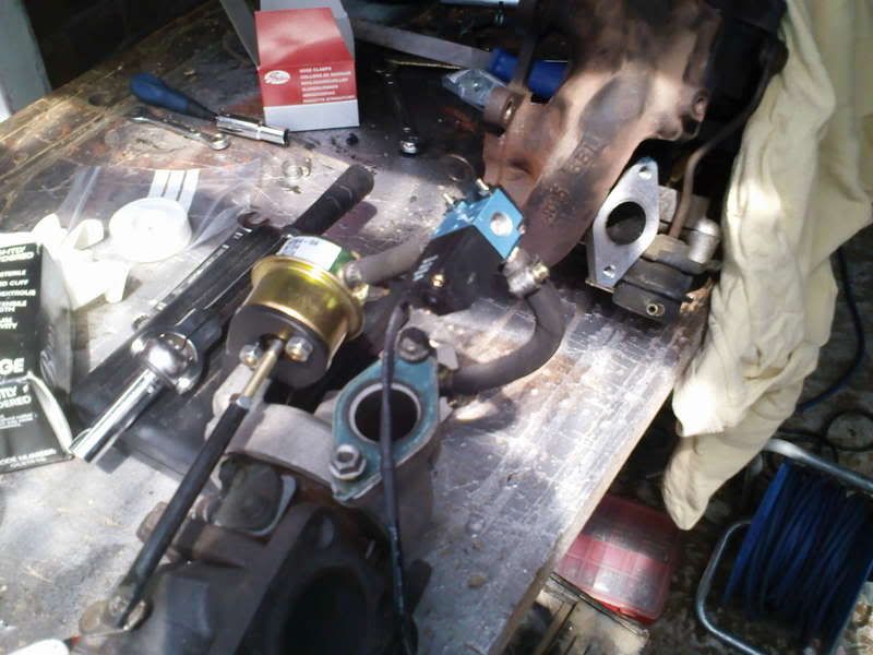

i never thought turning the turbo would be so awkward, but we done it lol.
also a thanks to all those nice comments

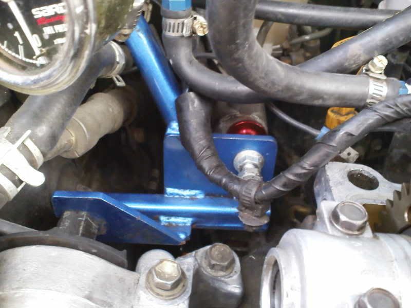

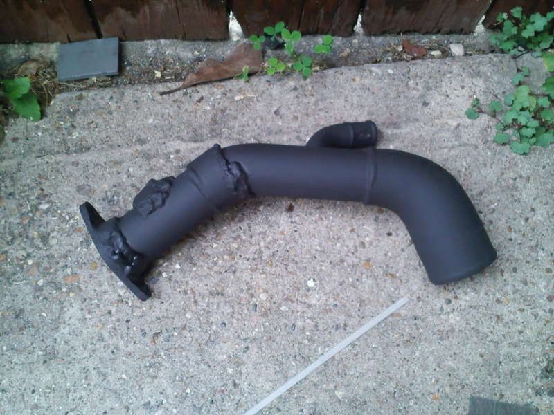

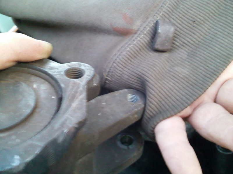

at first me and a mate spent 4 hours making an actuator bracket, test fitted it, and realised the guy who i got to rotate the turbo had rotated it to far, our fault for not double checking.
so with that found out we were almost defeated, but fear not my mate had a great idea, i had a second intercooler pipe, so 2 became one, plenty of cutting and rewelding

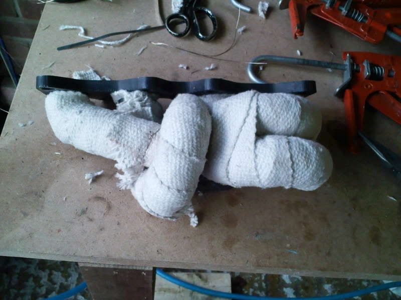

so with that done, i decided to wrap my maniflod while he was messing around with bits and peices and doing lots and lots of welding.
after the IC pipe had been welded, we needed to test for leakes under high pressure, so heres one we made earlier, proper bloue peter stylee lol
an empty siline cartridge, an air line, and a bucket of water and walla.
eventually they were all welded up. ( this was much harder and took much much longer than i have made out so far, ne and my mate have spent 12 hours solid for 2 days on this and it's still not been started lol)
hours and hours were then spent making a custom actuator bracket
unfortunately i was to busy to take many pics.
then we found that the new actuator bracket interfered with the power steering pump, and we couldnt make the pump fit, so i solution
yep we cut up the power steering pump lol
then we had problems with more pipe work, and its just been one problem after another so i tried bending an air con pipe and got this
all over me the car and my mate, was proper pissed and this was at 8.45 tonight. never mind it's one of them things, so i now need to get one of them, DOH!!
we then had a huge mission of cleaning up, and putting a few things on, we finished at 10 tonight, and have concluded with this
gotta double check a fair few things then fill it up with oil and water, and hopefully all will be well, but i cant help but think something else is gonna go wrong ^_^
This is how the bay looked when i started it for the first time, today (26/8)
i seem to have boosting issues now though which is very odd, the actuator dont seem to be boosting to what i have been told it does.
i am waiting to hear back from the trader i bought the actuator from
right i think i've found the boost issues, at 4k onwards the timing has been retarded quite a bit, from standard levels,
i beleive the tuner done this because of the way the piping route used to go over the engine and manifold.
it was originally booked in for a retune tomorrow, but i'm having mega cooling issues now (see other thread) so i cancelled it, theres no point getting tuned when theres obviously something wrong.
so as soon as i have located the coolant problems, i will decide what direction i will be going for the future.
unfortunately i have spent to much to turn back now, so must carry on and spend that lil bit more lol

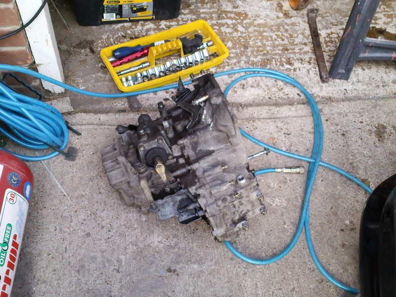

decided to take the engine out ready to send to dave b.
the engine hoist, it's a hoist for lorry engines, so a little bit overkill, but it costs me nothing to use so cant complain lol
engine
gearbox

decided to clean the inlet manifold last night, my thumb and fingers hurt so much now, spent hours scrubbing that to get it clean, 15 years of crap
decided to clean up the fuel rail last night aswell
again not quite perfect, but it's the best its gonna get

started putting all the brackets back on the engine today.
freshly painted timing belt cover

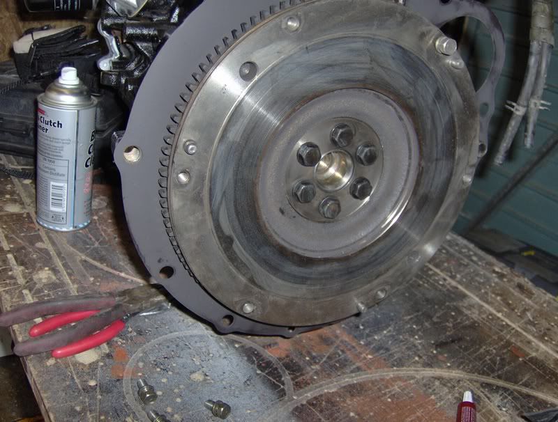

fitting flywheel
fitted clutch
fitted greddy oil filter relocation kit
ATTAIN Power throttle cable link
painted brackets

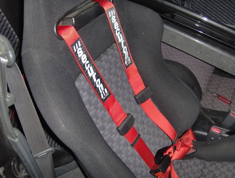

fitted one race harness
got rocker cover back, and gearbox back this week.
cheers mike,
engine went in over the weekend, just gotta sort a few bit's and peices, and i just waiting for the turbo kit to come.
i need to get the car back on the road within the next 2 weeks so fingers crossed.
